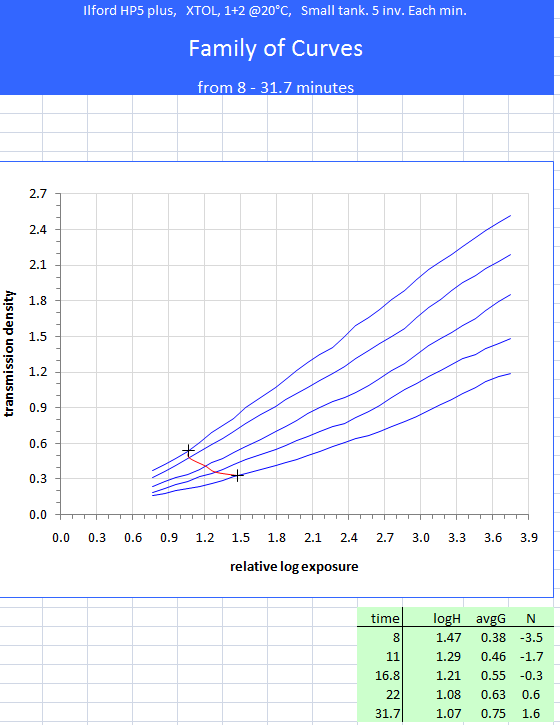

Hi PeterB,
You can jerry-rig your camera underneath your enlarger to take advantage of the shutter. Or maybe use electronic flash as the light source.

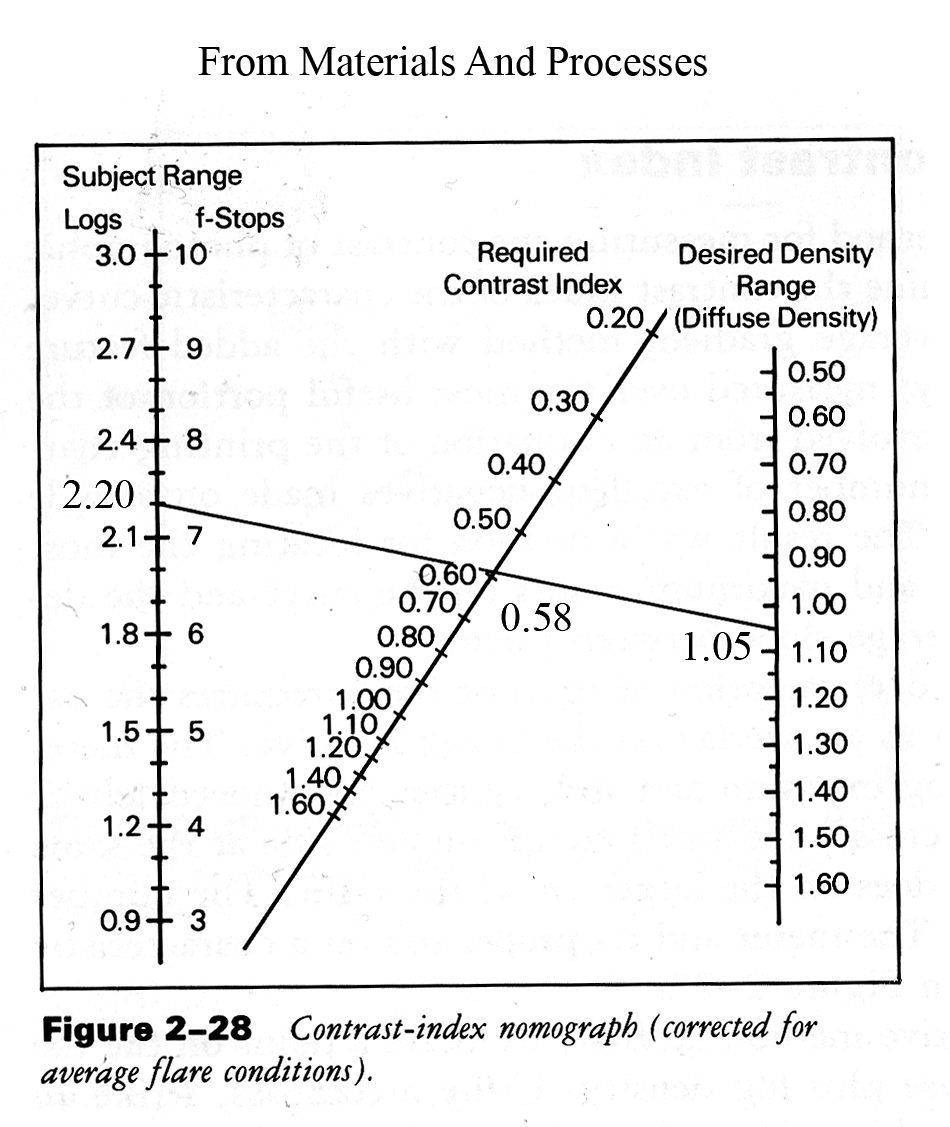

...BTW, a good way to calculate aim CI is:
desired negative density range / (log subject luminance range - flare)
Example: 1.05 / (2.2 - .40) = 0.58
Wow, so simple and easy to prove. I'll keep this posted by my densitometer!

Thanks Stephen. My main opposition (up until now) to doing it via the contact method is that Ralph's book (WBM) and his replies to date in this thread have never pushed it to the point you have which left me with the distinct impression it would be acceptable to carry on with the camera lens in the light path. Perhaps Ralph is assuming we must prevent all other sources of non image light from hitting the lens (the image being the step tablet). And after my learning experience above, I too agree that it is necessary to eliminate all light from around the step tablet and coming in from the sides in the air between the tablet and the lens.
Ralph's correct in that it's unrealistic to assume there isn't flare in the system, but that doesn't mean it has to be included during the exposure part of the film testing only that it needs to be factored in.
Ralph suggests we deal with flare by using the nomograph in WBM. "In addition, the use of certain equipment, like the type of enlarger or the amount of lens flare, influences the appropriate average gradient and final film speed. The nomograph in book provides an overview of these variables and their influence. The Zone System is designed to control all these variables through the proper exposure and development of the film. This requires adjustment of the manufacturer’s film speed (or ‘box speed’) and development suggestions." (copied from page 1. of the FilmTestEvaluation.pdf he links to in this thread)
Ralph has decided not to push the contact method because of the above approach he takes with the nomograph. He is ignoring the (supposedly small) effect of the flare from the less dense steps in the tablet).
The experiments you conducted Stephen give MUCH larger areas of light which add flare to the image (compared to flare from the few small lighter steps in the tablet). In fact on my Stouffer 31 step wedge each step is only 4mm x about 15mm in size - small compared to the nominal 56x56mm frame size of the negative.

Thanks for your replies Usagi and Bill.
Usagi, I too would be concerned about the repeatability of switching an enlarger on and off with the ramp up and down of the light intensity. Rather than waste another 5 rolls of film I would rather first do some test to convince myself of its repeatability.
My light meter measures flash output with and without a synch cable attached (I just have never tried it), and it is possible that such light meters can measure/integrate the light intensity over times longer than the micro seconds a typical flash burst lasts.
Having said that I am still trying to convince myself that the in-camera method can work for me (see my last post to Stephen)

Hi Peter,
I don't want Ralph to come back and say we hijacked his thread and tried to change his method.
So go for it with your current setup, which is in line with the Way Beyond Monochrome testing instructions.
Mask your test wedges and make the best lens shade you can.
Expose the strips for three or four more stops of light than you did last time.
Hopefully, you will find N somewhere near 12 minutes and you will have some densities near 2.0
Flare was messing with your toe densities that were supposed to be under 0.1.
Underexposure was keeping your dMax under 1.0 when it could have been 2.0
Because you are not using "modern" lenses, you may still have higher toe densities than Ralph, but it will be a model of your camera system.

Excellent ! Thanks for your blessings Bill ! Ralph should be pleased that I stuck to his method.

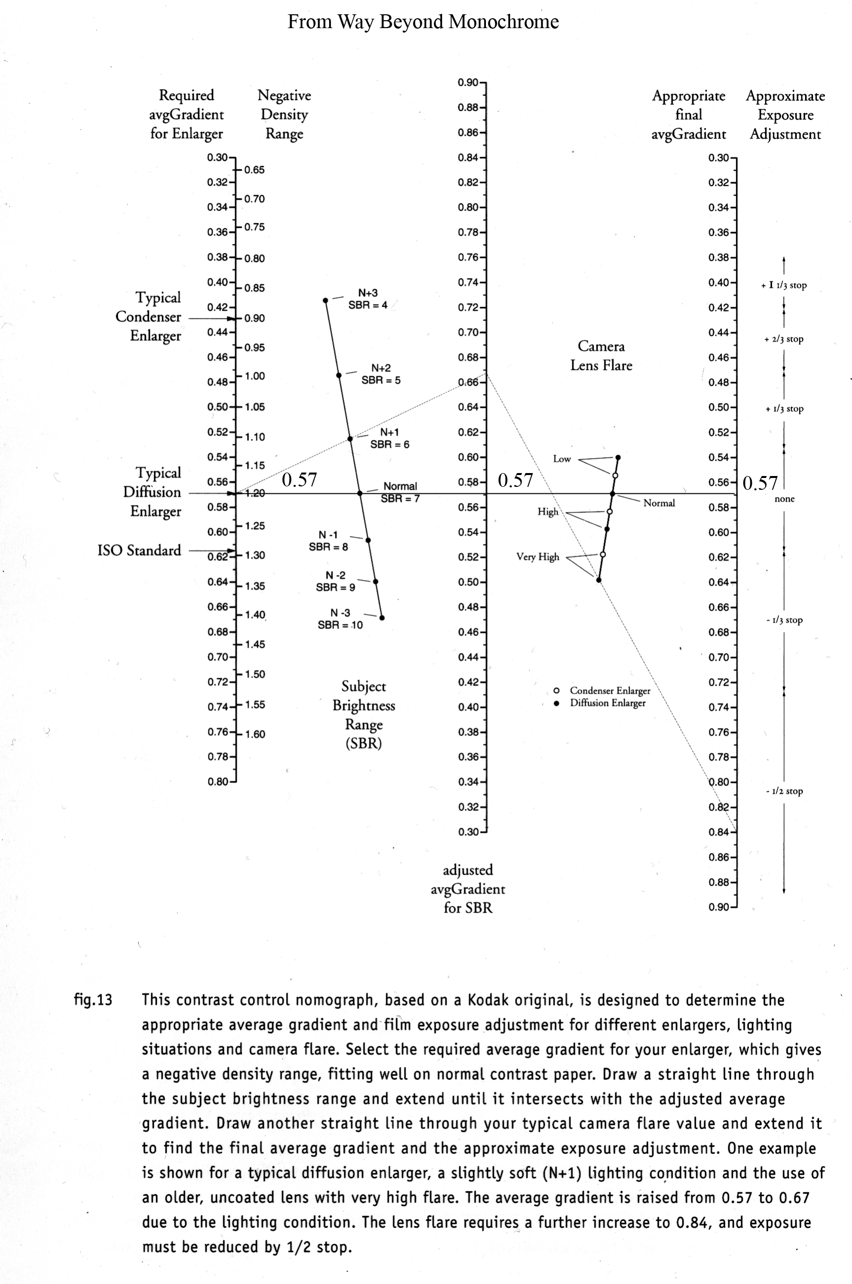

Take a look at Ralph's Nomograph. Here are three questions to ask yourself.
Why is the aim negative density range for a "typical diffusion enlarger" 1.20 when the ISO standard has it as 1.05?
If you draw a line from paper CI 0.58 through 7 SBR to 0.58 adjusted aveGradient SBR (middle scale), through Normal Camera Lens Flare and you get 0.58 for the approximate final avgGradient. How is it possible to have the same CI from beginning to end when normal flare is at least a stop?
How can 0.58 be the aim average CI when flare is zero, yet CI 0.58 is also normal using a 1 1/3 stop flare factor: 1.05 / 2.2 - .40 = 0.58?

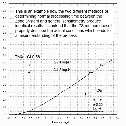

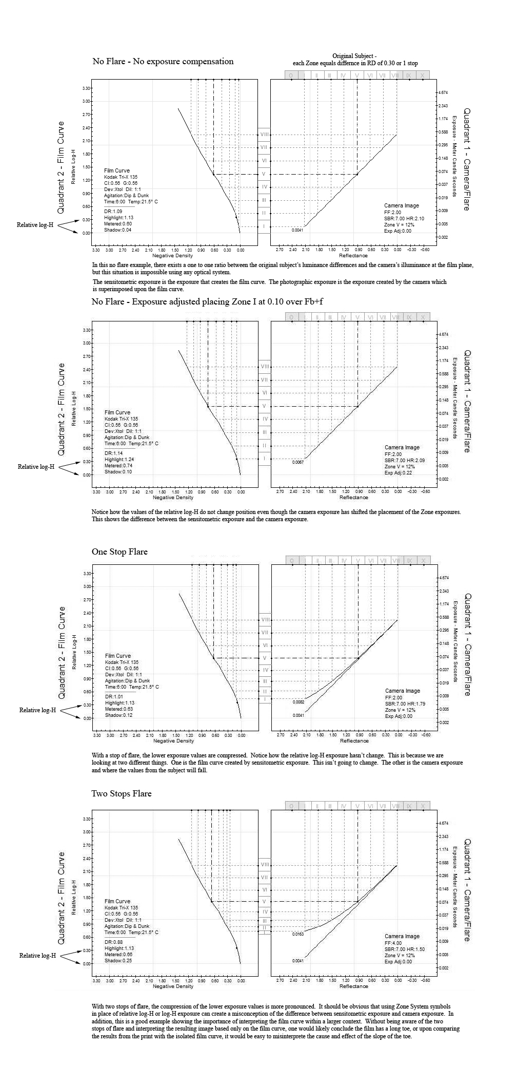

The attached example might help to explain the difference between sensitometric exposure and photographic exposure and hopefully convey the importance of contacting the step tablet in order to produce a characteristic film curve which excludes many variables such as flare.

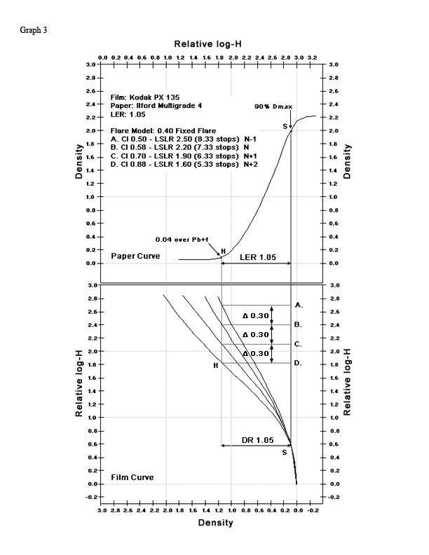

I've uploaded two more examples to help illustrate interpreting photographic exposure using sensitometric exposure. The first example shows how the discrepancy between the Zone System's aim negative density range and the ISO's aim negative density range is less a difference in system parameters and more about how the curve is interpreted. The Zone System doesn't factor in flare in the interpretation and instead uses a higher aim NDR. The ISOR method factors in flare, effectively reducing the illuminance range from the subject and consequently producing a smaller aim negative density range. Both methods will produce a negative with the same contrast index, but only one represents "reality" and only one works in relation with the ISO paper testing method. But I believe this is an excellent example about importance between sensitometric exposure and photographic exposure and understanding the difference when interpreting the data.
The other example shows the theoretical matching of the negative to the paper from a various subject luminance ranges. It's theoretical because it uses a fixed flare model yet flare tends to increase with higher luminance ranges and decrease with lower luminance ranges. However, it does illustrate the application of photographic exposure with sensitometric data (exposure). Determining the appropriate curve CI to luminance range that matched the paper LER was done using the equation CI = Negative Density Range / (Subject Luminance Range - Flare).

Hi Stephen, sorry for the late reply. Some new film arrived today so I'm ready to repeat my testing and I now have time to think about this again.
Actually when I look at his nomograph and read page 1 of the pdf Ralph gave us in this thread, the ISO target density range is 1.30, not 1.20. He goes on to explain why we don't target that. One reason is that "In general, advertised ISO film speeds are too optimistic and suggested development times are too long." also "Not knowing the exact combination of products we use for our photographic intent, they (the film manufacturers) have had to make a few assumptions."
To start with this nomograph something Kodak created and Ralph reproduced, so I'd prefer both of them justified it before I did.
It is possible the nomograph is in error since as you point out, 'normal' flare results in no adjustment in the CI. Alternatively there may be something 1/we don't understand about using it. I'd need Ralph to chime in here, or to see the original Kodak publication with any accompanying text.
As for you calculating 0.58 as normal when using a 1 1/3 stop flare factor and a SBR or 7 stops, you have used a target CI of 1.05 and I don't know where you got that from. If instead we assume a target CI of 1.30 as I mention above, and convert the 7 stops to the correct units by multiplying by 0.3 to then the adjusted CI =(1.3/(2.1-0.4))=0.76, not 0.58.
You posted 2 other replies, coincidentally one only 1 hour ago which I haven't had time to digest, so I will have to reply to those at a later time.
Peter,
Okay, first we have to make sure we are referencing the same material. I believe you are using the pdf file from the Beyond Monochrome's website entitled "Testing Film Speed and Development." If you are then you also must be referring to fig 1 on page one of the document. And if that is the case, you are mistaking the log-H range for negative density range. Your use of the term "nomograph" if referring to figure 1 also confused me because I didn't think the term applies to that type of graph. It may, but in my earlier response, I was referencing the fig on page 140 of the first edition of Ralph's book. So I hope we are now talking about the same thing. BTW, figure 1 is from the ISO standard for determining black and white negative film speeds: ISO 6 - 1993.
The figure 1 defines the contrast parameters under the ISO standard for which the film has to be developed before film speed can be determined. The reason for this isn't to reflect "normal" processing conditions but because under this set of conditions there's an agreement between the fractional gradient method of film speed determination with a fixed density method. I've attached a rather technical paper that explains it all. I've also attached something I've written that isn't as technical. Another paper, "Simple Methods for Approximating the Fractional Gradient Speed of Photographic Materials" is too big to upload, but I am willing to email it to anybody interested.
Let's take a look at the quote, "In general, advertised ISO film speeds are too optimistic and suggested development times are too long." Why are the ISO film speeds too optimistic? Based on what? What quality standard is the ISO speed being compared to? Ralph mentions the Zone System. The problem is the testing parameters and assumptions between the two methods are different, so it's like comparing apples to oranges. The ISO film speeds might be considered optimistic compare to the Zone System speeds, but to conclude the ISO speeds are wrong, you'd have assume that in some way the Zone System method produces more accurate results. In reality, there is only one method to determine film speeds and that is the ISO method (see the safety factors paper). All else is more about preferred exposure. You can call it EI if you want.
Part of the purpose of film speed is to define the exposure boundaries that will produce a quality image. In determining color reversal film speed, the high and low points are defined first. The speed point is then the mean of the two. Why? Because with transparencies, quality is determined by how the middle tones are reproduced. With black and white negative film, it's the shadows that are critical, so the minimum gradient (not density) needs to be found. Once this point is found, any exposure increase, within limits, over this point will produce a quality print. This point is known as the fractional gradient point and is found 0.29 log-H units below the 0.10 fixed density point when using the ISO contrast parameters.
What about the second part of the quote? Are the suggested development times too long? They are if you assume the film speed is determined simply using a fixed density method of 0.10 over Fb+f, except it's not. There is a hidden equation behind the contrast parameters of the ISO standard. Only under these conditions is the 0.28 log-H relationship between 0.10 and the fractional gradient point certain. And if you are assuming the speed point of 0.10 also necessarily defines the point where the shadow exposure is supposed to fall, you'd be wrong. The speed point may or may not define where the shadow exposure is supposed to fall, but that's not it's main purpose. It's purpose is to calculate a film speed. According to the scientific papers, if the contrast of the film is less than or greater than the the ISO contrast parameters, the use of a fixed density method isn't recommended as it will give inaccurate results. A different method must be used.
The negative is the intermediary step between the subject and the print. It's purpose is to take the luminance range of the subject and produce it in a reasonably accurate way on the print. In order to determine the necessary contrast of the negative required to achieve this goal, you need to know the log exposure range of the paper (LER) and the luminance range of the subject (LSLR). The LER of a paper is determine from the density points 0.04 and 90% of the paper's D-max. The mean LER associated with a grade 2 paper is 1.05.
The LSLR used for a "normal" negative is based on the statistically average scene which is 7 1/3 stops or 2.20 logs. While this may not seem like a big difference from the often used 7 stops, it can make a difference with making sense of the calculations: 1.05 / (2.2 - .4) = 0.58. Anybody remember when Kodak used CI 0.56 as normal? That was because coated large format lenses have slightly less flare than 35mm lenses with the greater number of elements: 1.05 / (2.2 - .34) = 0.56.
Ralph likes to use a negative density range of 1.20 for normal. His normal CI (average gradient) is also 0.58. As both aim Contrast Indexes are identical, that means that any scene photographed and developed to a CI of 0.58 is going to be the same on the negative. How is this possible with different aim negative density ranges?
Ralph's model - 1.20 / 2.1 = 0.57
Flare model - 1.05 / (2.2 - 0.40) = 0.58

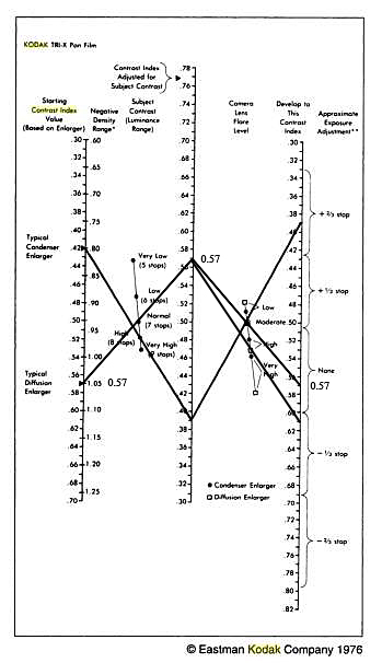

Actually I was referencing the nomograph on p. 140 of WBM. There is a similar version of it on p. 66 of Stroebel's book "Basic photographic materials and processes" (p. 66 here) (which in turn was taken from a Kodak Publication from 1976) but the neg density ranges that nomograph lists differ from the one in WBM by quite a bit. e.g. the ISO std CI of 0.57 (in 1976) matches a neg dens range of 1.05, but in Relph's nomograh the ISO std of 0.58 matches a neg. dens. range of 1.29 (which I rounded up to 1.30 and used that in the formula I gave above.
Now why do the two nomographs differ so much ? I think it is because Ralph made a different assumption than that in the footnote (*) of p. 66 which reads "these are the typical negative density ranges that result when normal luminance range subjects (7 stops range) are exposed with moderate flare level lenses and developed to the contrast index shown in the left scale".
For now I don't understand enough to comment on the rest of your post except the last part where you write:
Basically my only comment here is to Ralph: Help me out here please !! :blink:

I'm not really directly challenging Ralph's approach. In fact, Ralph and I am in close agreement with most of the goals and conclusions. We just tend to disagree on the theory. I have a lot of respect for Ralph and there isn't anything I'm saying here that we haven't already discussed. What I am attempting to do is what you yourself have admitted. I wish to convey the importance of understanding the material to the point so you can come to your own informed conclusions. Approaching any material with a good amount of informed skepticism is just good methodology and it will help avoid the risk of dogma. My advice is to always ask yourself "why" and follow where it leads.
Actually I was referencing the nomograph on p. 140 of WBM. There is a similar version of it on p. 66 of Stroebel's book "Basic photographic materials and processes" (p. 66 here) (which in turn was taken from a Kodak Publication from 1976) but the neg density ranges that nomograph lists differ from the one in WBM by quite a bit. e.g. the ISO std CI of 0.57 (in 1976) matches a neg dens range of 1.05, but in Ralph's nomograh the ISO std of 0.58 matches a neg. dens. range of 1.29 (which I rounded up to 1.30 and used that in the formula I gave above.
I've attached three nomographs. One is from Ralph's Way Beyond Monochrome. One is from Basic Materials and Processes. And one from Materials and Processes.
Here's my perspective on the three aims for a negative under normal conditions intended to be printed on a diffusion enlarger. There is no difference between them. That being said, I admit that it wouldn’t be very hard to come to the conclusion that they represent very different models, but once we take a closer look and break down the variables, they are virtually identical.
First, I do need to make a small correction in your interpretation of the negative density range that matches 0.58 or the 0.57 that is used as the aim avgGradient in the WBM monograph. I’ve drawn a line through the average conditions to the point that is labeled “Typical Diffusion Enlarger“. As you can see it has 1.20 as the negative density range for an avgGradient of 0.57. So, we need to adjust your 1.30 down to 1.20.
Let’s take a look at the variables (they are also in the attached word document):
WBM - NDR = 1.20, LSLR = 2.1 (7 stops), Starting CI = 0.57, Required CI = 0.57
Kodak - NDR = 1.05, LSLR = 2.1 (7 stops), Starting CI = 0.57, Required CI = 0.57
M&P - NDR = 1.05, LSLR = 2.2 (7 1/3 stops), Starting CI = NA, Required CI = 0.58
The biggest difference is between the aim NDR of WBM and the other two.
Let’s take a look at how the variables work together. The equation to determine gradient is Rise / Run. Or the Output (NDR) divided by the Input (log-H as it relates to the LSLR). (This can also be viewed in the word document.)
WBM: 1.2 / 2.1 = 0.57
Kodak: 1.05 / 2.1 = 0.50
M&P: 1.05 / 2.2 = 0.477
Since the Kodak and M&P numbers don’t equal the aim gradient, there can only be two possible conclusions. They are either wrong or there’s a variable missing. If you look at the bottom of the M&P monograph, it reads “corrected for average flare conditions.” Flare has been incorporated into the M&P monograph, but is missing from the above equation. We can also assume the Kodak monograph has also corrected for average flare. The WBM monograph works as is. Does this mean it hasn’t been corrected for average flare?
Equation incorporating flare: NDR / (LSLR – Flare) = CI (average gradient)
To find the value of flare: (CI*LSLR – NDR) / CI = Flare
WBM: (.57 * 2.1 - 1.20) / .57 = 0
Kodak: (.57 * 2.1 – 1.05 ) / .57 = 0.26 or ~ ¾ stop flare
M&P: (.58 * 2.2 – 1.05) / 0.58 = 0.40 or 1 1/3 stop flare
As you can see with the Kodak monograph, if you start on the left at 0.57 and move through 7 stops luminance range to the middle scale at 0.57. Then if you draw a line through moderate flare, the final CI is at 0.57. If you repeat all the steps except draw the line through the high flare (box), the final CI needed to process the film to is 0.61. It’s exactly the same with the WBM monograph, but there is a small difference.
With the Kodak monograph and the M&P monograph, the scales have been “zeroed” out for normal flare although flare remains as part of the equation in determining the average gradient. With the WBM monograph, flare appears to have been eliminated from the “normal” 7 stop conditions. This is the only way to have identical values for the LSLR and CI variables while having a different NDR value. The WBM monograph works just as well as Kodak’s with determining the beginning and ending CI (avgGradient). The only difference is a question of the aim negative density range.
Can the different values just represent different preferences for the negative density range? That would make sense except it wouldn’t balance the equation. If the preference is for a negative density range of 1.20 with a luminance range of 7 stops that included flare, the final CI would have to be different than 0.57. For a one stop flare factor, the projected CI would have be 0.67 for the equation to work with a 1.20 NDR. If you have the same CI, luminance range, and flare, you can’t have different resulting negative density ranges, so the difference in the NDR can’t be attributed to NDR preferences.
No matter the assumption for the normal luminance range or the assumption for the amount of flare, if the film is developed to the same CI, the negative density range for a given scene will be the same. The M&P uses a 2.2 log luminance range, but it uses a higher flare factor, so the CI is basically the same as Kodak’s with a 2.1 log luminance range and a smaller flare value. I can argue that 2.2 is statistically more accurate as is the flare and Kodak only used 2.1 because it’s a nice round number and by doing so they had to fudge the value of flare in order to make the CI conform with reality. But no matter the reason, as long as the film has the same CI value, the results will be the same whether the luminance range is 2.2 with .40 flare or 2.1 with .30 flare. The end results are the same even though conceptually and theoretically one is more correct.
How the WBM NDR works depends on how you look at it. And this answer also answers how the Zone System can have an aim NDR of 1.25, while the WBM can have an aim NDR of 1.20, while (lack of a better term) the sensitometric aim NDR can be at 1.05 and all have almost identical aim CIs.
It’s all about how the data is interpreted. The Zone System uses a camera to make the test and the goal is to produce two points of density representing the end points for a seven stop exposure range: 0.10 over Fb+f and 1.35 over Fb+f. With this data, we can determine the aim CI or gradient: 1.25 / 2.1 = 0.59. What most people don’t realize is that while the test is shot with a camera, there is almost no flare using the single tone subject and the point where the exposure is made on the film curve (you are really just under and over exposing the mid-tone exposure). As not flare is involved, the aim NDR has to be made artificially higher in order to balance the equation and produce the necessary CI.
1.25 / 2.1 = 0.59 is really the same as 1.05 / (2.1 - .32) = 0.59. One calculation incorporates the flare factor with a realistic NDR and one has a NDR that doesn’t factor in flare. The concept becomes even clearer working with film curves. The proper way to produce a film curve is to contact the step tablet. This forms a non flare curve. If you have a curve with a CI of 0.59 and you measure a 2.1 log-H range from 0.10, the resulting negative density range would be 1.25. Since we know all scenes contain flare, the effective log-H range isn't measured at 2.1 but 2.1 minus the flare value. Both methods will indicate a negative processed to the same CI, so the results are identical. You can think of this as the difference between the sensitometric exposure or the non flare contacted step tablet exposure and the photographic exposure or the exposure that represents the variables encountered when shooting.
Zone System: 1.25 / 2.10 = 0.57
WBM: 1.20 / 2.10 = 0.57
Sensitometric: 1.05 / (2.2 - .40) = 0.58
With the variance of flare in shooting conditions, the small difference in aim CI values between the three methods is inconsequential.
Therefore, there is no difference between the results of these three systems as there really is no real difference between the three nomographs; however, there is a difference conceptually. The Zone System and WBM NDR values are derived from interpreting results from the film curve with out incorporating flare to the subject luminance range. While all three methods will produce identical CIs, conceptually only one is technically correct (what is “correct” is a whole different post).
By understanding the “whys” of the variables, you are in control of the process and not the other way around. Don’t forget to keep this in mind when using the Film Speed and Development Test spreadsheet.
  • Nomograph comparison.doc

Hi Stephen,
well after your lengthy treatment of this I think I have come full circle. I'm sure I initially interpreted you correctly when I thought you were encouraging me to strongly consider contact printing the step wedge rather than doing the in-camera, low flare option I last described. Now I'm convinced you're saying it doesn't matter which method I use as long as I understand the theory sufficiently to properly interpret and apply the results.
I also thought you were indirectly challenging Ralph's method by asking "How is this possible": however in your last post you then finally managed to explain how it is possible without invalidating Ralph's method.
(You wrote:"Ralph likes to use a negative density range of 1.20 for normal. His normal CI (average gradient) is also 0.58. As both aim Contrast Indexes are identical, that means that any scene photographed and developed to a CI of 0.58 is going to be the same on the negative. How is this possible with different aim negative density ranges")
So with my new ultra low flare setup I intend on repeating my tests, hopefully this weekend.
First, I do need to make a small correction in your interpretation of the negative density range that matches 0.58 or the 0.57 that is used as the aim avgGradient in the WBM monograph. I’ve drawn a line through the average conditions to the point that is labeled “Typical Diffusion Enlarger“. As you can see it has 1.20 as the negative density range for an avgGradient of 0.57. So, we need to adjust your 1.30 down to 1.20..
I did make a typo, but not the one you corrected ! I actually meant to write
"in Ralph's nomograh the ISO std of 0.615 (not 0.58) matches a neg. dens. range of 1.29 (which I rounded up to 1.30)" you can see this is where the ISO Standard arrow is pointing on the far LHS of WBM's nomograph you attached.
Its way past my bedtime now !

Test results - take 2
After my first attempt to conduct this film test (where there was way too much flare in my test setup) I have now repeated and remeasured the 5 negatives and filled out the spreadsheet again.
In summary I think I have decent results. I have some questions about the toe area of the film. Contrary to my first effort where for some reason I didn't give the step wedge sufficient exposure and ended up with a long toe and low Dmax, this time time I have barely any toe present !! [1]
My plan now is to replace some of the points say from 28-32 with a toe interpolated between one more reading at D=3.8 (see below) (I will also need to space out the y-axis values over that region too (because the default step is 0.1 and I will need it to be about 0.2).
I think this points to a flaw in the spreadsheet as it assumes you have sufficient toe present in the data.
Anyway, any comments on my plan and spreadsheet would be appreciated.
thanks
Peter
[1] This lack of toe is despite me bracketing from a nominal exposure by metering the mid grey step to 3 stops below. I also 'nominally' rated the HP5+ at 200ASA. If I had rated it at 400ASA and bracketed +/- 1 stop I would prob. have sufficient toe. Fortunately I also included an X-rite cal step wedge which has its darkest step at D=3.8 (the Stouffer 3 only goes to D=3.05). That permitted me to get ONE point in the toe region and I can then interpolate/guess the others between 3.05-3.8

It does look like you've over exposed the step tablet, although it looks like you got results good enough to work with. I am a little concerned about the second Fb+f reading if I am correct in assuming that your Fb+f readings are 0.16, 0.13, 0.16, 0.19, 0.20? Film base plus fog doesn't decrease with increased processing, and the drop is too big to just be attributed to densitometer accuracy. As the next step (31) appears to be consistent with the data from the other test wedges it probably isn't operator error either. The 0.03 density drop for the Fb+f could be pointing to an error in the testing procedure. Don't discount the possibility that it might not be the one with the error. If there is a problem, perhaps it is with the other tests.
PeterB
Apr 3, 2005
644
Sydney, Aust
Thanks for looking Stephen. All is OK with the FB+F reading as I didn't make it sufficiently clear. The FB+F readings are stored as comments in the xls spreadsheet in cells G41 to K41. (those comments aren't visible on the screen capture, but in the actual xls file). They are 0.11, 0.12, 0.14, 0.15 and 0.14. all readings have a tolerance of +/- 0.01 so I am happy they are monotonically increasing after taking into account the tolerance.
The density values you read off were from cells G42 to K42 and are in fact those for the darkest step on the X-rite tablet (D=3.80) which I exposed alongside the 31 step Stouffer tablet. The value I entered into cell G42 is actually out of place and is understandably confusing (just ignore it if you can't understand what I've done after reading the rest of this). It results from a discontinuity of 2 stops as explained further on. The reason the film developed for 8 minutes has a higher measured density for all its steps including the one at cell G42 is because I was forced to read the entire set of values off a neg frame exposed 2 stops higher (1/15s rather than the nominal 1/60s I used for the remaining films) and then shift everything by two stops along the Y axis (vertical Transmission Density axis). This happened because one of the 5 films was ruined during the development as I tapped the tank to release the air bubbles the lid popped off and let stray light in to fog most of it ! I managed to recover from that scenario by cutting another roll in half and developing one half for 8 mins and the other half for some other time. I had filled all rolls by bracketing with 4 shots and the nominal exposure I chose to use in the spreadsheet (1/60s) ended up on one half of the cut roll not the other, so I had to use the 1/15s and compensate by shifting the y-axis values by 2 stops = 0.6 density units. I had to guess/interpolate some of the numbers because this method meant I was missing values for steps 26-31. Additionally the value of 0.16 in G41 was actually for step ((38.5-2x0.3)=32.5) not step 31 so the shifted value in G41 is slightly lower than what it really was, but for the sake of not upsetting the automated curve fitting equations Ralph set up I shaved a bit off it. It was the only point I compromised on from a data integrity point of view and could easily be explained by the fact that the ratio of my two shutter speeds (1/15)/(1/60) wasn't exactly 2.
Given the 8 min graph looks well placed compared to the others in the Family of Curves then I am happy my recovery steps were successful.
