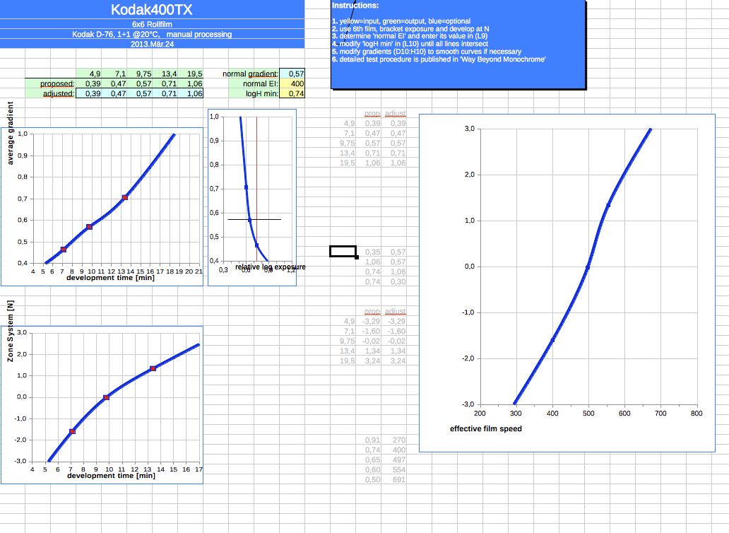

Hi,
i have now finished my tests.. finally after determining the EI (ISO320) I adjust die logH min until that the development intersect with the Development-Time...
In my Case ISO320 must be N Development.... Is this approach okay ?

Looking at the Effective Film Speed graph, it looks like to me that the line reaches 0.0 at EI 500 for "N".
my fault. i dont change the logH min to 0,64 in my case.

Hi,
Hi,
I'm trying to understand better film test based on WBM. If you do not mind I have few questions.
You said that your EI = ISO 320 but in attached file in cell L9 you have 400.
in pdf description to WBM test regarding graph av. gradient vs relative log exposure I found that:
"..In the upper right-hand graph (fig.7c), the average gradient
is plotted against relative log exposure. A black horizontal
line marks the chosen normal average gradient. A red vertical
line marks the corresponding relative log exposure. Its position
is unfortunately not automatic. Estimate the relative
log exposure required for the red and black line to intersect
the curve, and enter that value into cell ‘L10’."..
Like I understand we should modify value in cell L10 until red and black line intersect with each other and the curve. Is that correct?
In attached file they do not intersect with the curve. You wrote later that you corrected log min to 0.64 - I'm assuming to make them intersect?, did you modify your EI as well or yours is 400?

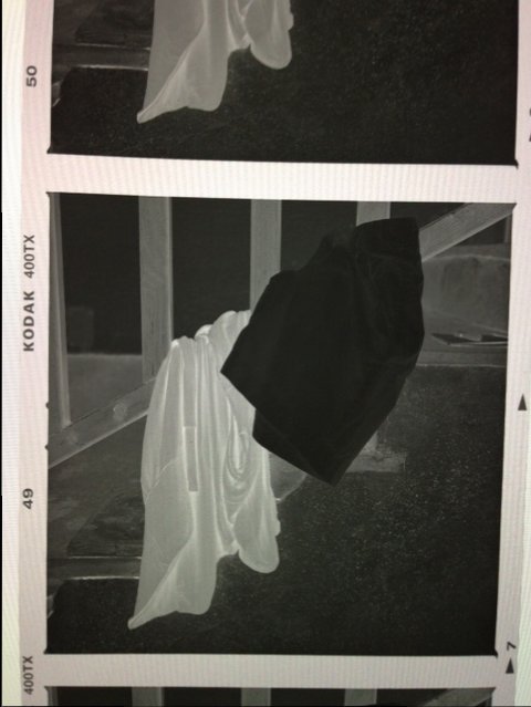

so i did the retest on a white and a black shirt.
i setup the iso speed for the 400tx, put the shirt on zone 3 and take photos changing the aperture half steps ( 80mm cfe).
a full stop lower than the recommended film speed i get the black shirt with 0,37 and the white with about 1,27 :smile:
thank you all for your help
Michael, would you mind posting the image from the shirt test?

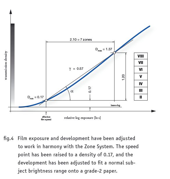

I'm sorry for being off the current topic but I have a questions regarding film test based on WBM in general. I tried to read all threads about the subject but still a few aspect of the method are not clear for me.
I'm referring to the method described in the WBM 2nd edition pages 214 - 224 and pdf document + xls spreadsheet ( Dead Link Removed Film test procedure)

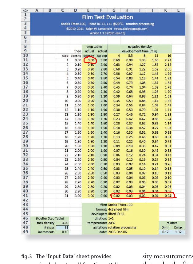

1. Exposure
I'm using 31 steps stouffer transmission projection step wedge, size like 120 film
Photographing step wedge using window, light table or slide copier (I'm aware about flare issue etc)
What would be the best way to measure correct exposure? Cameras I'm using do not have built in light meter. Take a reading from diffused "light source" (window, light table, slide copier) without step wedge and use it as exposure? Should it be adjusted or use exact light meter reading? or maybe take a reading with step wedge in place - which part of the step wedge should be used to read exposure (120 size step wedge is quite small)?
2. Densitometer (how to read densities for development time tests and effective film speed test)
In pdf document I found on page 4:
"My densitometer has a calibration
button to ‘zero’ out the measurements,
because it does not have an internal light
source of known intensity for transmission
density readings. In other words, it
can be used with different light sources
and allows for relative and absolute density
measurements. If your equipment has a similar feature,
then take the first reading with nothing in the light path,
push the ‘zero’ button, and then, continue to take all the
measurements.
This will enable you to measure the ‘base+fog’
density of the test negatives. If you ‘zero’ the measurements
to a blank piece of the film before taking any readings,
then all base+fog densities are equalized, and you would
be unaware of any fog increase due to development time.
but on the same page there is a Fig. 3 (please see attached) where densities for test negatives starts from 0.02, 0.03 therefore (in my opinion) could not be measured with densitometer zero out with nothing in the light path.
Also on the page 4. (pdf) there is a Fig. 4 (attached) which shows D min = 0.17 - is it 0.17 above base + Fog? Should densitometer be zero out on base + Fog or with nothing in the light path to correctly read film speed test?
Should I zero out densitometer with nothing in the light path or on film base (in case of step wedge on step 1 ?) ?
thank you
Tomasz
a full stop lower than the recommended film speed i get the black shirt with 0,37 and the white witZone System Placement copy.jpgh about 1,27 :smile:

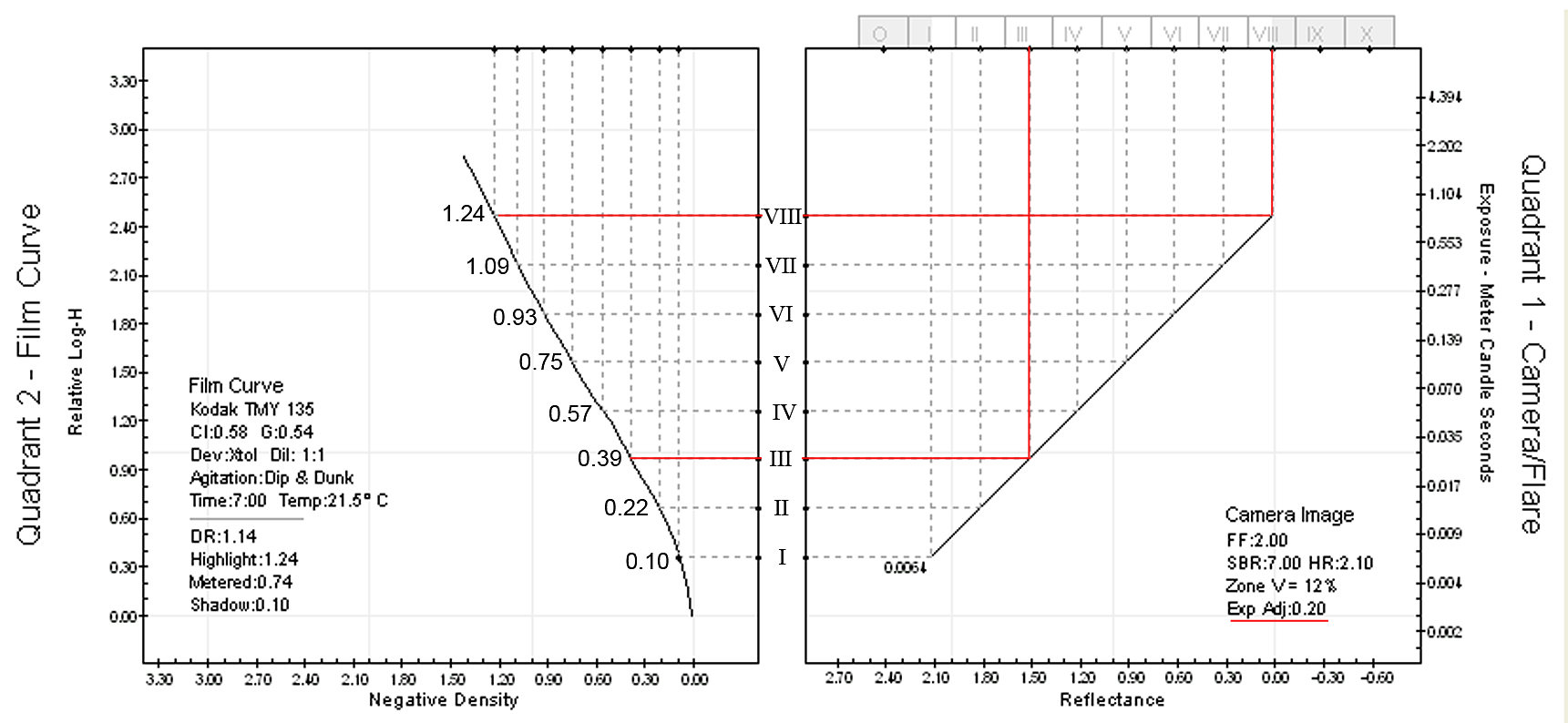

Michael, now that you've achieved your goal. I'm going to show you why it's wrong. Not that you can't make quality prints with what you have, or that I'm suggesting changing anything you're doing. It's just that what you think is happening, isn't. What your test shows is not about film speed, but about testing procedures.
The first two quadrant curve represents pretty much what you are observing. The film is processed to a CI 0.58. Zone I is placed at 0.10 over Fb+f. Zone III has a density of 0.39 and Zone VIII has a density of 1.24.

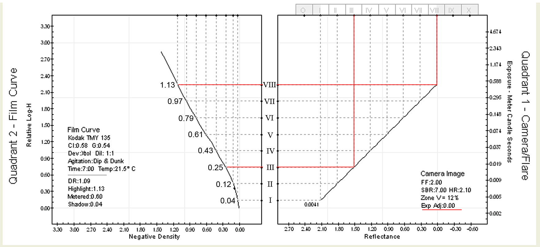

But you might have noticed that in order for Zone I to fall at 0.10, the exposure had to be increased by 2/3 stop. This is why Zone System EIs usually are tested at 1/2 the ISO. What would happen if the exposure wasn't adjusted?
This looks a little like your first field test. Take off another 1/3 stop of exposure and the results are almost identical. In effect, these two examples graphically illustrate your two tests. So, why doesn't the shadow exposure fall at the speed point when testing at the ISO speed?
