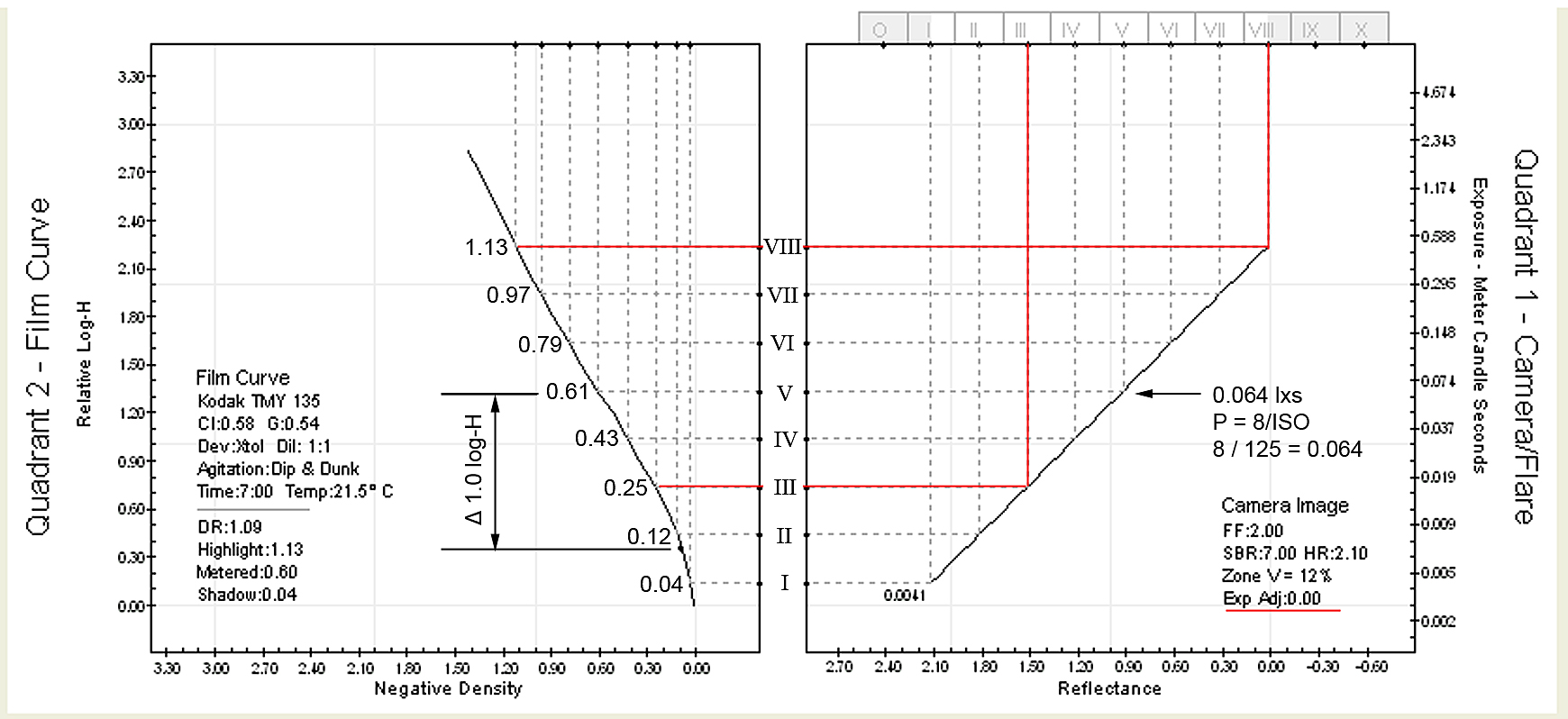

I've added a few things to one of the two quad examples from post #201. This example has it's exposure based on the ISO. Zone V represents the metered exposure. As the example shows, the equation of metered exposure is 8 / ISO and the example uses a 125 speed film so the metered exposure is 0.064 lxs. Speed point falls Δ 1.0 log-H units below at 0.8/ISO or 0.8 / 125 = 0.0064 lxs. So in this example, the exposure was perfect for a film that has an ISO of 125. Zone I falls below the speed point at 0.0041 lxs.
For something that is impossible that was pretty easy. :whistling:
markbarendt
May 18, 2008
9,422
Beaverton, OR
It's a specific example and not universally applicable. View attachment 66743
I realize that its a special case but only because you are using ISO speed point as the reference point.
Your example provides an interesting problem for the ISO standard, "how do I get it to describe what my mid-tones will do in a print?" In a simplified sense, it can't, the question the ISO standard and other shadow point methods answer is just "what the reasonable lower limit?" We still have to figure out how the rest of the film behaves.
If the "print reference point" is the "metering point" and that was simply a density of .4 or .45, something appropriate, we might talk about film characteristics differently. TX might still get a 400 rating and TXP might get 200, so what, .4 may very well be a better predictor of print results.

I do realize that. Still the example provides a pretty stark difference. Wonder how Delta X would change that graph?
As the fractional gradient / Delta-X speeds don't change as quickly with development as the fixed density speeds (which aren't supposed to be used beyond the ISO parameters), the overall negative density will tend to increase and decrease in comparison to the fixed density negatives. This is one of the primary arguments against the idea of the just black printing approach for anything other than normally processed negatives.
How will Delta-X change the example? It wouldn't. The ISO standard uses Delta-X Criterion. That's why the US agreed to the change.
Apart from the greater tendency of what Jones calls "first choice prints" is more likely under certain printing conditions, I can't see a problem attempting to peg a certain density at a certain point on the curve. As long as the photographer has customized it to their materials and personal preference. A specific target negative density; however, shouldn't be considered universally applicable. Take the two quad example. What makes it a correct exposure for the ISO is not the negative density at the metered exposure point, but that the metered exposure was at 8/ISO and the exposure fell at the correct ratio from the speed point.
In the scientific photography papers, phrases like "greater tendency" and "more likely" are used a lot. Most methodologies will work adequately. The question is always about the one which has better results most often. This doesn't mean that in certain situations another method will work better. Just that in most situations, one method tends to have a higher consistancy. The question of fixed density vs fractional gradient is about what is more accurate over the greatest number of situations. It's all one big normal distribution curve. Advocating one approach over another is only about what is more likely.

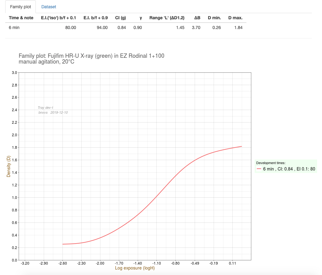

It is unfortunate that I have not seen this topic before. I made a script for myself for building curves (R Shiny). I also posted his sources on github.
If anyone has an interest in developing such a program, I ask you to join to this project. I would be grateful for any advice and comments, since for me the R language is a rather new discovery and I have not mastered it quite well at the moment. But the prospect in my opinion is very good.
So, this is working script: https://bnxvs.shinyapps.io/cc_film_plot/
Github source: https://github.com/bnxvs/cc_film_plotter

Can you post a screen shot of a sample dataset. I don't have any sample data that fits the source template at this time to try it.
