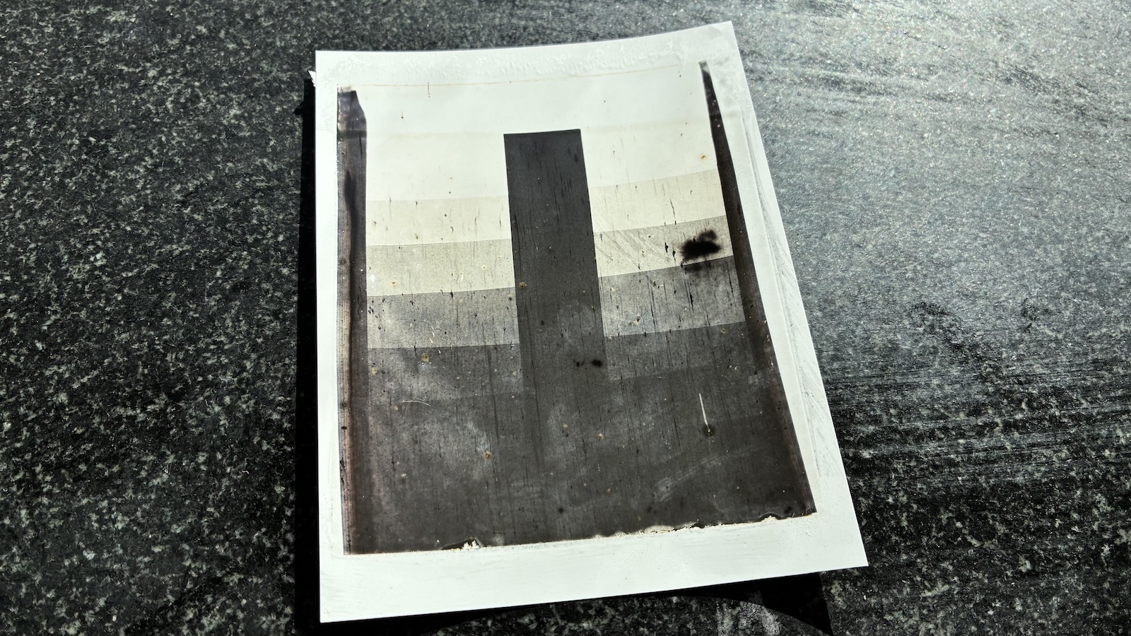

My first run at coating positives, success! Obviously there's a ton of room for improvement but I'm ecstatic either way.
This is a silica + Nickel Acetate/Sodium Sulfide/Zinc Acetate recipe, and then 2% gum arabic on top of that as a "stripping layer". My first attempt without the Gum Arabic caused the silica layer to delaminate. You can see a couple of places in this photo where it did that a tiny bit, near the face and left side of the photo.
The developer is my "type 2", which I never actually wrote the recipe of down. It's TBHQ-based with no superadditive developer.
The negative was a spare Polaroid 8x10 b&w negative I had on hand (640 iso). It was processed using the Polaroid 8x10 processor.

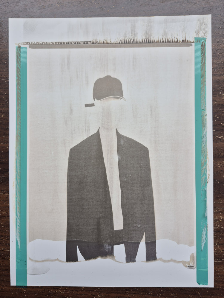

I finally measured the shutter speed of the Copal shutter in my camera, took some exposure measurements, and did some calculations: a sensible EI for the Fuji HR-U is about 1000 with the developer I last posted - if that's of interest to anyone.
The silica takes 24-48 hours fully to harden. I have found that after that time it's almost impossible to remove the silica layer even if you wanted to.

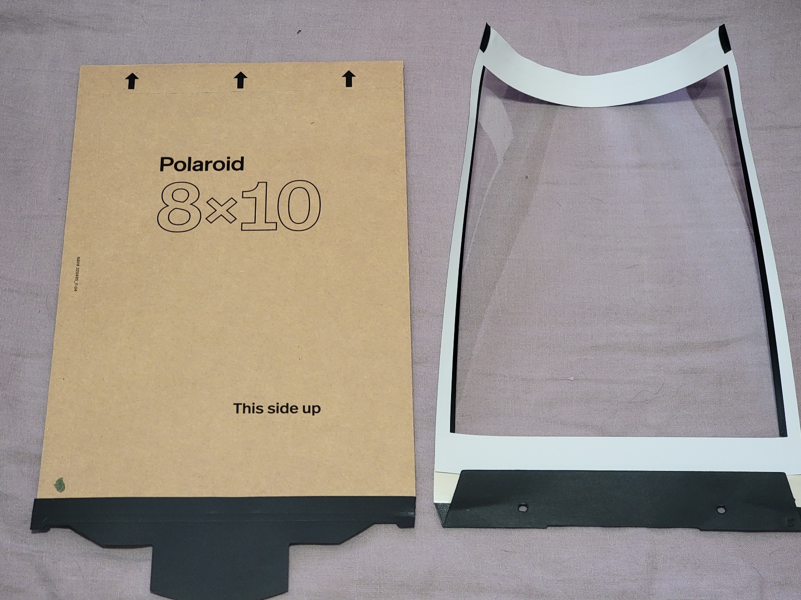

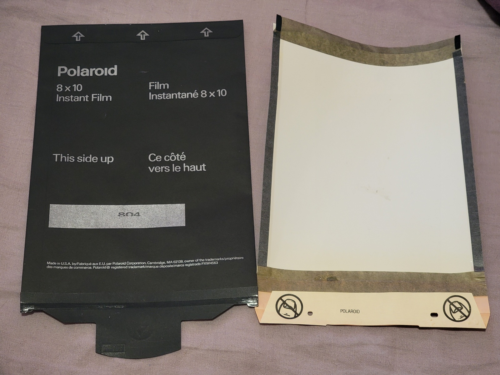

The new Polaroid company actually does still make 8x10: https://www.polaroid.com/en_us/film/8x10-film
It's an integral film, yes, but it's still designed to be compatible with the 8x10 holder and processor of old.
Original (Type 804) peel-apart, and modern B&W integral (brown envelope).

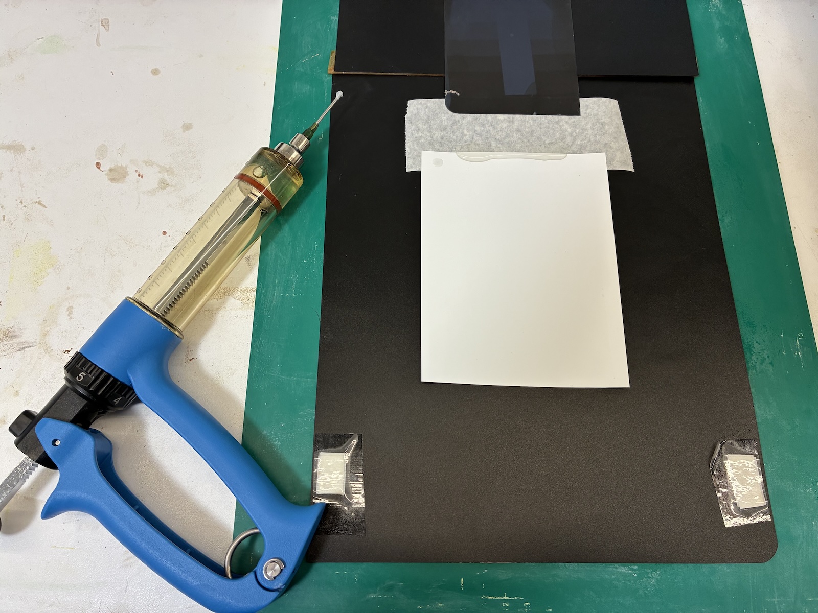

For a pouch I'm using two 8.5x11 sheets of black plastic (polypropylene, I think) sold as report covers in the binding supplies section of a stationery store. They're hinged with a strip of mylar tape. I've been using the same pouch for months now. Just wipe it clean after each print, and give it a rinse every now and then. It's also mostly light proof.
Here it is, also showing the developer in the dispenser gun (Amazon, about $50 - 1ml is perfect for a 5x4 sheet). The positive is attached to a strip of 2" masking tape, the developer is squirted in a line along the tape and the negative is stuck to the top of the tape as shown.
(Obviously this is a previous-used negative, as this photo is in white light.)
The negative is folded over, the pouch cover folded over that, and then it's run through the processor. When it comes out the excess developer is left in a puddle between the bumps which force the rollers apart as they go through (I confess I stole that idea from Polaroid.)

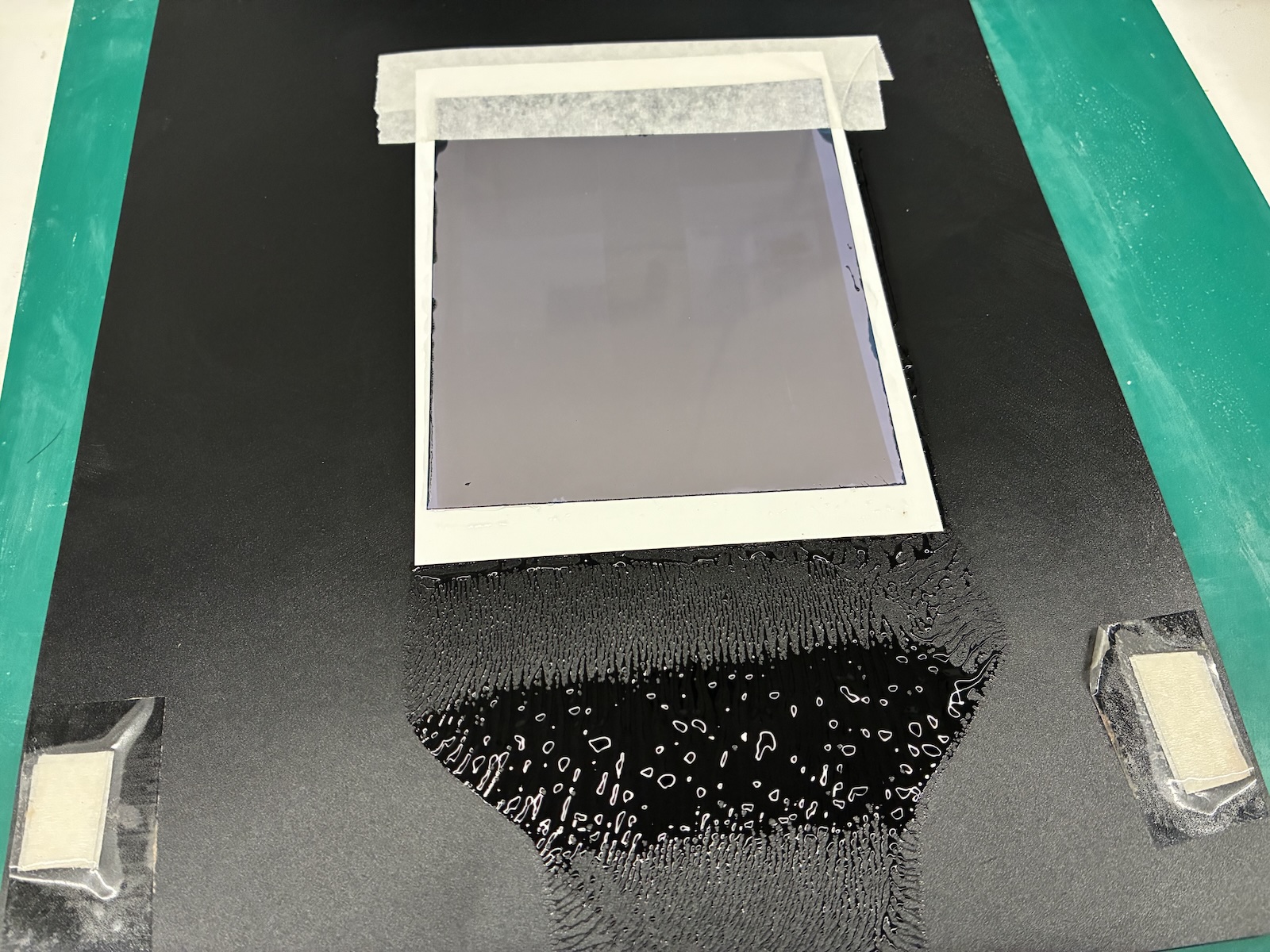

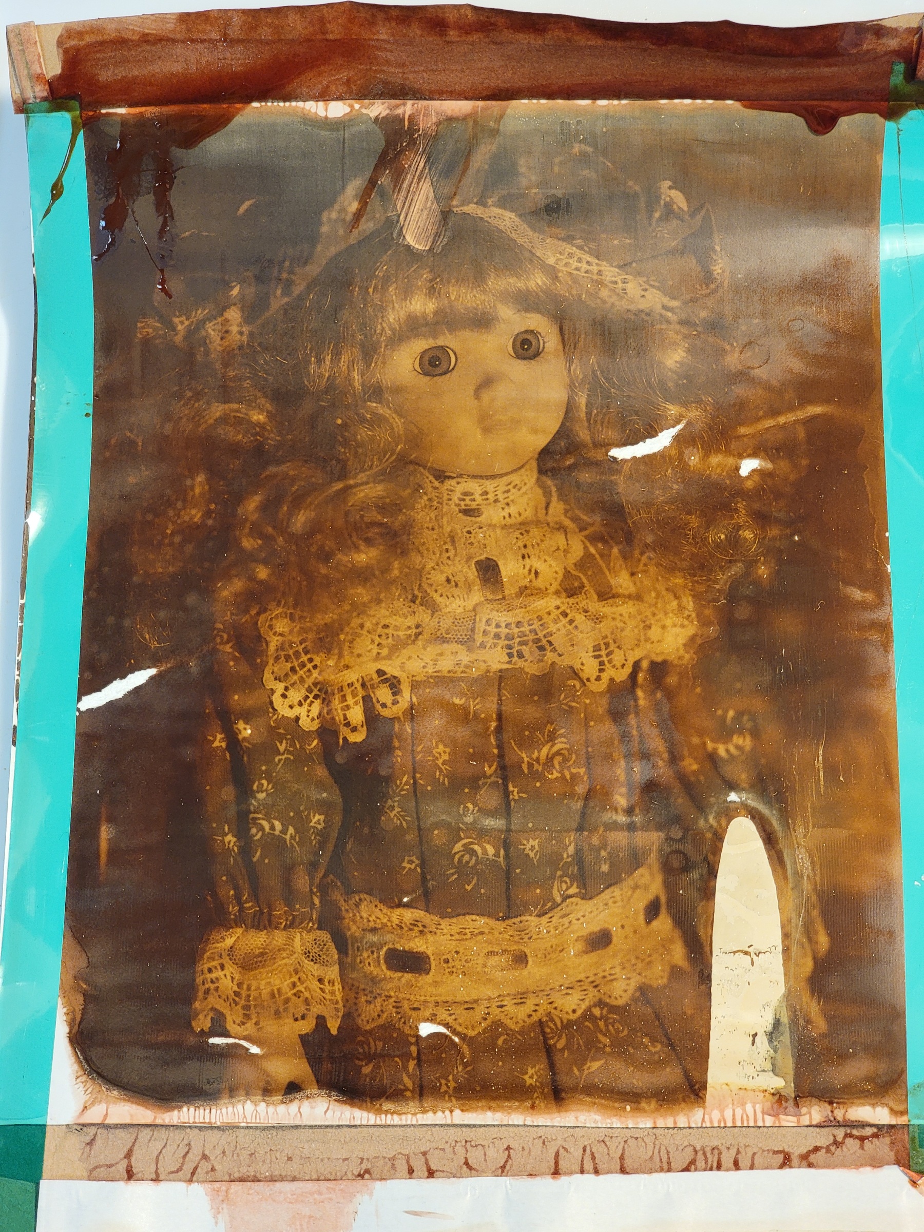

This is the result of that exact positive sheet:
What I'm seeing here is good tonality, and reasonable density. I'm chasing issues with the silica laying on the paper leading to loss of density and increased grain.

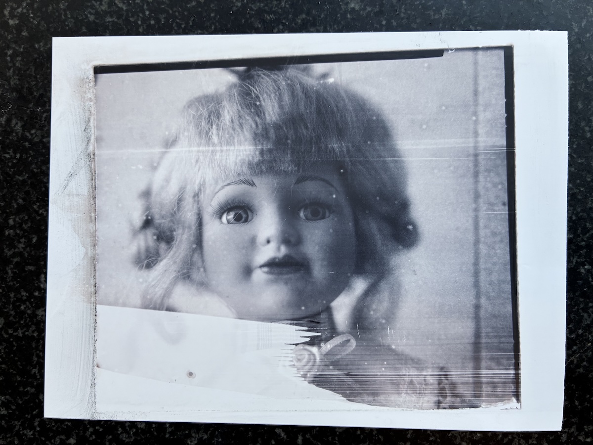

This is the best I've been able to get with the Cellulose Acetate (CA)/palladium coating, so far:
This is with Dimezone S in the developer. It appears to give a speed increase over Metol when used on CA paper, but first tests suggest a loss of density on silica.

As requested:
I'm using Multitone RC paper as my negative and Plastic paper from Yupo as my positive.
Developer:
43 grams of H20
2.8 grams of NaOH
1.75 grams of CMC
5.2 grams of Uracil
1.2 grams of AEEA
2.2 grams of DEHA
0.1 grams of Metol
Receiver Part A:
10 grams of H20
100 drops of HCl
0.02 grams of PdCl2
10 grams of H20
Receiver Part B:
20 grams of Silica
2-3 drops of 10% PVP
100 drops of Part A
0.01 grams of NaBH4
From a visual stand point, it looks like the developer is over developing where the developer sits for a few moments as I syringe it on to the positive print.
Is it exhausting by the time I start putting the negative/positive/dev. sandwhich through the processor?
