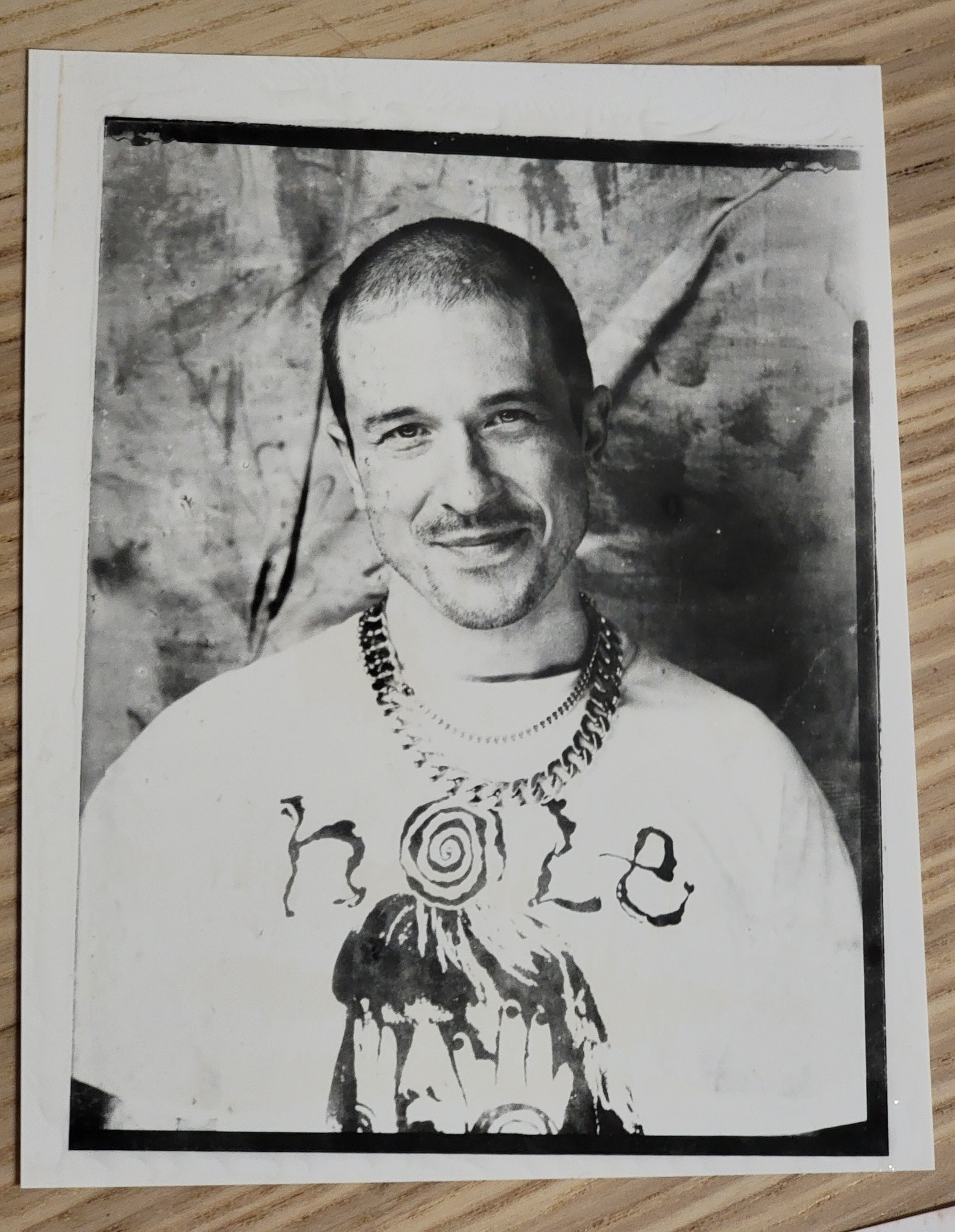

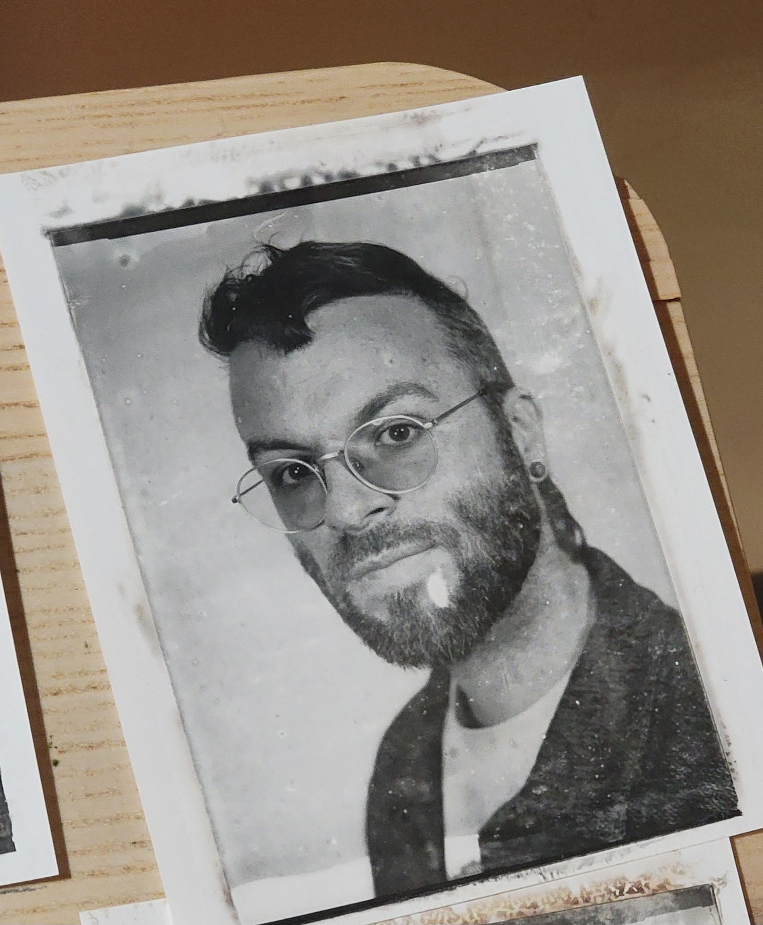

Hey,
I used two layers of I believe is 3 mil tape.
Darkest Blacks I have seen so far. Just great density.
I'm very happy!
The only downsides are that there is this yellow cast that wasn't there with Ilford Paper, and the biggest issue is that now that the rails are taller, there seems to be developer left behind.
It seems the rollers can't roll off the excess developer.
I tried wiping the print but the image smeared.
Edit: Oh, I guess I haven't tried a stripping layer, whoops!

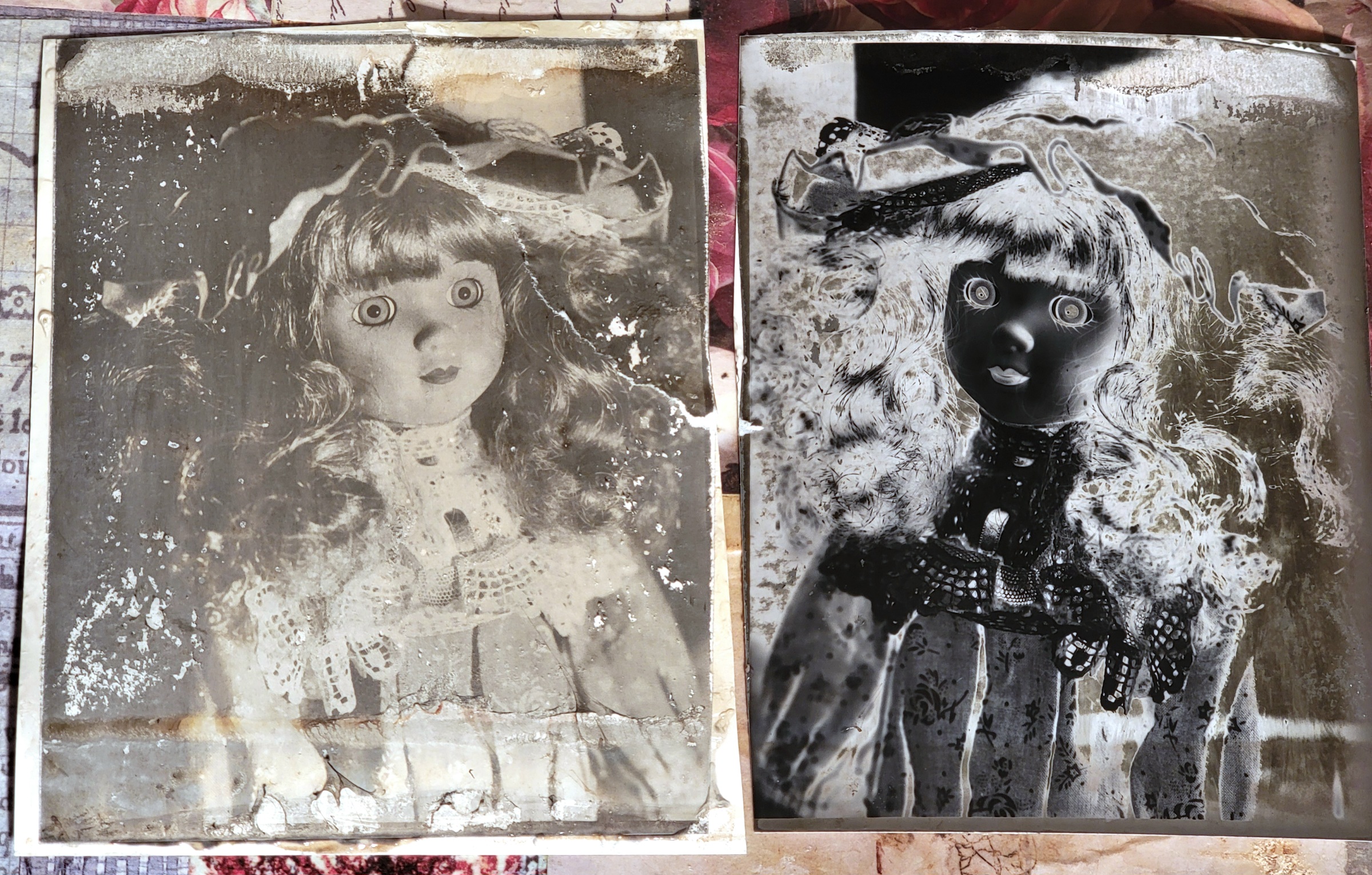

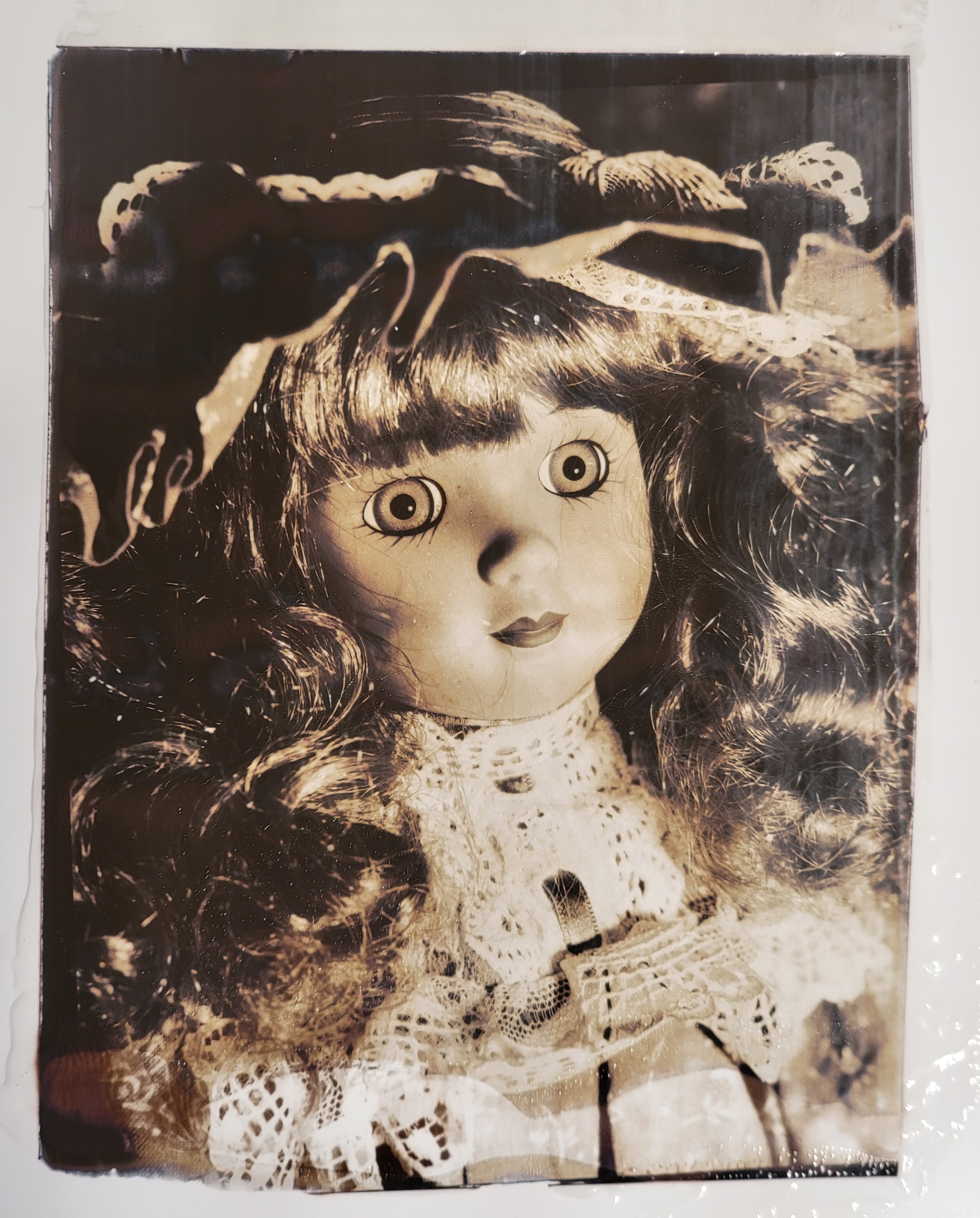

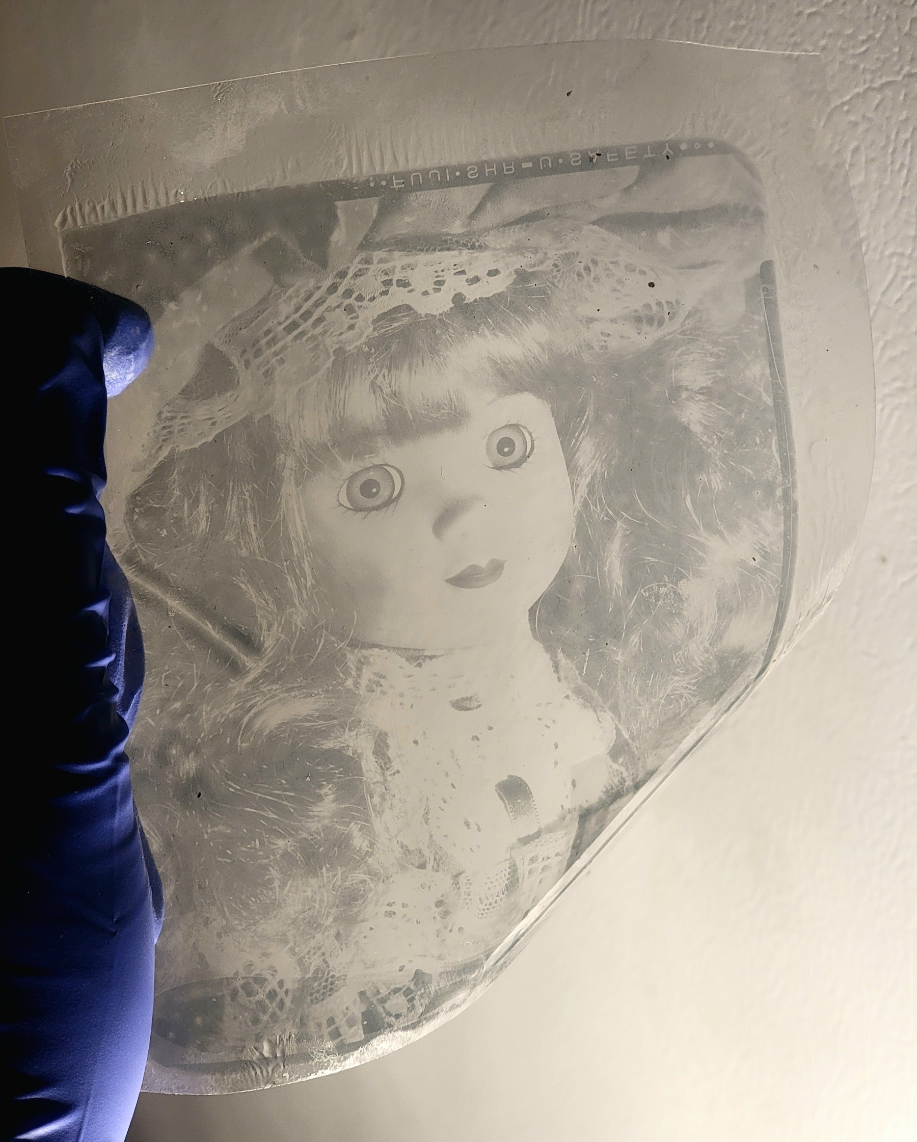

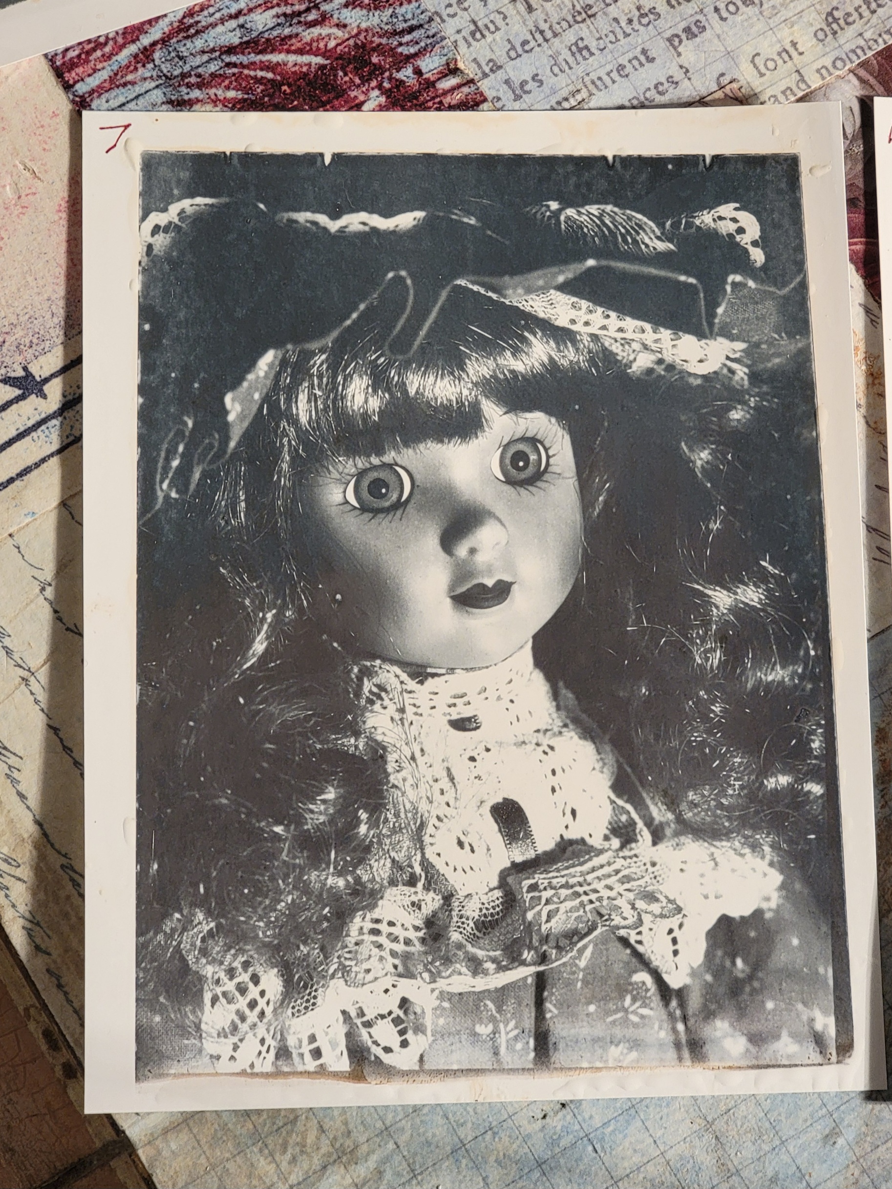

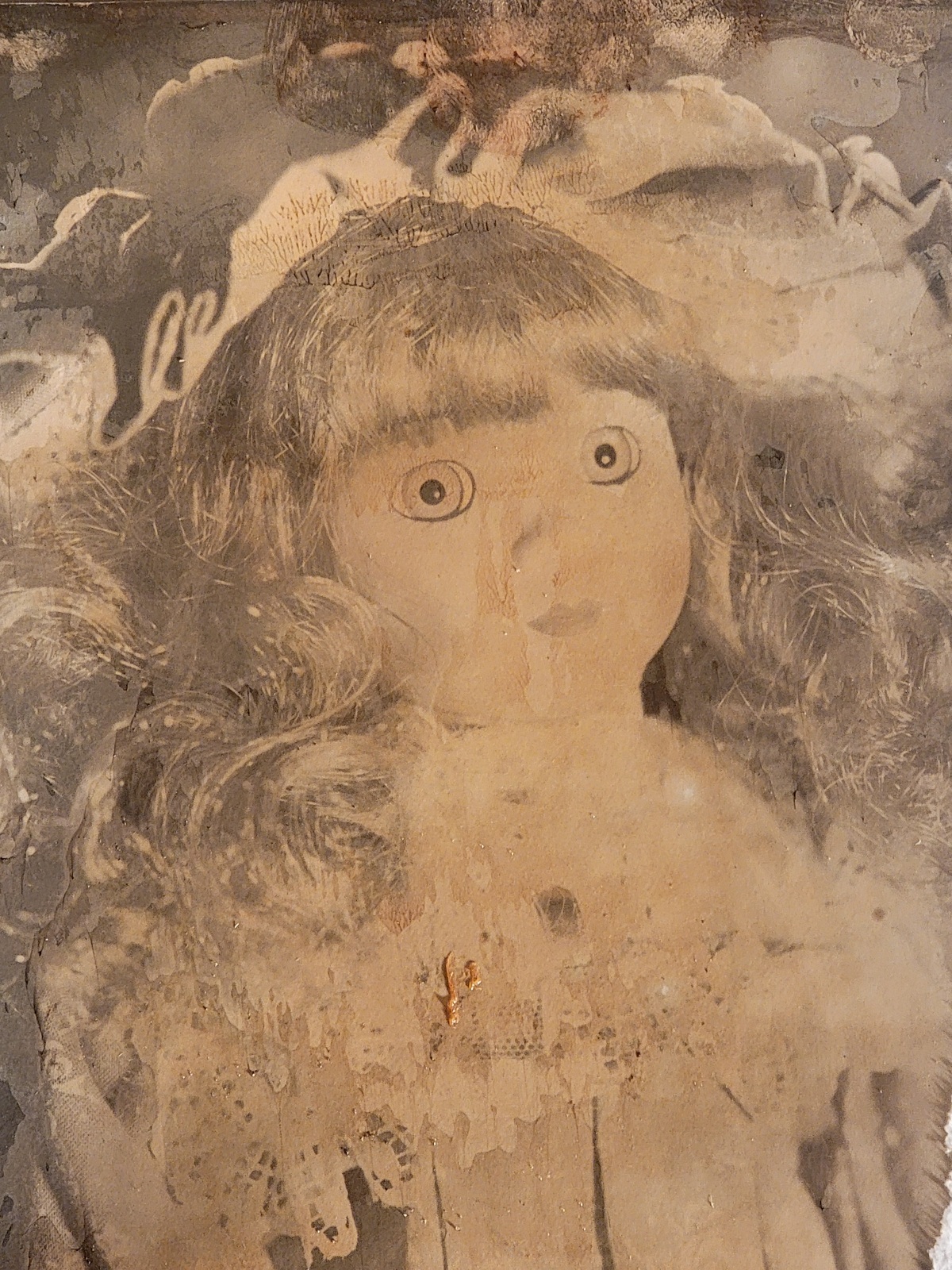

Same paper as my last couple of posts, with a new (TBHQ + Dimezone S + Uracil + AEEA) developer
Photo paper negative @ 32 iso
Same paper, another developer (DEHA + AEEA)
Negative @ 64 iso
edit: the paper uses cupric sulfide as the nucleating agent

are you using the least amount of developer possible?
Excellent progress. The tone is very good.
Thank you. I'm following your lead. It is essentially your #143, but with KOH, Dimezone S instead of Metol, and more DEHA.
whats with the weird discontinuity over the doll’s left ear? Did the paper rip? Photo paper at 64ASA is impressive too. I missed that detail.
Yes... I accidentally sat a discarded negative on top of it before I took the photo with my phone and the corner ripped off with it.

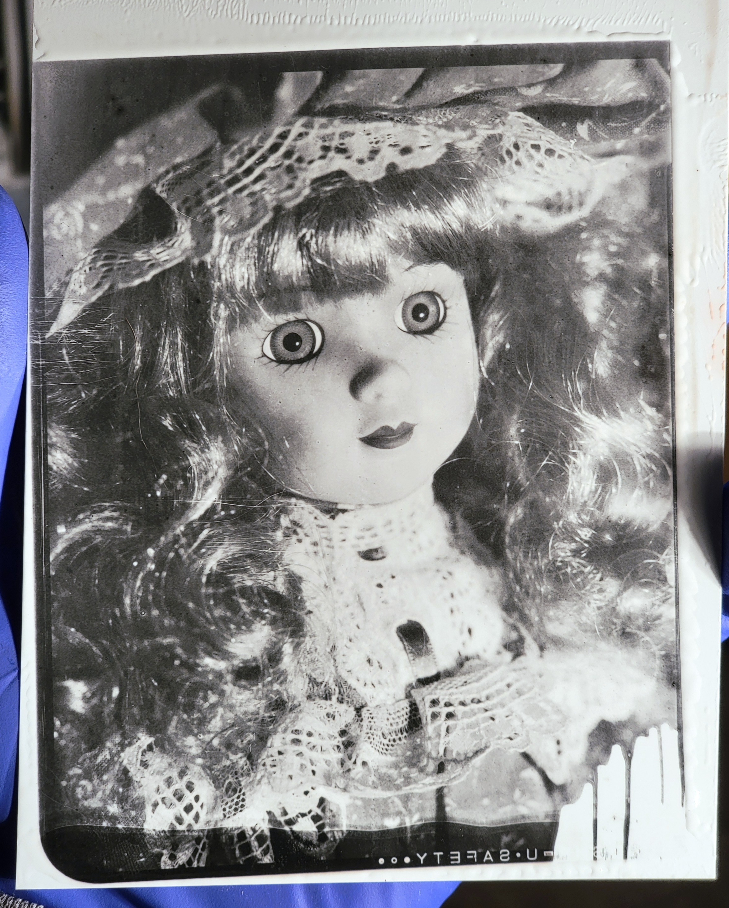

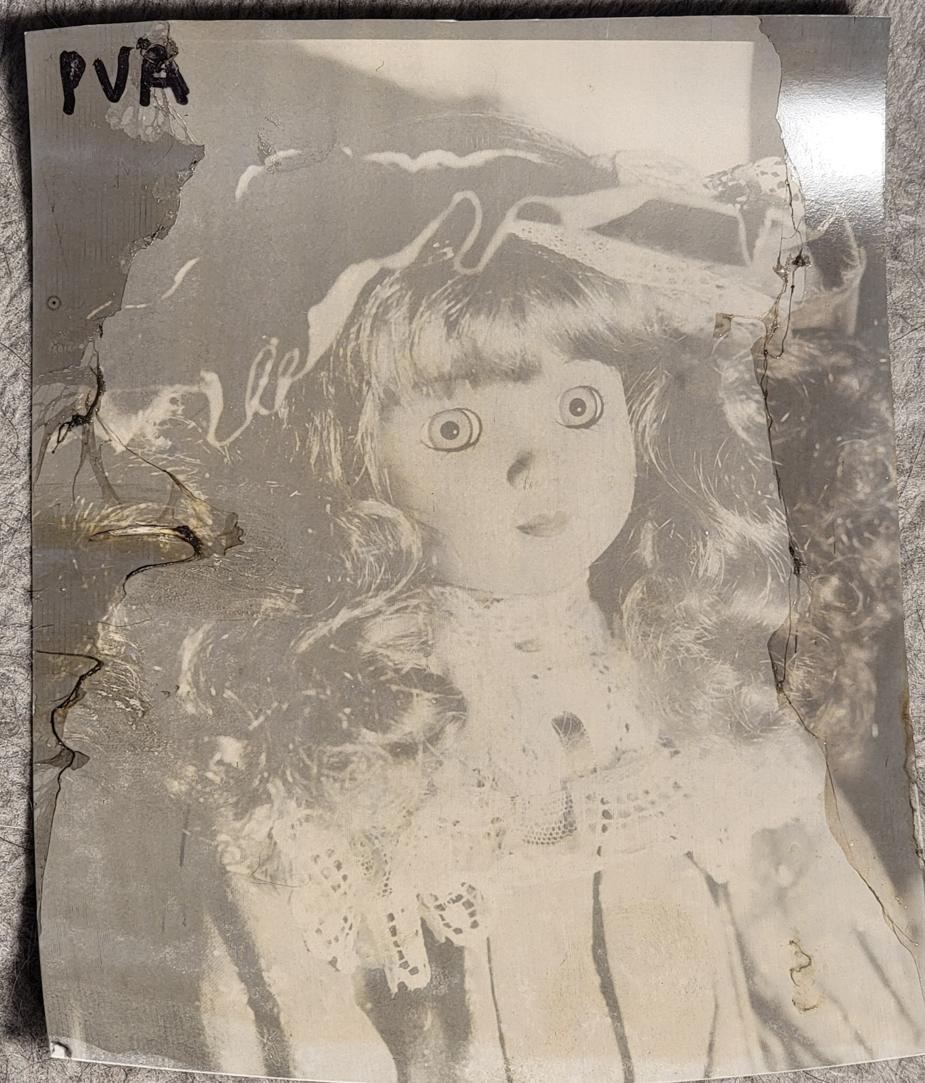

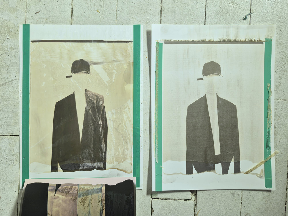

Tonight I worked a bit on stripping layers.
the PVA image is a bit overexposed, I bumped the aperture dial without realizing it.
they are labeled appropriately, both are 5% solutions of Gum Arabic or Polyvinyl Alcohol, with ~10 drops of 10% Tween 20. I coated them on the same positives as my last few posts, with a 50um bar.
These are my best results with each. I think once I practice the coating technique more they will be more successful.
I did notice that they needed to "cook" a bit longer after coming out of the laminator, compared to the paper without a stripping layer. Separation was also much easier with the stripping layer.
reminder: I'm using baryta paper, not plastic/waterproof paper. YMMV.

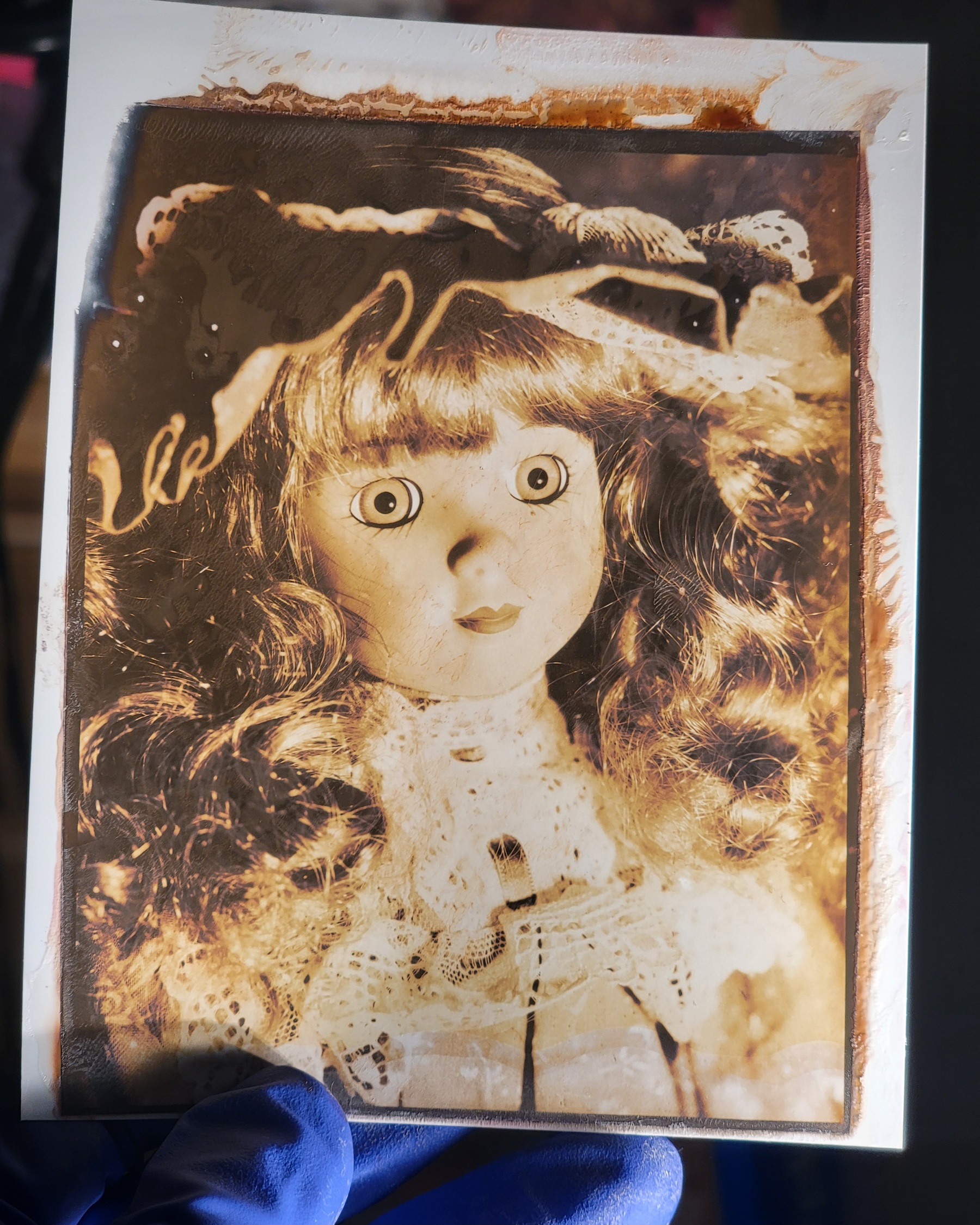

Last night I did more testing with different coater formulations, experimenting with different combinations of heavy metal salts. I stumbled upon something curious.
The above image was coated on Highh Image at 10µ with:
10mL Ludox HS-30 (colloidal silica, any should work)
1mL 1% Nickel(OAc)₂
0.5mL 1% Copper(OAc)₂
2 drops 1% Na₂S
1 drop 10% polysorbate 20
I used a DEHA/AEEA/Uracil developer. The result was unsurprising, I expected there to be some amount of yellow/sepia tonality. However:
I coated the above positive only minutes after taking the first image, using the same beaker of coating solution - but with 1-phenyl-5-mercaptotetrazole added (to the coating solution, not the developer). The amount added was miniscule, certainly in the µg range (I called it a "frog hair"). Both images used MultiTone B&W RC paper as the negative.
Mechanism-wise, the effect of 1P5MT and other mercaptans is known in the literature, but now it’s time to see how controllable it is. I'll work on upgrading my measurement system from "frog hair" to something slightly more scientific.

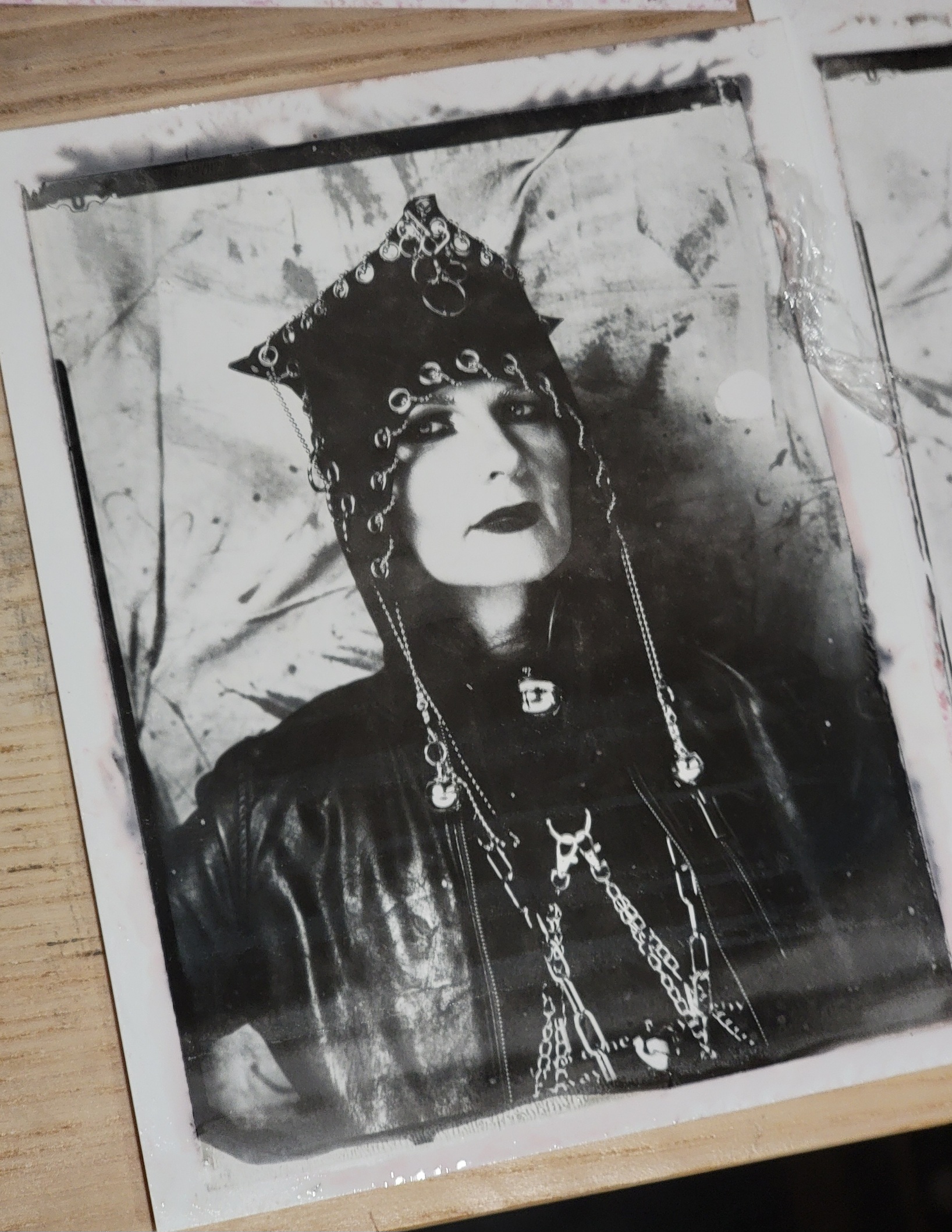

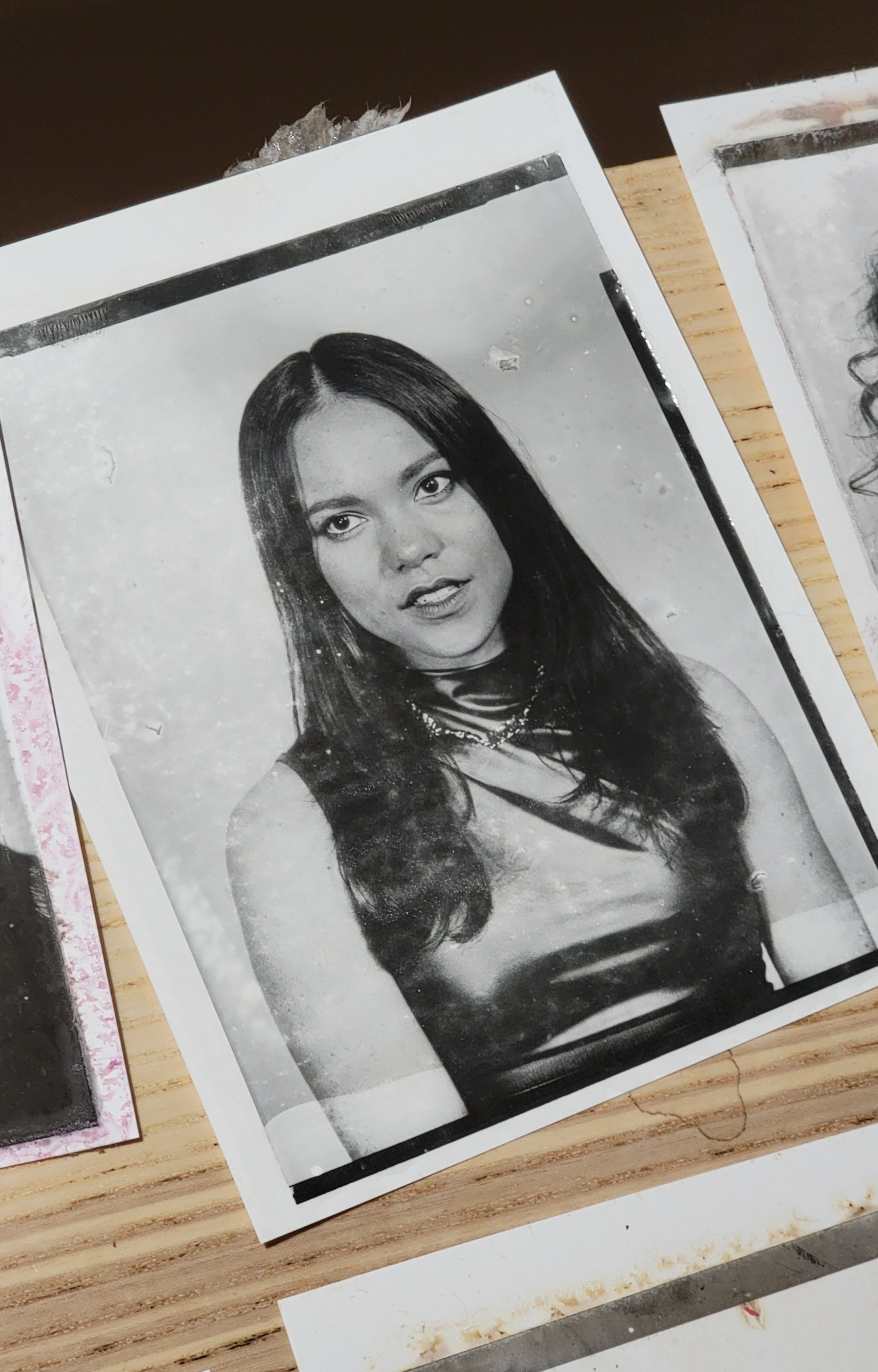

Tonight I coated paper with Palladium Sulfide. My best results so far.
I believe the mottling in the shadows might be from the MultiTone paper negative. Several people have reported mottling when printing (traditionally) with it.

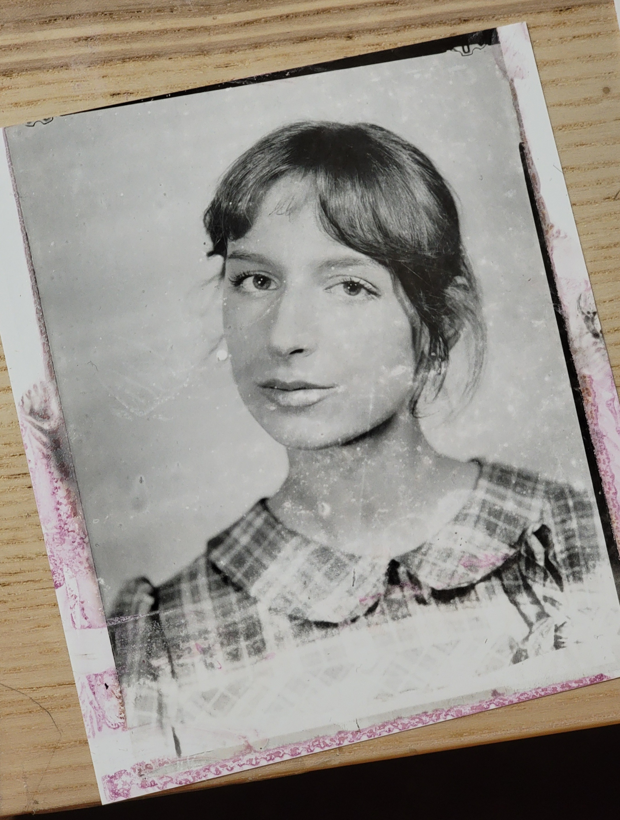

Today I finally got X-ray film (HR-U) to work well. This is using the 1P5MT paper. Extremely pleased with this result.

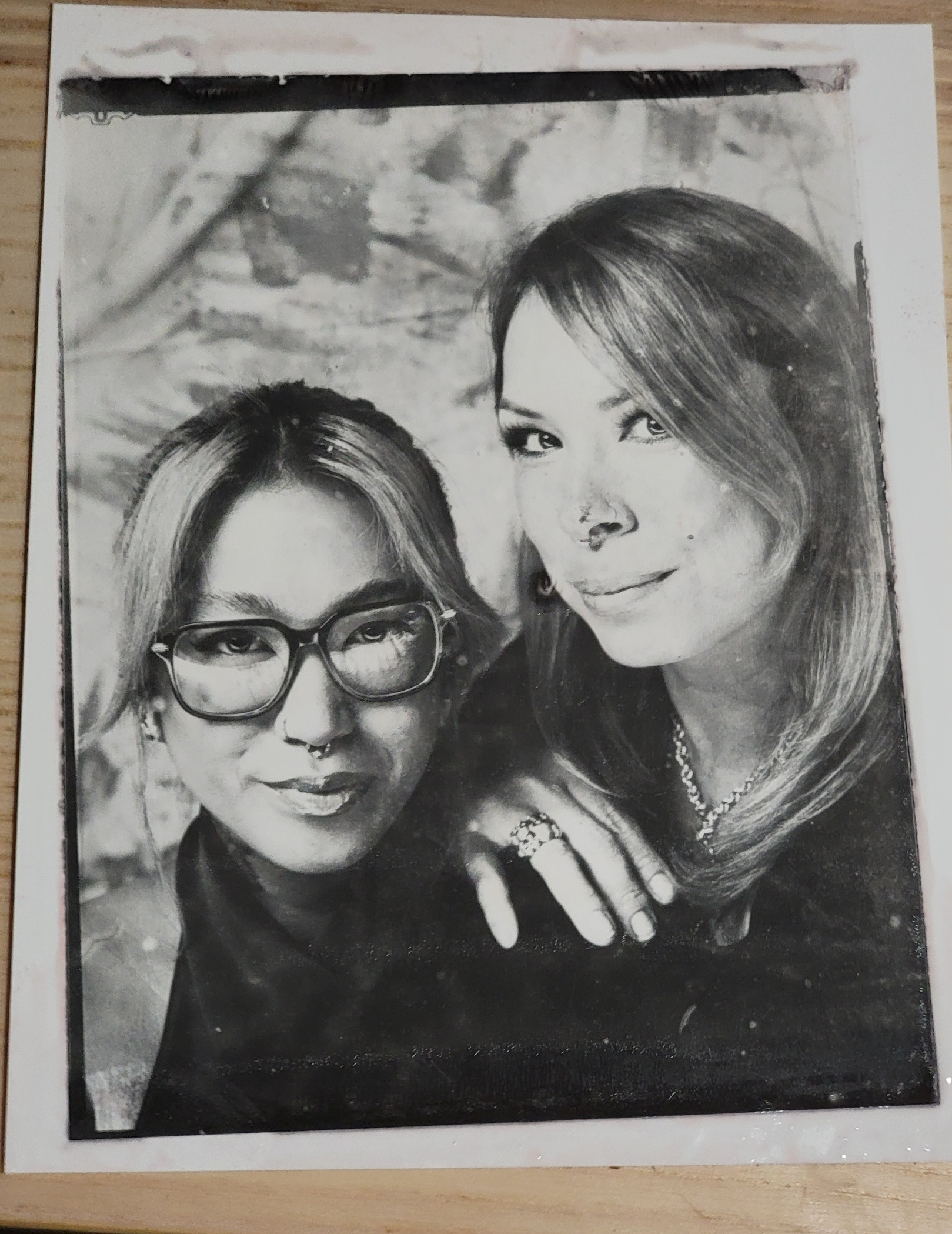

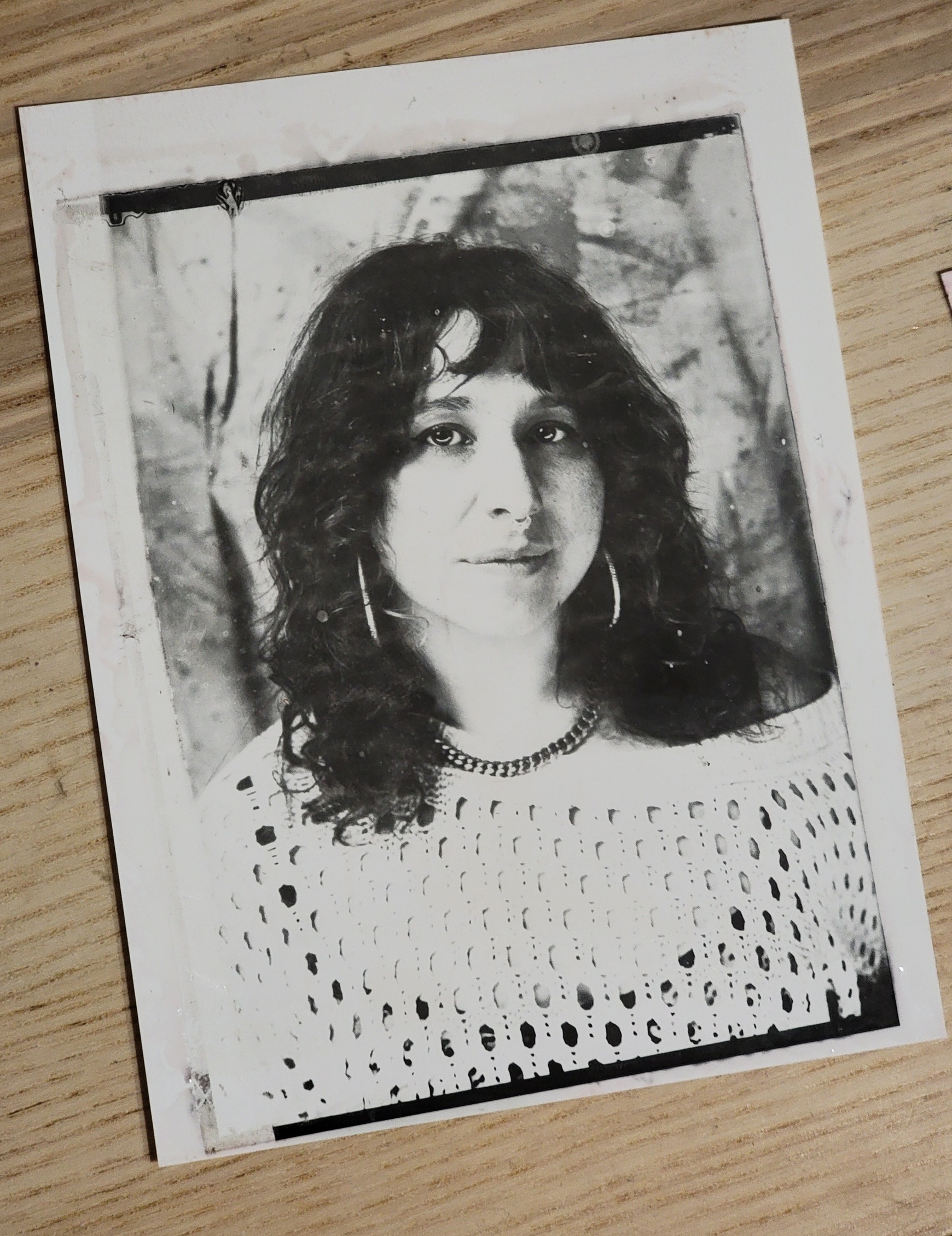

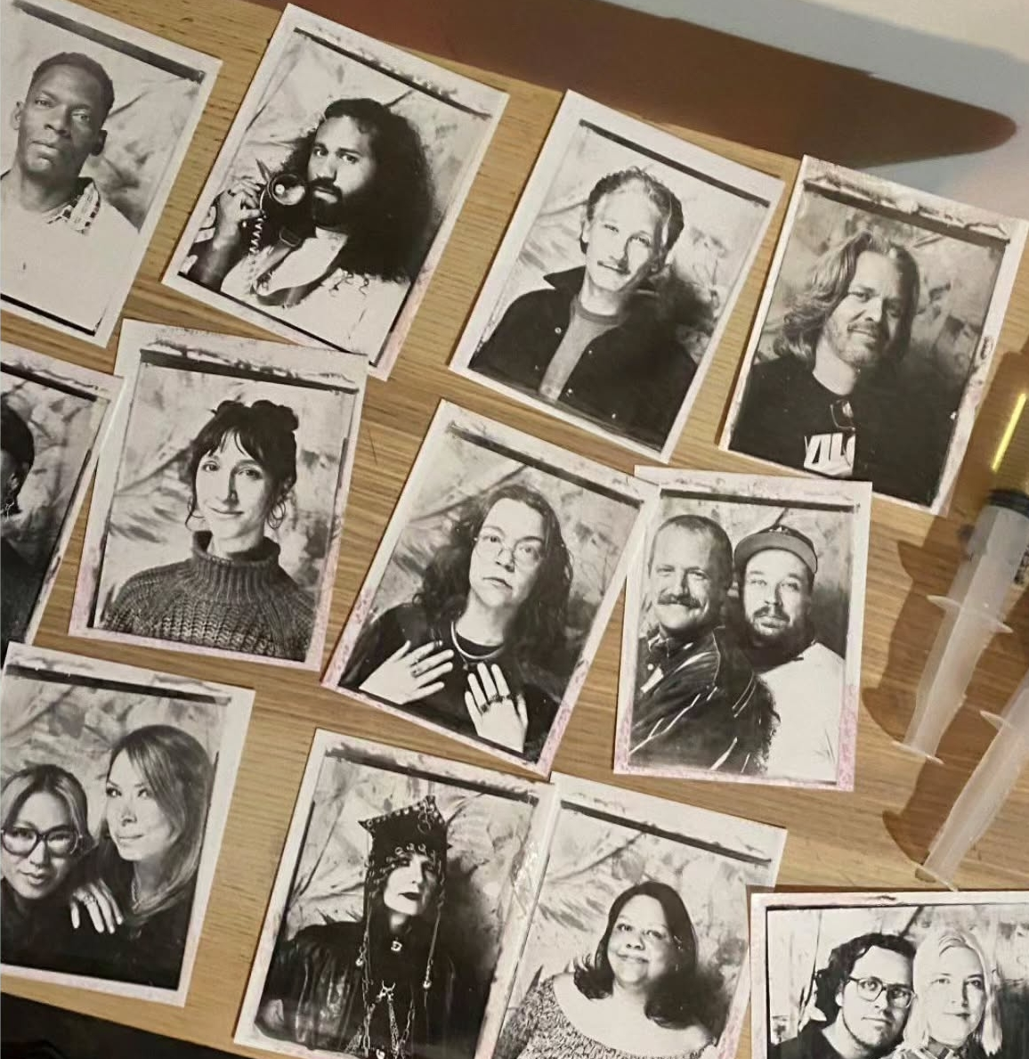

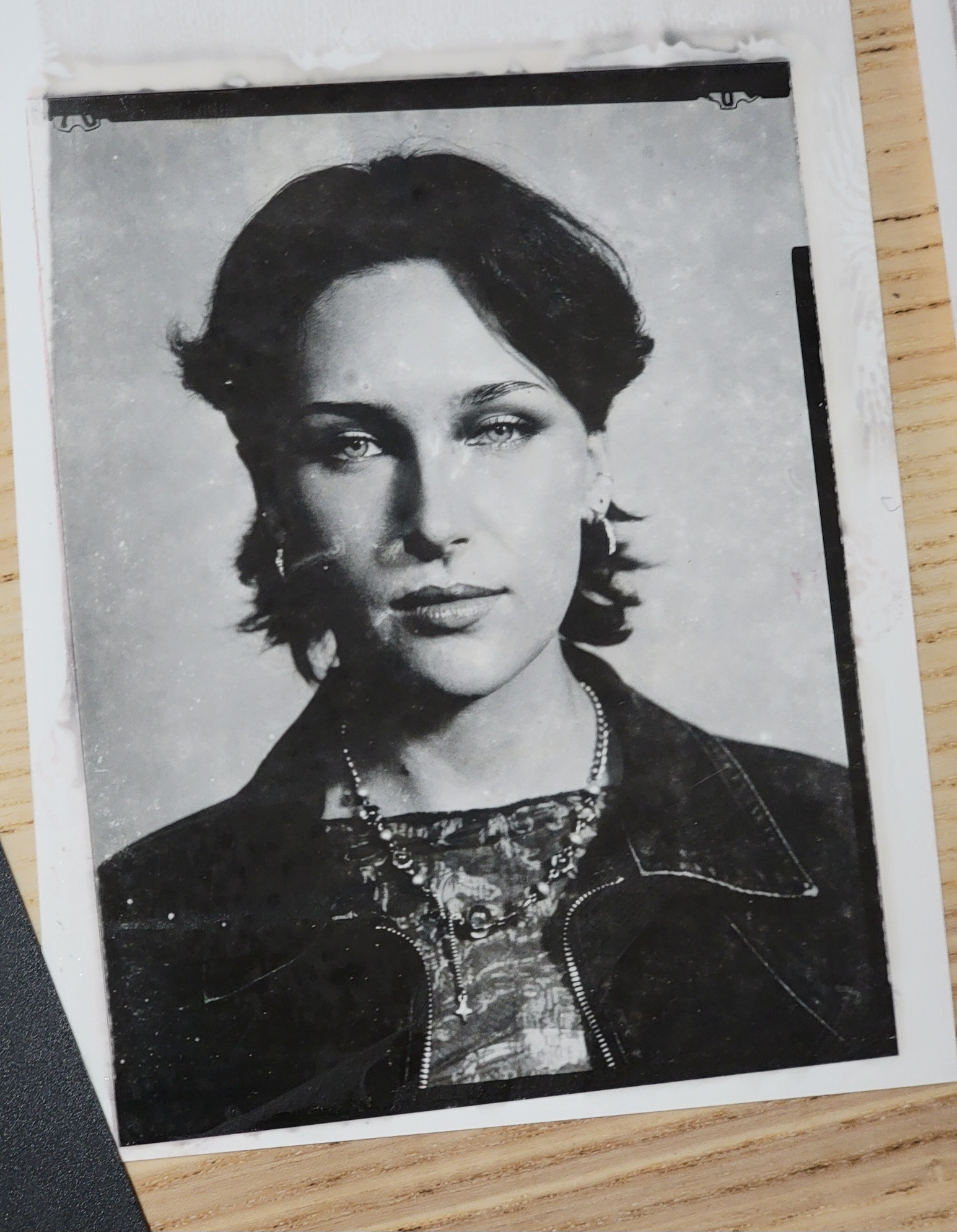

This weekend I traveled to Seattle to attend a gallery event and demonstrate this process. I shot, processed, and gave away over 100 photos. It started off iffy with no transfer for a reason I'm not sure about, but I skipped a few social outings to lock in and figure it out. I had to switch back to Ilford paper for the negatives.
Thanks to alec as always. here are some highlights, more images attached to the bottom of the post. there are certainly still kinks to work out, but the experience was incredible and I'm overall extremely pleased on how the images turned out.
