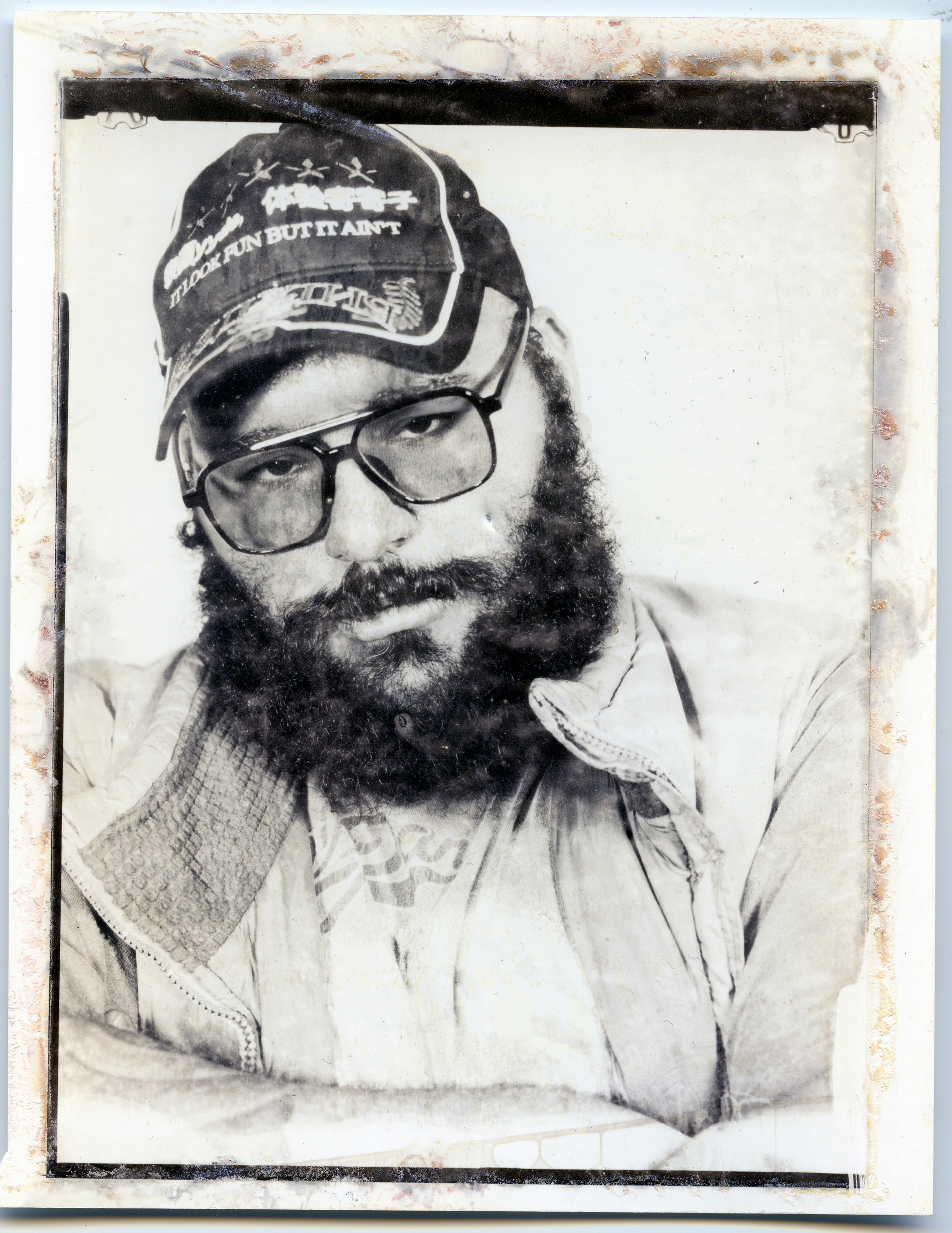

Here's a flatbed scan (Epson v850) from a friend of one of the images I took over the weekend:
No fading or color change apparent after 5 days, the print was never wiped or washed.

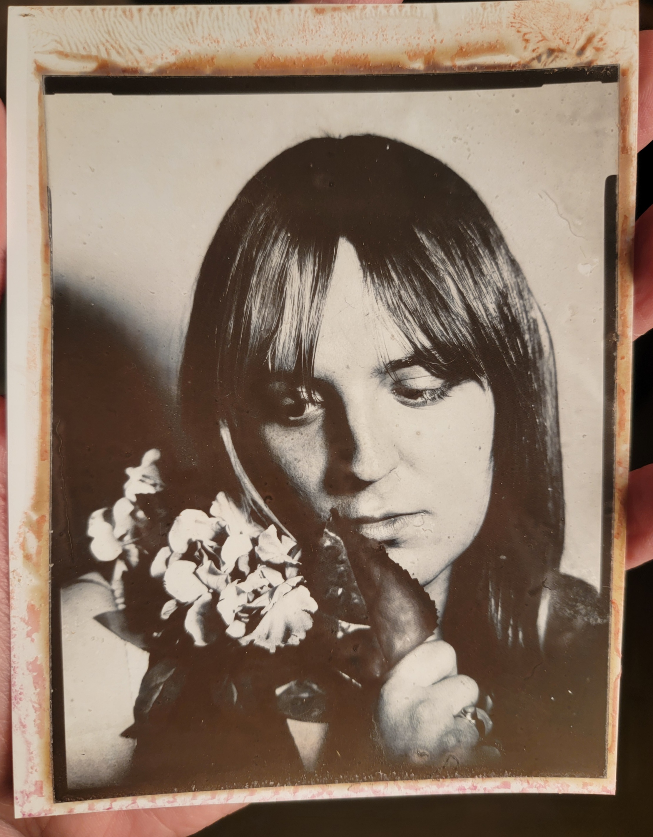

Really great image from paper I coated tonight!
Recipe for above:
10mL Ludox HS-30
500µL 1% Pb(OAc)₂
250µL 1% Ni(OAc)₂
3 drops 1% Na₂S
2 drops 10% polysorbate 20
Coat @ 10µm

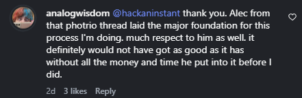

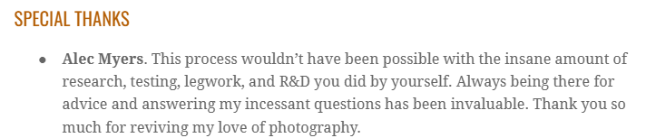

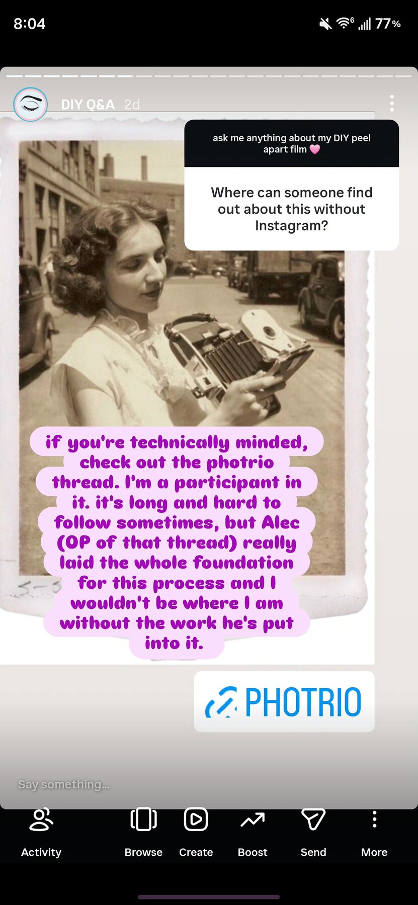

@analogwisdom -- not to really try to rain on the parade at all, but I notice you don't credit anyone else when you discuss this work on Instagram. I'm just wondering where you would be on the whole "peel-apart" resurrection without @alecrmyers ? (Note that this has nothing to do with me.)
(Edited to remove screenshots. I was mistaken and apologize.)
from instagram:
from an already written instruction document I'm providing to people that I give materials to:
from a Q&A with my followers I did on Instagram the other day, that's also currently pinned to my profile as a highlight (where it says Photrio is a link to this thread):
I'm also working on documentation that will make the info in this long and winding thread more accessible to people in the instant film community that are outside of Photrio. I am passionate about instant film and this process and I want to help make it easier for people who may be less technical than I am. Credit to Alec is already throughout the draft of those documents as well.
I resent the implication. Alec and I chat privately fairly regularly - although it has been a few weeks, but that's mostly because it's been a few weeks since I've been in the cellar to experiment. I haven't done nearly a fraction as much as Alec (who has, seriously?!) but I feel like I've been a positive contributor to this process in my own right, even if it has been small.
