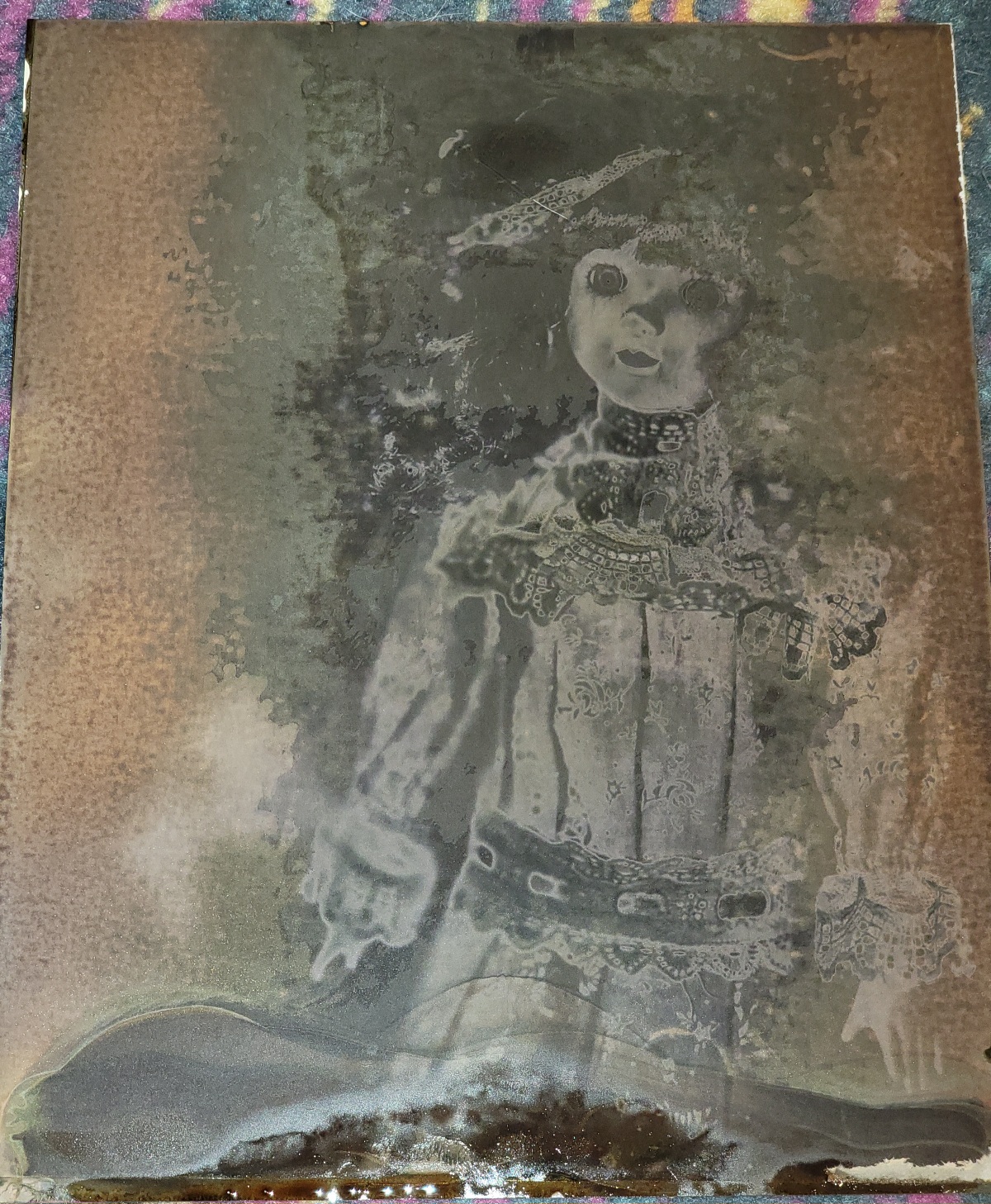

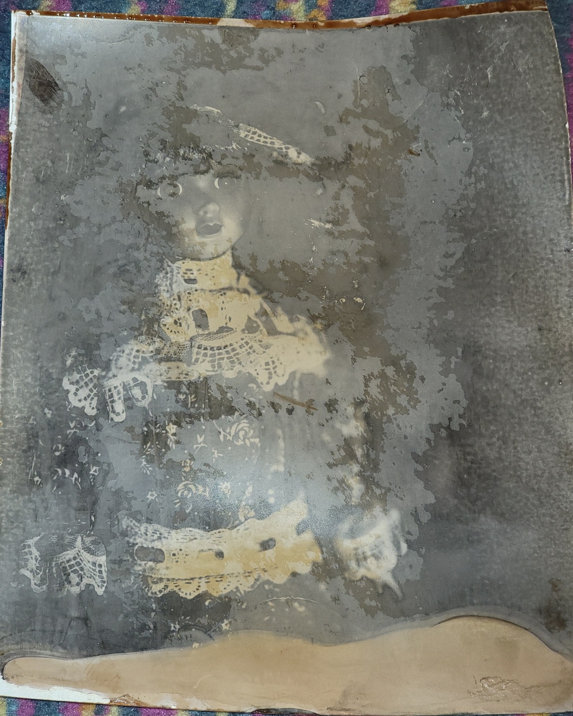

This is the best I've been able to get with the Cellulose Acetate (CA)/palladium coating, so far:
This is with Dimezone S in the developer. It appears to give a speed increase over Metol when used on CA paper, but first tests suggest a loss of density on silica.

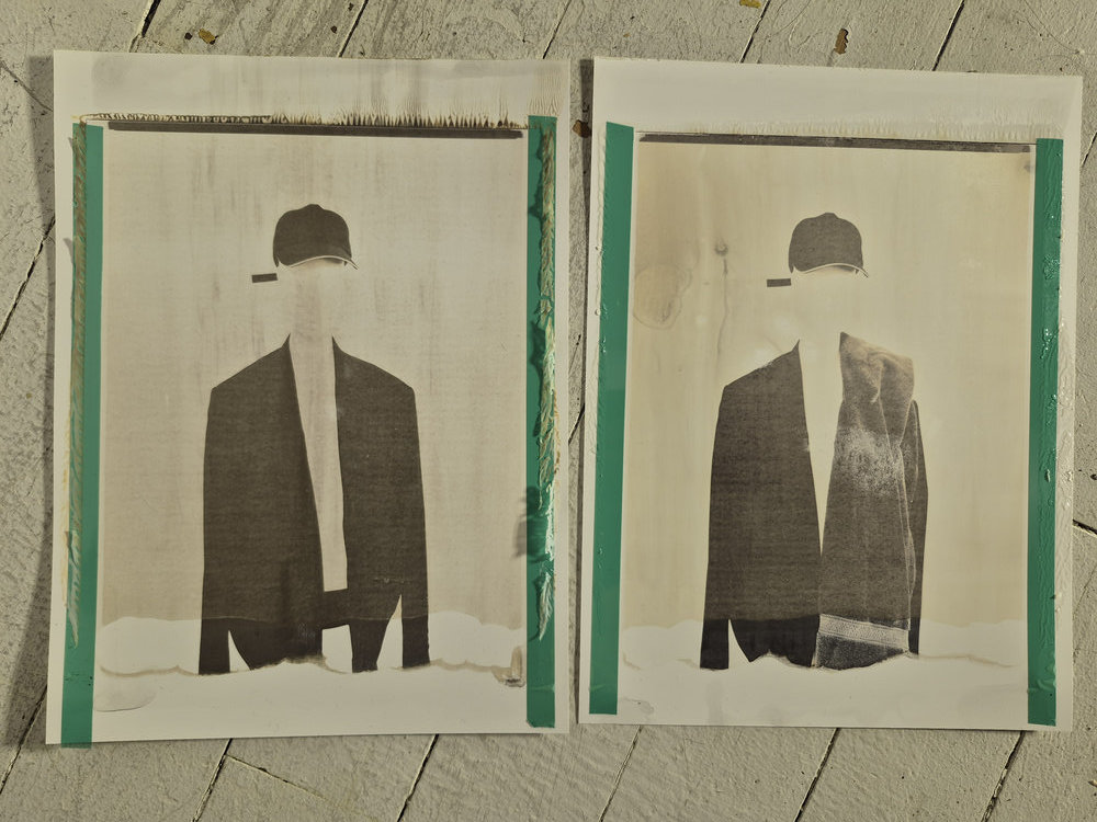

Hey,
Here is what I did:
  • 39.1 g distilled water
  • 7.22 g NaOH
  • 1.8 g sodium CMC
  • 5.0 g uracil pyrimidine-2,4(1H,3H)-dione
  • 2.2 g diethylhydroxylamine (DEHA)
  • 1.0 g aminoethylethanolamine (AEEA)
  • 0.10 g Metol sulphate
The new image is on the right, with the big finger print :tongue:
Now there is more of an evident yellow cast.
It still has this muddy cast that drops the exposure a fair amount.
I had the cast at times with Ilford paper but eventually got it more under control.
This yellow cast is interesting though, no idea why they both have it to a degree. Maybe I have a contamination issue.
NaOH % with Total Developer before was 4.9%
After adjustments, I got to 12.3% (I missed the 15% mark as I accidentally compared with the developer's base mass.
Anyone have any ideas what I should try next?

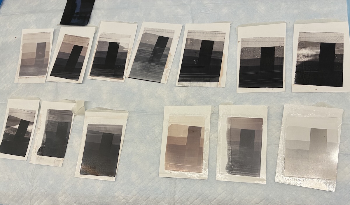

This morning I've tried thirteen variations on a new developer. Yesterday and thursday it was eight different ways to get the silica to stick to the paper. Understanding is great, but it comes through doing. The knowledge is out there but the universe is going to make you fight for it.
I can speak only from my experience, which suggests that viscosity isn't important, except for practical convenience: too loose and the developer runs all over the place; too thick and it doesn't wipe up easily. 2.5-4% CMC seems to work well for me without any obvious differences to the results within that range.
My processor runs at 7mm per second. Rolling speed makes a big difference to print density, for me.
Rail thickness did too, until I gave up using them.
you're right. I think #3 on top looks best.

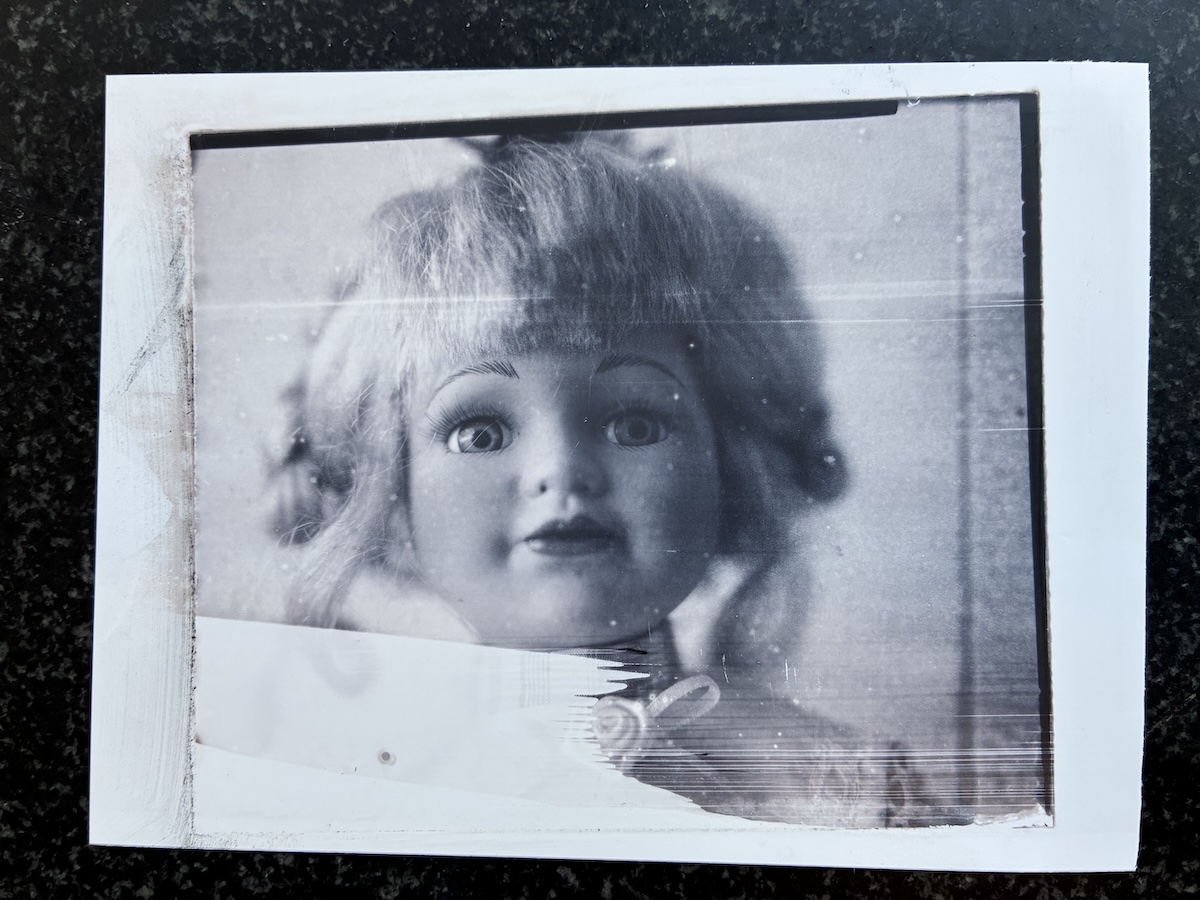

I spent all day working on the best technique for coating with the bar. I think I'm starting to get the hang of it. The laminator machine came just about an hour ago, and I was in a hurry so I shoved a quick 8x10 through.

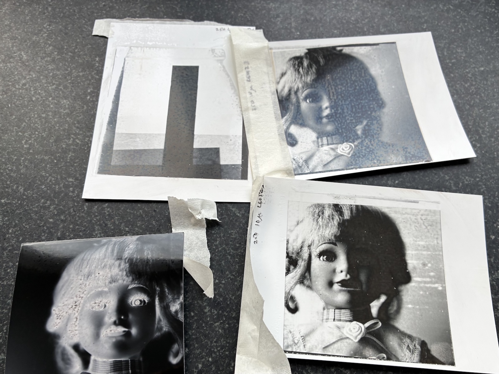

this is with a photo paper negative. the developer I used was unlabeled, but I believe it was TBHQ + metol. I shot the paper at around ISO 10. One step forward, two steps back. Back at it again tomorrow. Going to cut the sheets I coated down to 4x5 and try X-ray film.
Here's the "negative". Some interesting(?) partial solarization.
