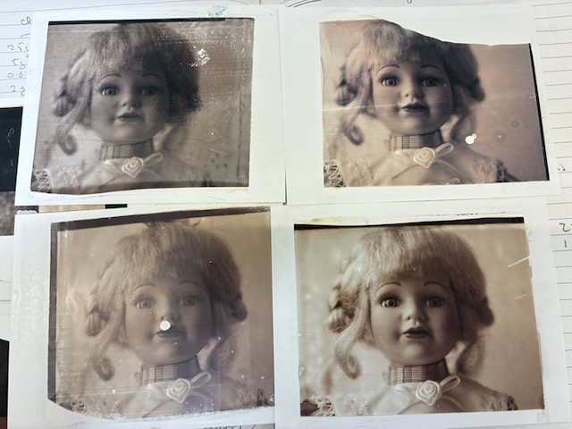

Results look like this:
The tonality is variable (and very hard to control) with Dmax a long way below what I can get with silica. On the positive side the prints don't appear to need washing as there's no stain and no salting.

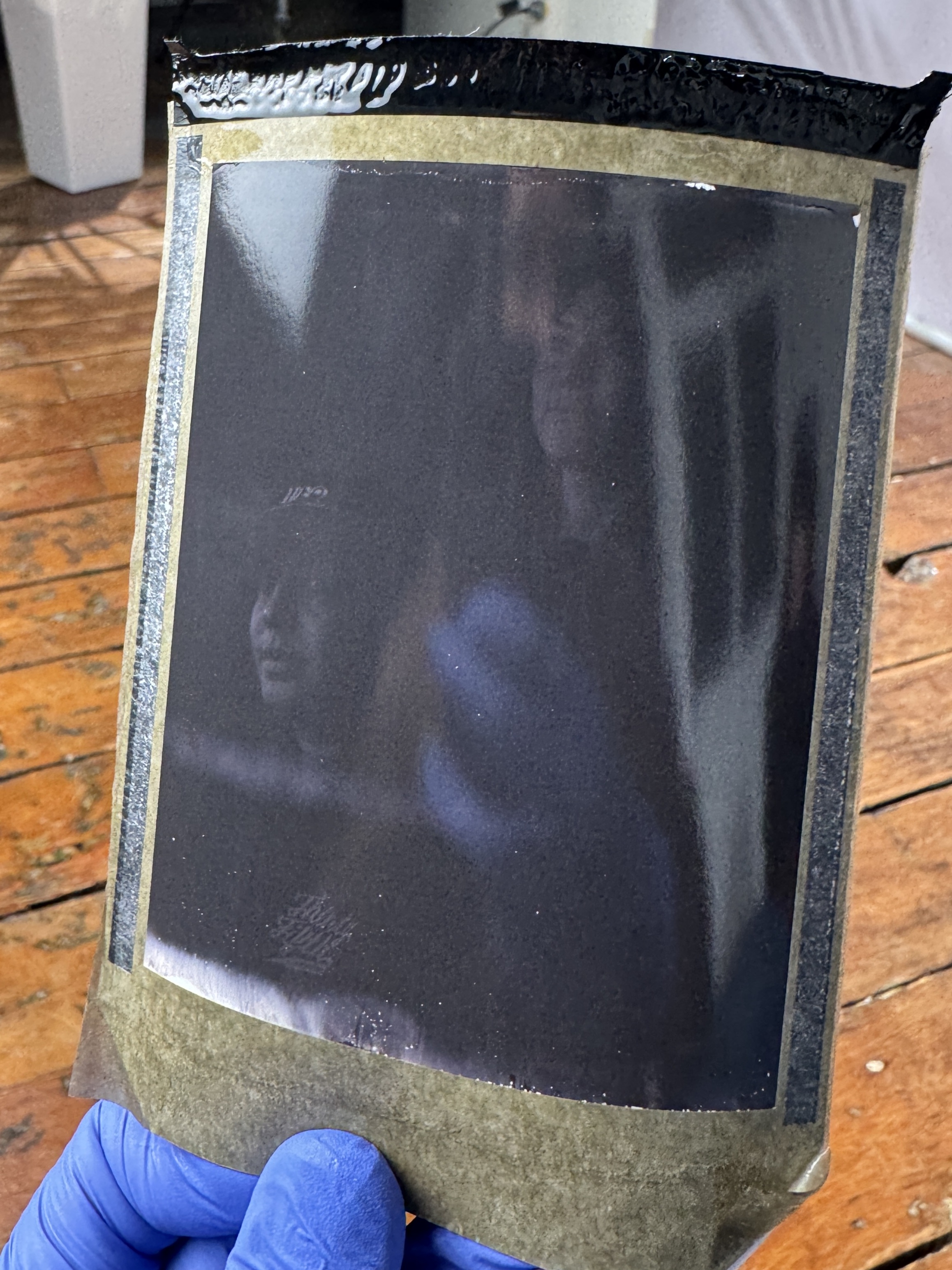

This is an uncoated baryta sheet with material scrapped from an 8x10 Polaroid negative glued on. I was successfully able to insert it back into an 8x10 sleeve, seal that, and place it into the Polaroid 8x10 holder + withdraw the sleeve. My dummy "negative" stayed in the holder with the tab intact.
The next step is to make up a dummy "positive" and see if it can survive going through the processor with the negative, without the tabs tearing.

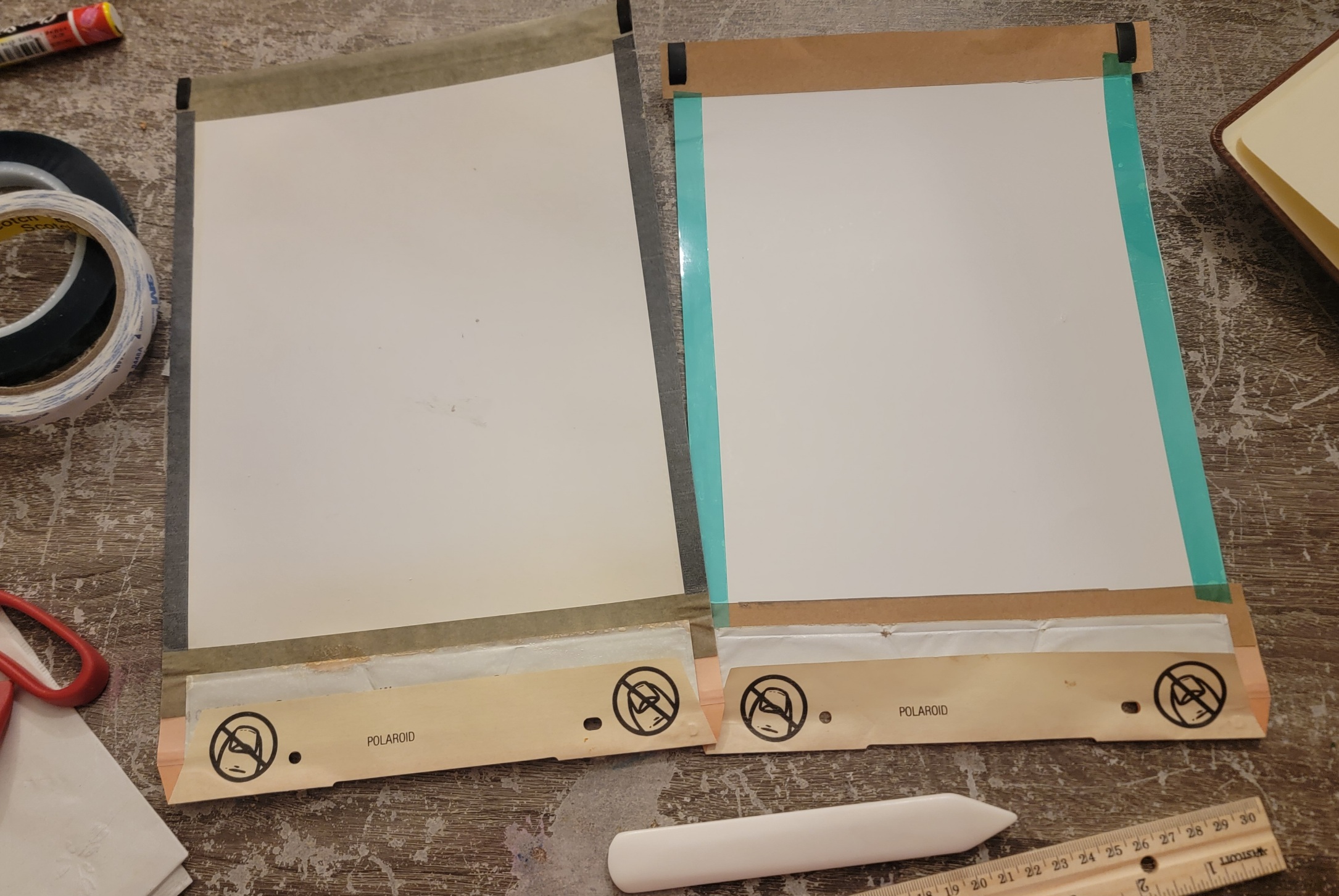

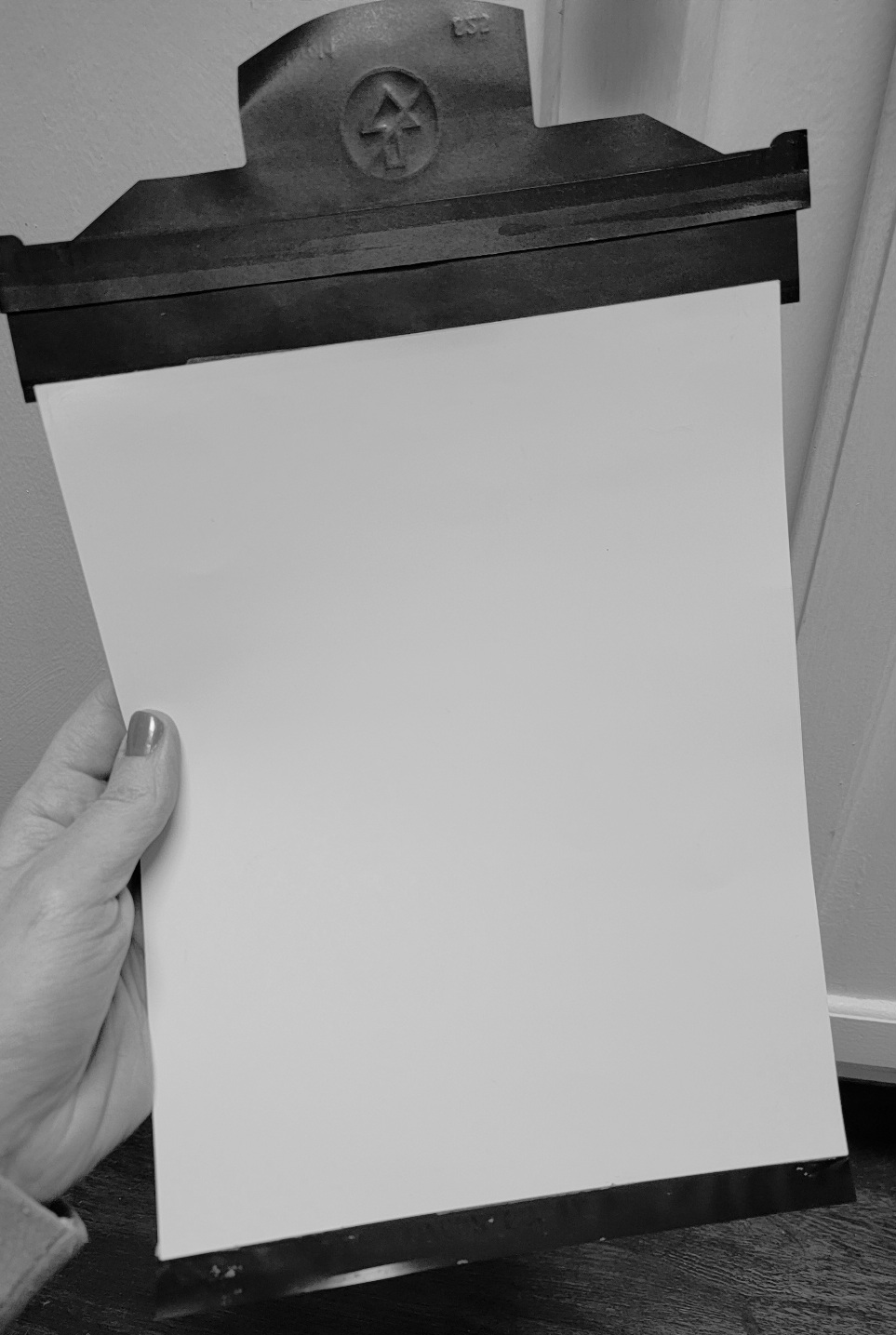

Type 804 positive on the left, (uncoated) baryta paper assembled by me with kraft paper on the right. The side rails are polyester tape, 3.5mil thickness. The bottom piece and top plastic pieces were salvaged from a shot Polaroid 8x10 photo. I am going to have a friend 3D print the plastic tabs. I have several dozen of the salvaged bottom pieces, but it isn't a very complicated piece of paper to replicate.
I successfully loaded it into the Polaroid 8x10 holder with my dummy negative, and the sandwich was easily pulled thru the processor (the pod was empty.)
Encouraging progress on this front! Let's hope I'm able to actually coat and get some good transfer onto positives. I'm going to use 8x10 photo paper (Ilford) as my negatives.

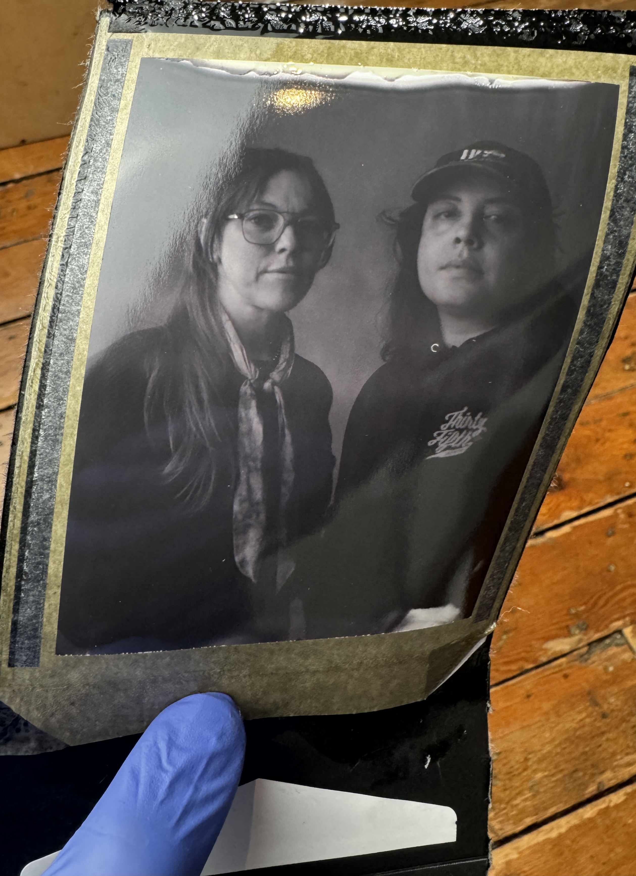

I sent some developer I made to a friend and this was his result on dried Type 54. This is my latest try using uracil as the solvent, success! There was no superadditive developer (just DEHA), so the film had to be shot at ISO 16 (as opposed to the original 100) to get this result. I'm ecstatic! This is close to perfect tonality for T54.
Well done!
Here are his first and second attempts on T54, first at box speed (100) then at 25.
For those following along at home, here's the recipe for the above developer. (I'm calling this my Developer Type 7).
