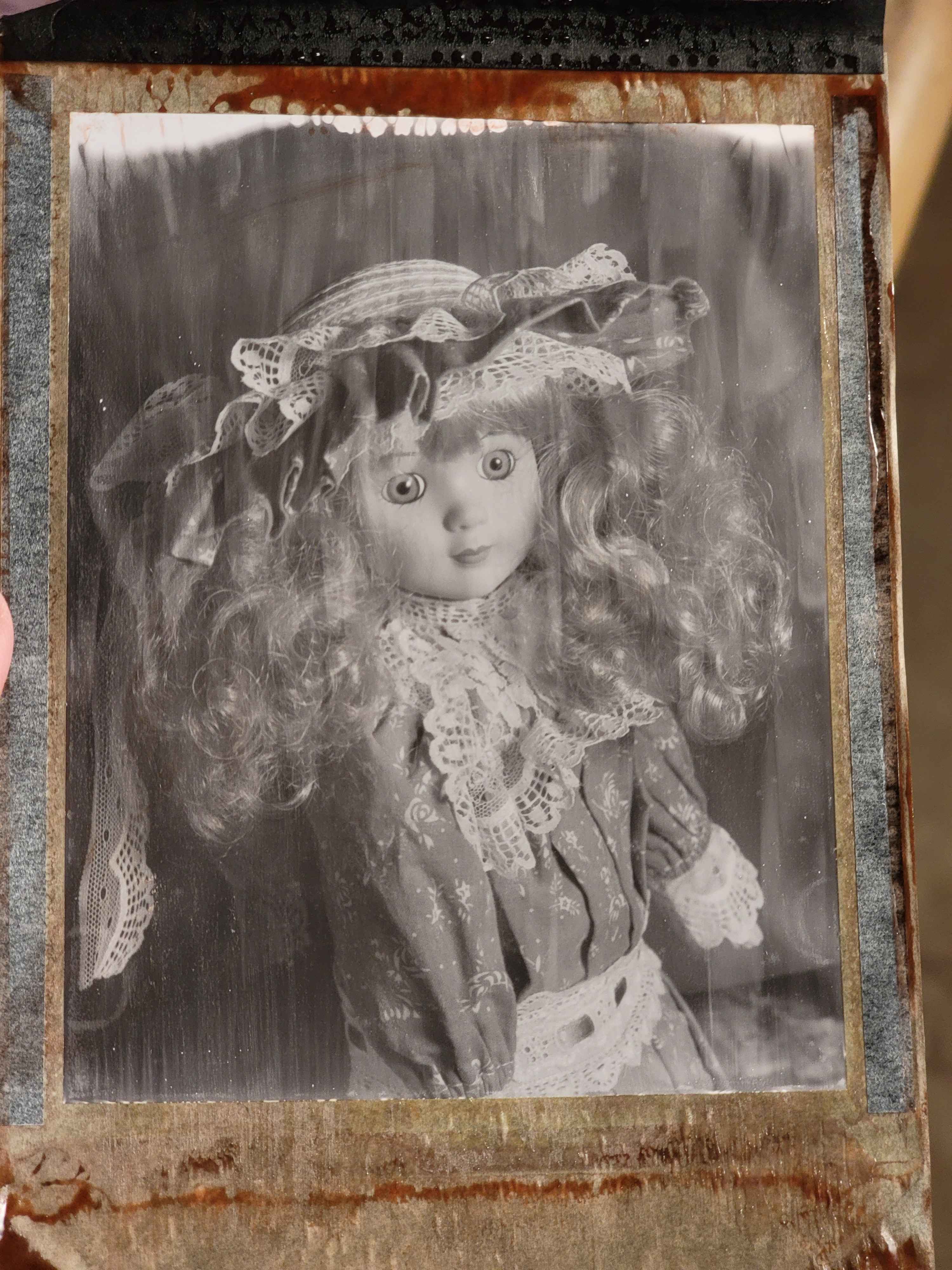

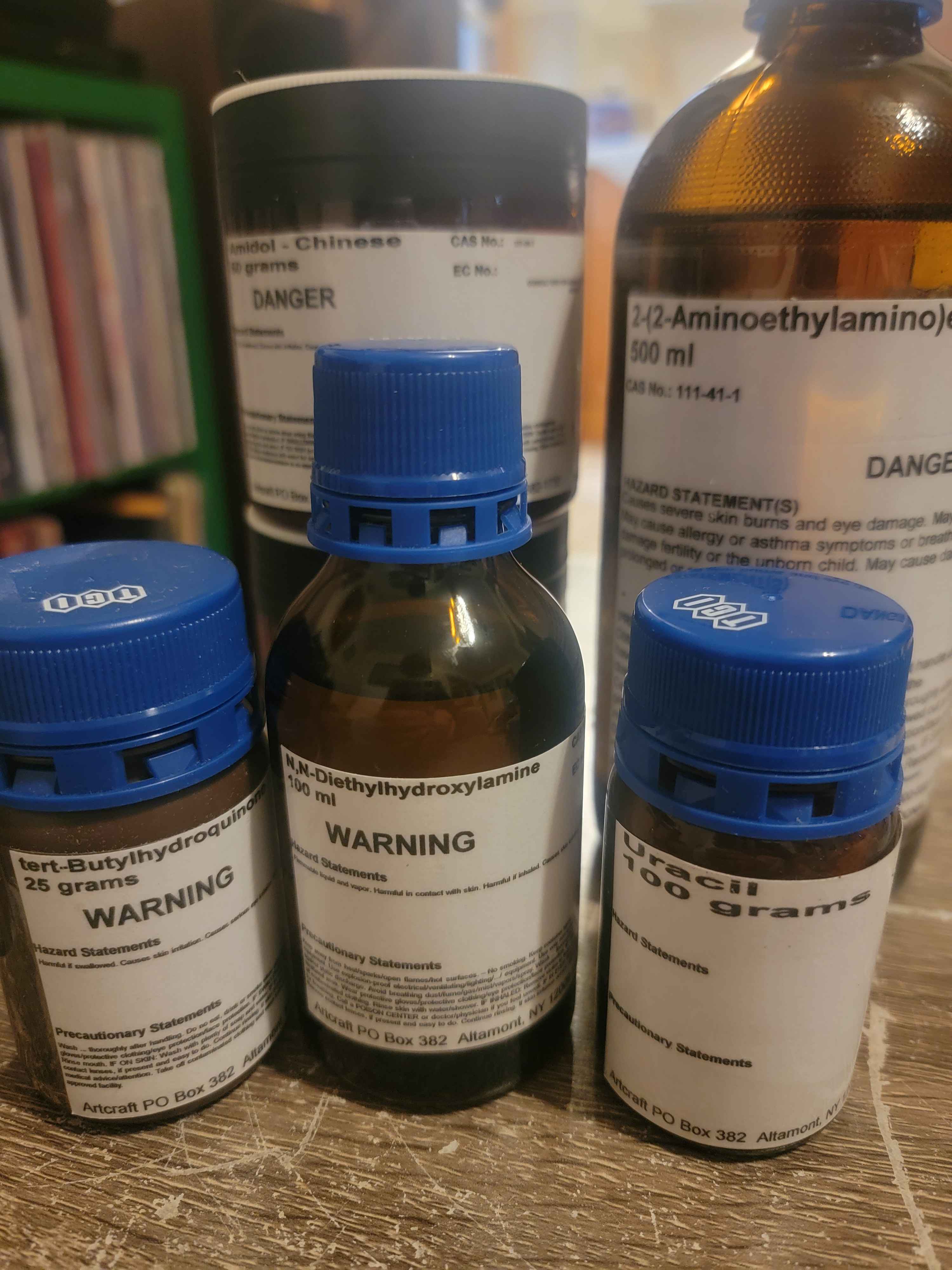

I finally got around to getting some stuff on my own, and I've had some decent success. Right now, I'm just focusing on making a paste that can be used to resurrect dried B&W Polaroid material, several friends and I have a LOT of it so there's some interest there. I got a bunch of chemicals, from ArtCraft (who was kind enough to order from TCI on my behalf), Amazon, and a local distributor:
Not pictured: Metol, Lithium Hydroxide, Zinc Acetate, Stannous Chloride, Triethanolamine, Sodium Sulfite, et al. I'm using hydroxyethyl cellulose instead of sodium CMC. I don't know how much of a difference that makes.

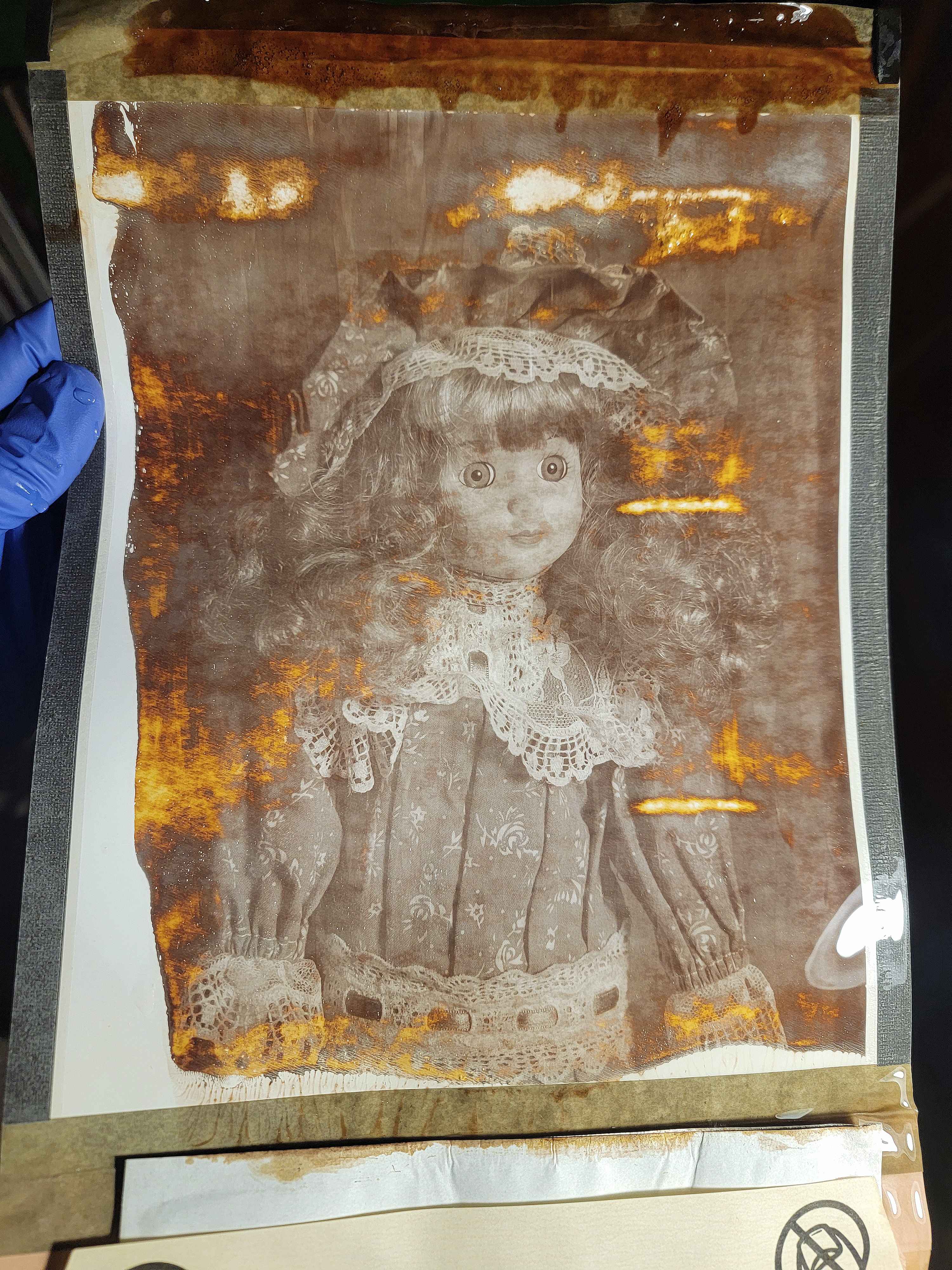

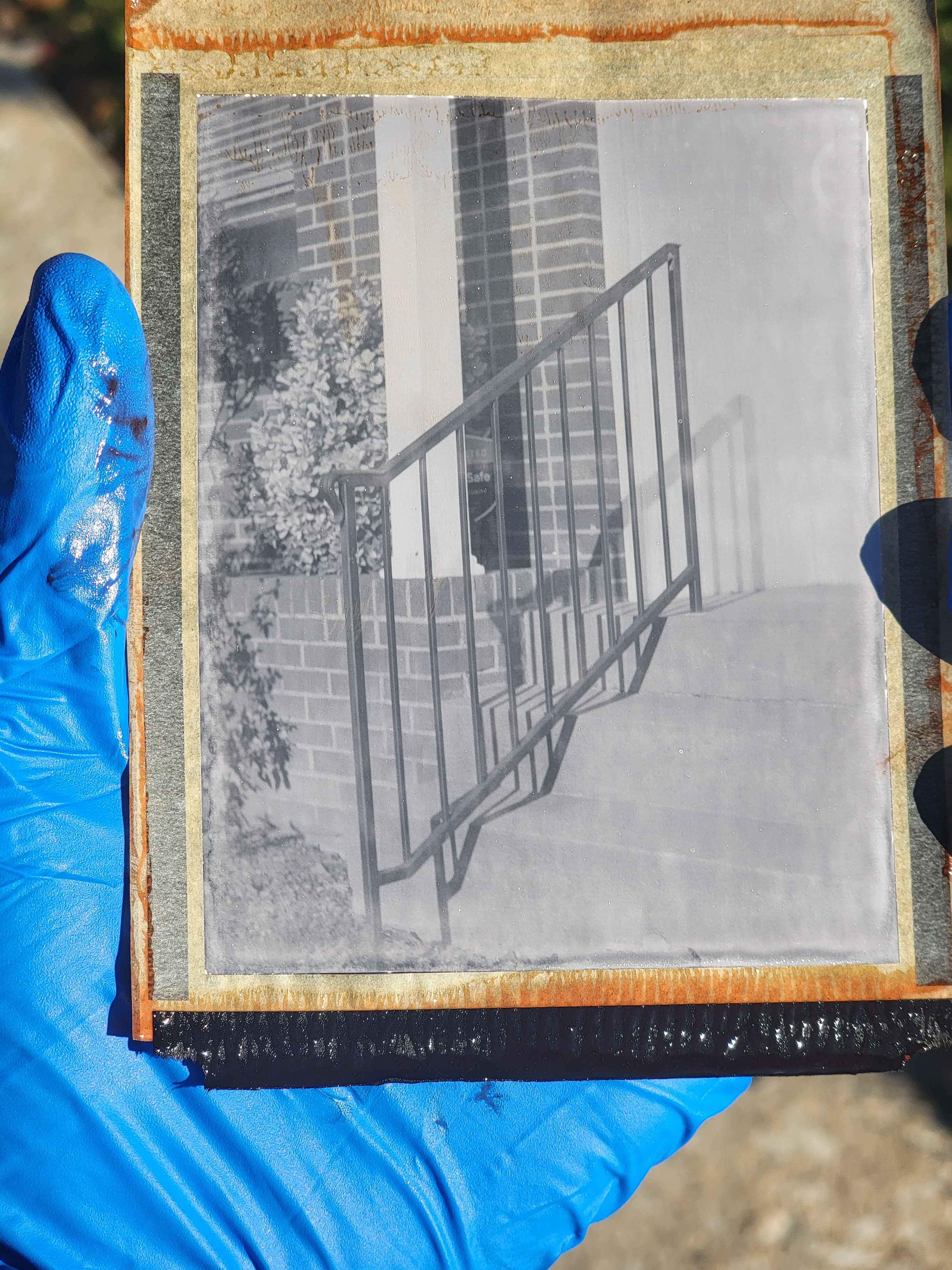

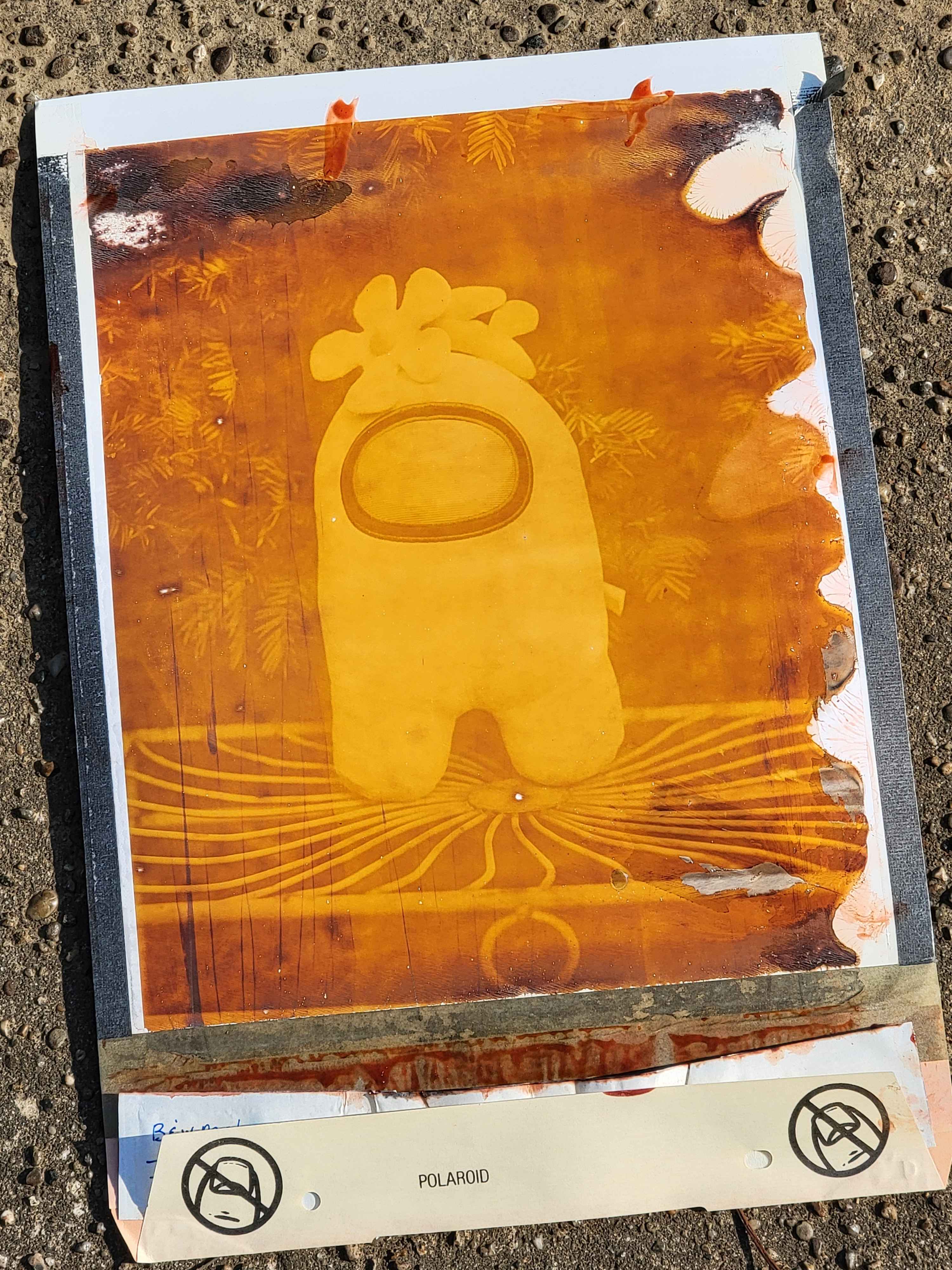

I've been thru five different "recipes" so far. I've had success resurrecting dried Type 55, which gives good neutral tonality and the negative also comes out good:
The previous photos (and the following one) were developed with tert-butylhydroquinone as the developer + Na₂S₂O₃ as the silver solvent.

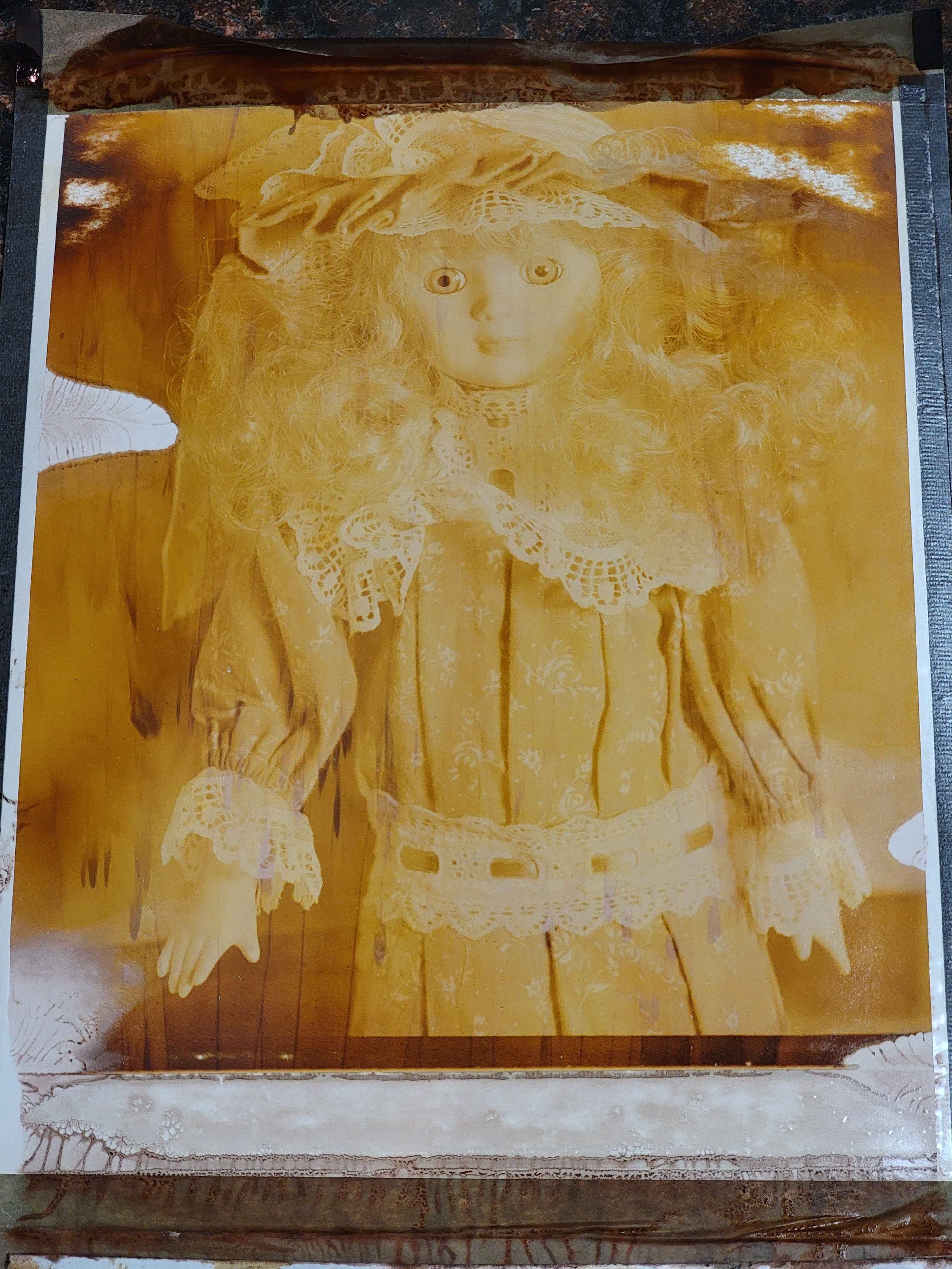

I've also been testing it out with Polaroid Type 804 (Polapan 100) 8x10. Unlike T55, no matter which developer combinations I've tried, it always comes out with a heavy sepia tone. I will continue to experiment..
The next few images were made with the 5th iteration of developer, I lowered the TBHQ and added a bit of Metol.
(Type 55)

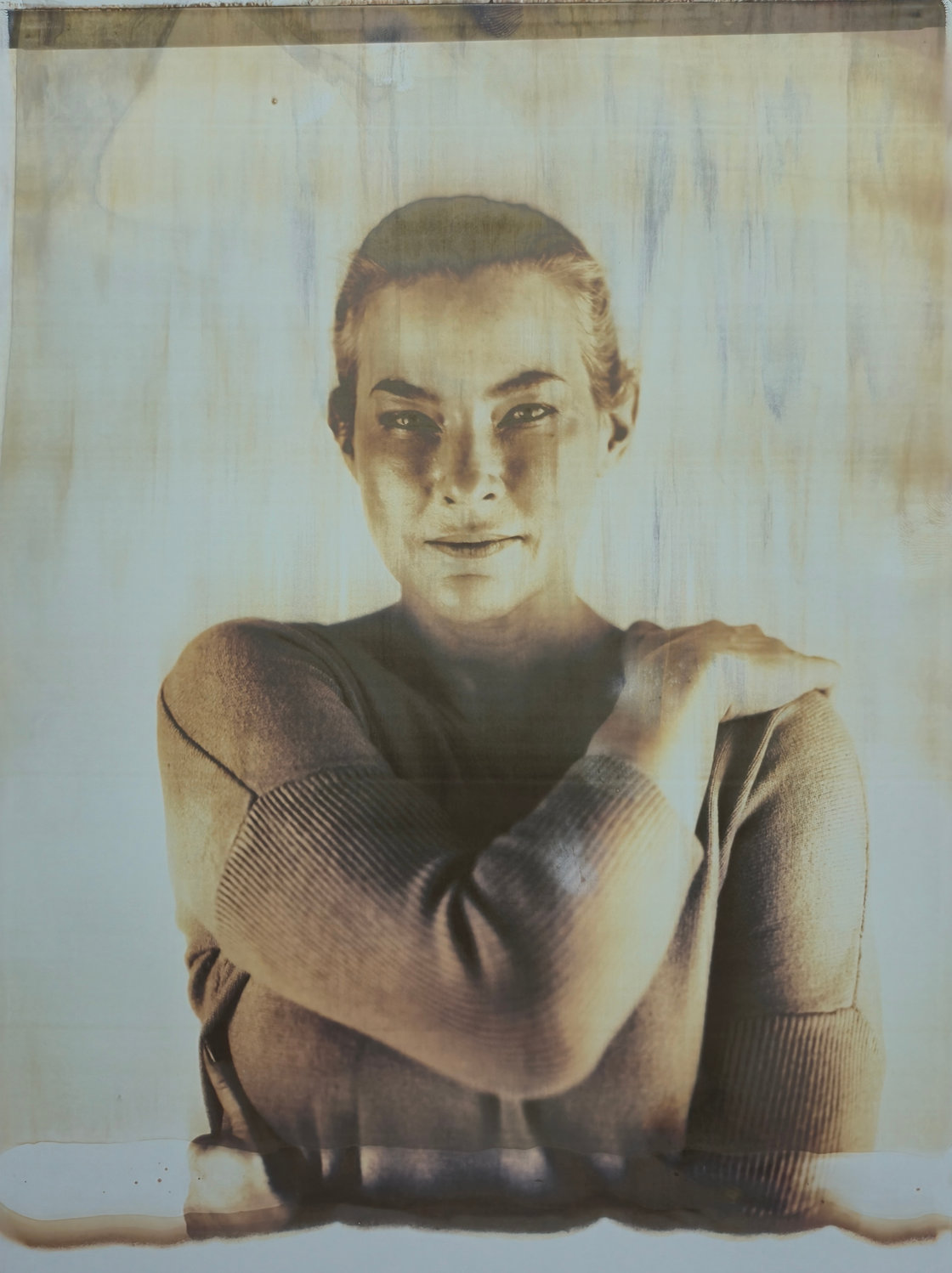

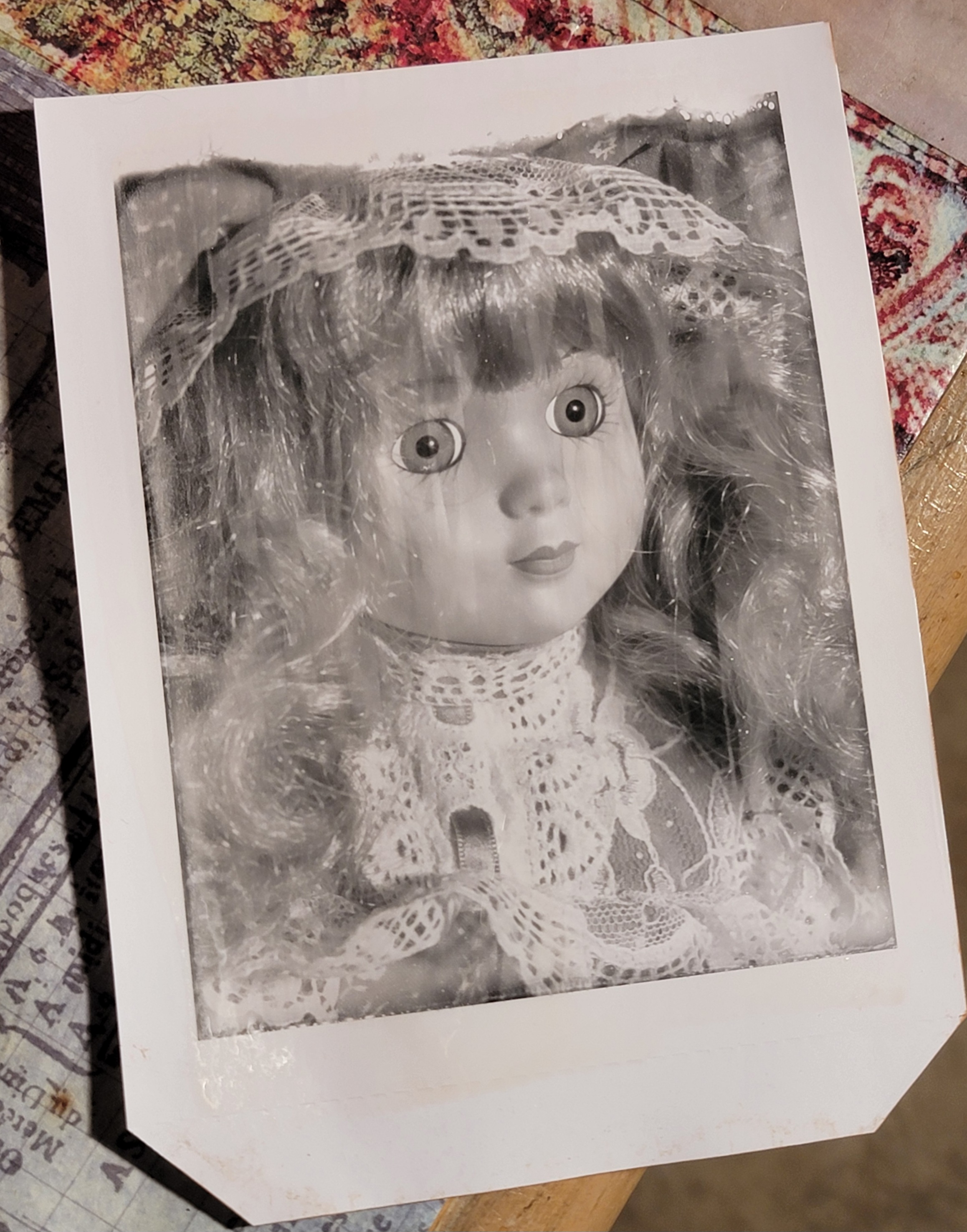

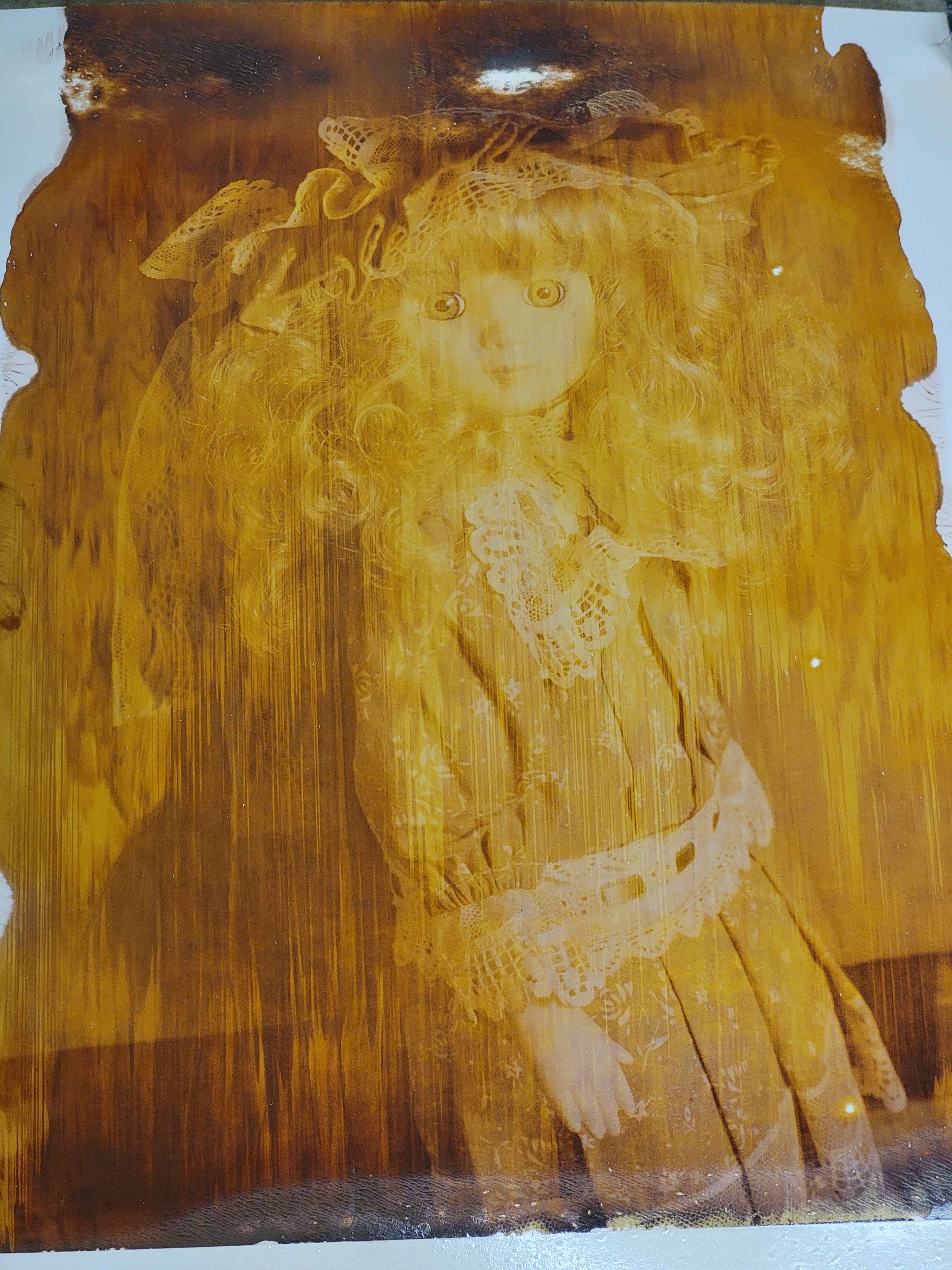

Just tested a new developer (with Type 803 again). Very, very excited on the outcome. Close to perfect tonality. The artifacts are from me being impatient and not waiting for air bubbles to float out, and not cleaning the rollers on the 8x10 processor beforehand.
The only difference is that I added 30mg of cysteine to Developer #5. Crazy how such a small thing can make such a big difference!

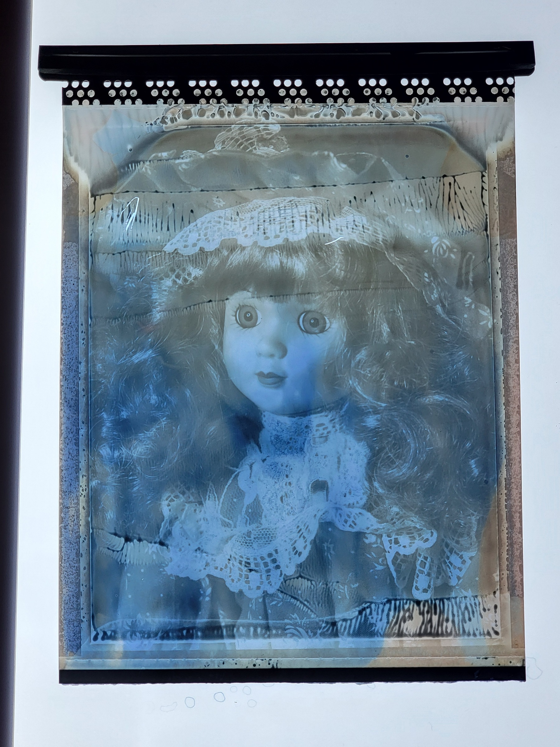

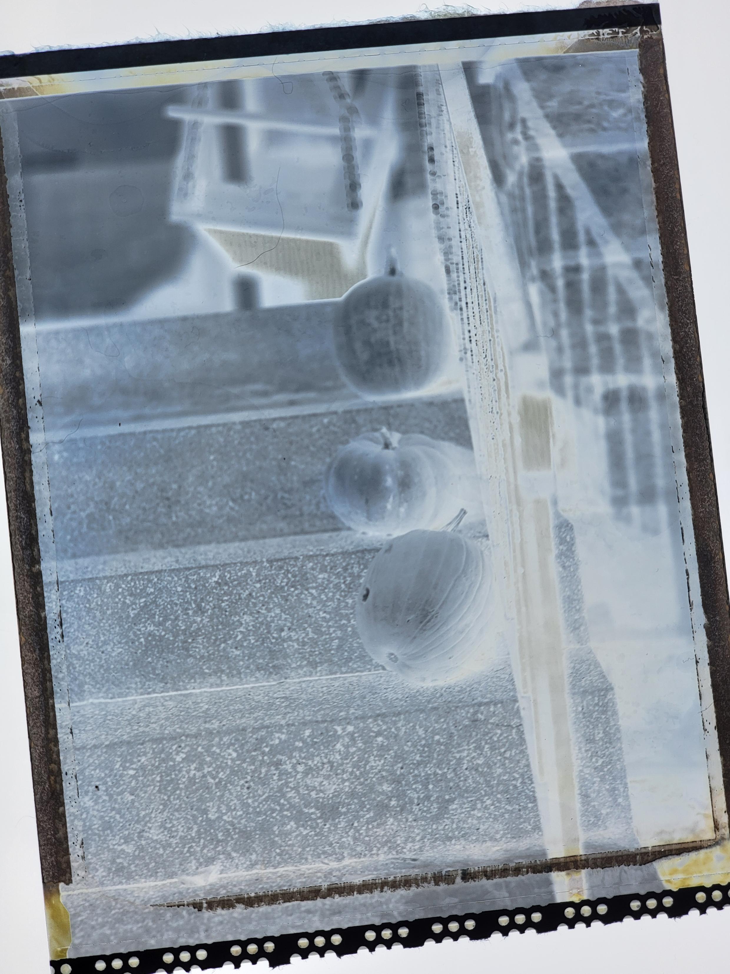

I've tried a few formulae that are thiosulfate free, using Uracil as the silver solvent, a la Alec's previously detailed formula. I have not been very successful with these so far, I'm sure I'm messing something up along the way. Interestingly enough, this happened on a Type 55 negative:
Solarization resulting in a negative that's actually a positive. Extreme blue staining, too. Still pretty neat!

I've also been emailing with a couple of retired Polaroid engineers who worked on the peel-apart products. Which has been very helpful. I'm going to do some work on finding which accessible toners work to move the hues from brown to black, which is very relevant to @analogwisdom comments about the sepia tone with Polapan 100.

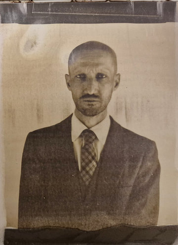

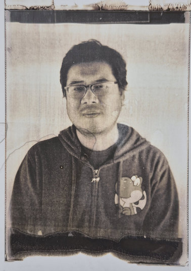

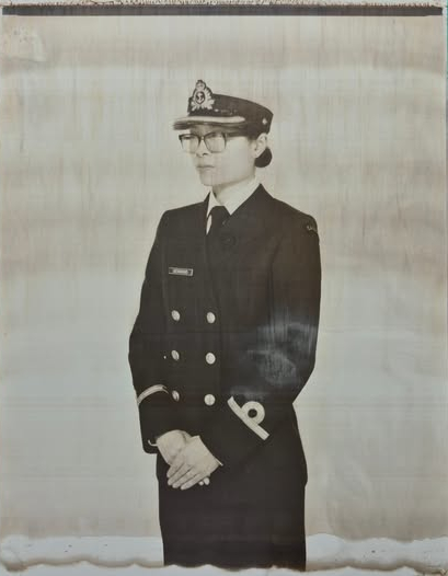

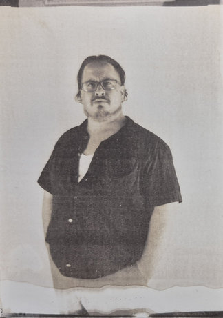

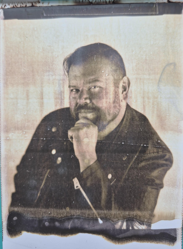

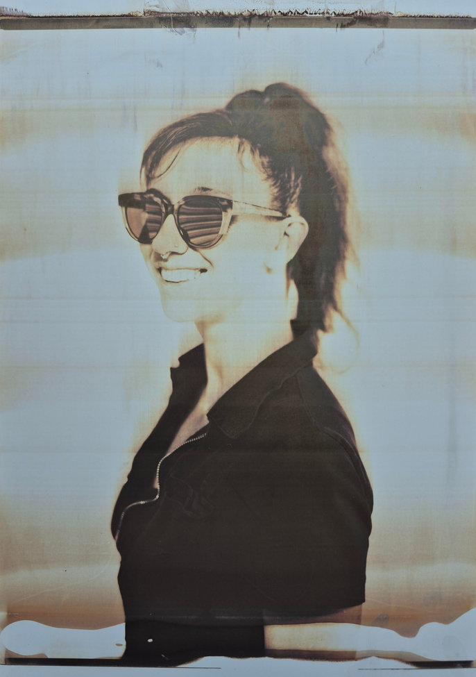

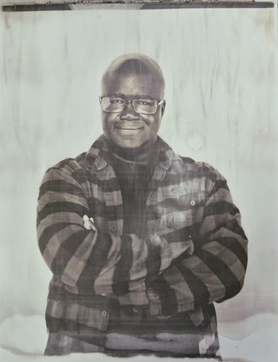

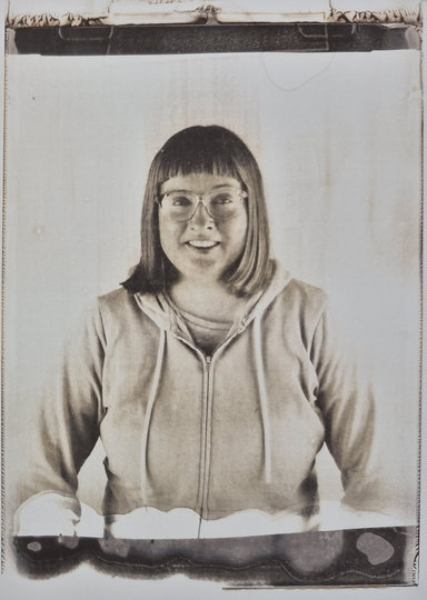

I spent October and November shooting as many people as I could find.
Here are some of the shots I got over the course of two months.
What did I do to achieve better results? The developer was modified a bit to account for using black and white enlargement paper rather than film.
Still not 100% satisfied with consistency in tones.

That's a very cool project! What size are the prints?
Land was also in shock when he found out his early prints faded; Polaroid had to invent and rush out the print coater in double-quick time.
Thanks so much Alecrmyers.
4x5" and 8x10" although soon 20x24" and later 24x32" as, I just received my chrome dipped rollers today that will get me better processing than with the regular motorized laminator rollers as those rollers are spongey.
