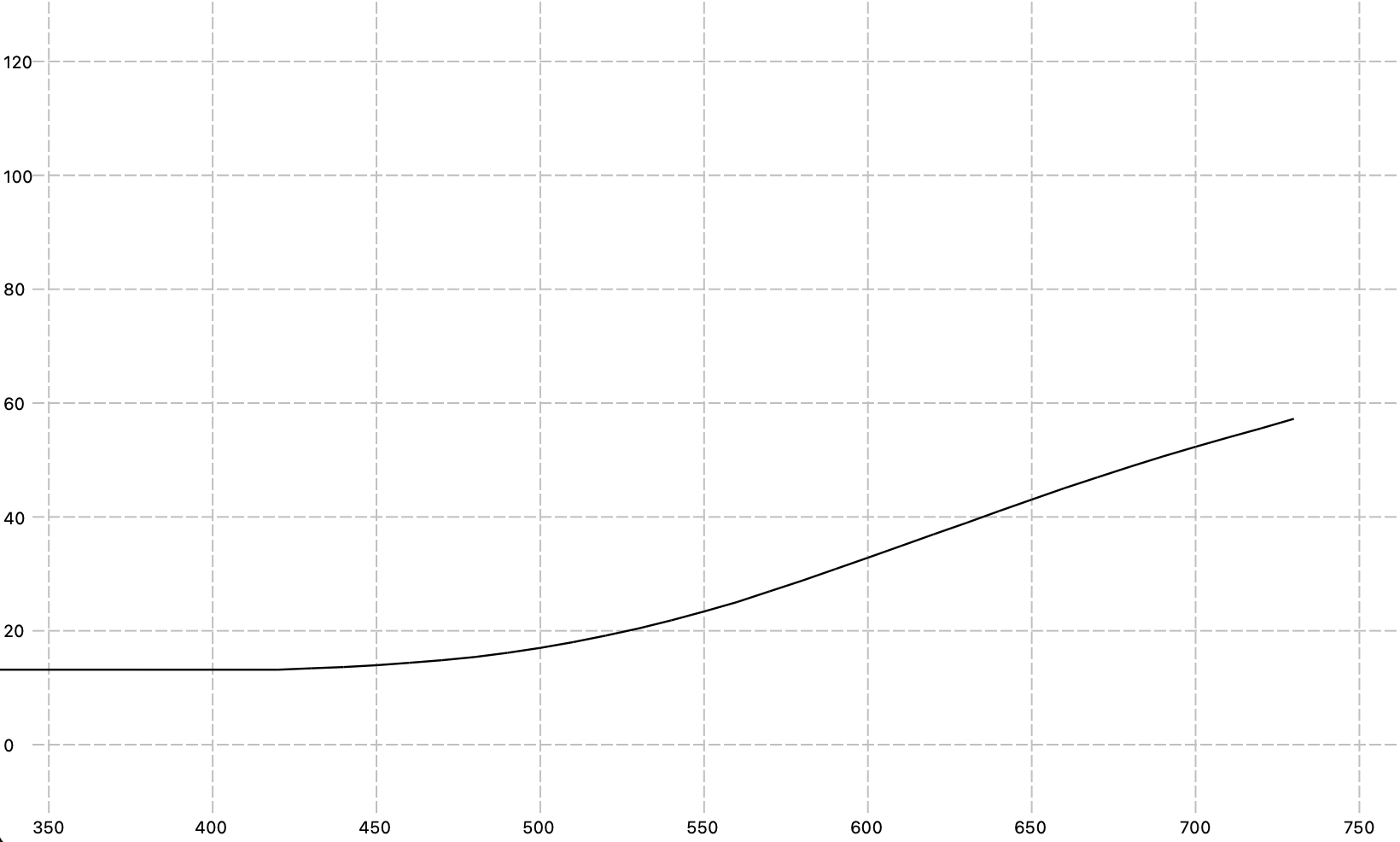

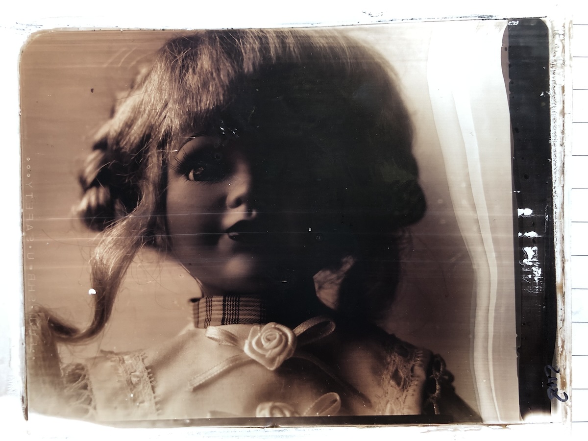

From the back of a drawer I dug out my old ColorMunki photo thingumy that I used to use to calibrate prints and my screen, and using the ArgyllCMS open source software I was able to measure Dmax for a range of recent prints - and they all came out between 1.6 and 1.75, which is excellent for this medium, very much up there with the best examples in the patent literature.
It was also able to produce a spectral response curve. It's pretty flat for the palladium silica papers, but no so for the red/brown one of the CA/palladium coating. Here is what it shows for a mid-tone area (wavelength along the bottom):
That's for the top left background area in this image:
It's not a stunning insight that a brown image reflects more in the longer wavelengths but it's nice to be able to measure the effect.

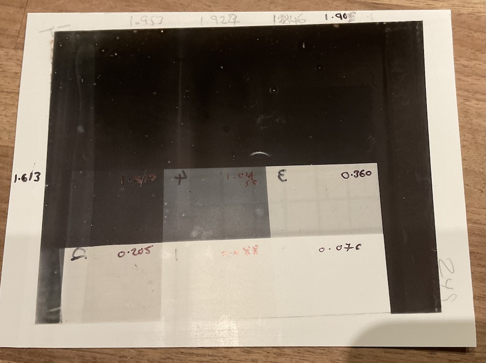

By adjusting the feed speed and roller pressure I was able to get a Dmax and Dmin of 2.16 and 0.06 over a dynamic range of 9 stops (logΔE of 2.7) which is really excellent. Ilford Multigrade RC is Dmax 2.15, so we're matching that. I will try to plot some exposure/density curves.
This is a HD curve from a test exposure. Are there any densitometry experts who are willing to opine on it?
