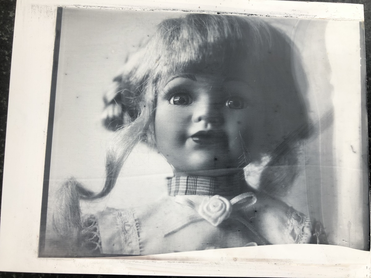

I did a lot of work with sodium dithionite last year without a lot of success, but I've changed developers somewhat since then so I gave it another go just now. Image is neutral tone (which is good) but Dmax is low - paler than it appears in the photo below. That could be worked on, most likely:
By the way - IronOut is only 15-40% dithionite (aka 'hydrosulphite'). I haven't tried it in place of the laboratory standard reagent.
I don't think the keeping quality is very important: once the palladium chloride is reduced (which process occurs in the vial before the paper is coated), you'd quite like any residual reducing agent to get lost. If it hangs around in the receiver paper then it might diffuse to the emulsion and cause fog.

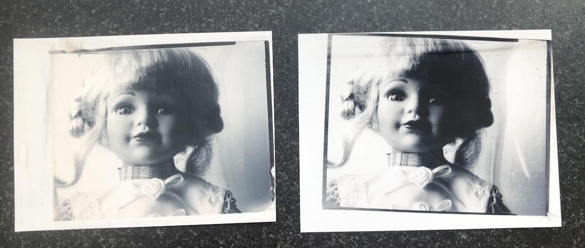

These two images are made with receiver paper prepared using sodium dithionite, today. I'm trying to reduce the slight yellow colour that appears in the highlights a couple of hours after the print is made (compare the two). But the dithionite does seem to work as well as the borohydride.

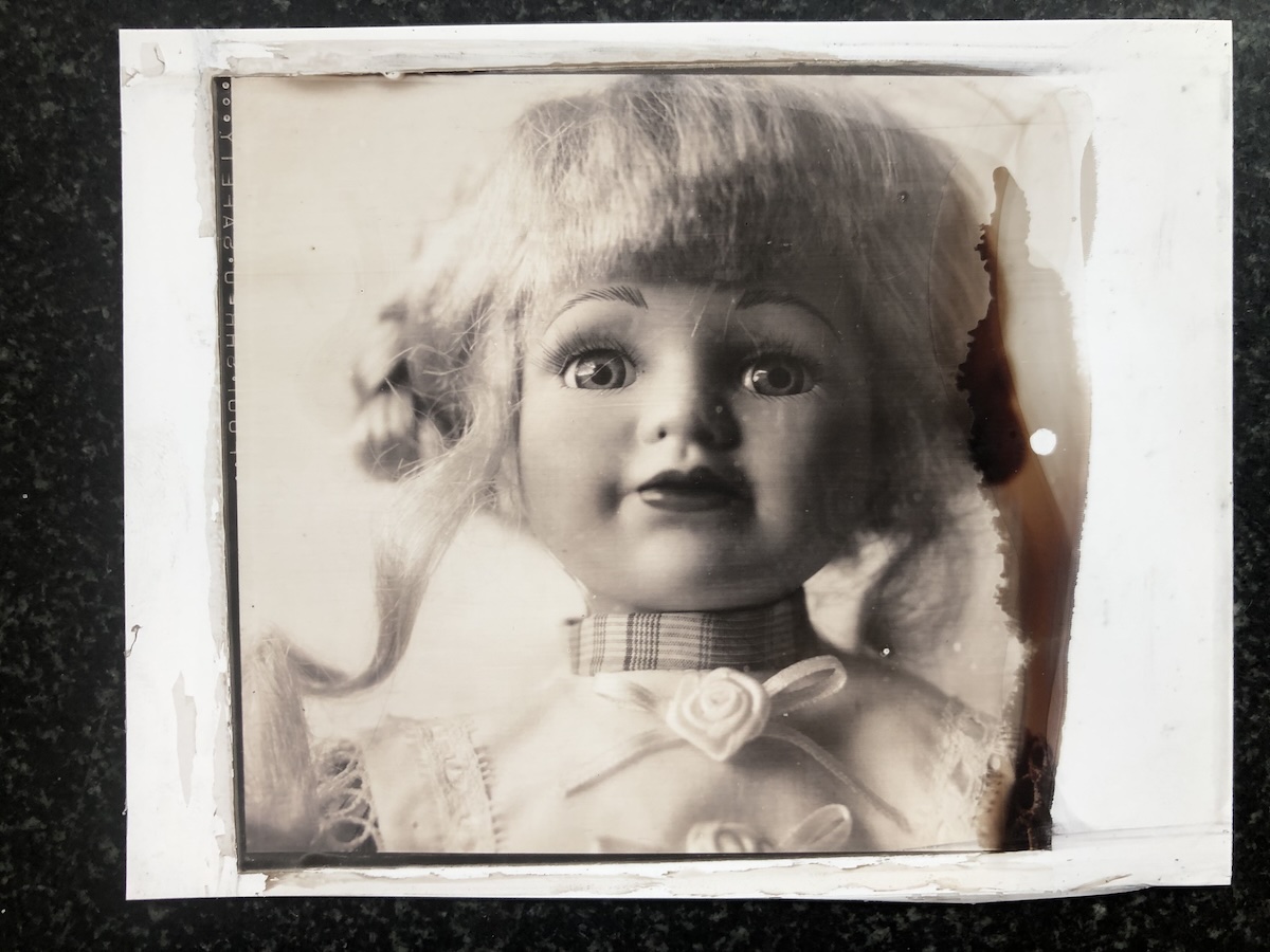

That looks like residual thiosulfate or similar. Are those getting a good wash after development? This may be why Polaroid still needed print coaters into the 1980s; the coater applied a layer of some sort of lacquer that blocked oxygen from the receptor sheet (as I recall).
I'm getting good results with the dithionite now. Experimentally I determine that it's necessary to wait some time (nominally 60 minutes) after adding the dithionite before coating the paper - if you do, Dmax is much improved. This could be for two reasons - it drives the reduction reaction to completion, and/or it allows the residual dithionite time to decay. By contrast, the borohydride reductions give good Dmax within seconds of the borohydride being added.
Refering to the colour: this developer doesn't include thiosulphate - in fact it's entirely sulphur free - so it's definitely not thiosulphate staining, but I do have some hypotheses for what it might be. My goal is to formulate a system that doesn't need washing - so most of the sample images are not washed. However staining can (sometimes) be reduced by post-development treatments, of which washing is one possibility.
According to what Land wrote in Neblette, the image coating was necessary to prevent aerial oxidation and sulphurization of the silver, but was only needed for some paper types. Not (obviously) for what Polaroid marketed as 'coaterless' systems. I understand the major deterioration with failing to coat a coated system print was image fade, which took place in days to weeks. My images are (thankfully) fade free. I have tried some Polaroid coating swabs (a Photrio contributor was kind enough to send me some) on various of my print formulations but they don't prevent stain. Land's method to prevent stain was a timing layer and a shutdown layer which automatically lowered the pH a predetermined time after the developer was spread. I don't have access to the sophisticated synthetic polymers that he used for those, nor the patience to experiment with three or more successive coatings on each receiver sheet :sad:
Dithionite, however does contain sulfur...
It does, but the staining is present with paper produced with borohydride, which is where I've spent most of my efforts looking at it - it's not a dithionite specific thing.

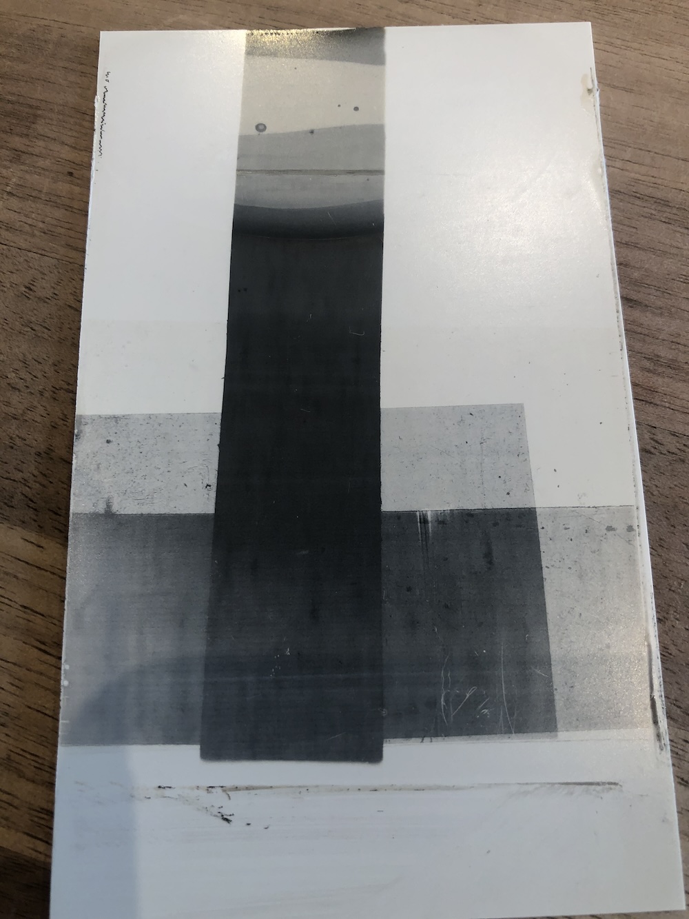

This is my first sort-of success producing an image on a layer of partially hydrolyzed cellulose acetate containing palladium sulphide. The challenge has been getting the CA to stick to the paper and not slough off. This system is much closer to Polaroid's coaterless chemistry than anything else I've done.

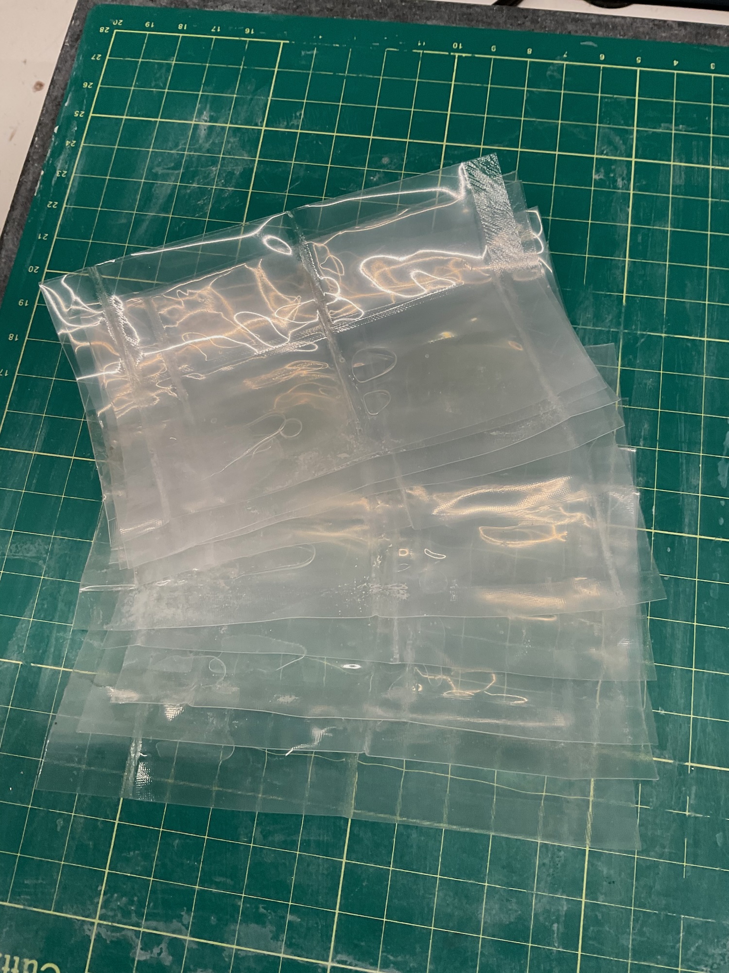

Two updates to report: I've been making pods with polythene vacuum-pack bags, which seems to be relatively successful. One 7x4 bag makes 4 pods. Here's a pile...

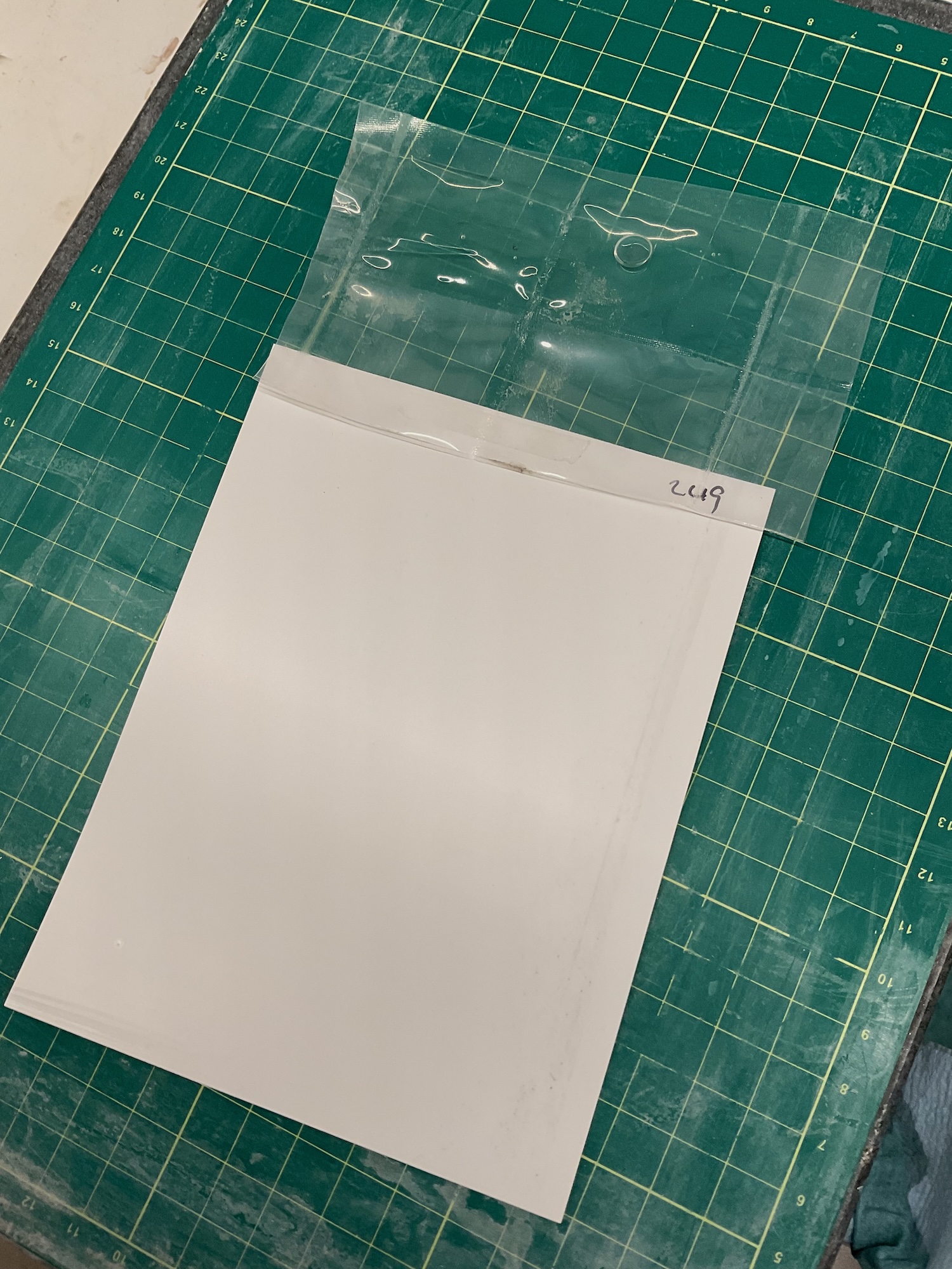

And here's one attached with some double-sided tape to a sheet of receiver paper in the correct orientation:

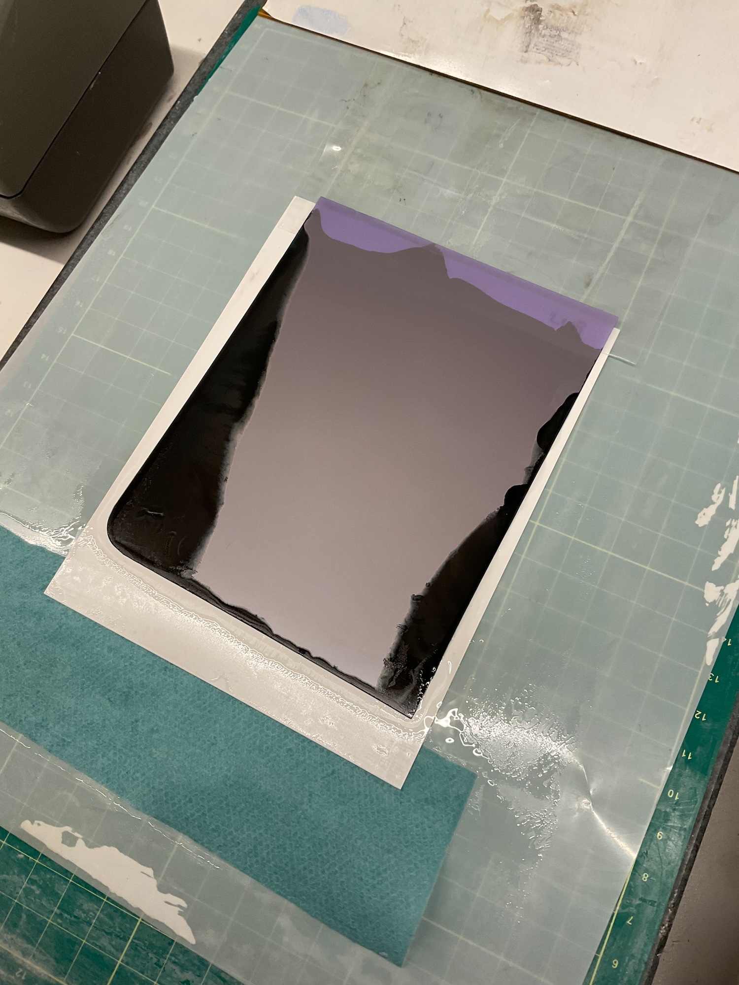

Here's the now empty pod after rolling through the machine (you can see the sponge is wet):

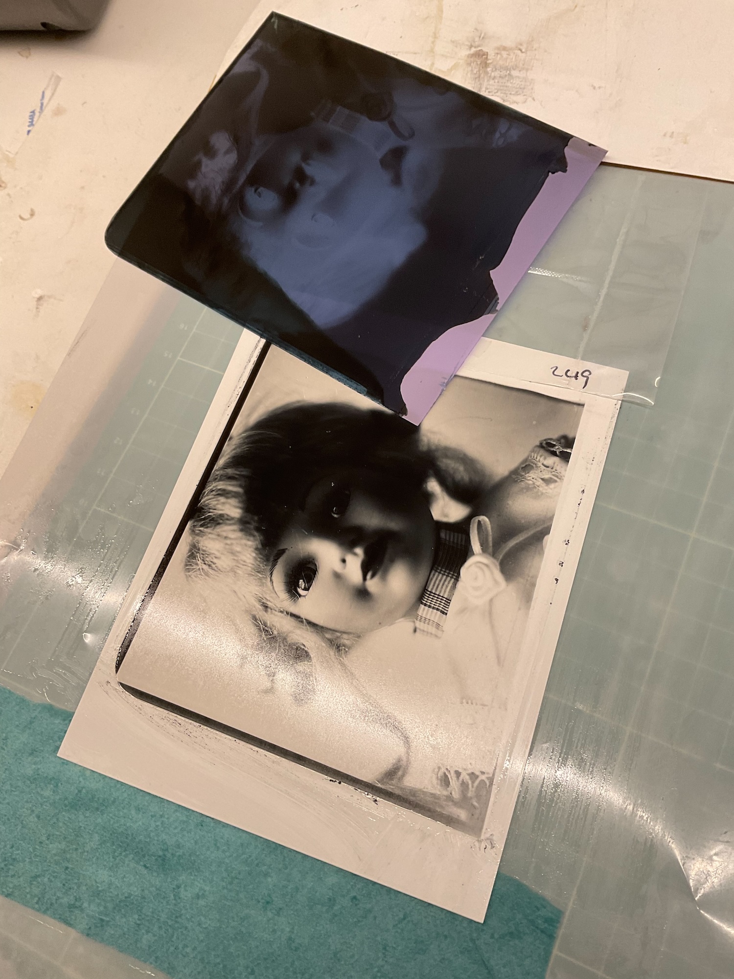

And this is the result:
This is the final print, wiped around the white margins but not washed, and then trimmed:
Comments: tone is very good, contrast too. Streaking is minimal. There's lots of shadow detail (more than shows up in this picture). Developing is a bit thin bottom left - I think this pod needed more developer in it. It took about 120 seconds from shutter to dry print.
