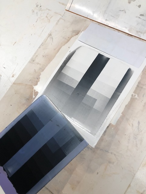

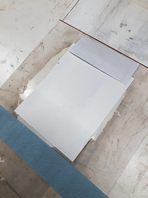

Working in the lab (basement) I was able to synthesize some di(methoxyethyl)hydroxylamine - DMEHA - which was reported in this post in this thread as the active developer in the Polaroid coaterless products. I've been trying it out today and the good news is that it doesn't appear to have any advantages over DEHA other than that it doesn't smell bad. In the picture below the left side is developed with DMEHA and the right side with DEHA and there's not a significant difference. (I am still working on the streaking, obviously.) In a way that's good news because DEHA you can buy, and DMEHA you can't.

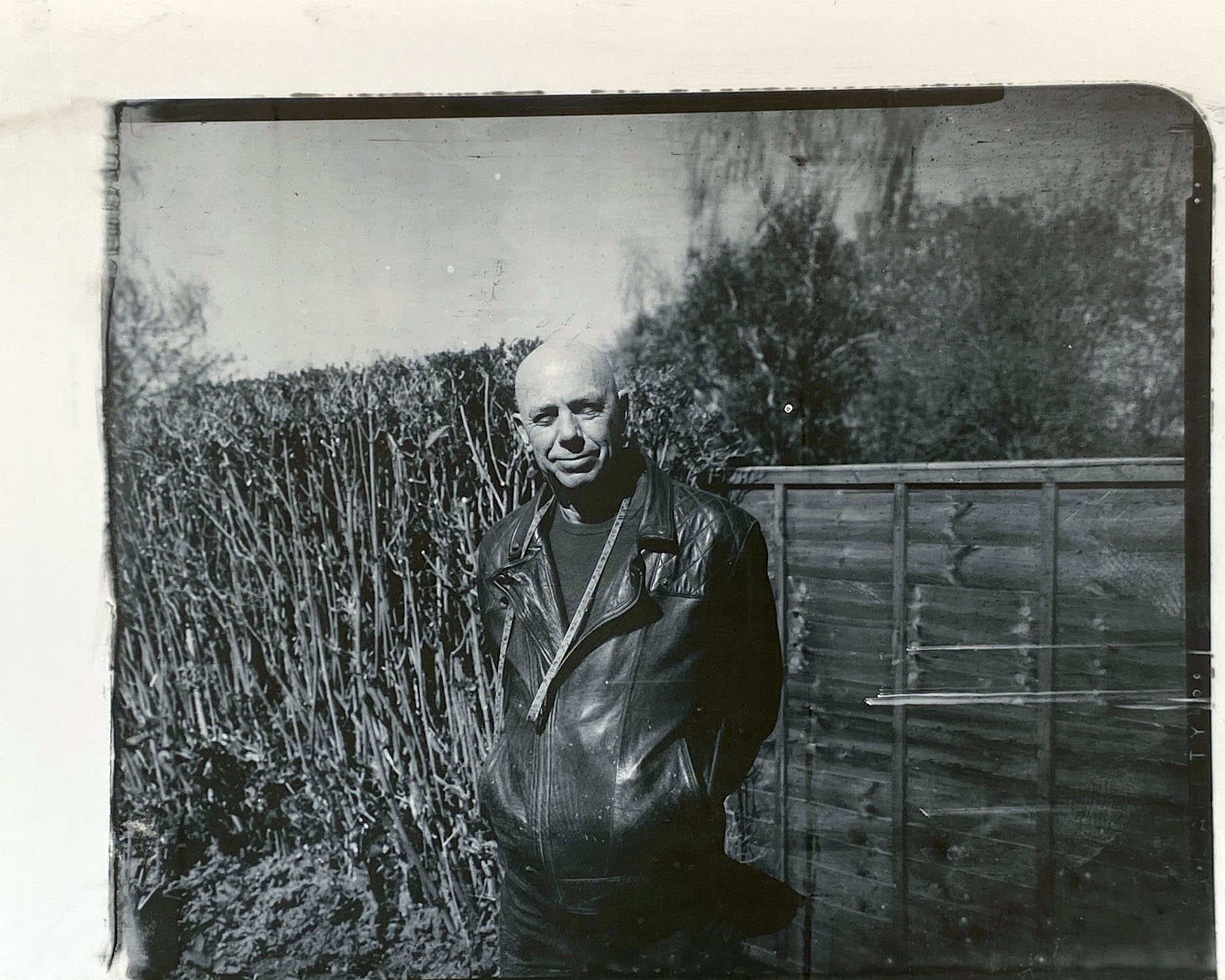

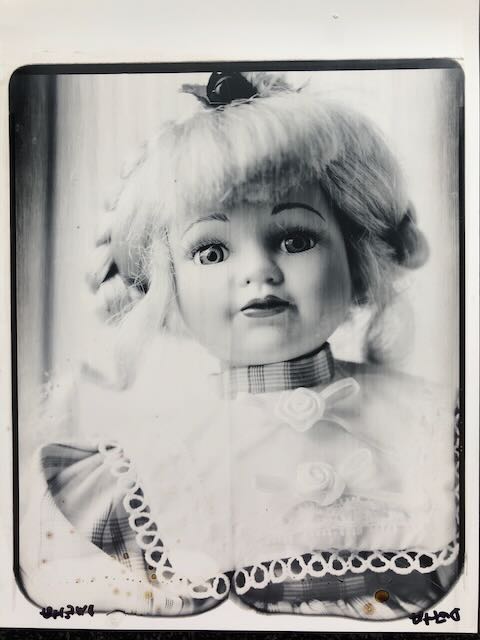

This is the last of the exposures. Very pleasing as before. The image is bluer in tone than the previous one which had a yellow tint. I don't know why the difference with the same materials - exposure? I managed to get the mechanical part of processing sorted now with less mess. I note that the developer supplied is labelled 148 is that much different to 143?
I still have a lot of developer left so will try to do some coating of receiver paper. It's difficult in the UK to get chemicals. I think I have found a paper type and a source for the chems apart from palladium chloride, at least in small quantities. I do have a fair amount gold chloride intended for use in toners, would that do instead of palladium? I guess the tone would be different. I have found two potential sources of silica suspension, one offers .09 micron and the other .06 micron, would either do?
I have a few sheets of Ektascan 8x10 x-ray film (single sided not made anymore) I could first try, would love to make some 8x10 prints. Again UK sources of x-ray film are few and expensive but I will see if a cousin in Netherlands can obtain for me from a German supplier.

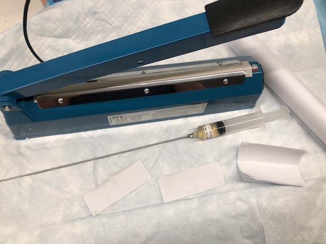

For a bit of Friday afternoon fun, I got myself a very cheap heat sealer and some freezer paper (the kind with the polyethylene coating on one side) and made up some pods of developer using some of the ideas in this thread (only using real developer, not chocolate sauce, obviously.)
I cut the paper into 3"x4" rectangles, and turned them into pods as follows:
- fold in half
-seal along the long dimension, about half way across the width, with the sealer on its lowest setting
-seal one end, with the sealer on the middle settting
-inject developer with syringe
-expel obvious excess air
-seal along the other end
-smoosh the developer about half to each end then seal across the middle, to divide the pod into two roughly equal halves.
The pod was placed at the top of receiver paper with the film negative on top, then the assembly was rolled through the machine. It pretty much worked first time. The photo below shows the result - I should have inserted a little more developer, as it got a bit thin, hence the grey-out effect - but it spread nicely across the whole width of the plate.
So now anyone who wants to run this through their Polaroid back or developing machine can try it in a pod.

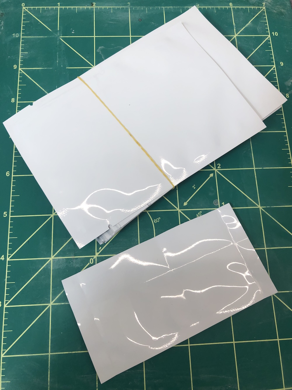

On the subject of home-made pods: the PE coated paper isn't sufficiently oxygen proof to last for more than a few days; the developer oxidizes inside the pouch.
I bought some mylar foil pouches on Amazon (top) which material is more gas tight. They make adequate pods (bottom). Creating the rupturable seal is harder to finesse with the heat sealer - if the seal is too secure then the whole pod rolls through the developing machine without bursting. But it is possible to get it right.
I also found a supplier of PE coated aluminium foil which sounds appropriate. I have some on order, and will make a post when I've tried it as pod material.
