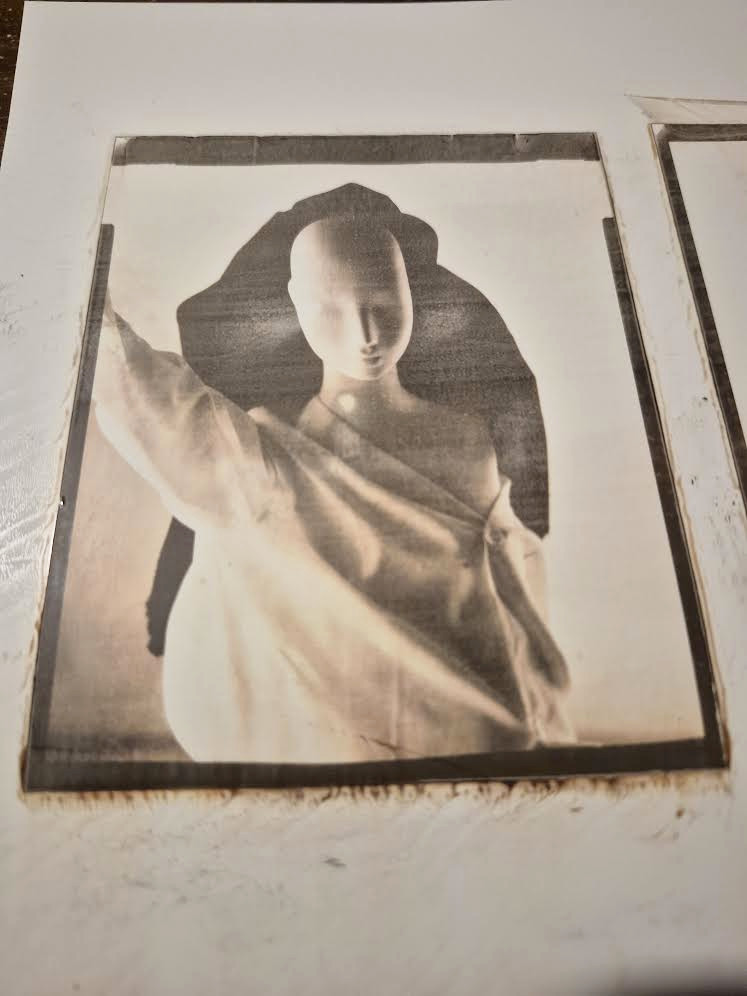

The state of play is that I have a single combination of film, developer and receiver paper that produces good positive images.
To summarize the things I'm still working on, or would like to find:
A developer that uses more traditional thiosulphate/phenol-based chemistry, which would be more accessible.
A stripping layer that helps residual developer peel off the positive more cleanly. At the moment the very thin layer of developer that remains can crystalize and produce white powder or haze on the surface of the print (salting out). This can be prevented by rinsing or wiping the print, but it would be nice to avoid that need.
Alternatively/additionally a volatile silver solvent, or one that works at a lower pH than uracil/thymine and other cyclic imides, which would reduce the solids left on the surface of the print.
If anyone wants to help with these, that would be very welcome.
Indeed, you have accomplished amazing results for one person that what work very well. I have had good results from the material and would be quite happy to use what you have produced up to now. I did make up some developer to a partial recipe you published earlier in the thread using regular development ingredients but the result was weak and yellowy.
I don’t have the resources now to pursue, either in chemistry (my knowledge is over 40 years forgotten) nor in space and equipment. I can make up my own developers to known formulae but that’s about it. A serious health issue has re-surfaced as well so am on treatment again which will impact my time for projects.
I must say I didn’t notice much of a residue on my prints but having said that I just tried rinsing a few of them and yes it is noticeable. But working in a darkroom and having to rinse the paper is not a problem. More worryingly is that with the papers I coated the image will rub off under water.

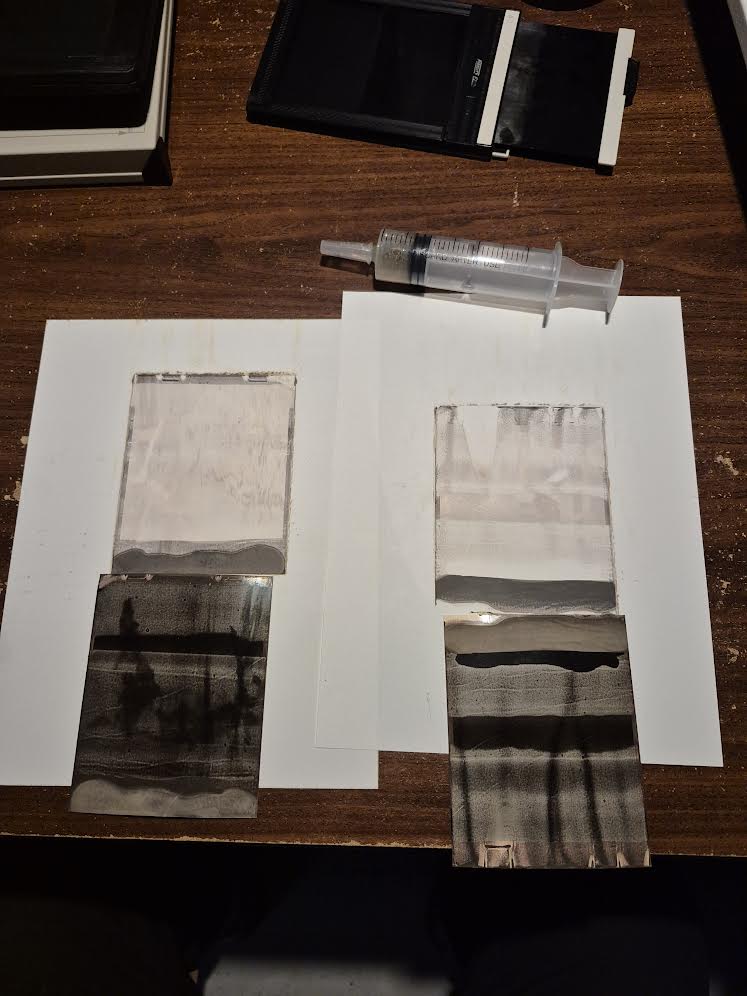

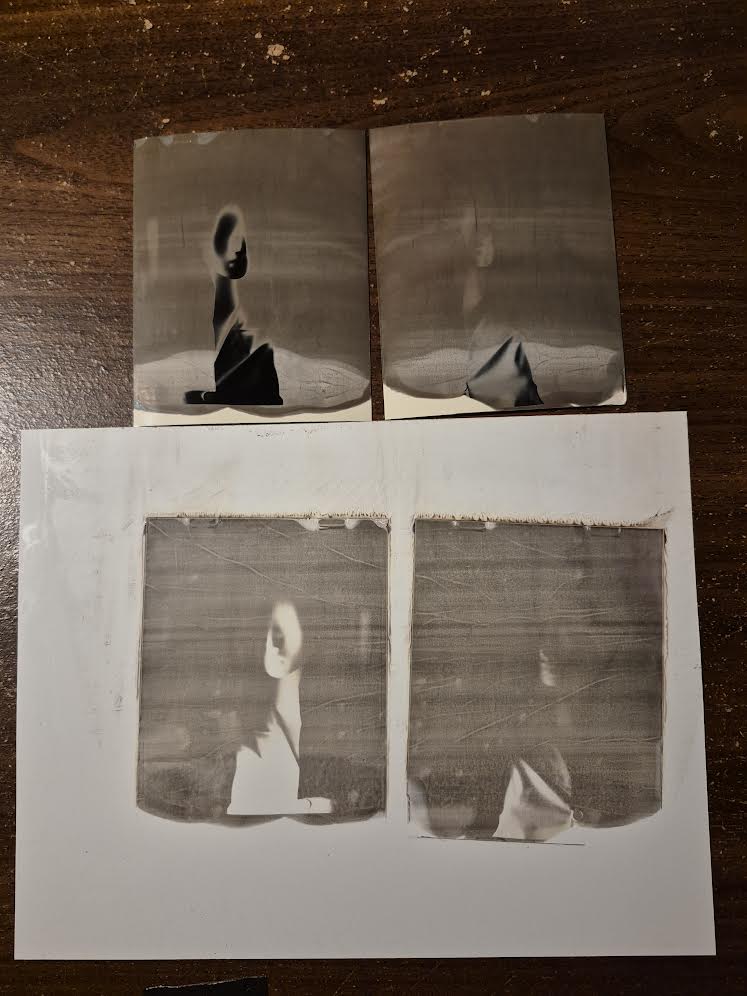

This was the first two results I got.
I'm not sure what's wrong.
For developer I made:
21.87 g of water, added the 2.5 g of NaOH, stirred, then added 0.625 g of CMC and mixed with the drill and painting stir bit.
Then, added 2.5 g of Uracil, 1g of DEHA, 0.5 grams of AEEA and then 0.1 gram of Metol.
For the receiver I made:
10 grams of silica solution with 1 drop of a solution made up of 10% PVP and 90% water (1 gram PVP, and 9mL H2O) to the former I added about half a match head of Sodium Borohydride.
Then, I added 5 drops of the following solution: 0.04 grams of PdCl2, 8 drops of HCl, and finally added enough water to get 40 g total mass.
Alec, from your last post, it seems I'm not using enough PdCL2 for the receiver, but then how come I'm not getting an image on the negative film?
If anyone has any advice from experience and looking at the image below, I would be very grateful.

This looks all wrong.
The PdCl2 needs about 1/3 as much Muriatic acid as water, added dropwise, to the water, under stirring, to dissolve. And it takes a while. You should end up with a yellow/brown solution, somewhere betweeen pee and malt whiskey. No brown powder left at all.
Add the sodium borohydride after the PdCl2 solution is mixed in with the silica sol. You should see a rapid darkening.
Thanks Alec for the advice on the receiver.
Can you help explain why I didn't get any image on the film?
How would I troubleshoot this?
I'm dumbfounded, and have no idea what to try.
Thanks :smile:
Perhaps because the receiver wasn't correct. The presence of the receiver is vital to removing silver from the unexposed areas of the negative. Without the correct process occuring to deposit silver into the receiver layer, the silver stays in the negative and you won't get an image. That might not be the only problem, but the developer gel alone isn't enough to give an image, I don't think.
Also your rolling looks terrible. What on earth are those black stripes? Are you using a laminator?

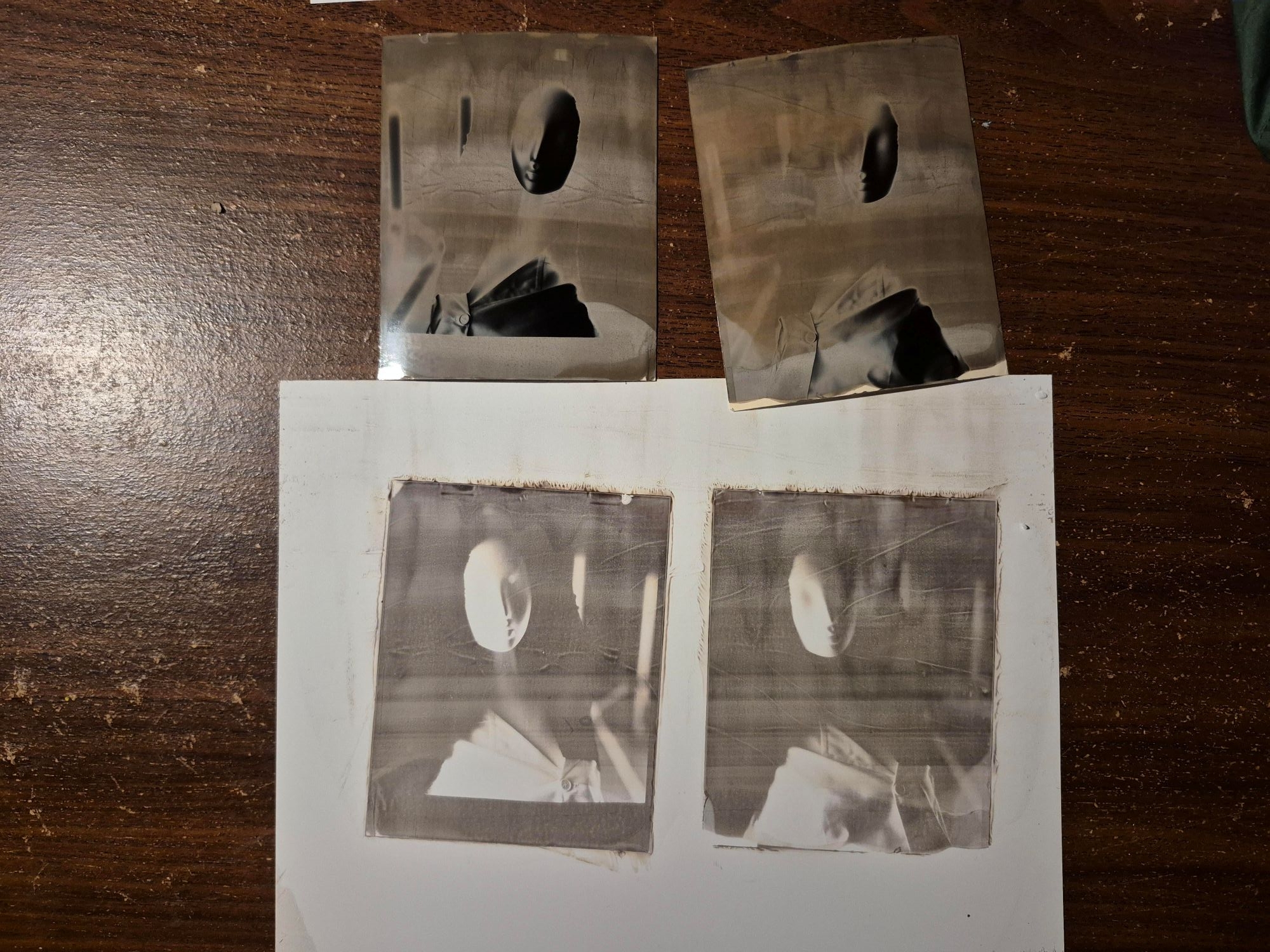

Hey Alec,
Oh, okay. I will try again mixing the chemicals tomorrow.
I was daft to assume the developer would make an image on the film side.

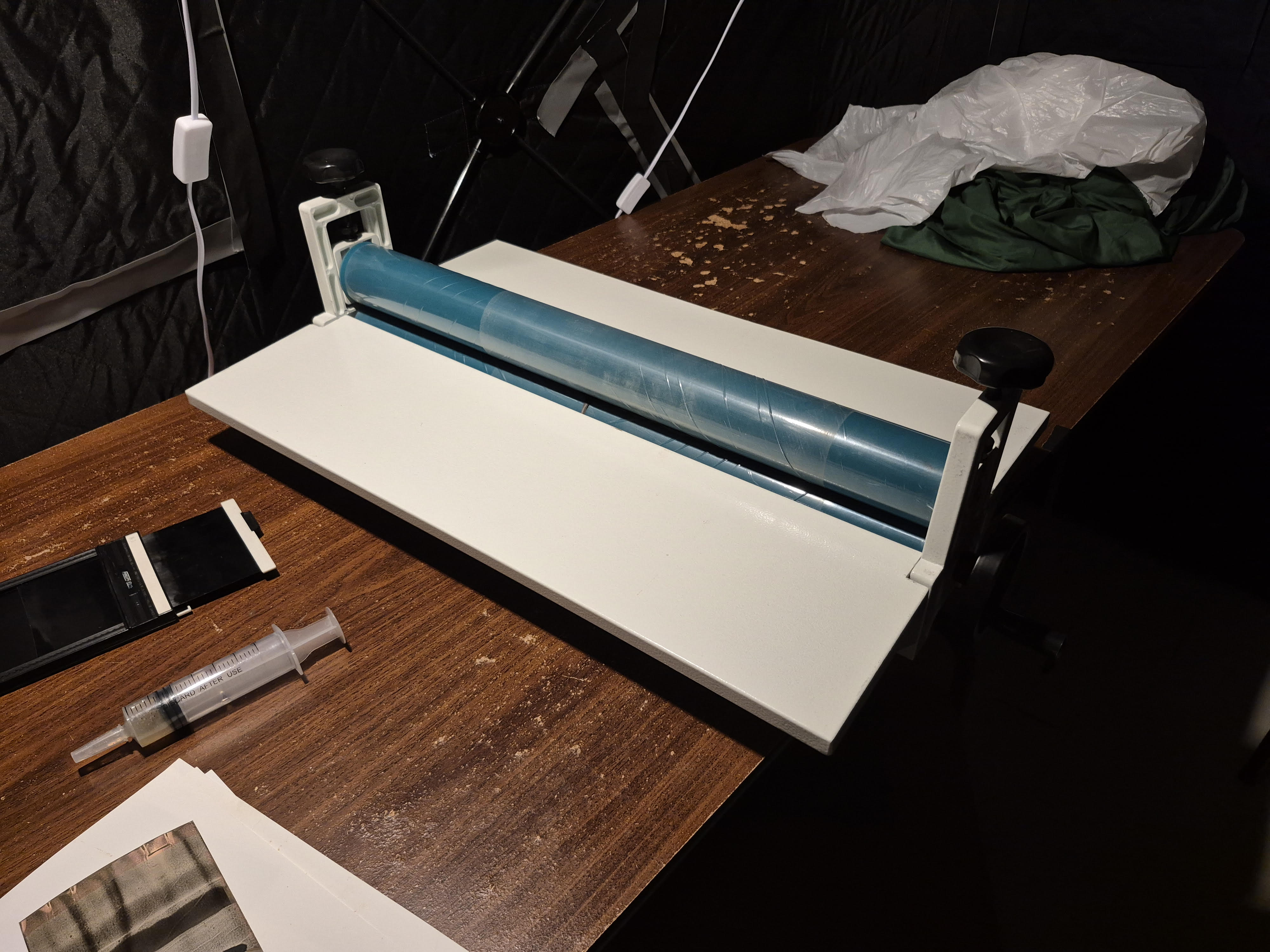

I was in email contact with someone who helped do the initial tests for the New55 instant film. They described their formulation, similar to your early ones, as being a mono developer. Develop, stop and fix all in one.
Yes, I am using a laminator, but I found it hard to roll the paper through with a smooth consistency.
When you use laminators, is the setting on in a way that there is tremendous pressure on the two sheets?
I have the gap between the rollers set at finger tight and this prevents me from getting a nice flow to the sheets moving past the rollers and this causes jitters (slow and go).
I tried that laminator and found it wasn't very good. When using "no rails", the development happens in the pool of developer just ahead of the rollers, and when the paper and film sandwich has passed through the rollers the developer is mostly squeezed out and no further transfer occurs. So the rolling process has to be very slow, about 1 minute for an 8x10 sheet. To use that manual roller then you have to go very very slowly, and very evenly, which is difficult to do by hand. The small electric office laminators have the advantage of being very slow using a high torque gearbox that keeps the speed even, and so they work better.
The pressure of the rollers doesn't seem to be critical as long as it is enough to squeegee out most of the developer.
That's just my experience of course, your experimentation may show something different.

Do the small office laminators use two motors, one for each roller.
Perhaps both rollers are linked together?
I ask, as I'm now looking for a wide enough electric roller, I want to know if it's okay if only one roller is powered.

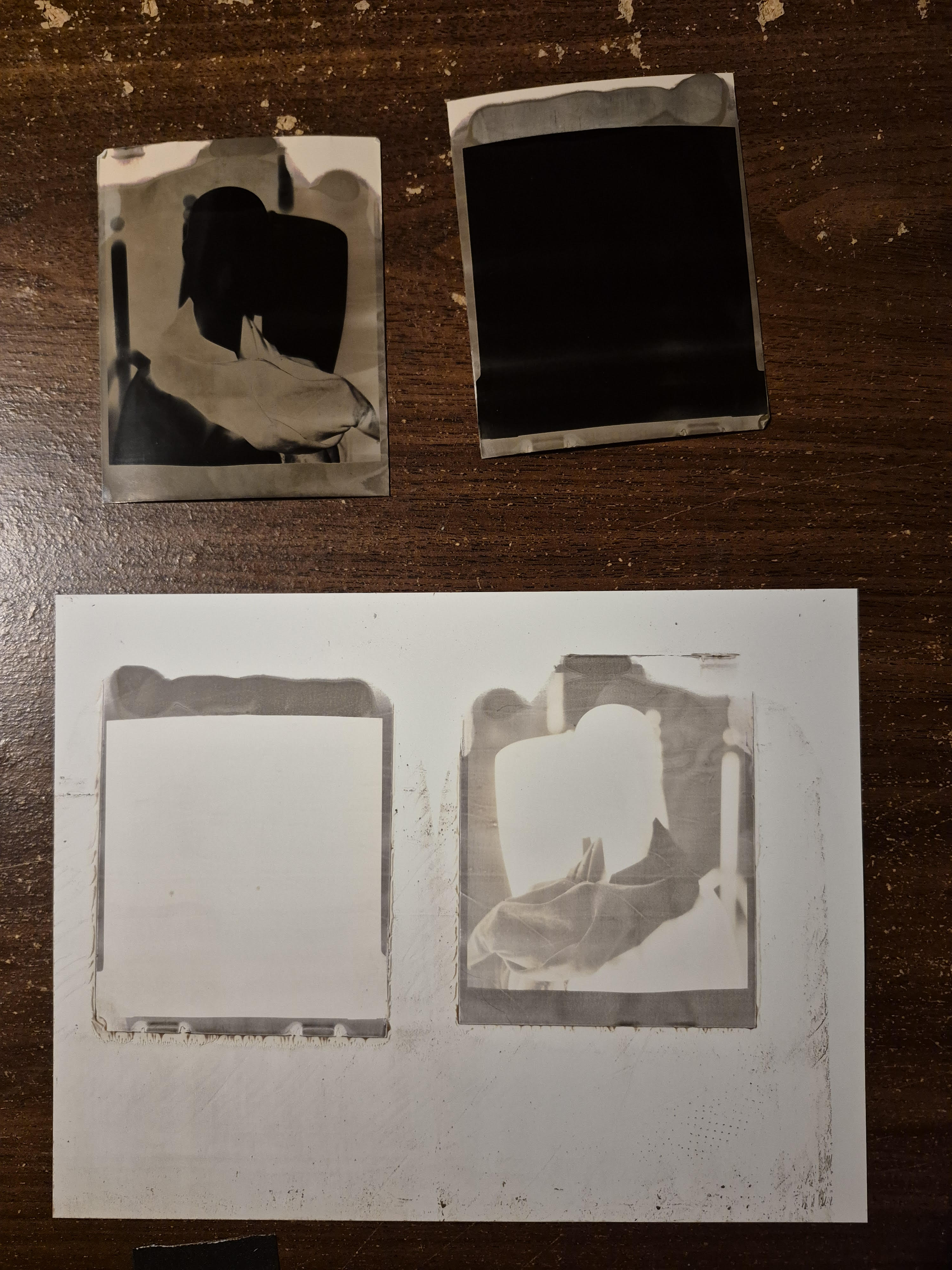

Hey everyone and Alec,
Wow, I got an image, It was so exciting to experience the peel and see density.
What I did different above (not the color image) for the two images was to decrease exposure from 1/4 s (bottom image on the right),
to 1/15 s (top image, left side) and 1/60 s (top image, right side).
Furthermore, I slowed the rolling so that the length of the 4x5" sheet took 30 seconds, as well, I added a bit more developer and tightened the rollers.
(disregard the organic looking diagonal wrinkles, that's the protecting covering on the rollers that came with the laminator, I'm keeping them on for now to help longevity of the laminator. Note, I am cleaning the rollers each time).
Looking at the results, it seems contrast is an issue. Whites, are blown out, and blacks are too dense.
Should I use less uracil as it's the silver solvent?
Would one want to develop for 60 seconds instead of 120?

What I did this time for mixing chemicals:
I doubled this and used a drill to mix very well, for at least 4-5 minutes for each step--->
Then for the receiver, this time, I used the magnetic stir tool:
I added 10 grams of water, then stirred for 5 minutes with 20mg of PdCl2
then added 57 drops of Hcl and stirred for 5 minutes,
Then added the above (5 drops) to 10 grams of silica solution, stirred for 5 minutes, then added the sodium borohydride at about a volume of half a match head. Stirred for another 5 minutes.
Recap: Should I increase the gap between the rollers or tighten down the rollers.
Should I adjust Uracil content?
In people's experience, what does high contrast but not deep enough/dense enough blacks mean?
Thanks everyone.
For reference below is the first two of the night:
1/4 s and 2 s.
15 second roller time and a little less developer than the examples above.
Edit: Two more---->
EDIT:
I GOT a sort acceptable image!
The trick was to use 16 drops of PdCl2/HCl solution.
Alec, thanks so much! This was exhilarating.
Now much goal is to get a neutral tone image.
