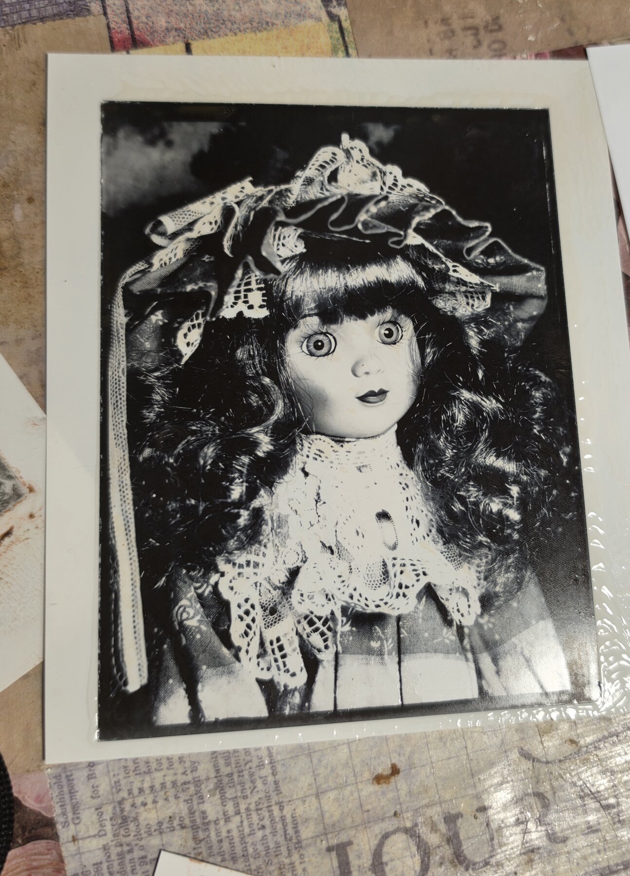

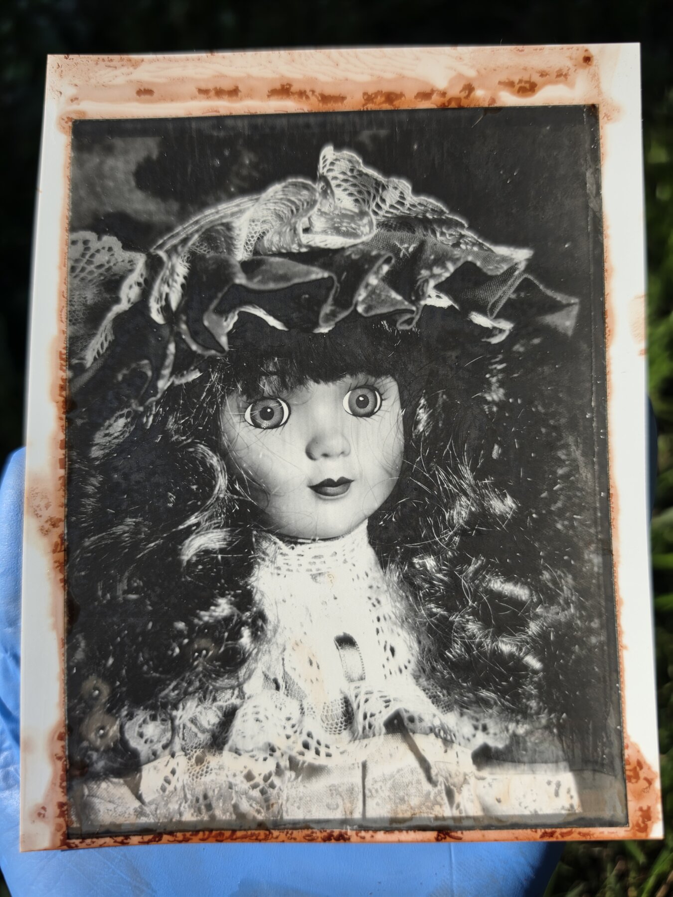

This batch of receiver uses PdCl₂ (palladium [II] chloride) reduced with KBH₄ (potassium borohydride) as the nucleation layer. The detail is excellent - if you zoom in you can see the texture of the doll's shirt.
The Dmax and tone both look excellent.
As far as detail goes - this process is effectively a contact print from a large format negative. The detail should be absurdly fine (and I have some prints where it is). If the detail isn’t eye-popping then there’s something to investigate.

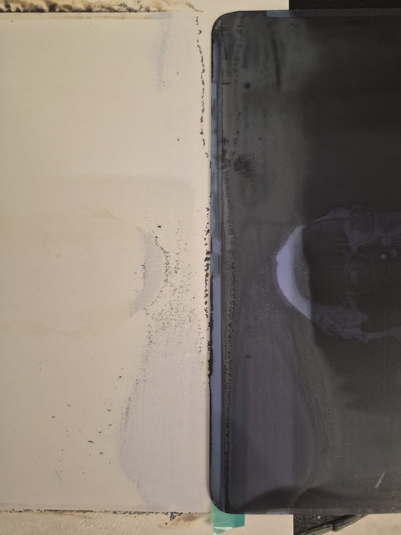

Does anyone know why when I did a test with xray film and plastic paper, the xray film's surface seemed to stick to the plastic paper, leaving areas and specs of black.
I did use a stripping layer of 2% or 5% Gum Arabic on the receiver sheet.

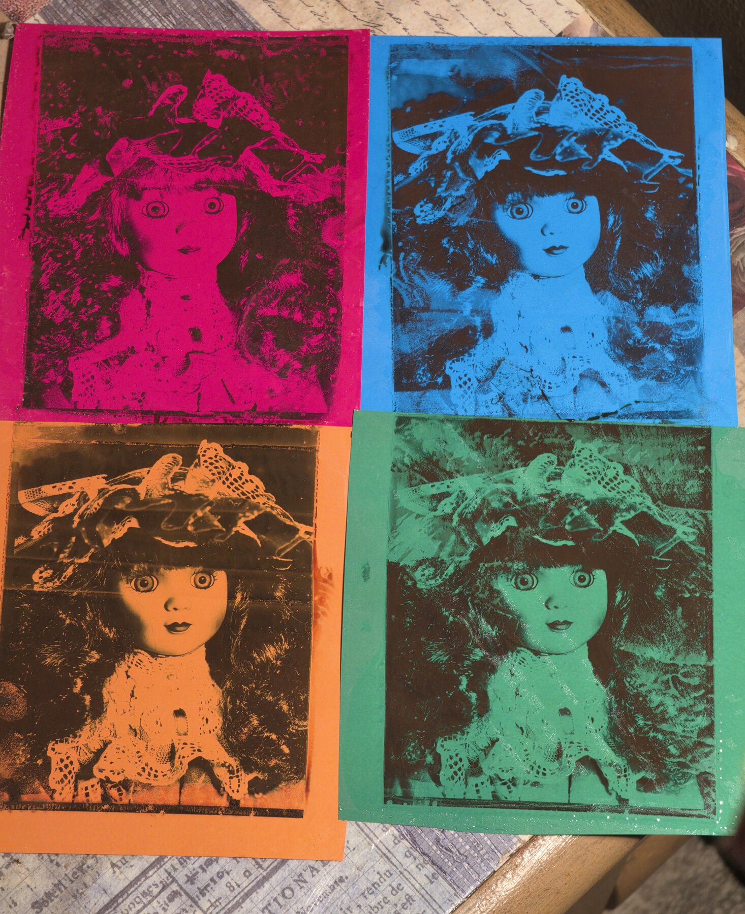

Fun little experiment today. Made some "duochrome" film (like the stuff modern Polaroid makes) with some waterproof paper that comes in different colors.
It was an absolute nightmare to coat onto this stuff compared to the usual (Highh Image) paper, so I doubt I'll do much more of this.

Hey everyone,
I'm back at it again.
2nd motor is in the laminator after the first one's gear box "blew up" due to a hang up in the chain. This time I'm using an AC stepper motor. Thanks to my friend Tony, a mechanical engineer, everything is installed and working smoothly.
Tonight I tried using the Fuji Xray paper, CMC/NaOH/Uracil/DEHA/AEEA/Metol developer, and the Silica/PalladiumChloride receiver.
It looks like I made a mistake during mixing, or during application, or I fogged the xray negative.
But the point of this post is to figure out, why is the xray negative disintegrating and sticking to the receiver sheet. Is one of the chemicals dissolving the negative material?
Has anyone else had an issue with this?
It's quite a distraction for the eye and while I'll probably figure out what my other issues are, this one has me stumped and is concerning.
Your negative looks developed, which to me says it is a problem with the receiver.
What exactly is the brand of paper you're coating onto?

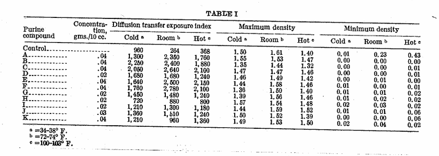

What is the role of mercaptopurine in your latest developer?
I am poor at translating what I have read/learned into something that isn't just word vomit, so I'll just link the relevant patent...
here's a table from the patent. Compound "B" is 6-mercaptopurine.
The idea of the purine compounds was to give better images across a wide variety of temperatures. I am more interested in the increase in "Diffusion transfer exposure index" (read: effective ISO/ASA) they give.
More testing required! A majority of my nights the last several weeks have been spent wading through dozens and dozens of patents, cross-referencing various compounds and then seeing which of the most commonly mentioned compounds are actually attainable. I have a short list, none have been mentioned prior in this thread. It'll take me some time, but I'm enjoying the work.

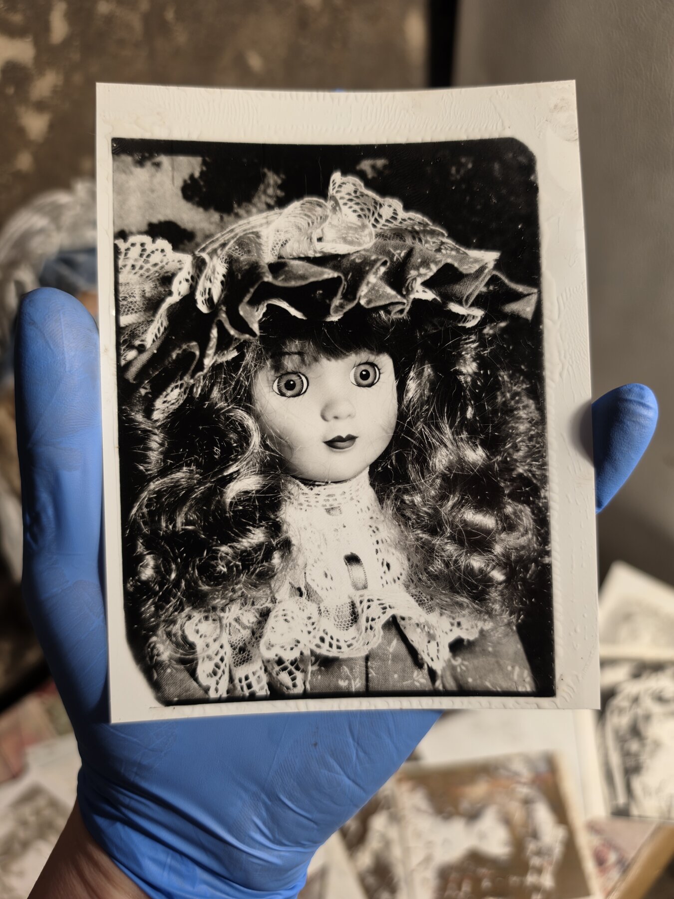

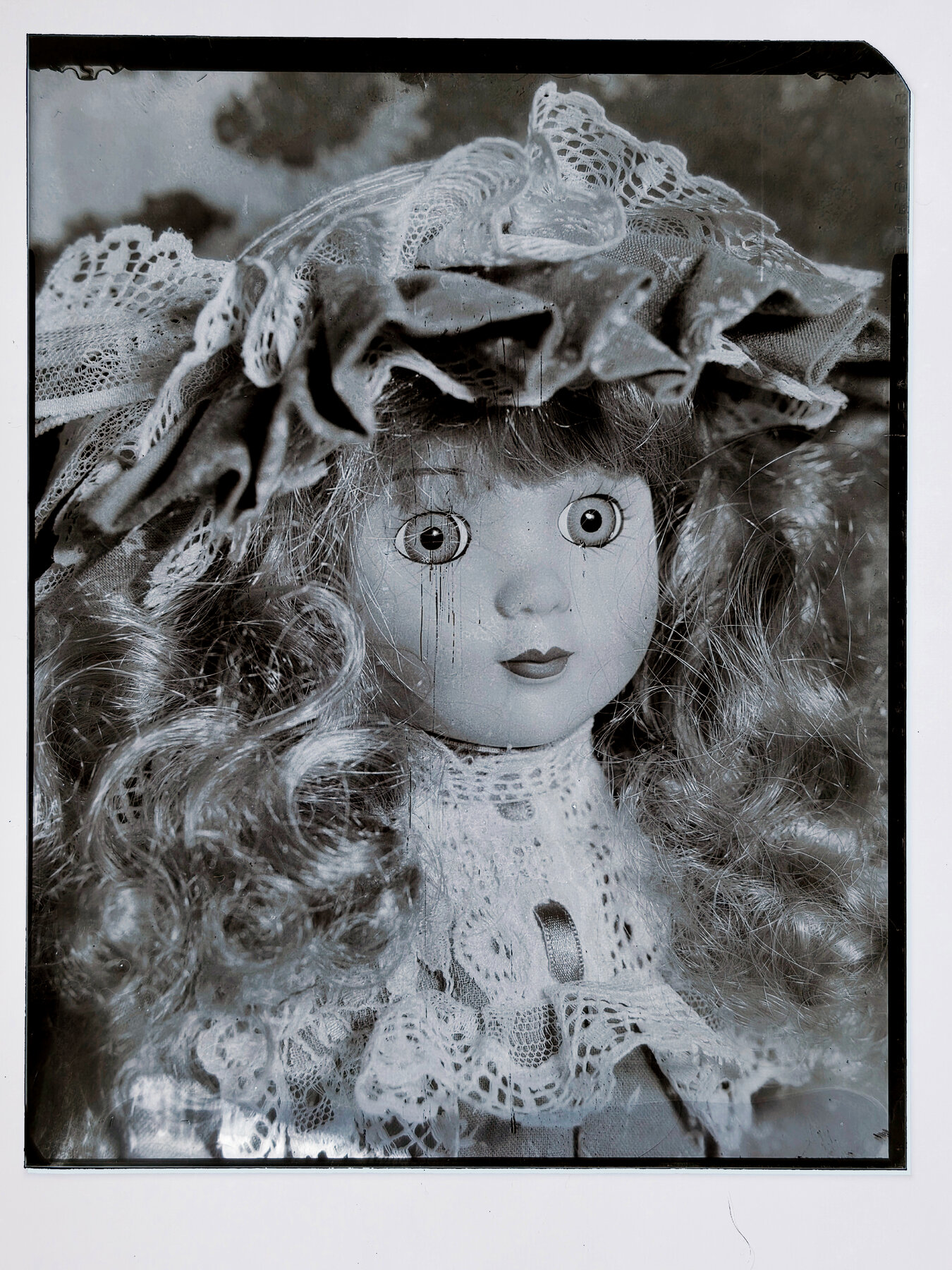

Great results tonight using Agfa CP-GU M (Ortho x-ray) as the negative. Exposure index was around 800.

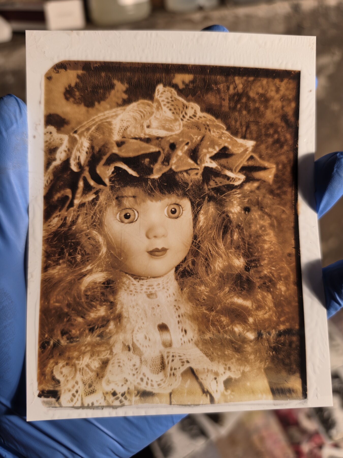

Last night I unintentionally made some sepia images. I find it very pleasing. I would love to have it as an option, so I will work on finding out if I can replicate it consistently.
The diffusion transfer print...

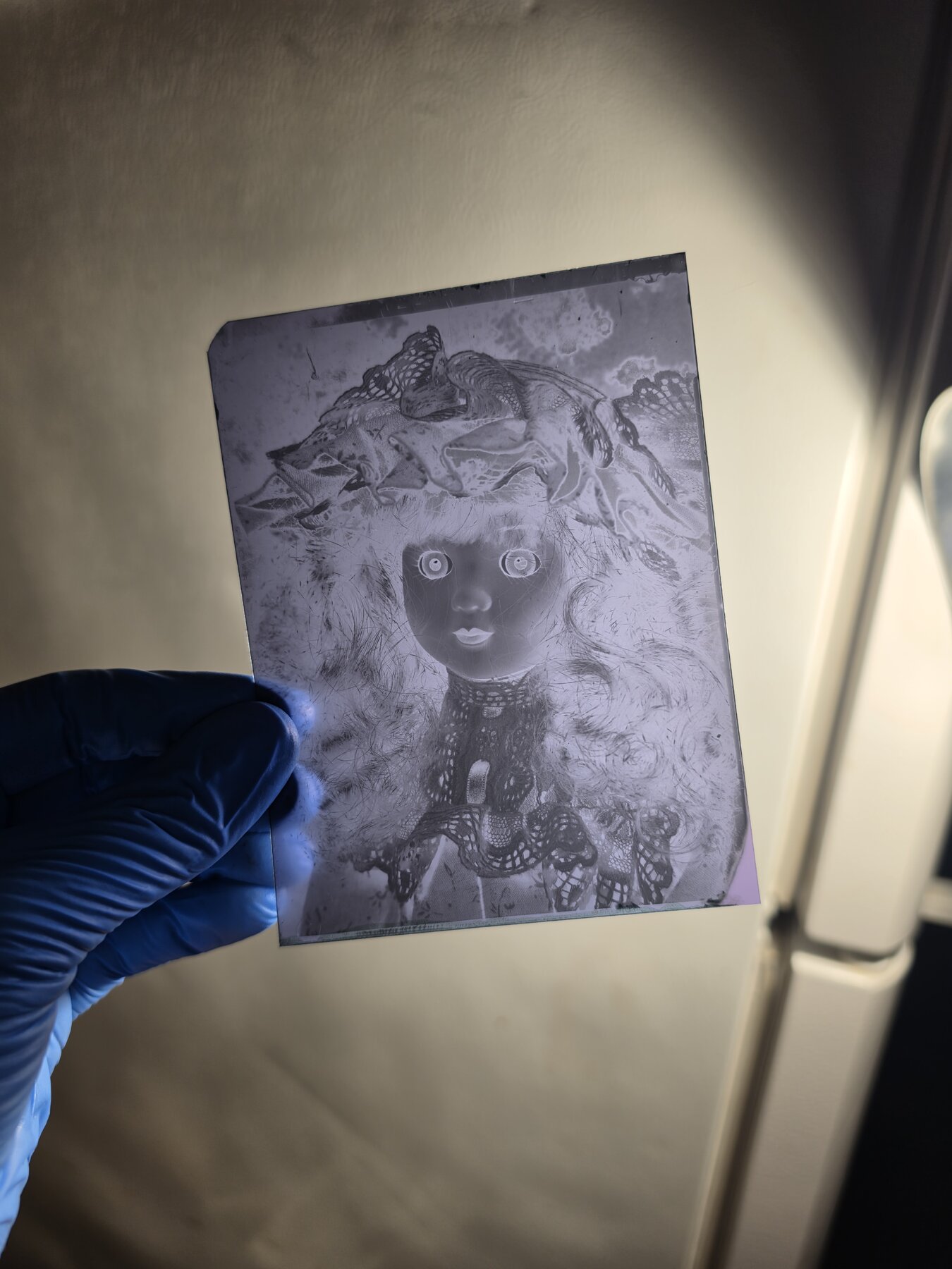

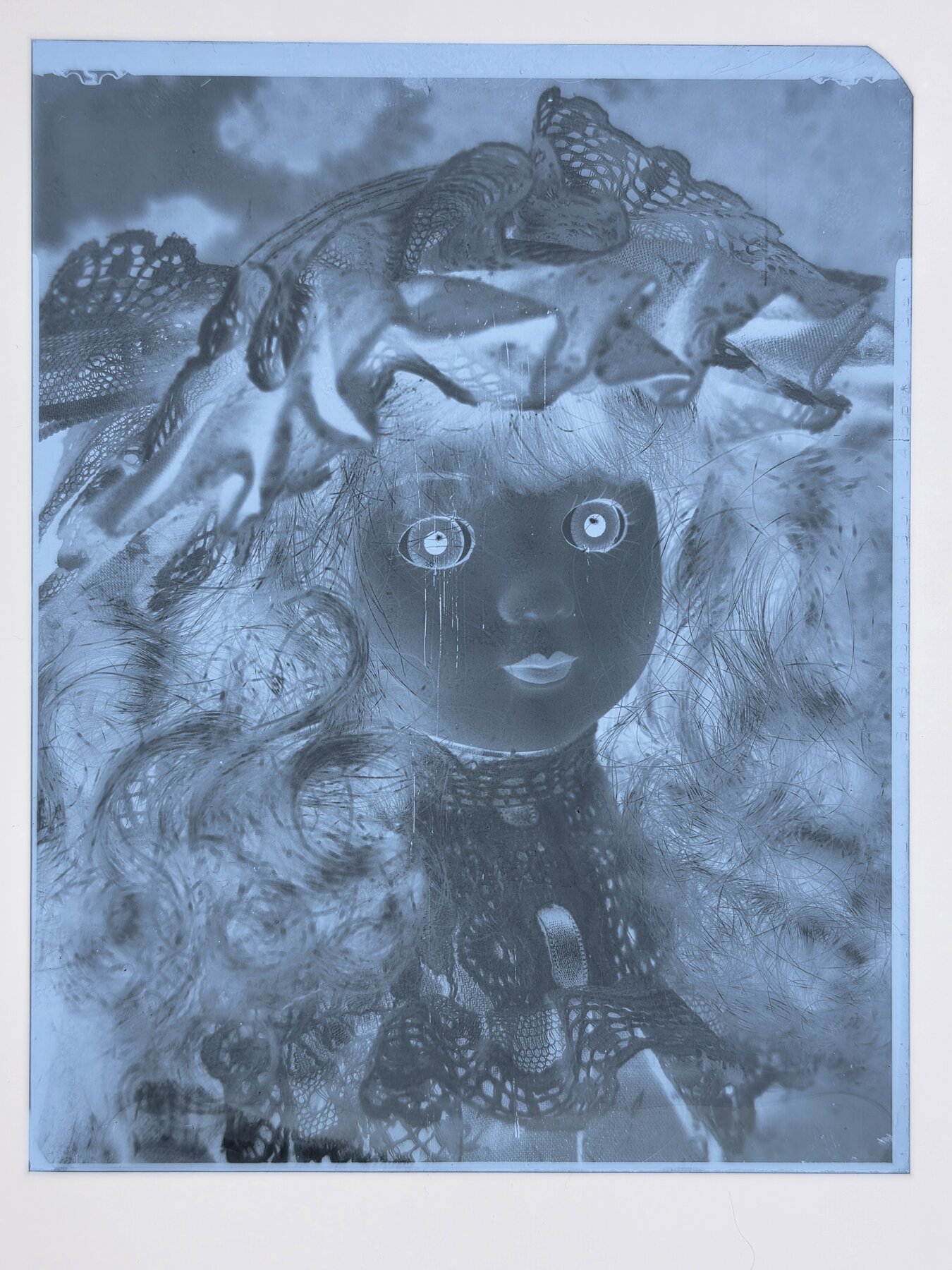

...the fixed negative from that DTR print (Agfa CP-GU M) on a light table (phone pic)...

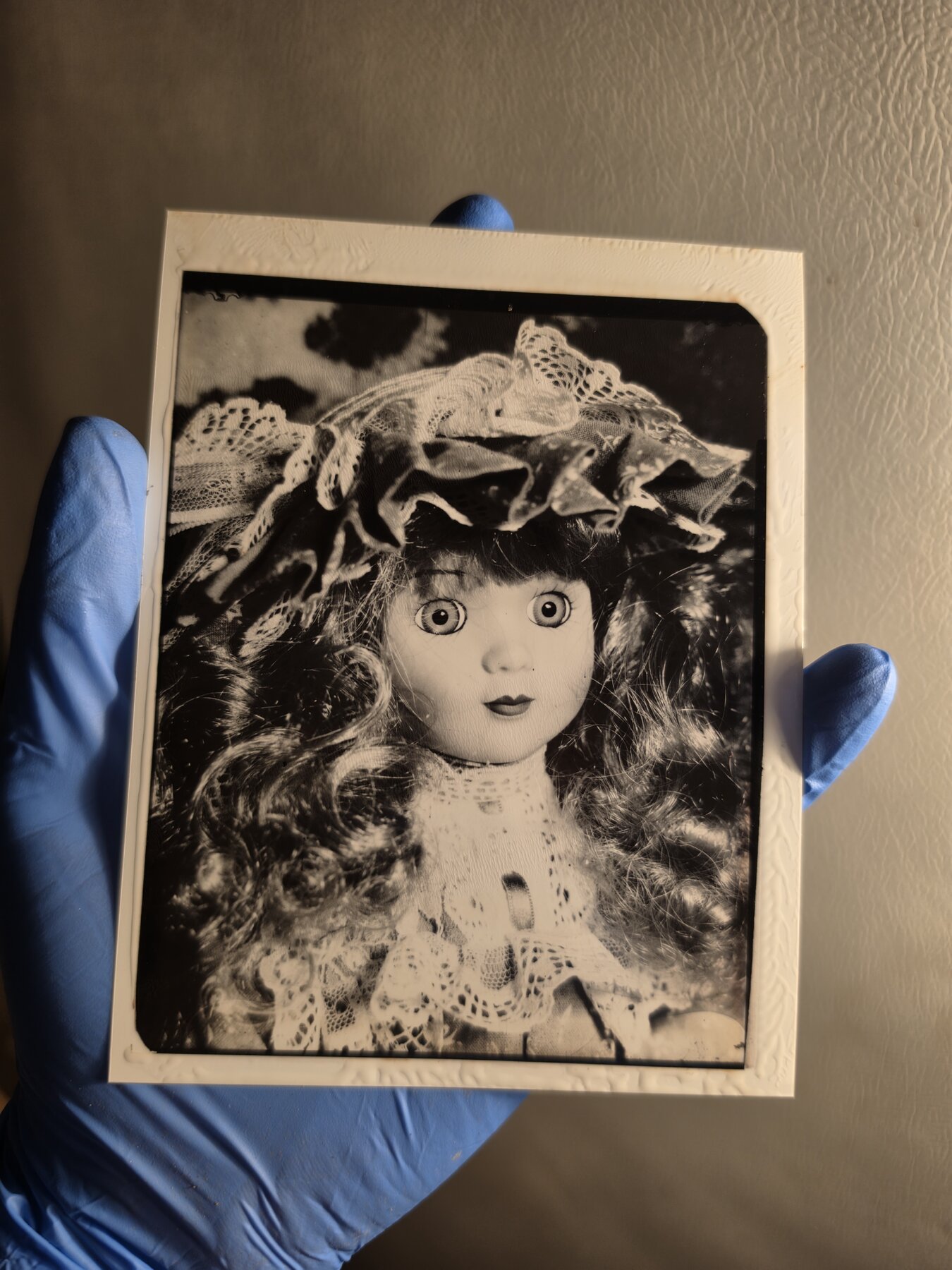

...and a quick and dirty inversion of that phone pic. Pretty neat!
