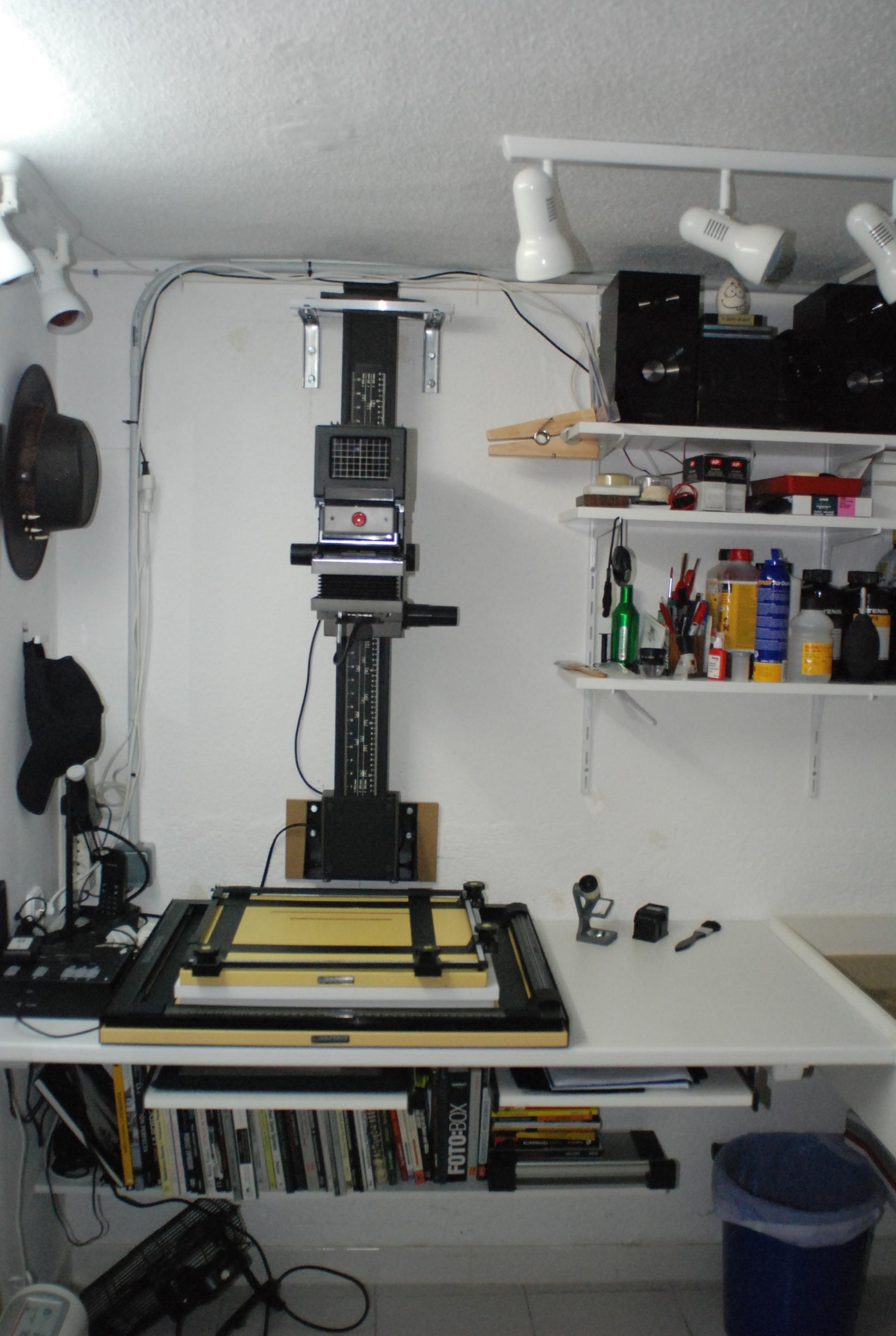

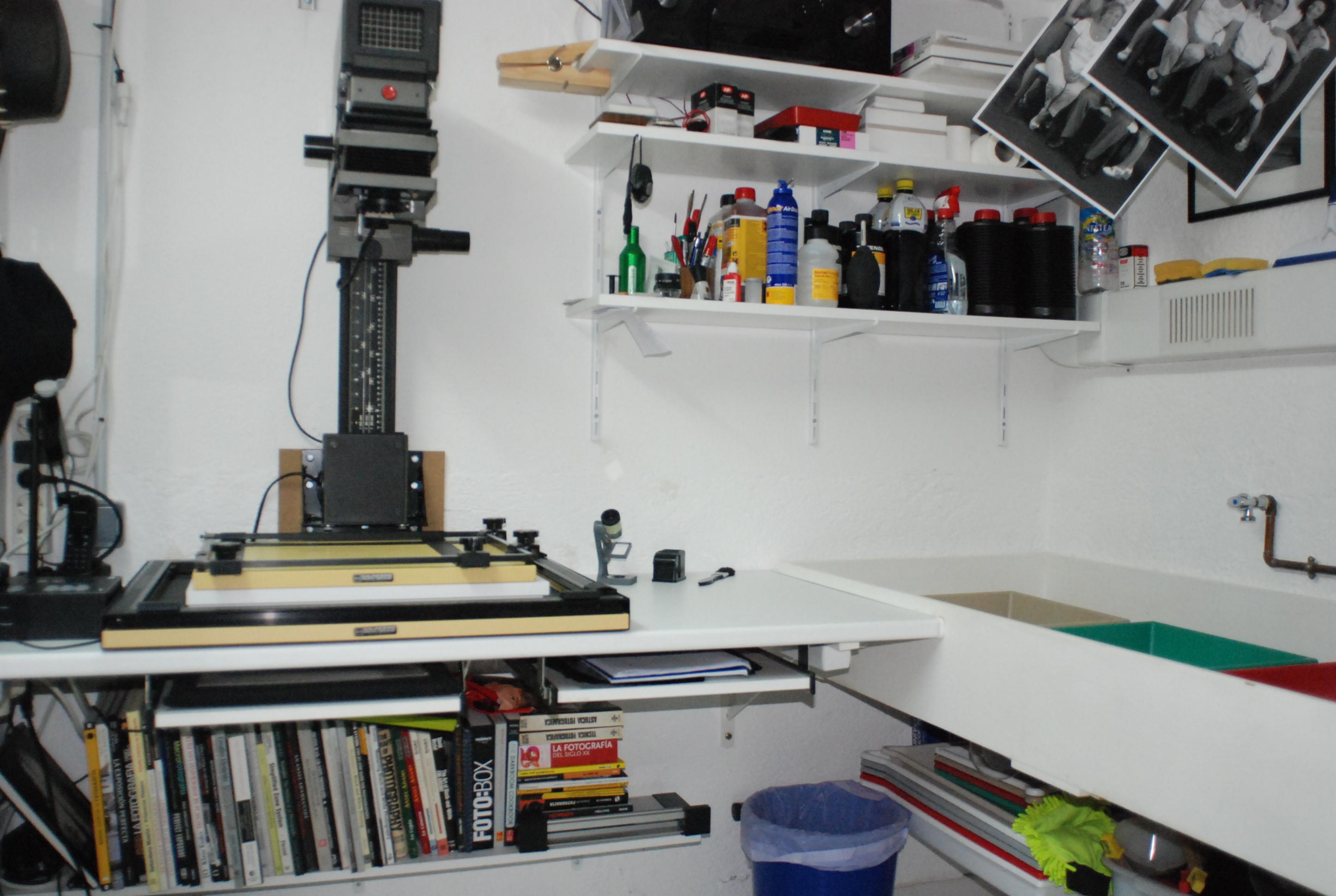

This is my new darkroom, and even though the area is exactly the same than always, I have introduced some improvements. First of all, I have put a wood sink that my brother Saver made for me. It is 1.75 m x 0.65 m x 0.20 m. It has a lot of special resin layers and it has been reinforced with fibber glass. Second, I bought the 12x16 Nova Washmaster-ECO Archival Print Washer and I put it on a metal support above the sink, just at the right hand. Notice that the water do not drain trough the sink, as the hoses go directly to the drain pipe. In third place, I have put a ventilation system. I used a vent that can move more than twenty times per hour the total volume of the darkroom (Just in case, this is the vent I bought: Soler & Palau TD-350/125 SILENT). The air is exhausted trough plastic pipes directly to the backyard. I also bought a 12x12 Doran Heavy Duty Darkroom Light Tight Louvers in Adorama, and I put it at the door.
I keep the rest of the equipment: Meopta Opemus 6 printer, RH Designs Analyser Pro, etc.

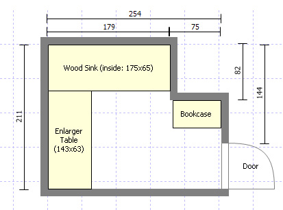

Now, I am able to print both RC and Fiber Paper. My Meopta can print as big as12x16, and I can put four trays inside the sink, so I can work with two fixer baths when I make 12x16 baryta base printers.
I am annexing some pictures in order to show you how my new darkroom looks like. They are not very good, but you can see how the sink looks like, the dry side and the wet side, the washer support, the ventilation system, and what things are located just under the sink.
Finally, I want to thank all of you that gave me ideas about how to ventilate my room when I asked for help to the forum, and mainly to my brother Saver, who made the wood sink and help me to put everything in its place.

This is my actual darkroom. It is simple and small, and it is perfect for printing as big as 12x16 FB papers. However it is possible to print 16x20 if it is necessary.
The enlarger is a Durst M805, condenser one, mounted directly to the wall and working with my Analyzer Pro from RH Designs. The wood sink (1.75 m x 0.65 m x 0.20 m) has a lot of special resin layers and it has been reinforced with fibber glass. I also have the 12x16 Nova Washmaster-ECO Archival Print Washer and I put it on a metal support above the sink, just at the right hand.
The darkroom has a ventilation system. I used a vent that can move more than twenty times per hour the total volume of the darkroom (Just in case, this is the vent I bought: Soler & Palau TD-350/125 SILENT). The air is exhausted trough plastic pipes directly to the backyard. I also bought a 12x12 Doran Heavy Duty Darkroom Light Tight Louvers in Adorama, and I put it at the door.
I hope this information could be helpful to people that have small rooms available to become darkrooms.

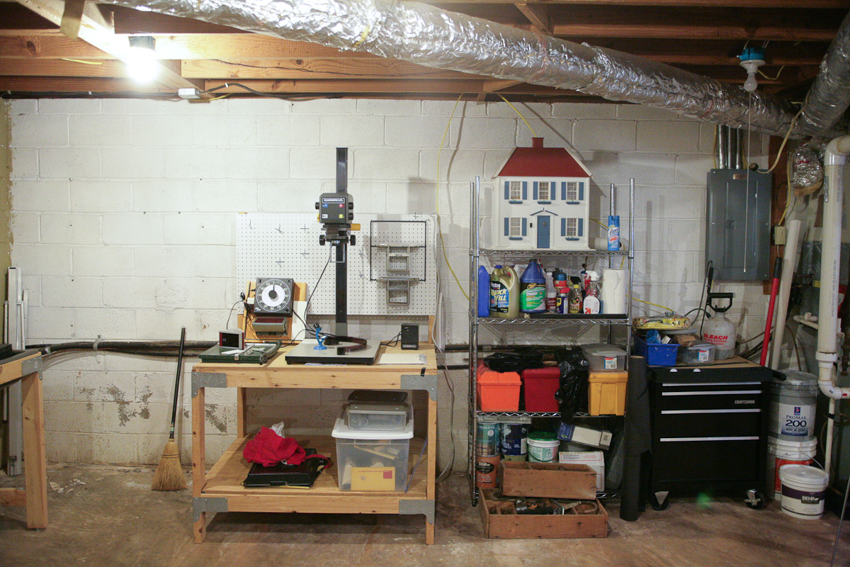

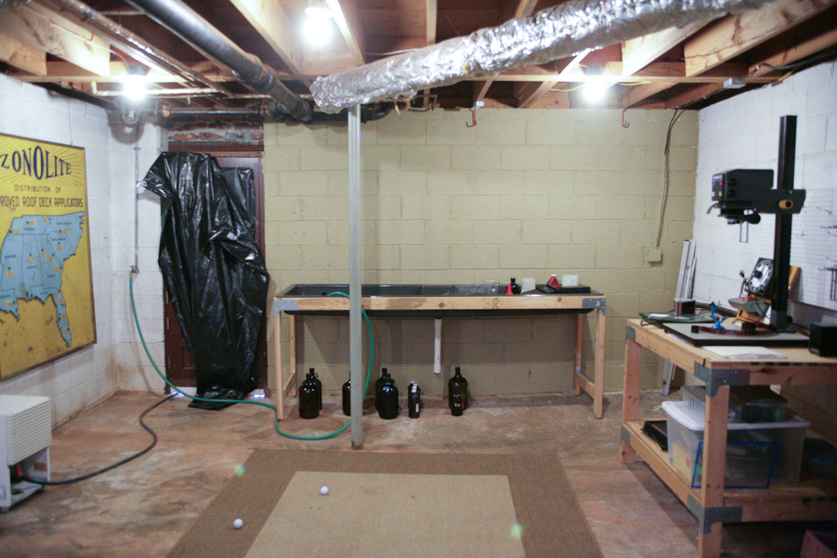

I recently got this sink off CraigsList and built a base for it. Drains into a bucket. Decent for making contact sheets in its current setup, but the sink will hold four 16x20 trays and I'd like to make real finished prints. Under the sink will be one more shelf for trays and chemistry, high enough to fit large plastic storage boxes on the floor.
The table with the LPL enlarger is built by me, too. Drying racks go underneath (currently being reconfigured).

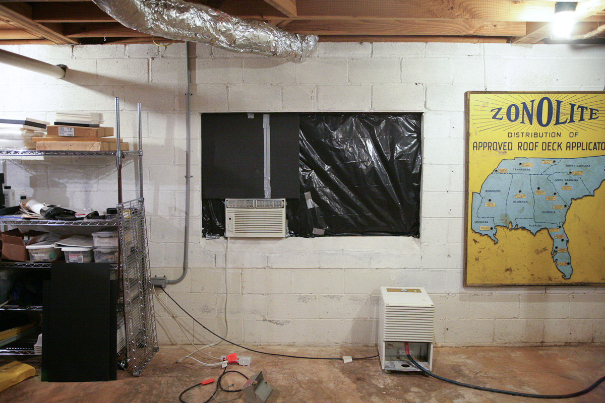

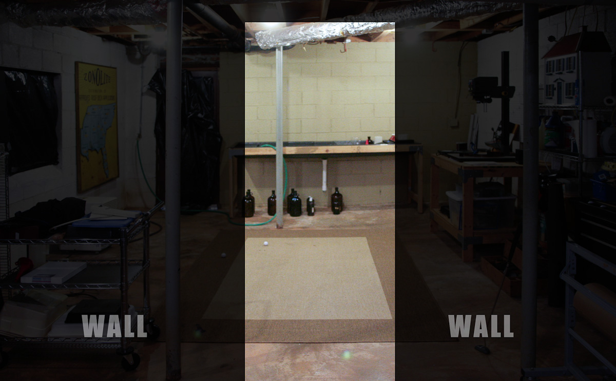

So as you can see from the photos, I have a great space in my basement that measures a whopping 16 feet square. There is a very natural space where a wall can go (bit tricky to build around existing ductwork, but shouldn't be too much trouble). Window on the left houses an A/C unit and is very easily blacked out, as is the door. A/C can provide lots of fresh air, and the wall behind the sink goes directly outside, so ventilation should be fairly easy to install.
The three overhead lights will be converted to pull chain fixtures for lights and safelights. I will add power wherever needed via the electrical panel in picture 3. Water lines can be tapped right above the sink, which is our master bathroom. Drain lines are also accessible for a sump pump. I'm very handy with plumbing, electrical and finish work.
I'd love to "crowd source" this and tap into all of the expertise at APUG. Is 16x16 too big? The space can be smaller, though building the wall would be more difficult. I also have a 20x24 dry mount press and would like to have a finishing area. My only concern was that perhaps that should be outside of the darkroom area, but if I can fit it in and the room is well ventilated, I hope that might not be too big of an issue.
Let me know your thoughts. All feedback will be greatly appreciated. :D

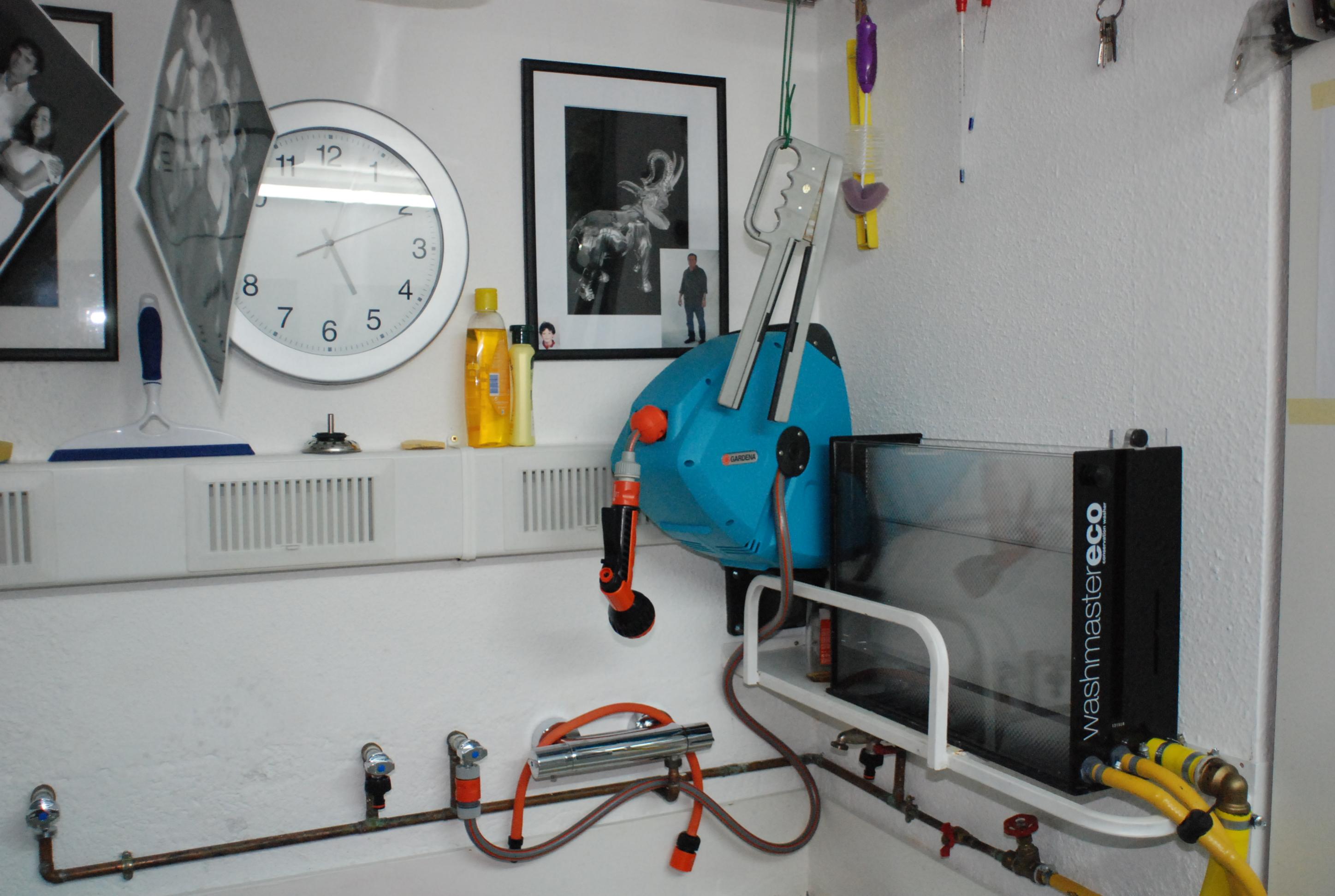

well I gotta say this is the first time I've seen a Gardena hose reel in a darkroom :wink: The spray handle attachment would make cleanups a breeze though !

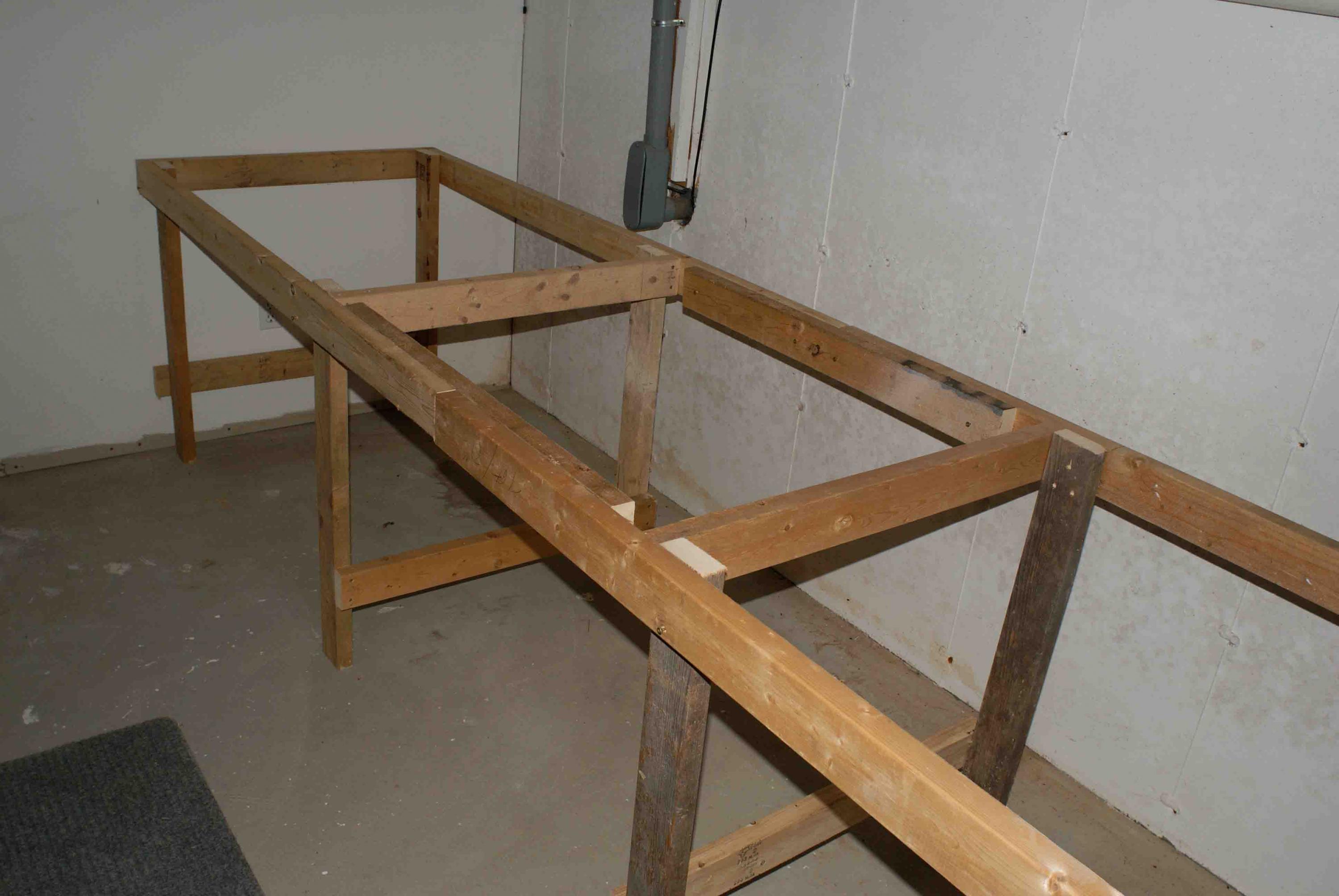

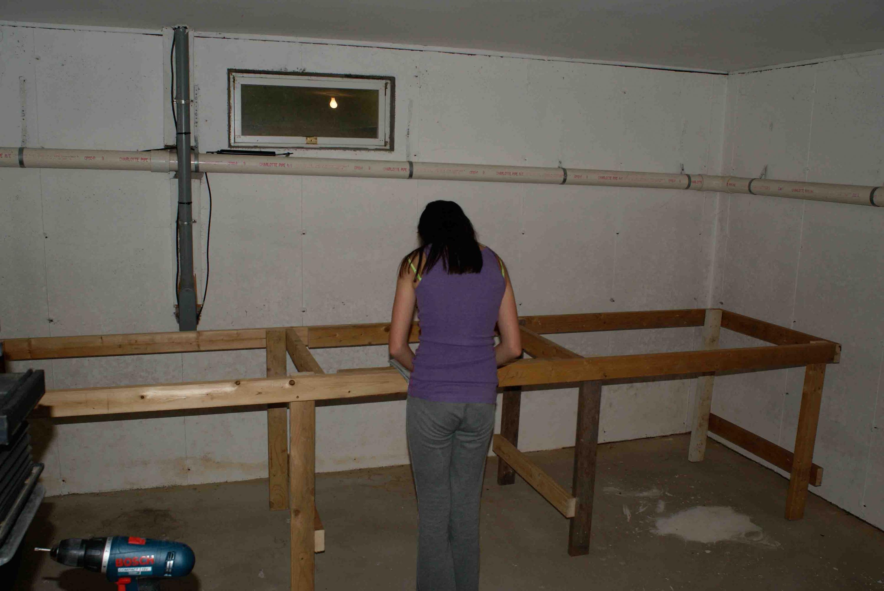

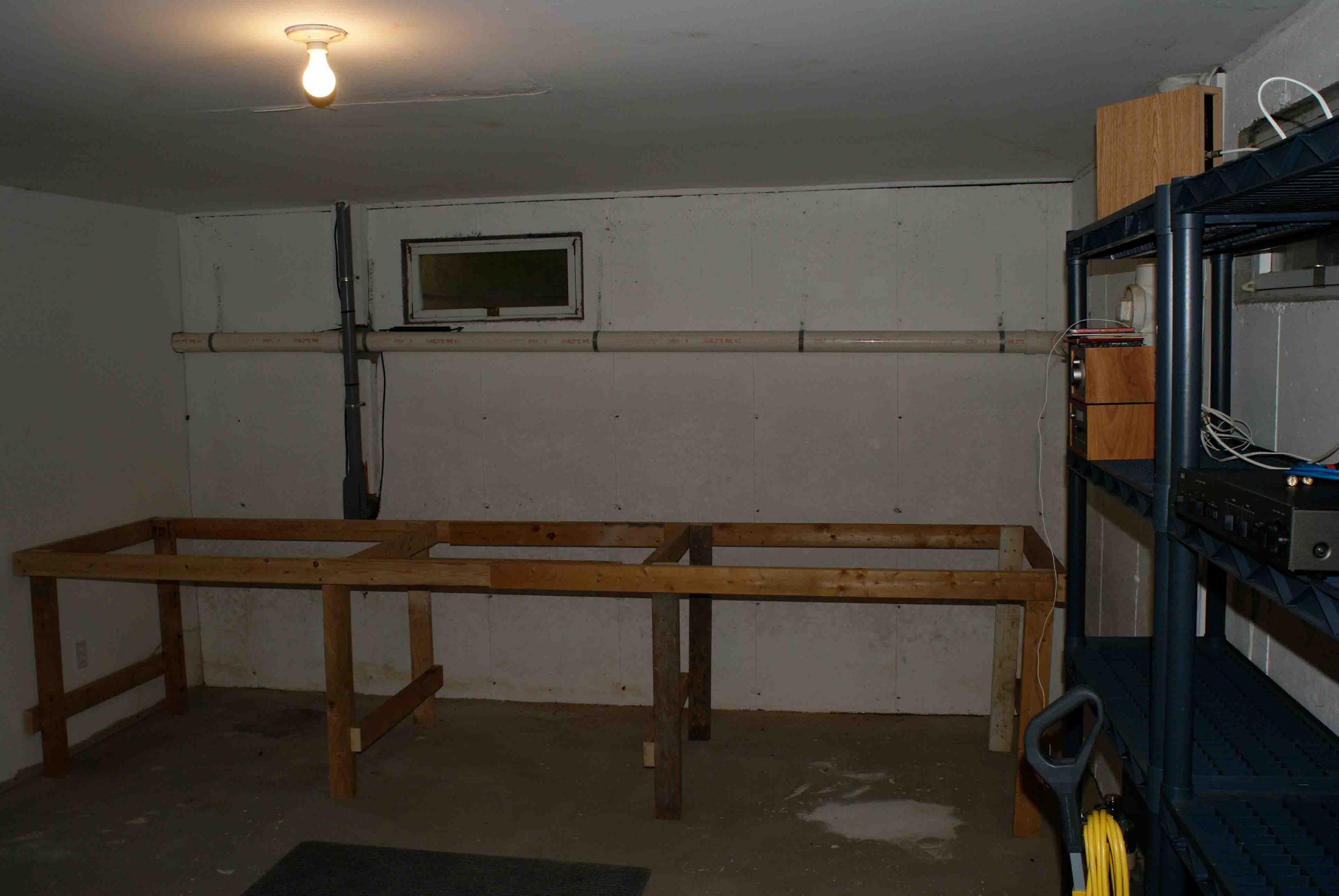

... in a 13' x 17' basement space.
*** QUESTIONS ***
o What inline fans do people like for ventilation?
o What do people find are successful systems for water temp control?
