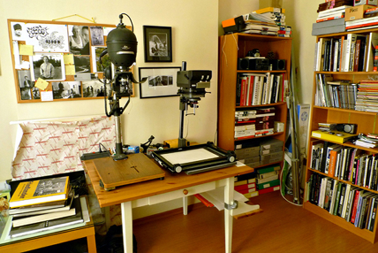

A couple of pictures from my darkroom.
The dry side has two enlargers, one Focomat Ic and a Meopta Opemus 6 with Meograde head. The Meopta is my workhorse; a great enlarger for relatively little money. It does up to 40x50cm on the baseboard. Enlarging lenses are a 50mm EL-Nikkor for 35mm and a 80mm Schneider Componon for 6x6.

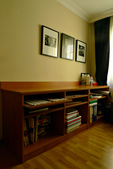

The wet side isn't that wet really. I don't have running water in the darkroom, and frankly never missed it as the bathroom is just opposite and I do all the washing there. The bench is custom made to fit the room and my requirements. It has four drawers on rails to dry prints. I really should have added a few more. The lower compartments contain all the paper, trays etc.
The darkroom is just one smallish room in my house. It even has a door to a small balcony which I use for ventilation.

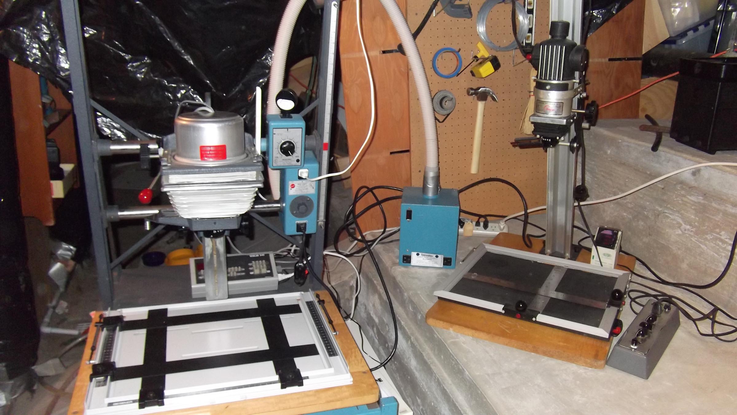

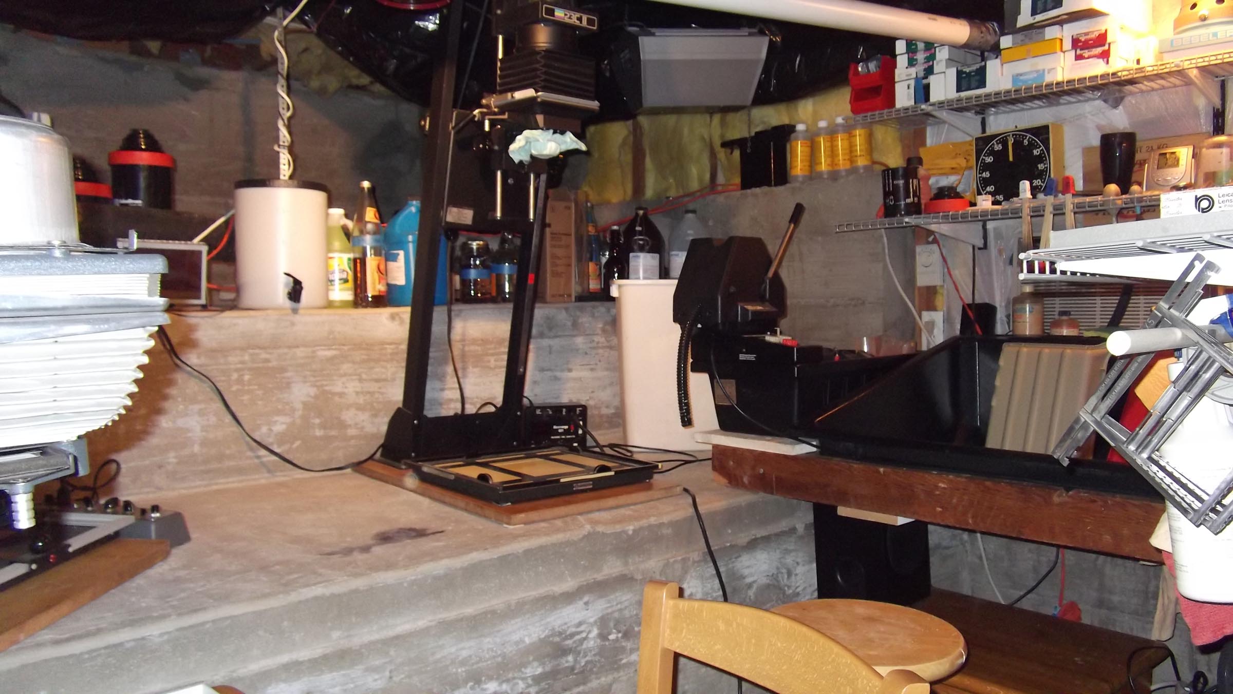

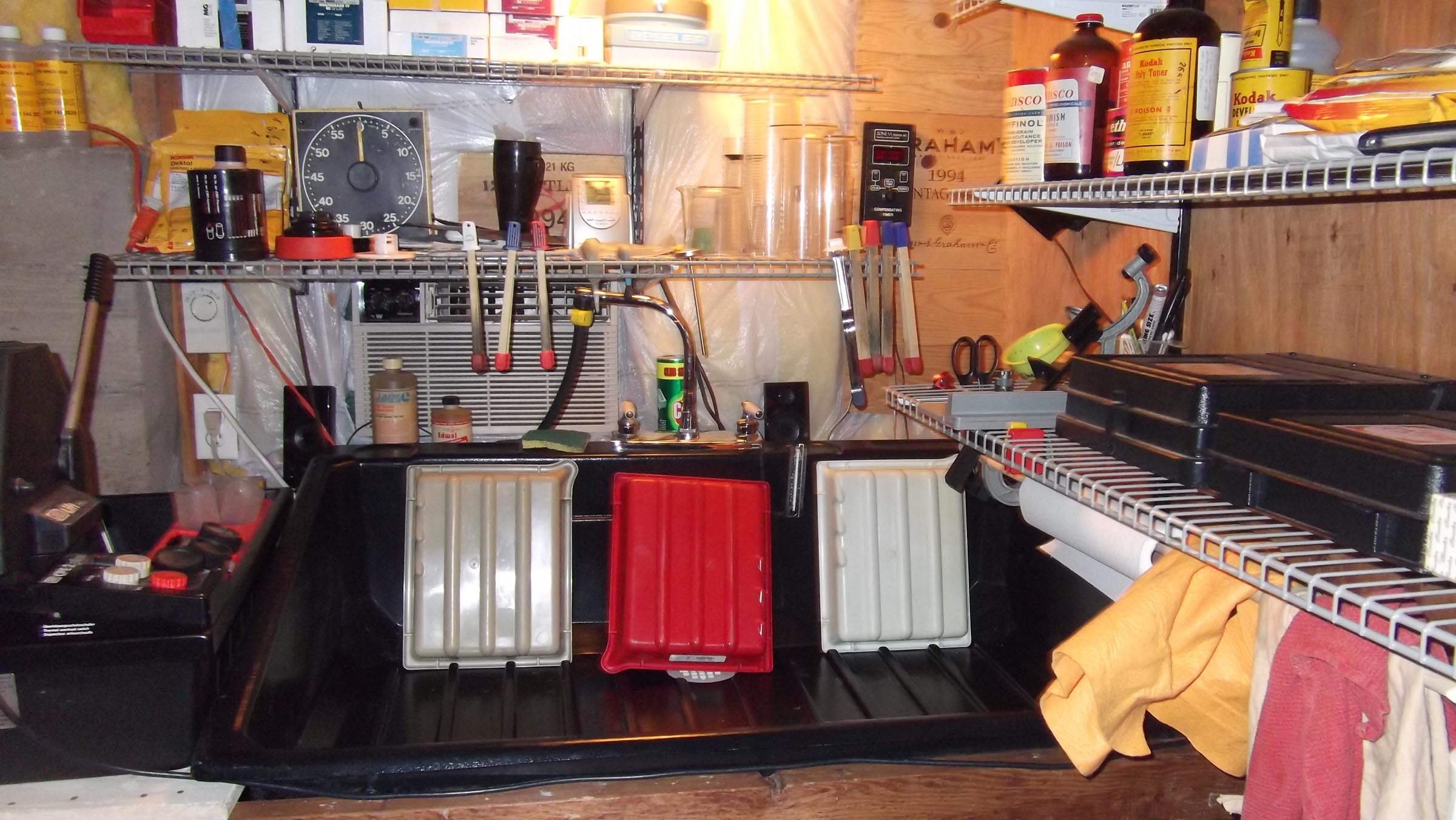

Alright, I finally got some pictures of my darkroom. I was reminded how much i hate digital in taking these... haha
New Things is a long list, but what still needs to be done:
Sink Plumbing,
Permanent walls/paint
Ceiling
Ventilation
Film Drying Cabinet
Other than that, this darkroom is very pleasant to work in. small, but it's not too bad

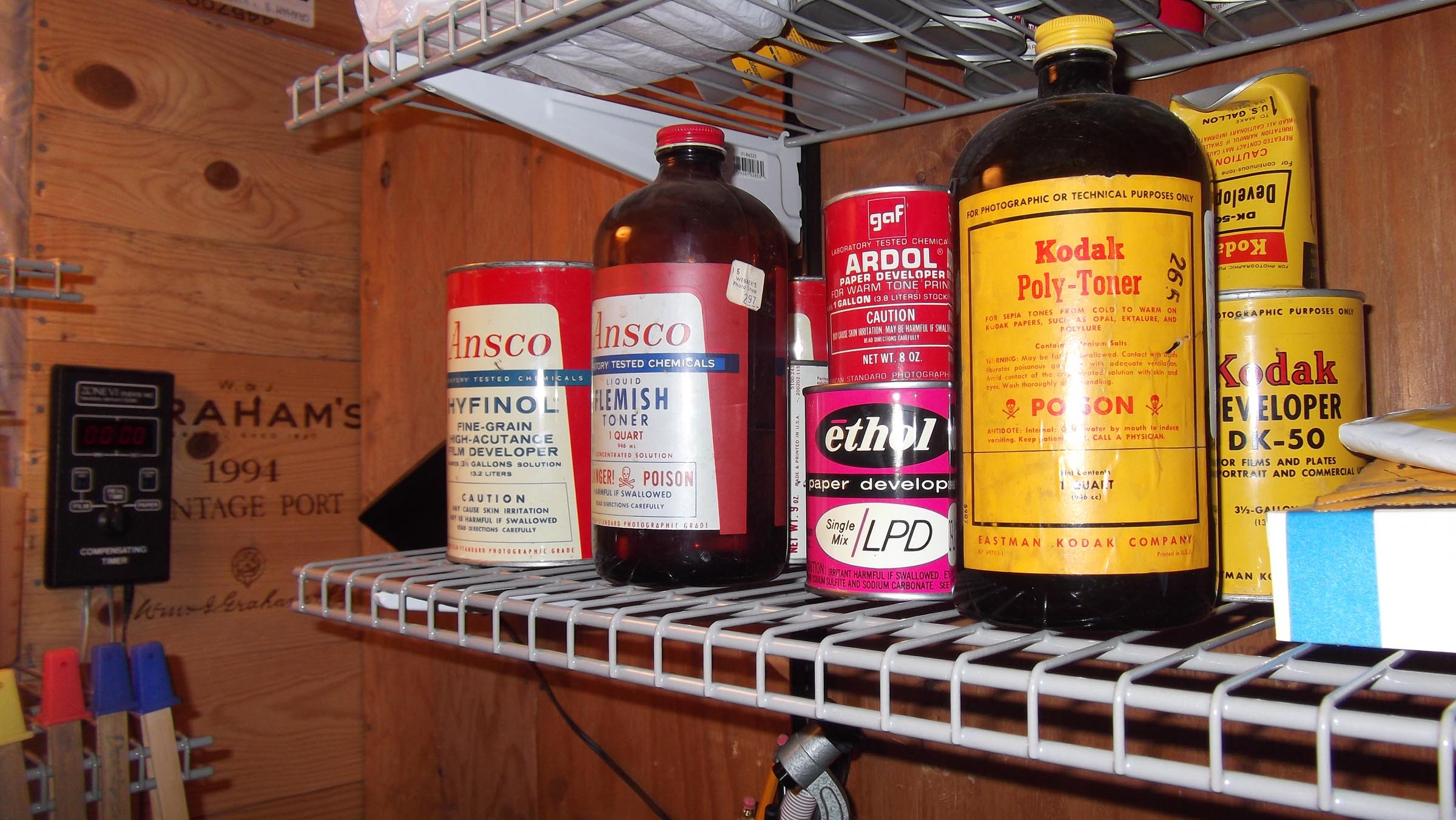

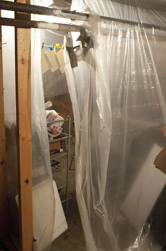

My Darkroom is in the basement of the house my friends and I are renting, it occasionally floods after a rainstorm. The set up cost was about 50 USD. The light proofing comes from tinfoil on the windows, and the 'walls' of the darkroom are 3mil contractor plastic. The basement is super gross so after I hung the plastic I cleaned the floor with a vengeance.
[not pictured] is my ventilation. Its a box fan mounted on one end of a cardboard box, and a furnace filter mounted on the other end. It blows air into the room hopefully blowing dust out. It works pretty good, but in an ideal room I'd have an out vent over my work table.

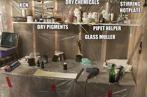

Here is my work surface. Every once and a while it gets cleaned off/ a new plastic sheet. The shelf was about 10$ from home depot. Lots of stuff on the shelves not labeled like my glass stirring rods, calibrated 10ml pipets (a godsend! I hate drop counts) My hake brushs, vinyl gloves (I prefer nitrate but ran out) and some equipment storage below the table in a rubbermaid tub.

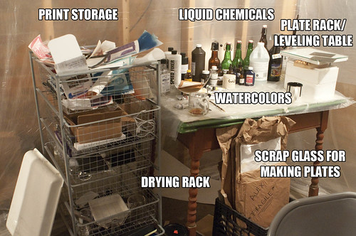

This is the reverse wall to my work table. This is where I keep (most) of the wet chemicals, as well at watercolor tubes for gum bichromate. Some other misc gear such as my plate drying rack and leveling table (for cooling/setting up of dry plates). You can also see some drying racks (thanks ikea) and a small pile of prints. Somehow my prints manage to infultrate every room of the house :laugh: . Also there is my box of glass which i've been collecting from my friends at a frame shop. They throw out so much glass that can be resized to 4x5, 5x7,8x10 because they always have more than they'll ever need.

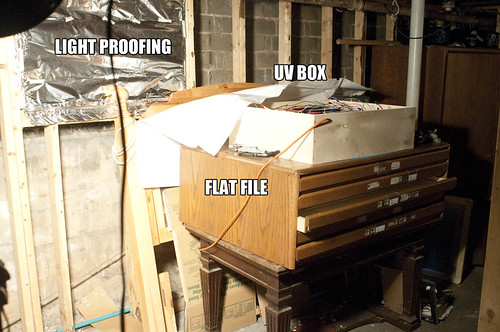

And finally my UV box and flat file. My last job was throwing it away after it got crushed by some gaterboard :blink: . Just needed to be reassembled with some screws and glue. The thing was stapled together!
The UV box averages 40 min cyanotypes and 12 min gum bichromate. Its still a work in process, the stupid tube socket's keep melting despite being rated for the amount of juice the tubes draw. Just been a near fire.. thats all.
Also, check out the lightproofing!

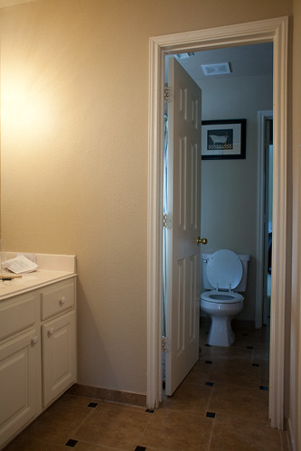

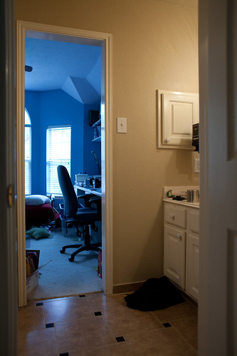

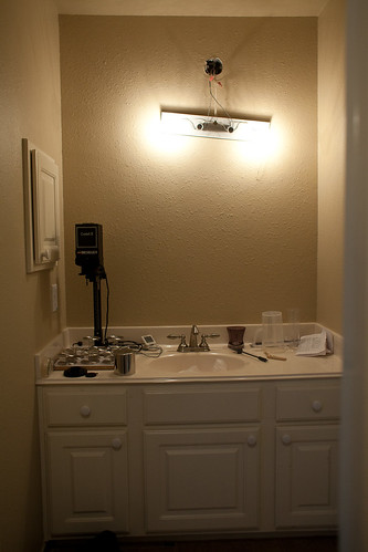

Finished my darkroom a few minutes ago. About to go inside, mix up some chemistry and test it out. This was done in the vanity area of my old bedroom at my parent's house.

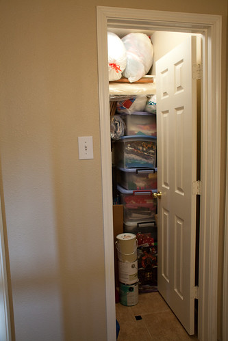

A few before shots:

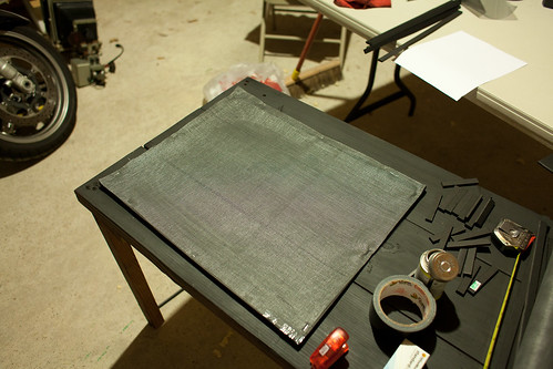

Drying screen:
And then the transformation occurred after several hours with a circular saw, drill, electric screwdriver, and paint. Not to mention some back pain from carrying it all up the stairs.

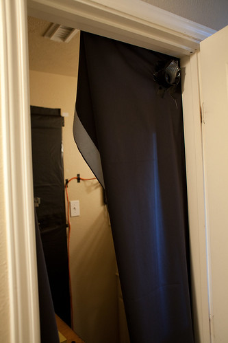

Entry way:
Entry way from the inside:

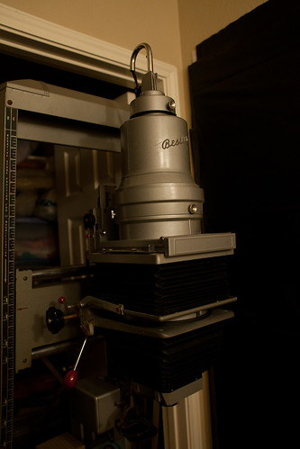

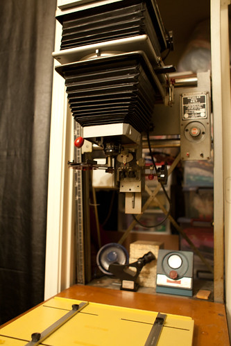

Enlarger:
Enlarger again:

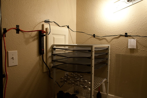

Drying rack, power, squeegee + acrylic sheet, air-evac bottles. The washer lives under there too, I just hadn't put it in place yet when I took this.

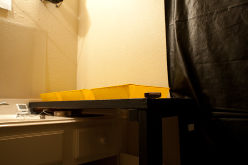

Trays:

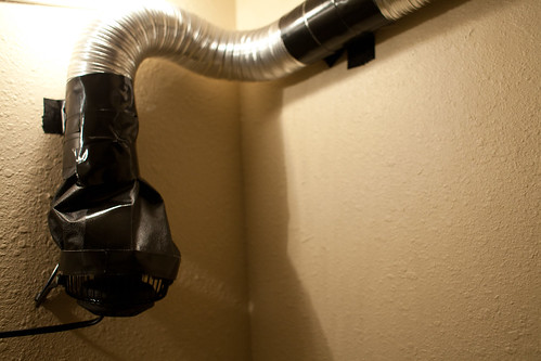

Exhaust system. Some vinyl for a shroud, a 4" personal fan, 3" dryer hose, lots of duct tape:

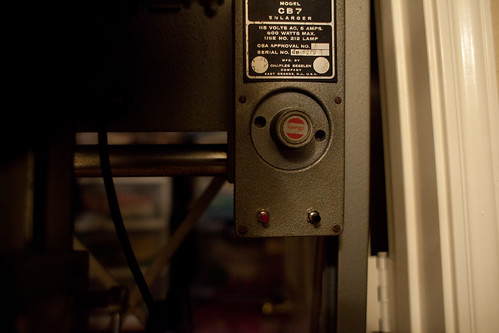

CB7 modification. I rewired the carriage movement circuit on account of it not working. Momentary switches control the up/down movement of the carriage now. The rest of the front panel controls remain as originally wired.
