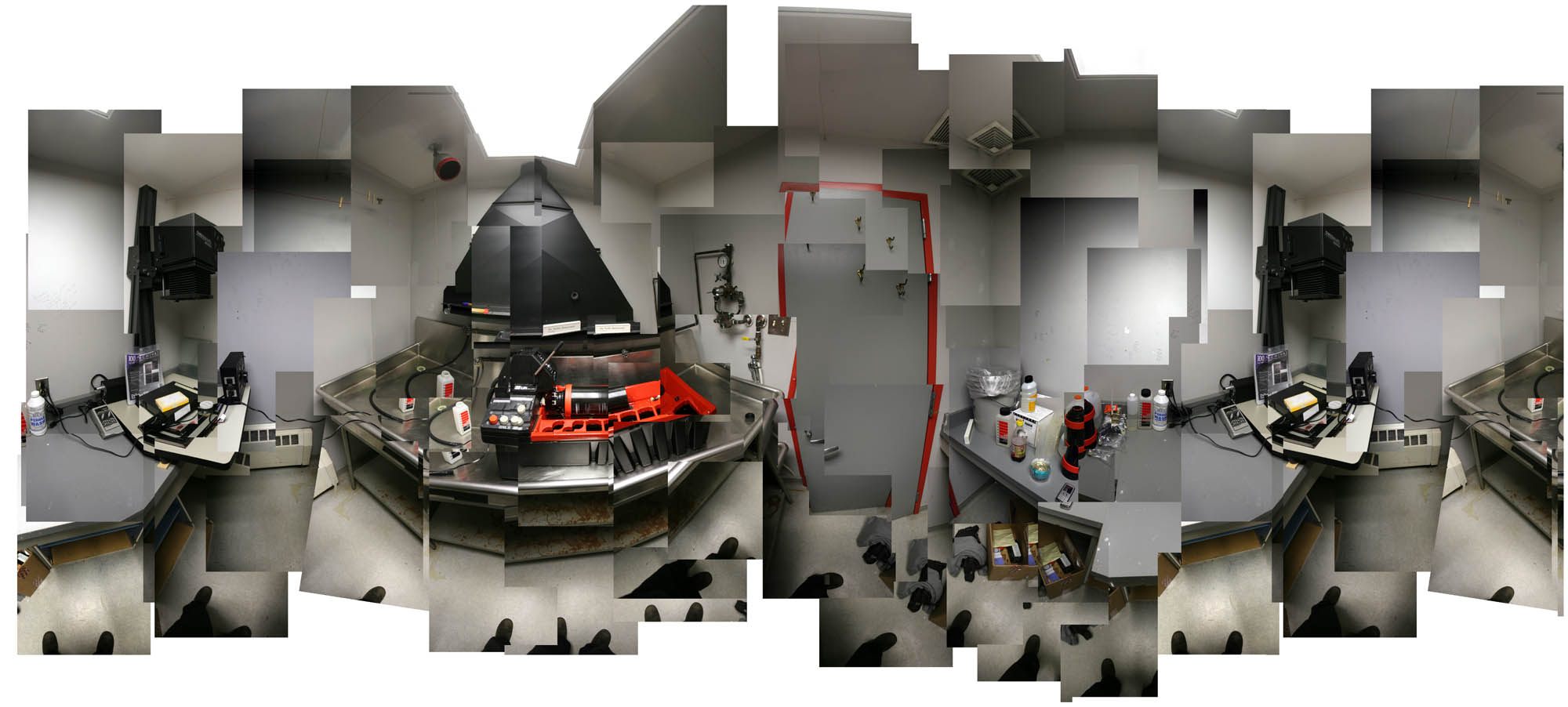

Ok it's not completely finished but it is functional.
The window is blocked out right now but I'm building a ventilation system that will fit in it. Since it's only useable at night I'm going to build some light walls around the space too. It's a work in progress but at least I can print now and hey, it's got a Godzilla poster too. :cool:
I like your Poster, but I might suggest putting dark cloth on the walls you are close to as to avoid reflection off the walls from the enlarger light. It can cause a bit of fogging on the paper or a loss of local contrast in the image.

See the first or 7th picture as an example of what I am talking about.
If you can't you will live without it, but I think that close to the corner you will see a difference.

Thanks for the tip, Robert. I'll give that a try.
What kind of material would you suggest? Just something black? We have a pretty good fabric store here maybe I'll pay them a visit to see what they have.
Nice darkroom by the way. :cool:
Any flat (non shiny) fabric will work, if you can get flat black poster board, that would work too, but get what ever is easiest to store and the cheapest.
At the fabric store, ask if they have "blackout cloth". I have a few yards of that which I purchased primarily for light-blocking, but it's black and matte and probably would work fairly well.
If you want/need total overkill at a matching price, then consider telescope flocking. Here's an example page for Protostar's flocking products, you can find others via web search.

Easy and cheap. I can do that.
