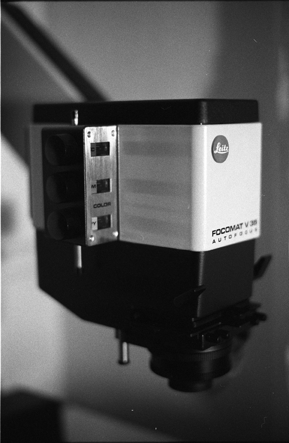

i have to leitz/leica enlargers. one v35 and a focomat 2c. my darkroom "sink" is a industrial table that i have plastic on to protect from chemicals. i have the tools hung on the shelf above it.

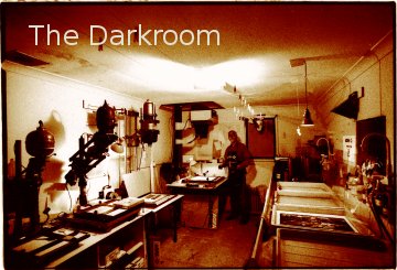

A bit different to this June 2006 pic as the 1947 DeVere 54 has gone and another Leitz Ic is on that bench - The bench for the 1947 DV is now used for slicing off silver jelly from a 42" wide roll - The door, off pic' to the left is being moved to the end so I can extend the dry bench for a contact printing frame and a DeVere 504 enlarger - The big bugger enlarger at the end is a DeVere 5108E for 10x8"
The deep tank of replenished D76d from 1985 is still the deep tank of replenished D76d from 1985 - Like me it improves with age

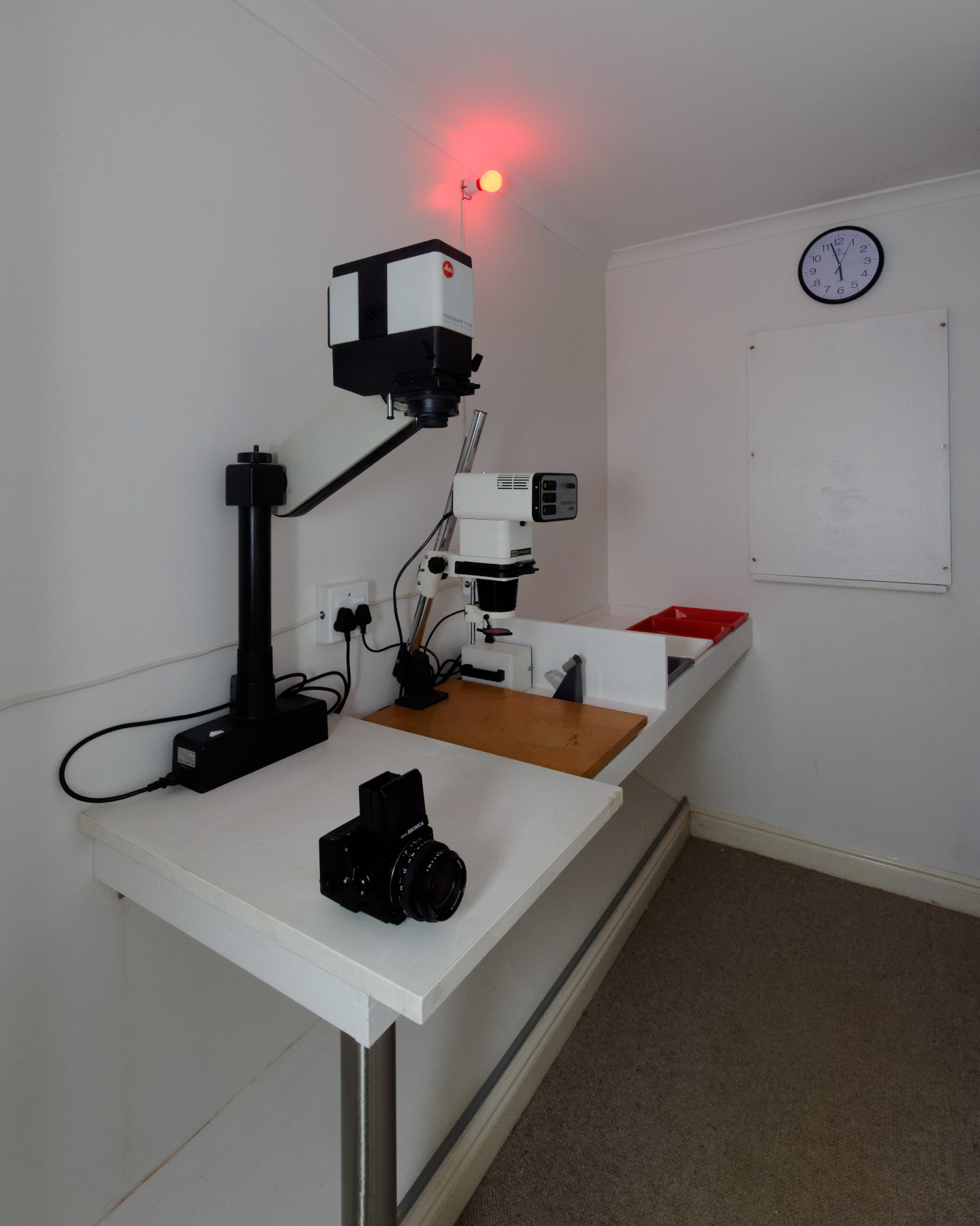

My First Darkroom
I have converted the walk-in closet in my bedroom into a darkroom. It's home to my Leitz Focomat V35 and Opemus V enlargers, which were surplus to requirements at the local college of photography. They stand on a custom workbench, which has a 20cm (8") high central divider to separate the wet and dry sides. The wet side has a 4cm (1.6") rim around the top, to contain any spilt chemicals. I also installed the electric outlets and safelight. Phase 2 will include ventillation and a sink, which I plan to install beneath the boarded-up window under the clock. There is a small alcove on the far right with shelves that I use to store equipment - camera equipment and lenses are stored in airtight containers with silica gel dehumidifiers due to the tropical climate. Chemicals are kept in the fridge in the garage, although I would like to add a bar fridge in the darkroom when I can.

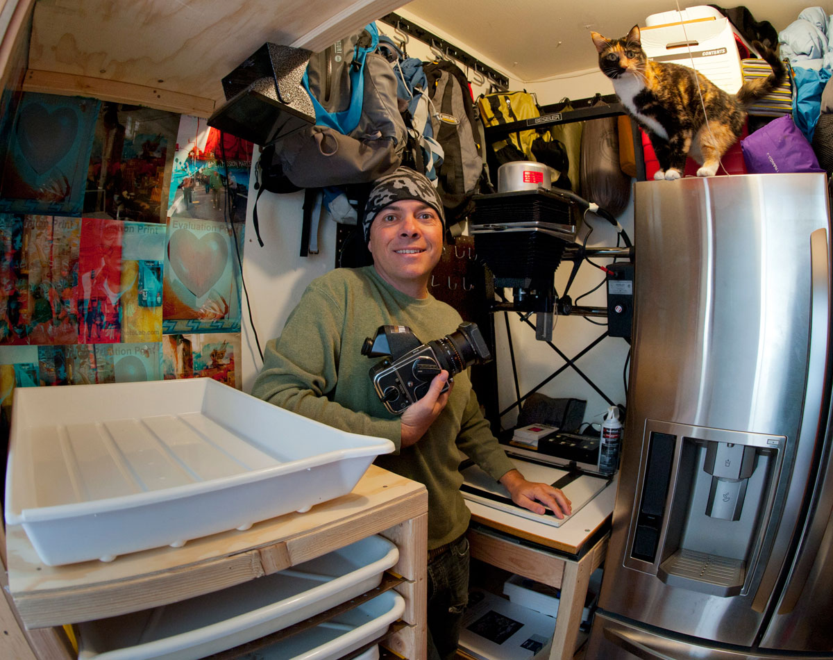

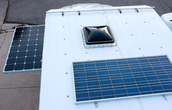

Just got mine done ( middle photo ), about 15 square feet of working space in the storage closet of our 820 square foot 2-bedroom apartment, vertically stacked trays, over 2,000 rolls of film in the fridge / freezer combo to the right. The 16x20 Eco-Wash connects to a diverter valve in our shower. Have been printing for two days and already sold three prints, 10 x 10's from Hassy.

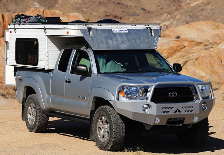

My other darkroom goes over 100 MPH, gets close to 20MPG when not doing those speeds, has 235 watts of solar, a freezer, fridge and lets us stay out in the field for not days but weeks in the same location. I don't print in it yet but do soup film.
That is true dedication!
