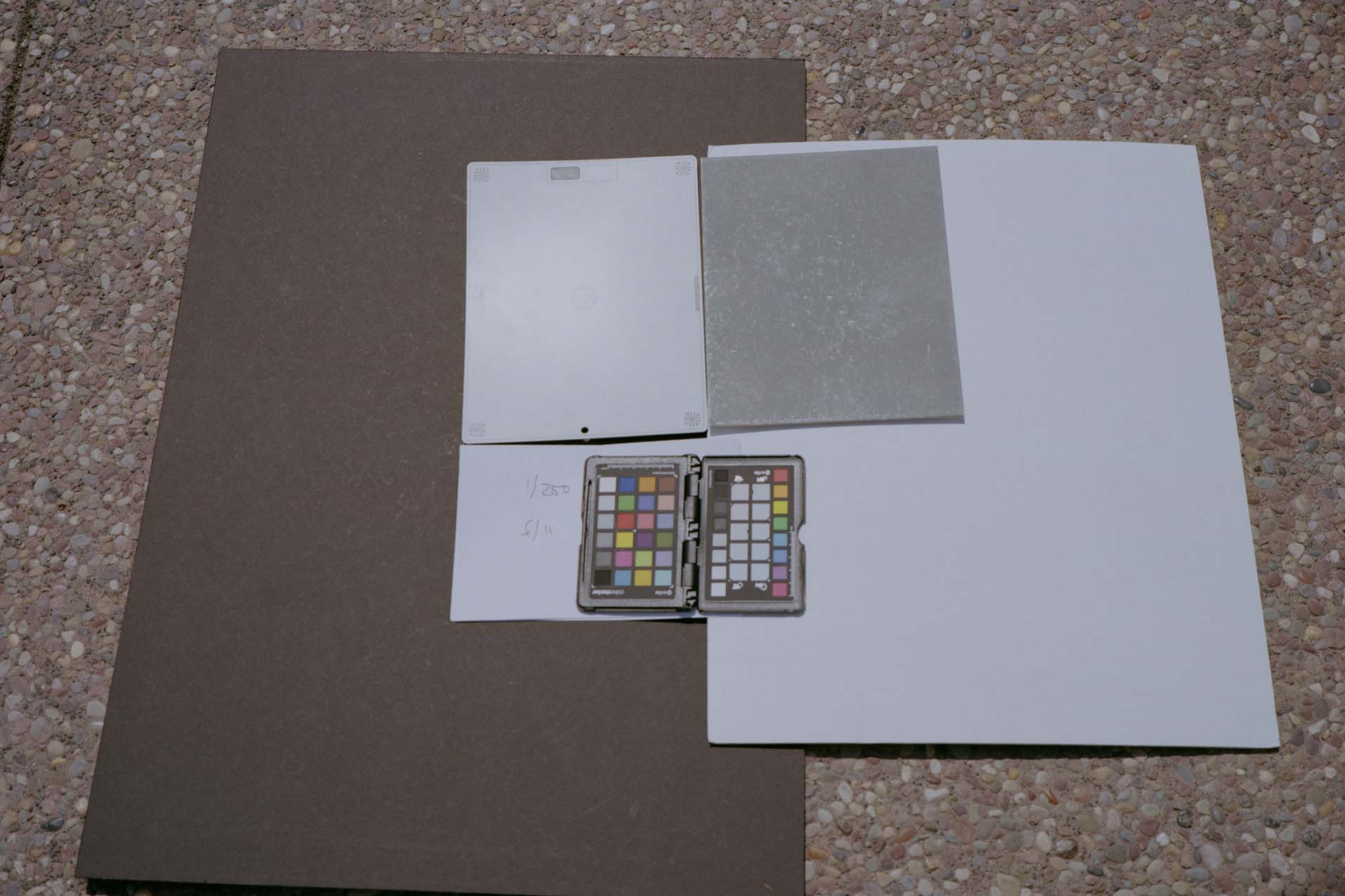

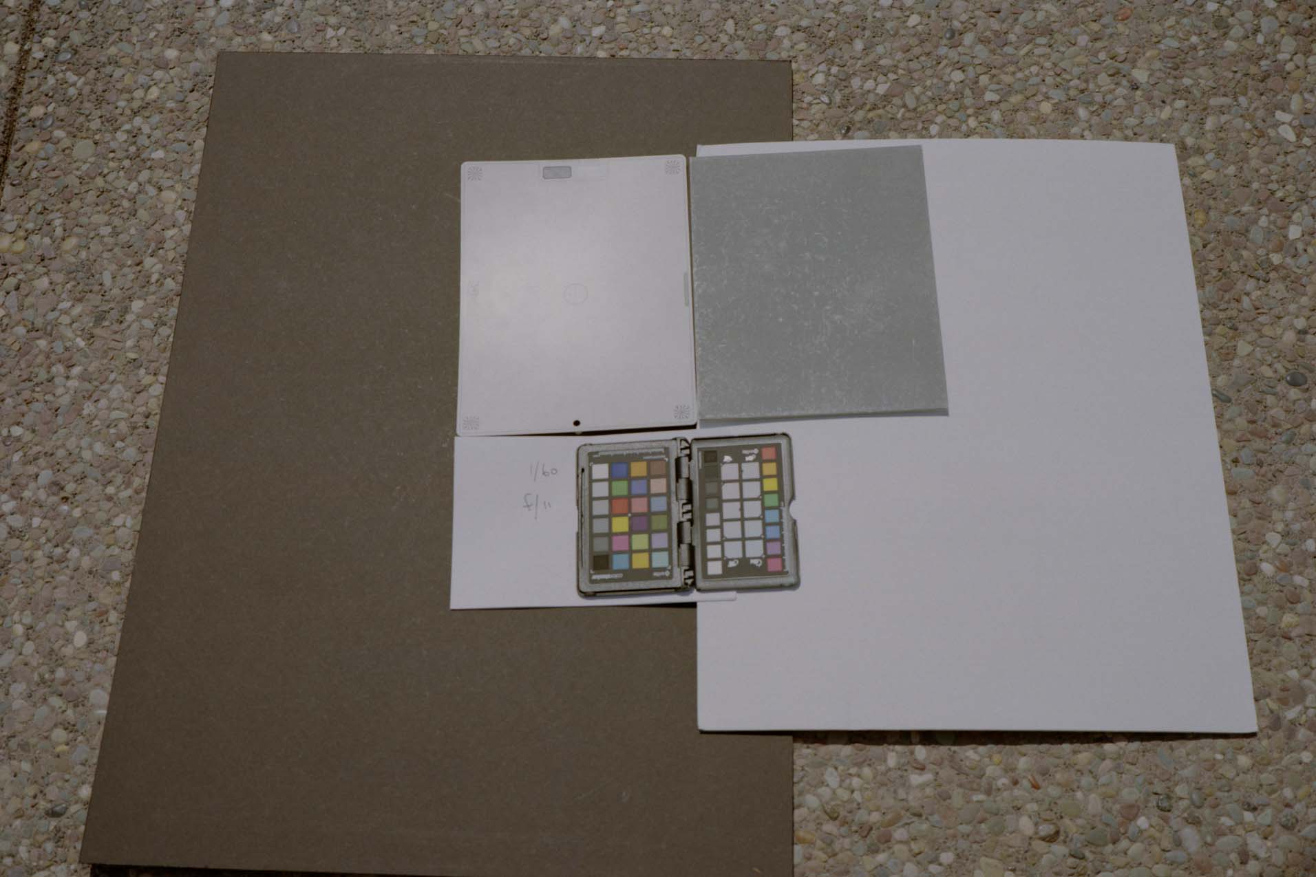

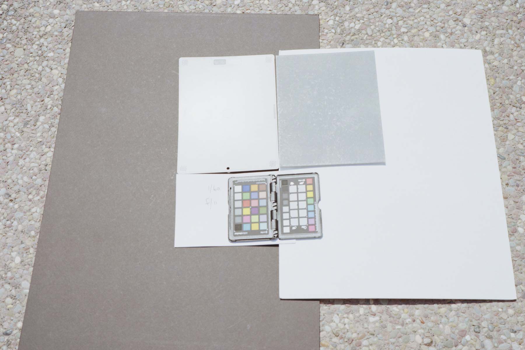

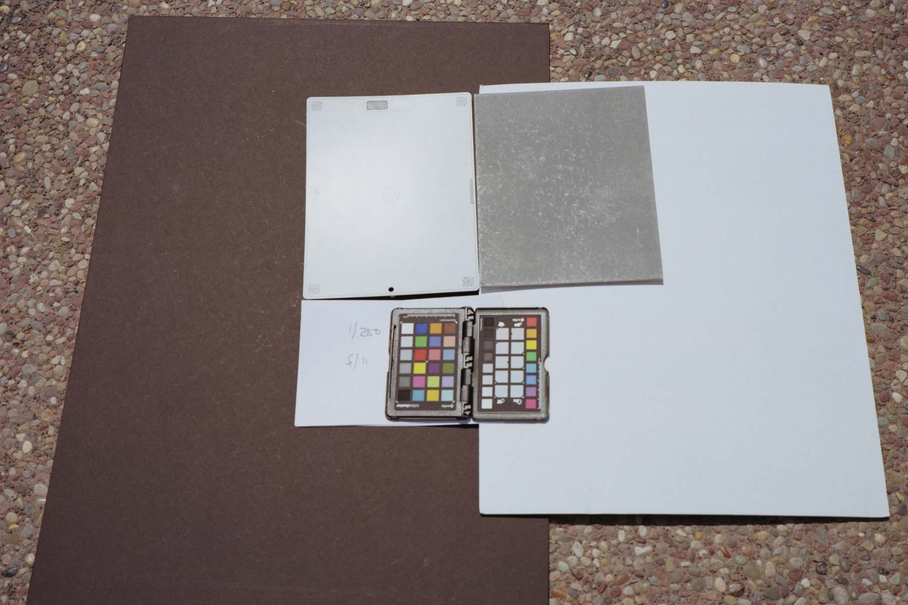

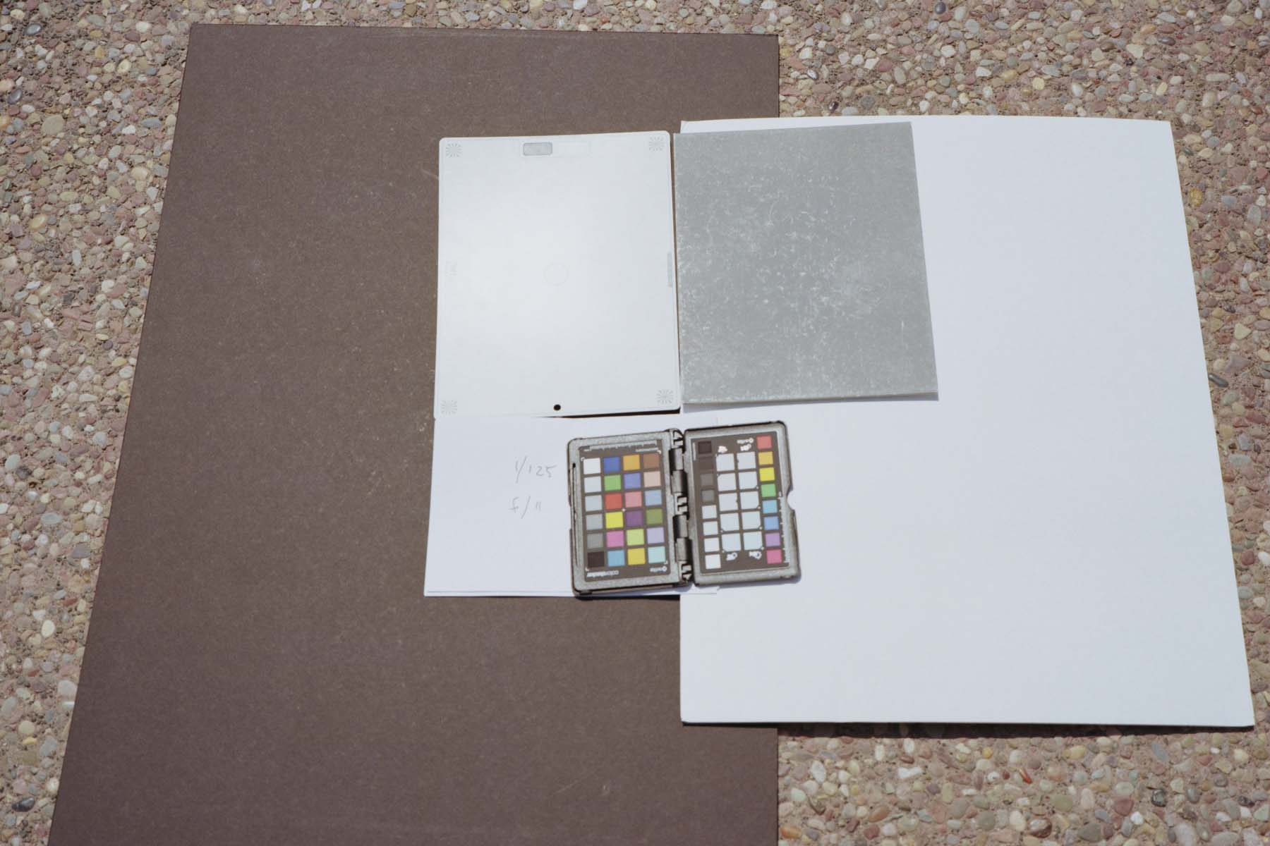

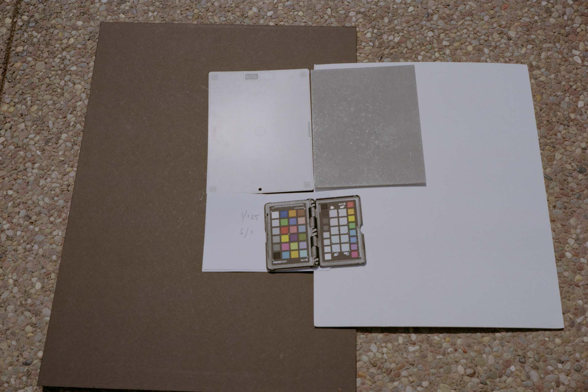

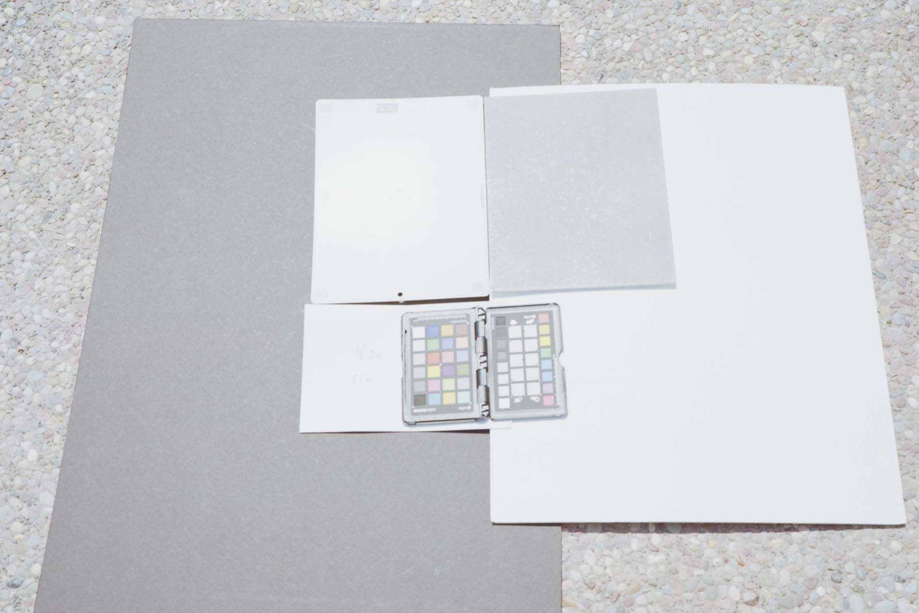

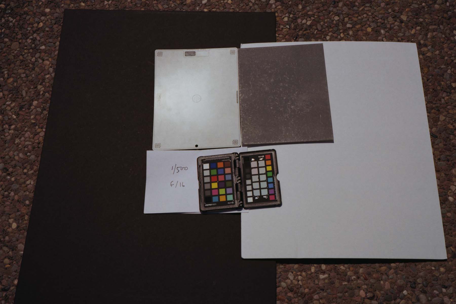

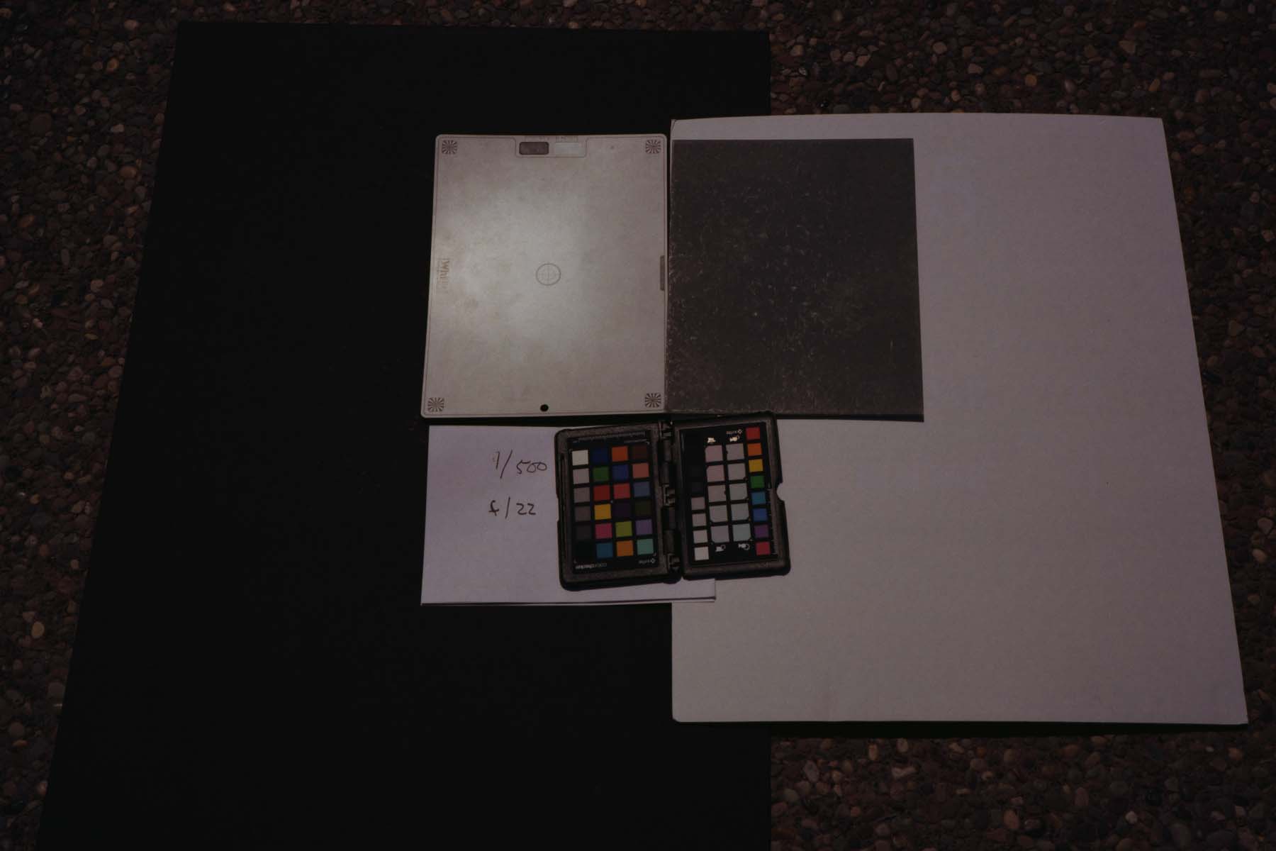

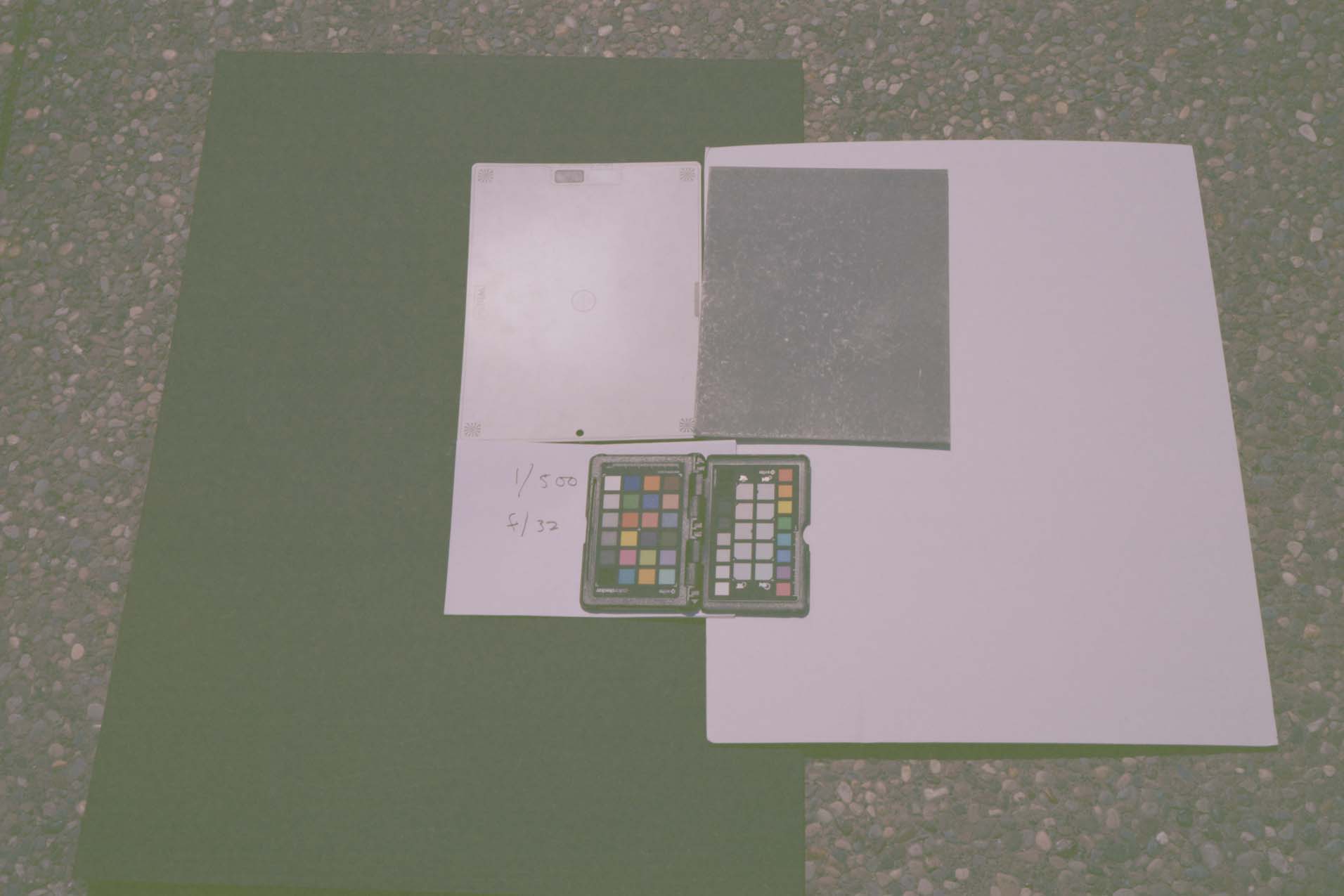

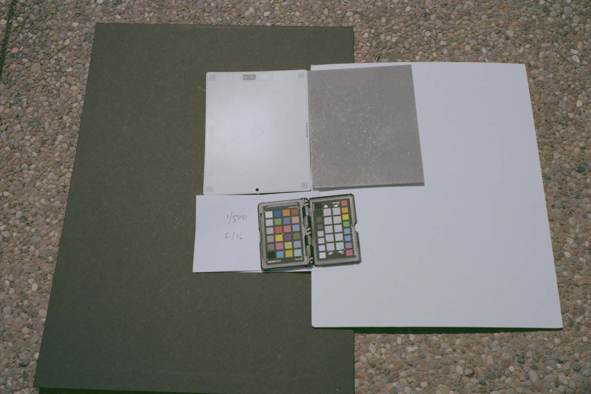

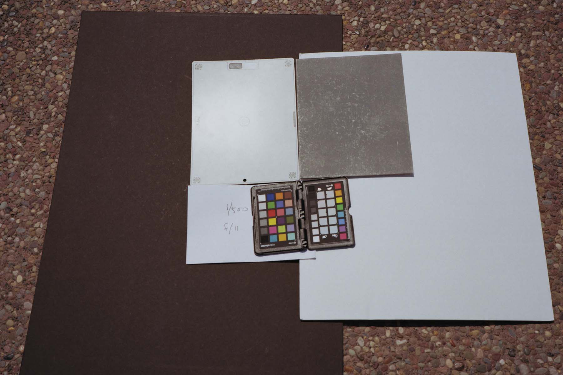

Attached is two sets of images. This was a scene shot at noon with Ektar 100 120 roll film in a Fujica GW690. The negatives where scanned in on a Canon 9000F MkII and Vuescan as a positive image and saved as a raw tiff with gamma 1.0. The first 8 images have been inverted and the red, green, and blue channels were gamma adjusted so that the grey card for each channel is sitting about in the middle of the histogram. These are not finished images, but are included so those that are interested can see how Ektar responds over the exposure range. Since the gray card was normalized, the bulk of the color shifts at the extremes of the range are in the highlight and shadows, as expected. -4 is losing a pretty significant chunk of shadow to the film base for this amount of scene contrast, and for that reason, qualifies as unusable.
The second set of images is the same scanned in positives as the first set, but run through my standardized Ektar post process. I didn't include -4 because I can only upload 15 images. What specifically is done to each image is the purview of dpug, so we'll not go there. There's a giant swath where all I'd have to do is a simple exposure adjustment to put the gray card where I want it followed by tweaks to aesthetic. With the exception of -4, none of them are really what I'd call problem images, though the more you get under exposed the more your shadows are going to suck, and the higher your scene contrast is, the faster you'll start losing shadows when under exposing.

I don't think those are tests of the film.
I think they are tests of how your scanner and your software interact with the film.
As opposed to tests of how a wet darkroom interacts with the film. Either way, the film was exposed over an 8 stop range.
Mine had no adjustment at all. They were all scanned in one strip. No post process.

I still think your set of individual frames were adjusted for brightness. Scanner is trying to make each frame look good.
Your contact prints reveal what a prints made with "no adjustment" would really look like.
If the individual shots were not adjusted the set would vary in brightness, like this... Screenshot 2016-10-30 at 12.17.03 AM.png Screenshot 2016-10-30 at 12.17.20 AM.png Screenshot 2016-10-30 at 12.17.29 AM.png
But... Your contact prints are great, they show what you get when you...
Vary negative exposures on a roll (so you have different densities on each negative), and you make several contact prints under an enlarger and varying the f/stop on that enlarger lens (so you have different print exposures)...
The result is proof of the idea of latitude. You can make a good print from a wide variety color negative exposures... as long as you are leaning towards overexposure.

With all that being said, looking at the second set of images, the color checker chart is pretty telling as to what Ektar can do over the exposure range. I've also done this exercise with Portra 160, Portra 400, TMAX 100, and TMAX 400 with similar results.
