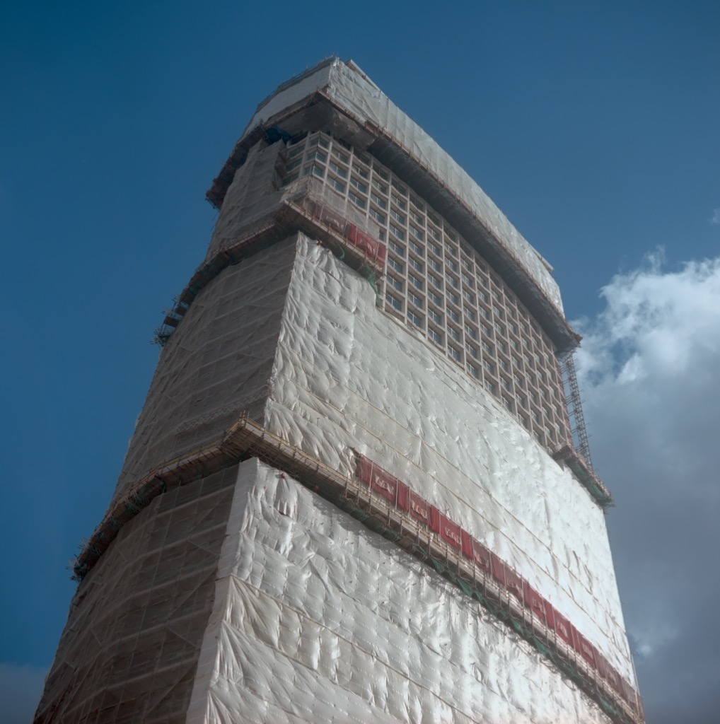

Ok here is a straightforward scene - how would you meter this with a spot meter? There was masses of bright reflected light coming straight at the
It was taken last week in London with an 85year old Rolleiflex Old Standard on expired Portra 400NC

Actually, the fact that you scan makes it much more complex and difficult. It means there are a whole bunch of added variables, and some of them aren't easily within your control.
For Portra 400NC, if it hasn't deteriorated due to age, the film and developer will handle a very wide range of highlight exposures. I would meter the shadow areas, place them appropriately, and then let the film and "printing" process handle the rest.
You will need to work out how to defeat any presets and assumptions in your digital workflow in order to get it to deal properly with the highlights. That is an off topic subject for APUG.

We seem to have a disconnect here, issues with colour shifts but using OOD film, still, moving on, excessive noise points to underexposure, I still can't see why you don't bracket just a one frame +2 stops (rarely will going down "improve" things) would give you an idea what happens. I also agree that your scanning needs to be up to scratch, you say "another variable removed" indeed yes if you are scanning "properly" and on what? Why not let a reputable lab scan a roll and compare? Note reputable are few and far between in the UK many go so far as sending to the USA.
David for your picture I would take a reflected reading of the blue sky and use that as my base exposure. Then bracket +1 and -1. I would set meter iso to match box iso. One thing about negative film when I shot Ektar 100. Colors actually change when you bracket a stop. You'll be OK to use any of the bracketed shots under most conditions. But if you are a pro shooting products where photo colors have to be true to the original product, you have to get the exposure exactly. For landscapes like I shoot, that's not so important because most people cannot see the difference unless they are looking at the bracketed results at the same time.
View attachment 165877 .
Can I ask how you metered this scene? Given the amount of grey of two shades and the rest is virtually all blue sky I am not sure this is as straightforward a scene as it might appear
If the scan represents a faithful replica of the negative then it looks pretty good to me so your metering looks pretty accurate to me in this case and even better given it is an 85 year old camera and expired film.
It might help if you gave us examples of where your metering produced poor results.
