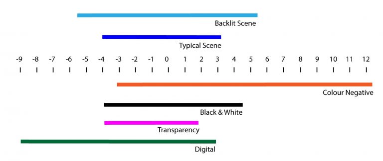

I am confused - with upwards of 15 stops of available latitude on certain colour negative films, 5stops on slide and 10 stops on black and white - where to the midtown's sit? How does the Zone System help when evaluating the position of tones in colour negative and slide?
If you don't have certain tones in your images then the position of shadows / midtones and highlights are vital - there doesn't seem to be any information on this distribution of light across the film, just its extreme ends.
1. For colour negatives like Portra (or example), the usable range is around -3 (black) to +12 (white). Everyone says expose the shadows for -2 (not blacks) and everything should fall into place, so are we saying put the mid tones at 0? This gives another 12 stops of lights highlights in this case? Is that correct to put the midtone value so close to the shadows?
2. Black and white seems to have a more even distribution, -4 to +4, which seems to be nine stops rather than the 10 the zone system uses. I am seeing midtones at 0 and whites at +4...
3. Subsequently with slide film, -3 to +2, are we told to position the highlights on 1.5stops, so are the midtones are at 0 once again?
Image below is (C) Onlandscape
A link to your graph would be helpful to see the context.
You are confusing two different things, latitude is not dynamic range and vice versa.
Latitude is the "room" you have on the recording medium for the light range you are trying to record.
So if your recoding medium has a dynamic range of 10 stops and your scene has 8 you have two stops "spare" called latitude which allows you to move your exposure up or down the 10 stops available (one up or down) and still fully record the scene. If you have the same 10 stops available and your scene has 12 you have no latitude and will need to decide what to loose highlight or shadow detail.
The dynamic range is not a hard stop in film, the response to light in the highlights rolls off, the characteristic being down to the film and developer chosen, in digital the stop is, at the top, hard, it saturates and that is that, at the bottom it becomes noise limited and is soft depending on your tolerance of noise and the RAW converter and post processing you use.
The "hard" lines in that graph are too simplistic IMHO.
So, in your graph digital has a 12 stop dynamic range and in the typical scene of 7 stops shown has 5 stops latitude you would, on digital theory, choose to expose to the right to maximise your data without hitting the hard stop and let the shadows fall as far to the right as possible to minimise noise.
The colour negative has 15 stops dynamic range so has 8 stops of latitude for that scene and where to place the scene is a choice, usually the advice is as you suggest is to be generous in the shadows as your highlights will take advantage of the latitude and be recorded or as you say "fall into place". You seem overly concerned IMHO with where the mid-tone falls it's the highlights and shadows you should worry about in both film and digital and let the mid-tones "fall in place".
You mention the Zone System and where it helps, it doesn't really!!
The Zone system was designed to place the scene on the straight part of the curve (for maximum quality and ease of printing with light and not scanning which I know you didn't mention but requires for optimum results a different, slightly, approach to exposure placement than traditional printing)) and does not venture to use the highlight roll off available, which was very different than in modern films which have a curve with a much longer and straighter central section. The N+1 etc of the Zone system, which was intended for individual exposures on sheet film and only translated to roll film because it was good idea in thinking about how the film was exposed and fitted to the film curve, was used to manipulate the curve which today for most scenes and modern films is mostly not necessary.

So what you are saying is meter the shadows and highlights and work out the difference between them, then position them on the scale accordingly, rather than worrying about the position of the mid tones?
I always get confused when the composition does not contain obvious shadows or highlights etc. If you went to shoot green grass for example, filling the frame, then I have no idea what value I would position that....
I have recently been using a new (to me) Sekonic 758DR meter. I spot the highlights, then the shadows and average the results. As it contains a 'midtones' button, I can then slide the recorded values up and down the EV scale, putting my deep shadows on -3.
Using slide is the same. It allows me to position the shadows on -2, and then look at how much above 1 and 3/4 stops the highlights are, so I can grad them accordingly.

No I don't advocate "working out the difference" I advocate metering the highlights in digital to expose to protect them (unless I'm prepared to sacrifice them for some reason eg lots of specular stuff and taking care with colour channels which is another digital can of worms which is an E6 approach as well) and metering for shadows in film (negative). As I said, the highlights in negative film will take care of themselves and the mid-tones will do the same.

So your problem is the green grass filling the frame? That is a scene with a very low dynamic range so you are free, almost, to place it where you want ie you have lots of latitude !! Having moved away from spot meters personally I would use my incident meter and create an artificial shadow with my hand shading the meter and call that my shadow exposure job done. Why not test it out? Take a green field and look at the dynamic range with your spot meter then expose over say an 8 stop range around your mid-tone position ( having worked out the difference) I suspect you will find the shadows will start to loose details on the underexposed ( and if C41 colour the colours will be "off" C41 stock hates underexpose and to overexpose you almost need to take the film out into the sun) but you will have lots of "overexposure" room, if you scan at least 5 frames will be virtually indistinguishable when the scan and software has finished and you will see quite a gradual progression of density on the negative strip. You are over-worrying IMHO.

As far as practical colour photography is concerned David I would forget about the Zone System, you are only going to tie yourself in unnecessary knots.
