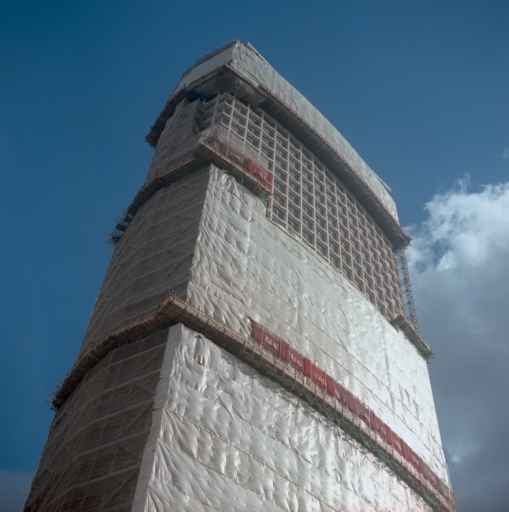

Ok here is a straightforward scene - how would you meter this with a spot meter? There was masses of bright reflected light coming straight at the
It was taken last week in London with an 85year old Rolleiflex Old Standard on expired Portra 400NC
View attachment 165877 .
Looks like whatever you did worked fine.
I'd meter the sunlit white side of the building - maybe not the brightest sheets but a little to the left of the real bright parts. In "Zone System" terminology, I would "place" a high value where I wanted to see some detail on "Zone VII". (You might be able to read some points that will go up to Zone X in the brightest sheets of plastic, but those extremely bright points aren't necessarily the best place to judge a meter reading)
Then I would check the darkest reading I could get on the left side of the building and see where it "falls". I think in your scene it wouldn't fall much below "Zone IV" so I'd take note of the planned exposure and make a few more notes.
[Here is where you could just as well take the darkest reading and "place" it on Zone III and "see" where the white parts of the sunlit side of the building "fall"]
I'd read white cloud, gray cloud and blue sky and just "see" where they "fall". If gray cloud wasn't right on "Zone V" I would get suspicious. But if it was "Zone V" that would be enough confirmation for me.
So this scene, say that except for the really bright points, might have metered a range of five or six stops, which you could expose anywhere in the range of exposures from -3 to +12.
For example I would probably try to expose it at "-2 to +4"
But you could pick "-3 to +3" or "0 to +6" or "+4 to +10" and the color negative material, because it can record up to fifteen stops of detail, would be able to record your picture - and you would be able to get a fairly good print out of it.
[Like PE just showed, a scene of about 7 stops subject luminance range (from the dark shadow under the chair... to the white patch on the color checker card), can be exposed over a wide span of choices for exposure as long as you avoid underexposure]
Color slide material is more finicky because people watching your slide show expect to see the white sheets on the side of the building... as white... and without the negative-positive process available to give you a chance to adjust brightness, you have to get the brightness (as it will show projected up on a screen) correct in the camera.
You're shooting color negative film though, so you have a wide range of adjustments that you can make after you get the negatives back.

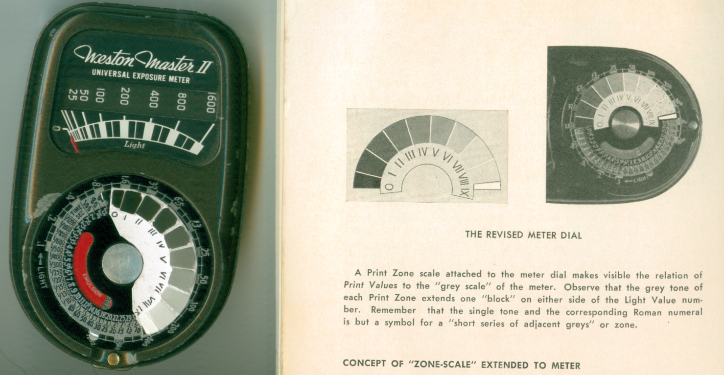

I metered my outstretched hand and set the dial on Zone VI, then I aimed at different parts of the world around me... the sky, the grass, shaded side of car I got out of... and each meter reading corresponded to a print value that I would be happy with.
My meter has a sticker like this: (photo is of my Weston Master II, but I made a sticker similar for the Master III - advantage of Master III... it has ASA speed instead of Weston speed)
With a 30 degree angle of view, you must take close up readings of the reflective areas you are metering.
It's very practical, and turns picture taking into an immersive experience... to walk around the area you are considering taking a picture and checking the reflected light readings of different parts of the picture...
But when I went to Yosemite last summer, I smashed the glass on my Weston Master II (the one in the picture but I've since repaired it)... Then I was forced by circumstances to rely on a Pentax Spotmeter V.
