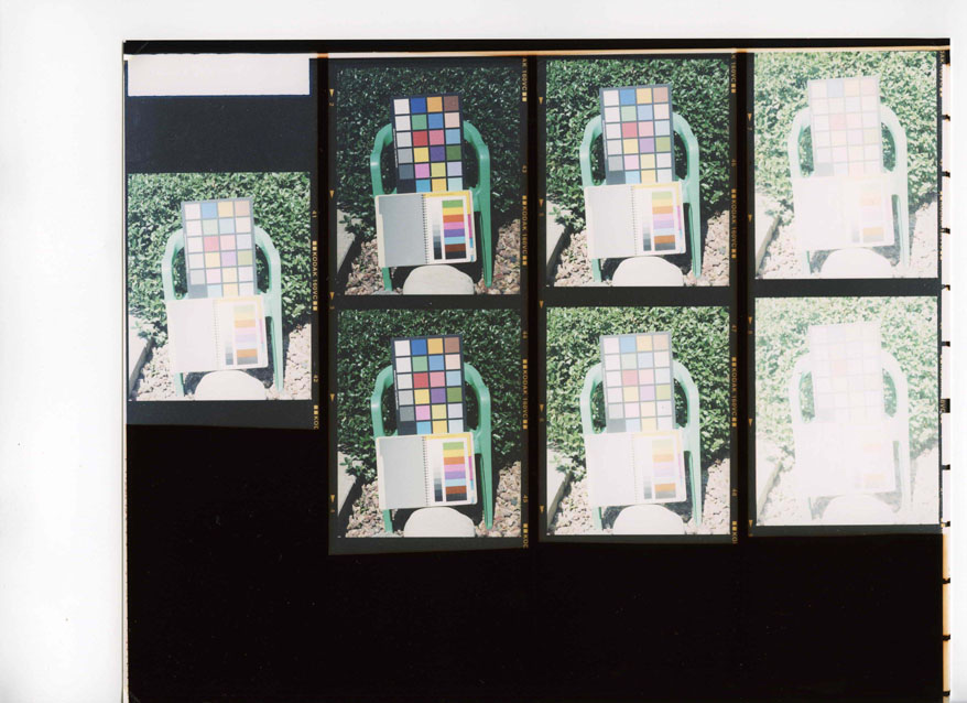

I'll go pull the test negatives I shot out of archives re-scan them in and post them here so you can see what Ektar does as you over and under expose it. I'll stick the mids in the same range and not correct the highlights or shadows. It'll either be really late today or some time over the weekend.
What I am getting at is that the only time I see color shifts that are caused by film exposure with negative films is when trying to print from the negative's toe. If the tones are on the straight line of the negative I see no shift.

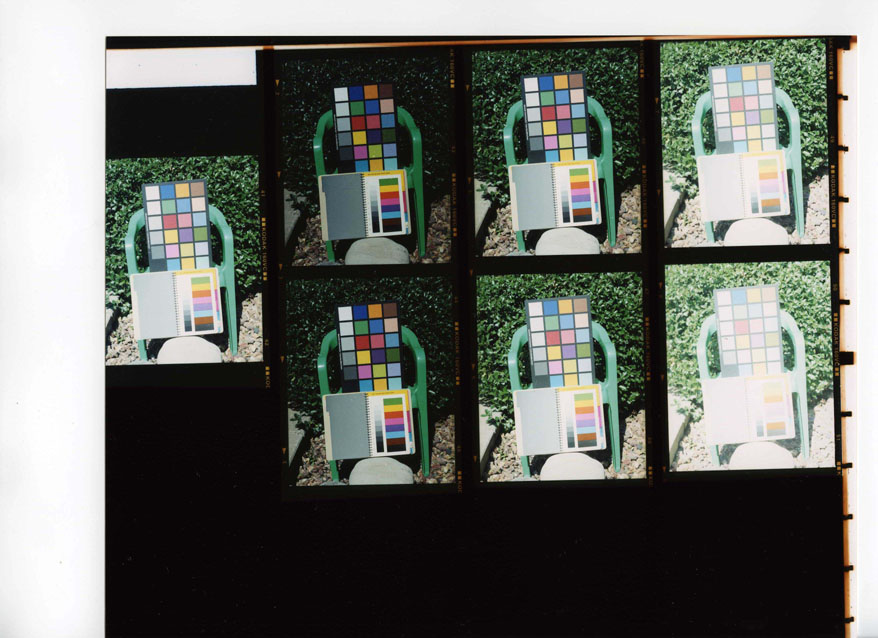

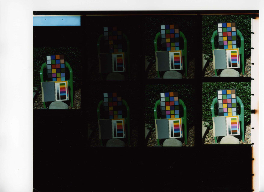

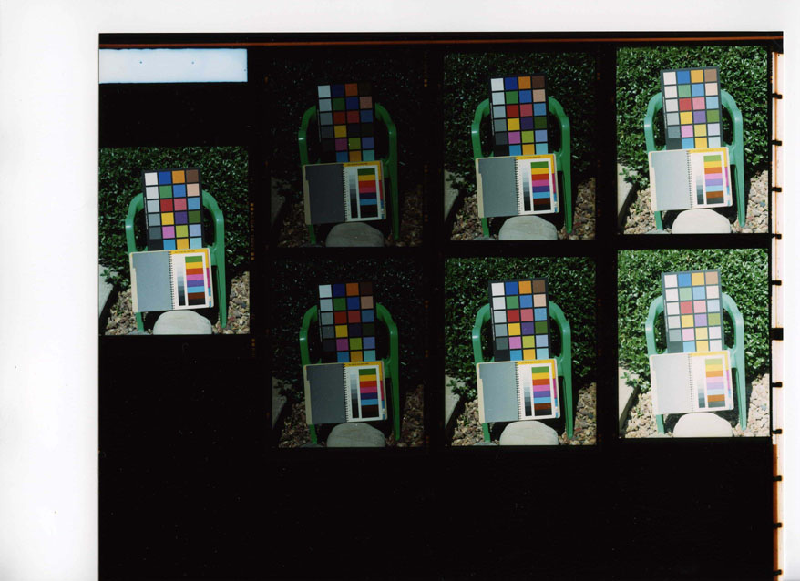

Let me clarify or rather correct something here. The above scans were done at exactly the same settings on the scanner with no correction.
Here are some others. They are scans of prints of the above negatives which were scanned. The prints had a constant filtration and exposure time but varied only in f stop. Do you see a significant shift in color or any color error? Color neg maintains its balance from the toe to the shoulder. at the extremes, some shadow or highlight detail is lost. But the good range is pretty broad. I've done the same with Portra 400.

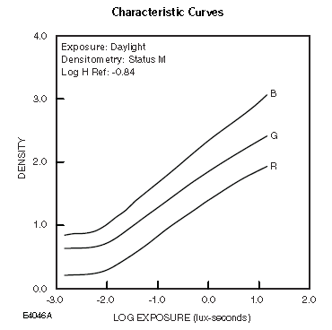

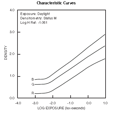

Ektar top and Portra bottom. The speed difference is obvious due to the shifted curves.
This tiny difference makes little difference in printing or scanning.
