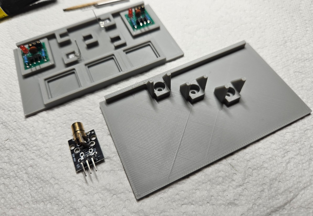

in few Days, i am ready with the first, two laser version, the esp32 follows with a nearly same construction.

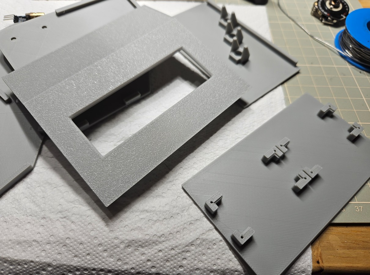

Alloy frame and 3d printed parts.

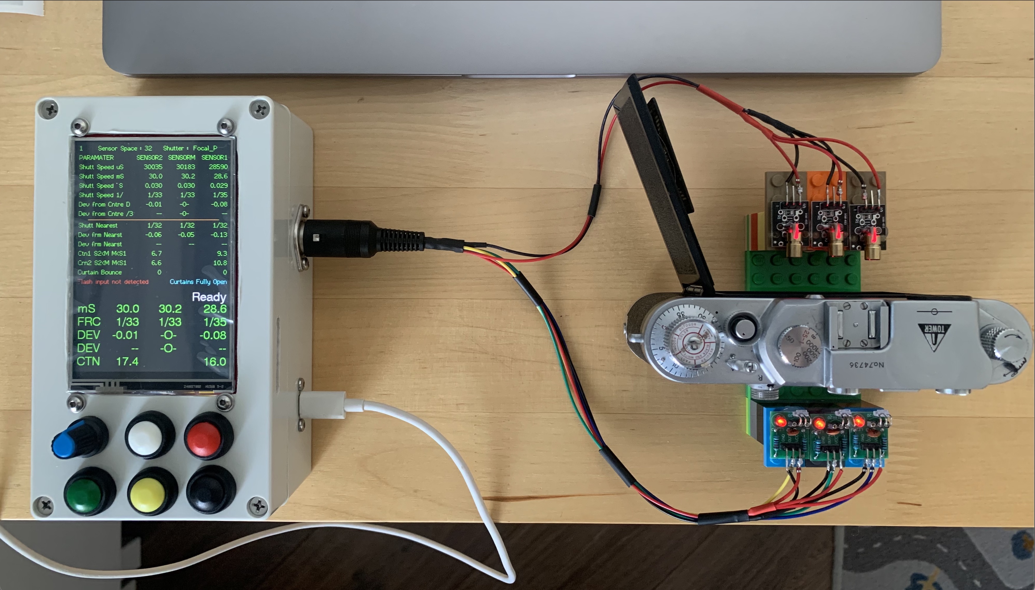

Finally managed to finish this project. Not the perfect one (somehow I switched sensors\lasers placement), but I like it. A huge thank you to Niglyn and everyone who posted their builds, it helped a lot in the process! And I think it works perfect! No strange readings or anything like that. I've tested two of my cameras already and the results look plausible.

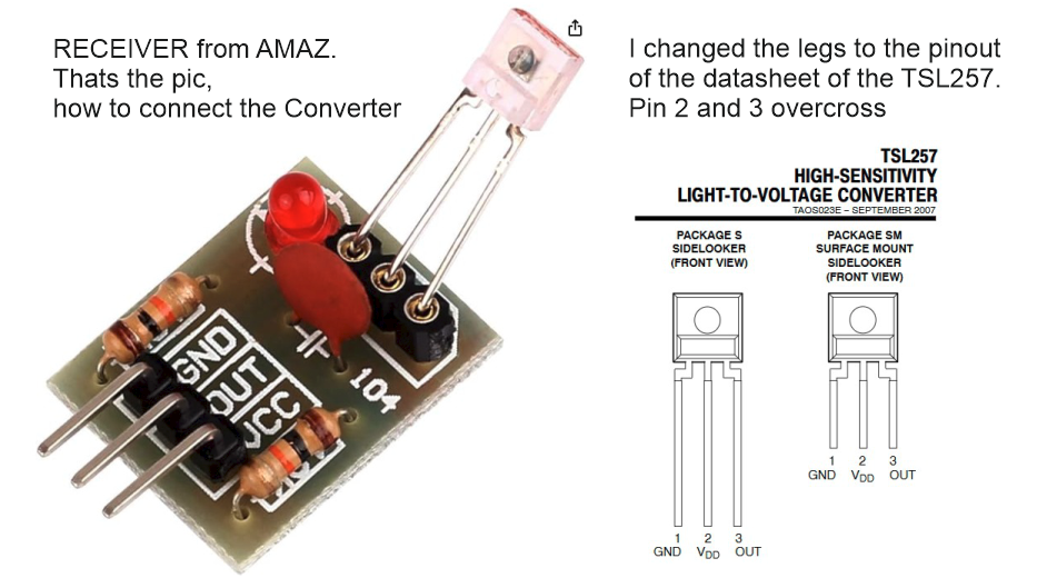

I have a problem with my laser receiver.. when laser is in the middle i have 0V,
In asolut darknes, closed all sides with fingers... a max of 2V.
I read that some other had problems with receiver wich dont work.
Is it right? LOW with Laser? how much V is HIGH ?
thx
I checked all my receiver boards (7 pcs.), all the same.
in darkness roundabout 2,2V, with laser in middle 0V.
The avr differece betwen high/low is between 2V - 3V.
It seems, that the BS12B20 board is for the temperature sensor.
what is the name of the phototransistor?
thx
thx
Hi, sounds like you have a short on your 3.3V line or a high resistance on the 3.3V going to your sensors.
Check you have not used the 'CMD' terminal, but the correct 0V terminals on the breakout board, as specified on the schematic.
(Boards have the CMD terminal incorrectly labelled as GND)

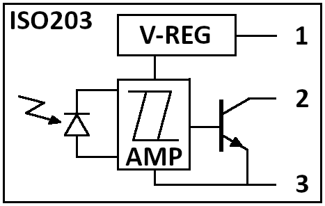

POWER OFF the shutter tester and remove the sensors only, from the sensor board. Power up the shutter tester.
Measure the voltage on the 3.3V terminal on the breakout-board, which goes to the sensors. Check it is actually 3.3V.
Measure the voltage on the sensor boards pins using the VCC & GND pins on the sensor board. Ensure it is 3.3V.
Measure the voltage on the sensor board pins between the middle pin and GND. ensure it is 3.3V
The sensor board has a 'pull-up' resister on it (between pin 1 &2 on the diagram below). What ever the input voltage on the sensor board is (3.3V), the middle pin will output this same voltage (3.3V) via the pull-up resister.
(If you are only getting 2.2V on the sensor input, then you will only get 2.2V on the sensor output).
When the sensor sees light, it will operate the transistor between pin 2 & 3, thus dumping the pull-up resister voltage to ground.
This then gives 0V on pin 2.
Light = 0V on pin 2
Dark = 3.3V on pin 2
Pull-up resisters are very important in electronics. They give a 'bang-bang' clean switch between 0V and 3.3V (or what ever voltage the circuit is using).
Without them, stray voltage is picked up on the pin, giving spurious input readings.

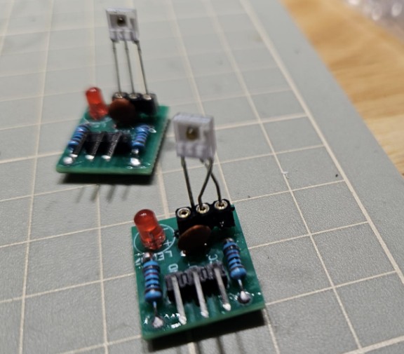

The sensor board is a simple generic board.
It just has a 10K-ohm pull-up resister between pin 1 & 2, a smoothing capacitor between 2 & 3
It has an LED, with current limiting resister.
So it could be used for any number of different digital sensors.
The senor itself is an ISO203 as shown below. It incorporates an optical lens, voltage regulator, light sensor, amplifier and switching output.
So it makes using them very easy, without the need for additional circuitry.

Problem solved > curios.
The receiver boards i bought from amaz are all 10 the same.
But! it seems that the high-density converter have changed.
No ISO203 , its a TSL257.
I changed to the pinout like the datasheet and it works.. pin 2 and 3 overcross.
in dark 0V.
with laser 3,5v oder more.
thx, Andreas

Hi, not sure why the TSL257 is being supplied. The TSL257 is an expensive sensor compared to the ISO203, but they are both expensive to purcase individually, rather than as part of the sensor module.
Have you left a review for the sensor on amazon, pointing out it is not directly compatible with the sensor board?
Looks like the output is reversed compared to the ISO203, so you will have to change the sensor type parameter in the Alignment utility to 'Old'
and put some sleeving on the sensor legs, so they do not short.

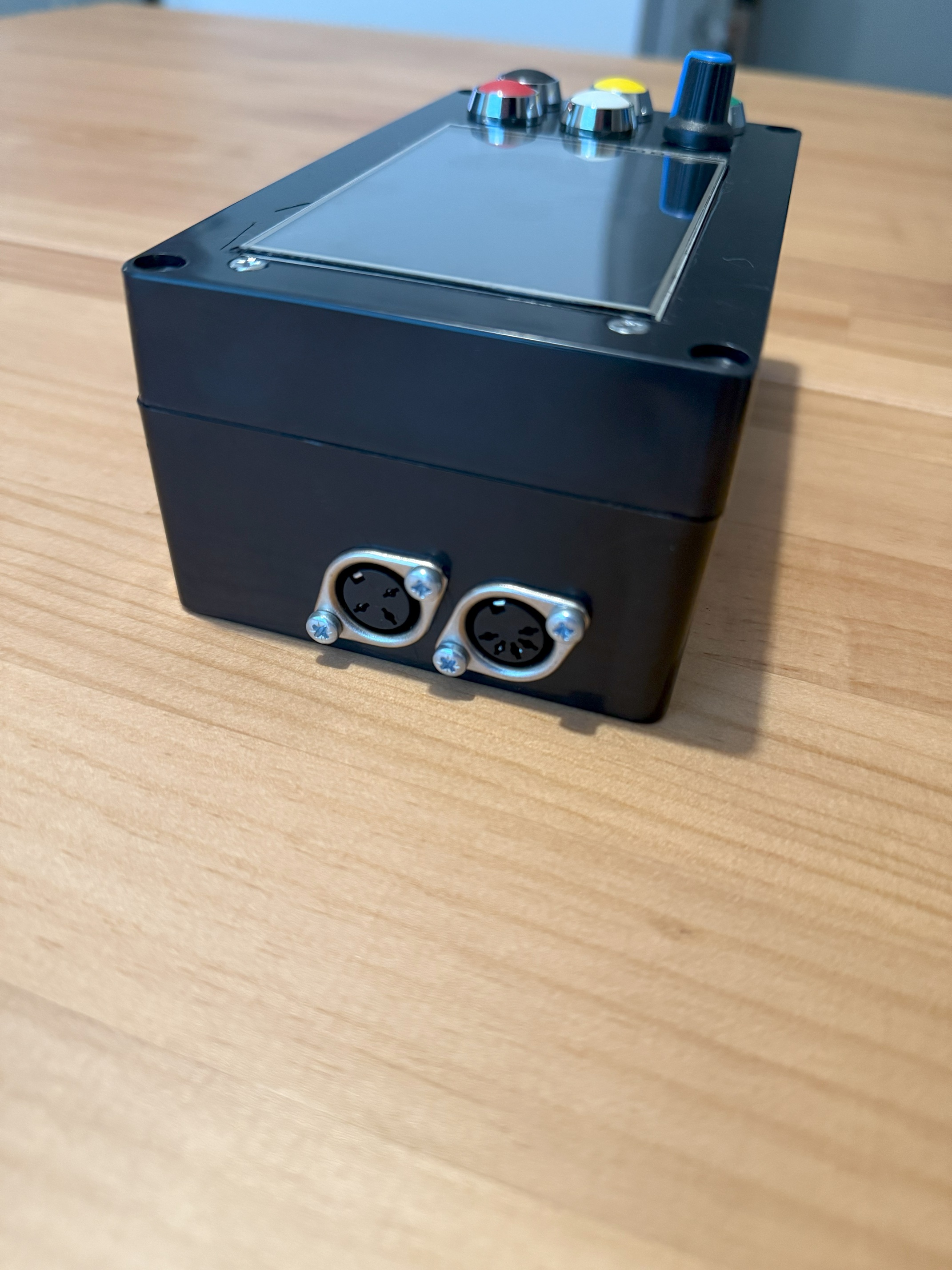

Hi,
First of all, huge thanks to Niglyn for the amazing work!
I've just found this project a few weeks ago and immediately ordered everything. I'm still missing the sensors but the main unit is finished, it's just waiting for the auth. code. :smile:
Hopefully next week everything arrives and I can 3d printing some brackets for the sensors. If somebody has STL file and willing to share I won't refuse the offer, otherwise I'll just design my own.
Niglyn, can you send me a PM please? By forum rules my permissions are restricted at the moment.
Picutres are coming later, and some test results also.
Gabor

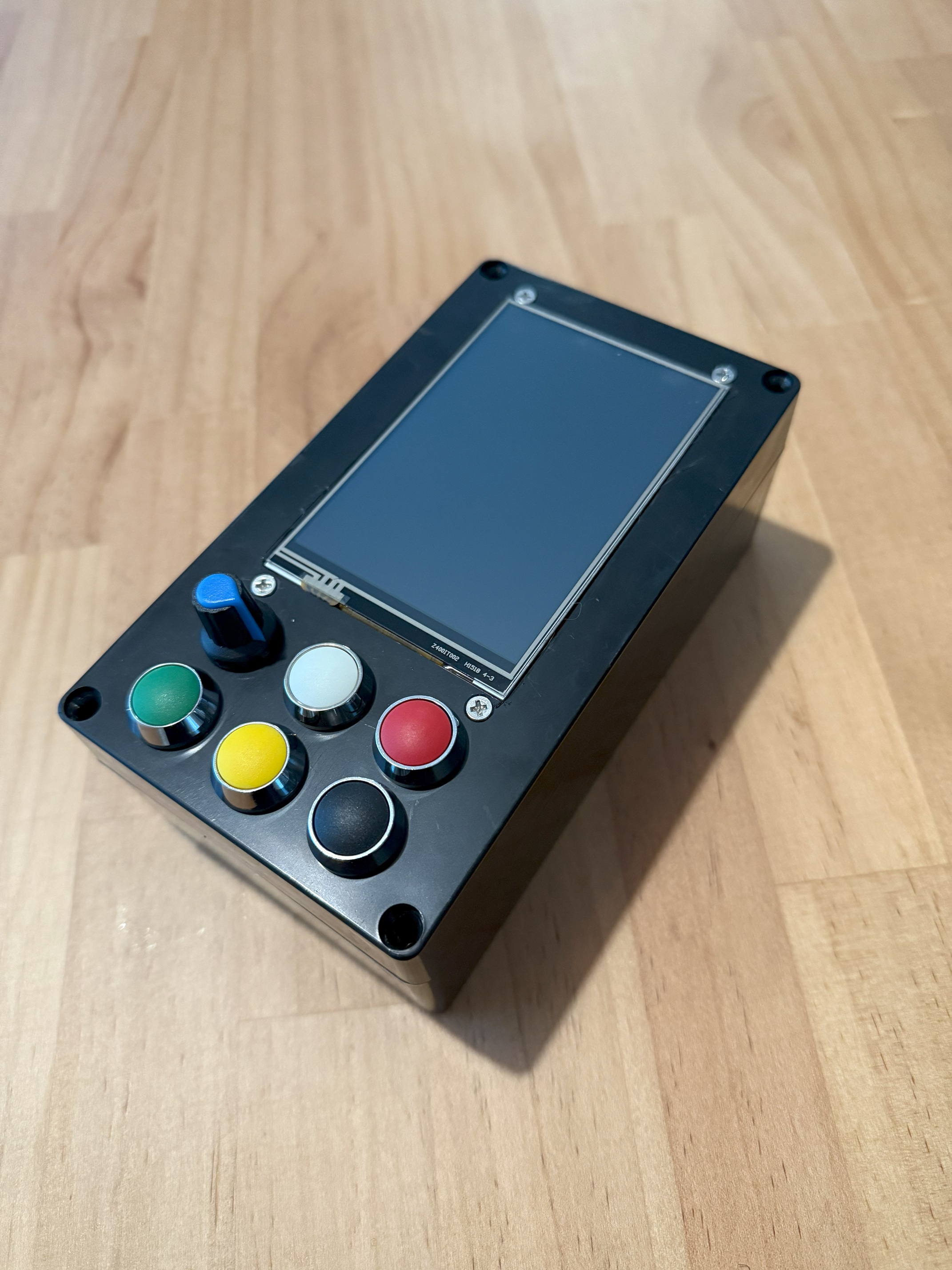

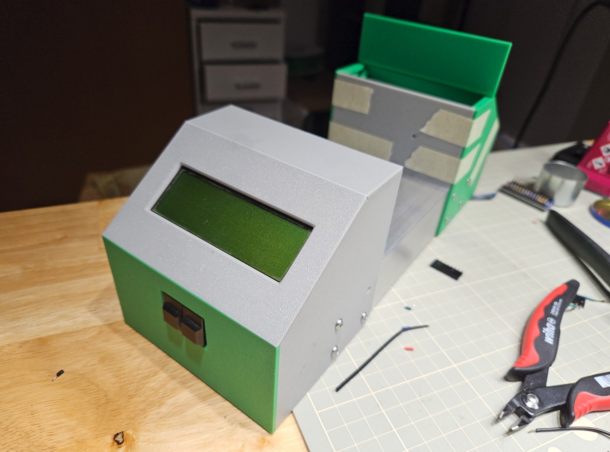

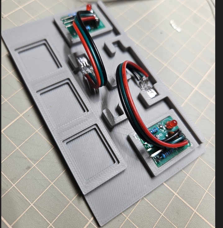

As I promised, some pictures of my build.
I went with the recommended standard but I'm not a big fan of cables coming out on the side so I relocated the connectors to the top. 3 pin for the lasers, 5 pin for the sensors. Still have enough space to install the USB-C port that should arrive next Monday.
I made the cables today, so after the sensors arrive I'll do some measurement and try to 3D print something nice. Hopefully some test results are coming next week. :smile:

Hi, thanks for posting the photos of your build.
The screen cut-out looks very neat, how did you do this?
(I used to have a milling machine, which was ideal for making the panel cut-outs)
I notice you are using slightly different buttons, with chrome bezels.
They look to be slightly smaller, which can help, as there is only just enough space for the specified buttons.
You could use the 5-pin din for both sensors & Lasers. This way you only have one cable going to the sensor frame.
Hope your USB cable and sensors arrive soon.
For the screen cut-out I used a metal ruler and a precision knife to make some grooves (just 3-4 passes with the knife) then I drilled the middle out leaving some material just like the build PDF suggests it.
I removed the excess plastic with Knipex Electronic Super Knips. I found these kind of pliers to be perfect tool for these kind of jobs. The blade just found the way into the grooves I made with the precision knife and it took just a minute or two the have a near perfect rectangle cut-out. Then I just used a cork sanding block with 240 grit sandpaper to smoothen the edge.
One more thing I did is to remove same material from the top inside part of the project box When I first put the screen in I noticed that the bottom part lays totally flat, but the top cannot because of the pin header's solder joints. So I made a 2mm wide 1-2mm deep groove in between the top 2 screw holes to make space for the solder joints and now the screen lays flat.
Yes, I was specifically looking for buttons with metal housing simply because I like the look more. I did not even think about the clearance to be honest.
I know I could use the 5-pin for both but I wanted to have the sensors and the lasers on different harnesses. It's just my preference. But I left the door open as I wired both connectors in a way that GND and 3V3 are on the same pins, so if I change my mind I can still use the 5 pin, and the other connector can be a spare for PC sync, light meter, etc. If I decide to implement them later. As long as every cable comes out on the top, I don't mind. :smile:
Suprisingly the USB cable and the sensors arrived today so I can finish the main unit and start working on the 3D prints.
I'll keep you posted.
