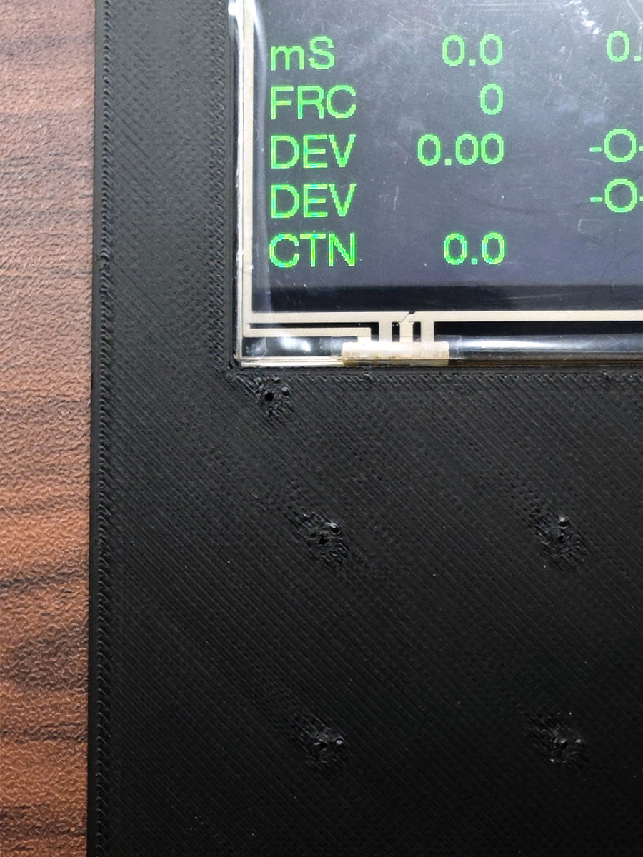

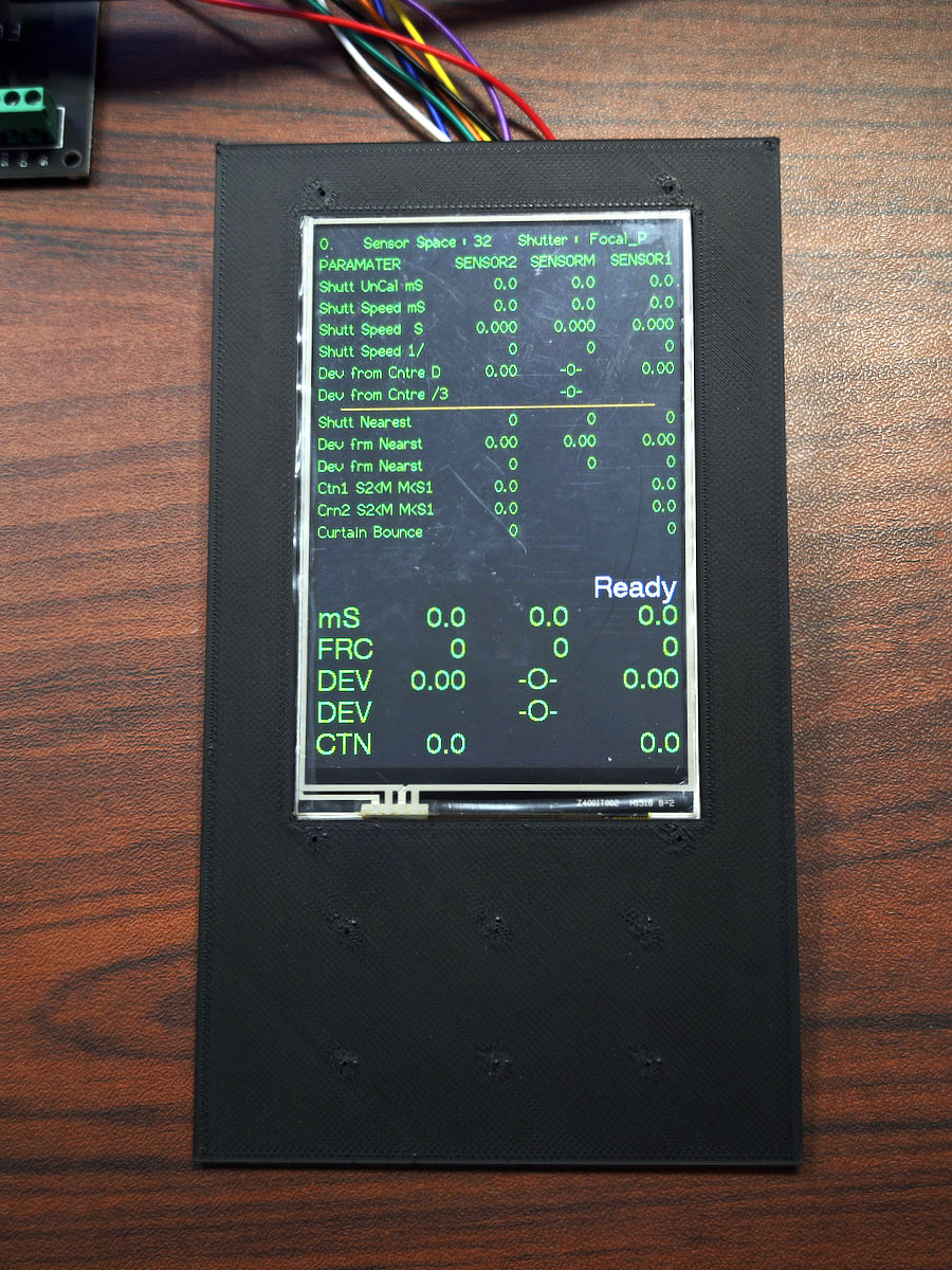

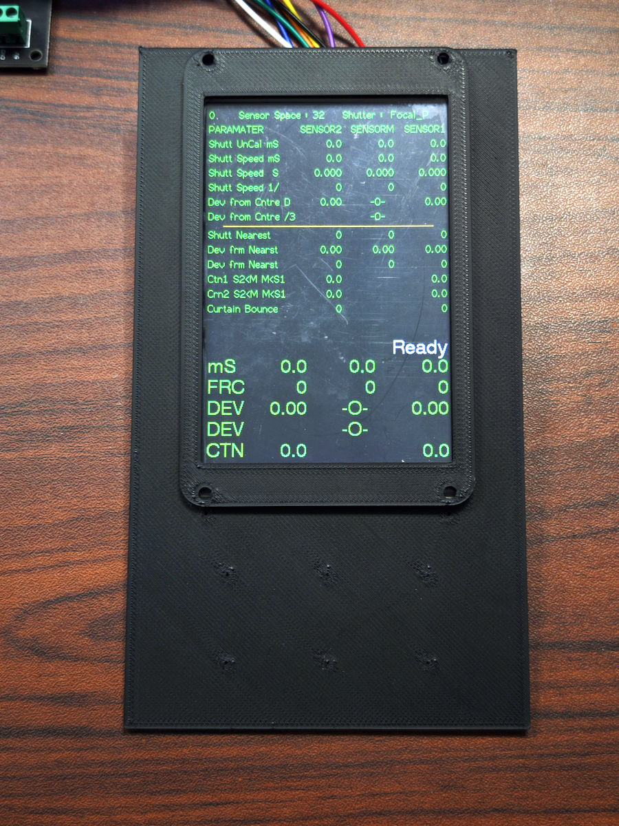

This week was extremely busy, but I managed to quickly print four 3D models from Git at the beginning of the week. The printing was just for testing, with relatively high speed and below-average quality, using ASA material. It was just an experiment to see if the dimensions would fit. I won't use these prints myself, as I have a slightly different solution in preparation, but I promised the prints, so here are the photos.
The frame is dimensionally correct, the LCD panel fits well into the cutout (including the protective film), and although I didn't drill the holes to the screw size, according to the print, this also looks fine. The boards with the laser module placements are also relatively correct, perhaps I would add 0.1mm to the diameter of the hole for the laser, but that could also be due to the fast printing.
basic frame with LCD cutout
with cover frame
plates for lasers
Thanks for printing them.
The basic frame is only meant to be a template, to mark out the top of the project box.
The bezel or frame looks to be wrong. Is maybe just upside down?
It should attach using the same holes through the TFT, however, the top holes are two high, as shown in the photo.
Hi Niglyn, it's possible. I didn't examine it in detail, I just printed it at your request and quickly took photos with my mobile phone. If a lower print speed and higher print quality are set, the prints will look significantly better.
If you want, send me your address and I'll send you these 3D printed parts to the UK, I won't use them anyway.
Hi, thanks for printing them & thanks for the offer to send them, but I don't think its worth the cost of postage.
If there is somebody more local to yourself, they may like them to try the template.

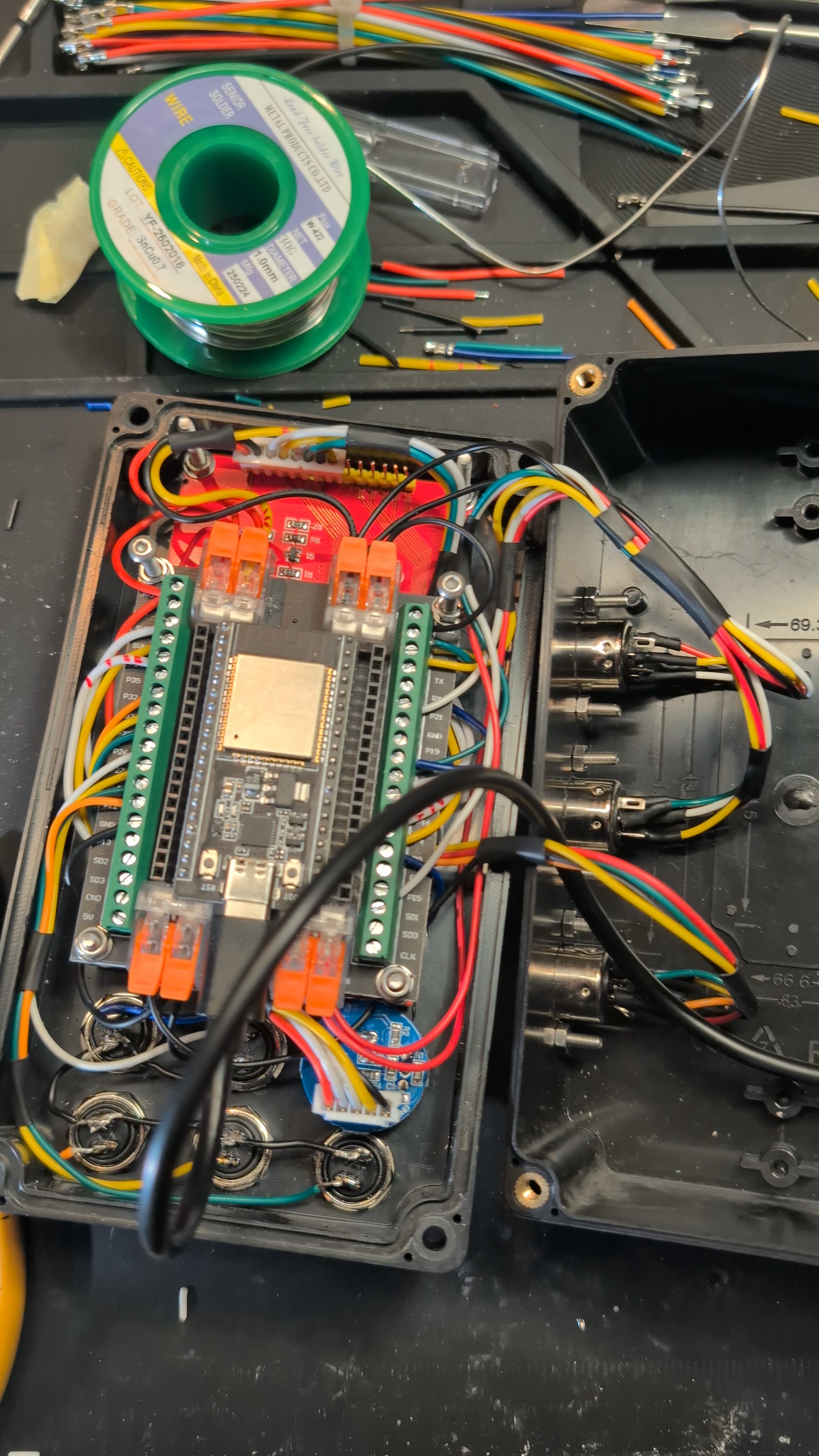

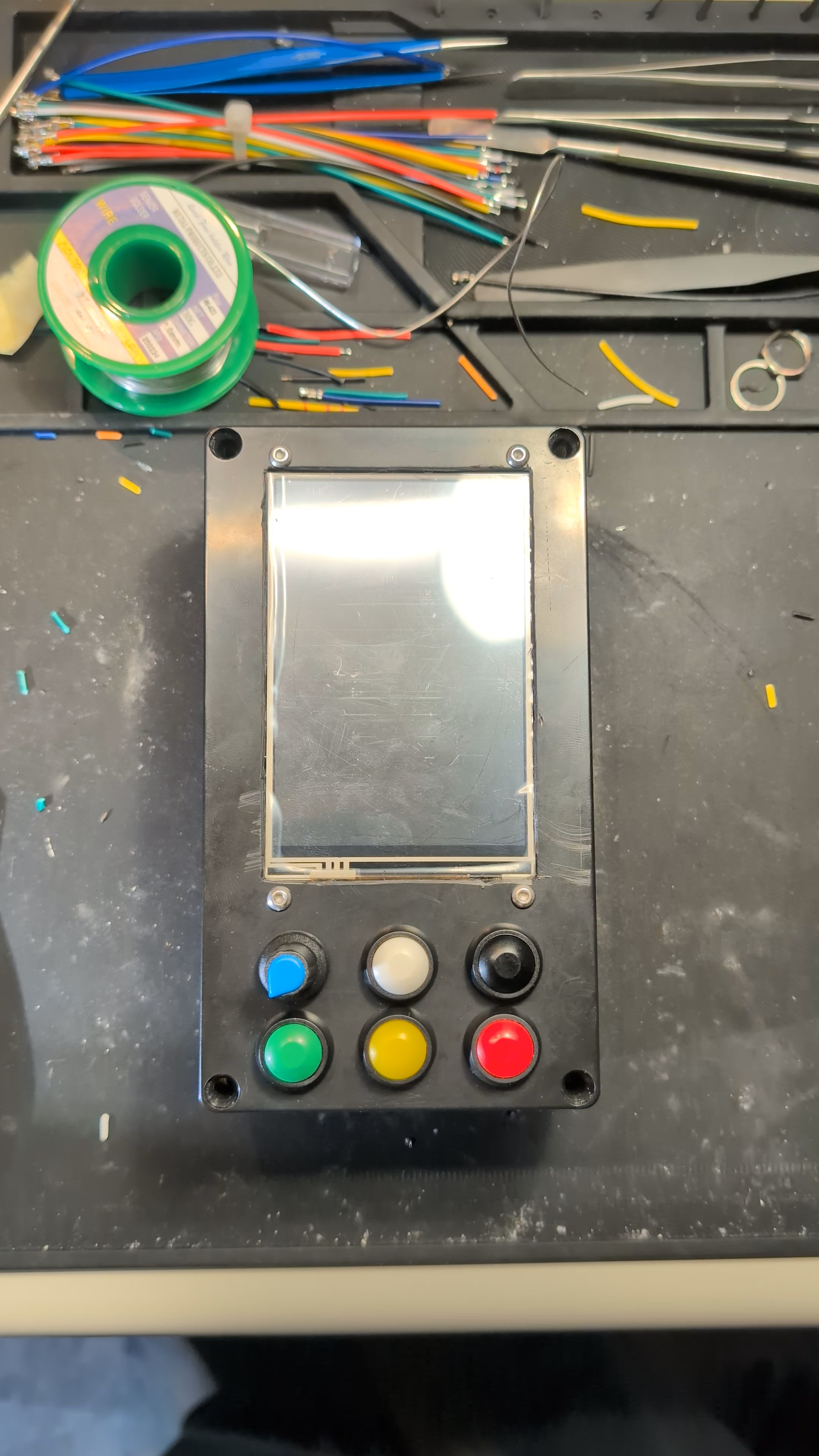

heyy, I just finished building the box! I need to build the sensor/laser, light meter and all the external part to the box.
but I think I will already try to install the driver, flashing and these things.
I want to be sure that I can do that before doing and connecting the laser sensor modules. But I think its okey.
And I will also need a pass or something like that at a moment in the installation ?
First time in my life doing electronics and things like that but I'm really having a lot of fun right now. Thanks for all the ressources !

Hi, looking good so far :surprised:)Looks to be identical to mine inside :surprised:)
Glad you are finding it interesting and fun to do.
From here, you can learn Arduino (I recently posted a link to a beginner course)
and start building your own projects.
Look at my github, I have made a weather-clock, modern film developing timer etc.
Would be great if you could do a mini-blog & post here.
How easy you found it to build, any problems you encountered or things that were not clear etc.
Hi, just a tip, throw that lead-free solder away and buy some proper lead/tin solder.
It can be difficult to ensure it is actually lead/tin. Sometimes it states 60/40 (which is the percentage of lead to tin)
and does not actually state it contains lead.
On Aliecxpress, I have seen the same solder listed as both 'lead-free' and 'lead-solder' so be careful.
I bought mine via Amazon, whist more expensive, I was able to confirm it was proper lead-solder before purchase.
You will find soldering with lead solder far easier, it melts at a lower temperature and gives a nicer shiny joint, which is not as brittle as this horrible lead-free stuff.
