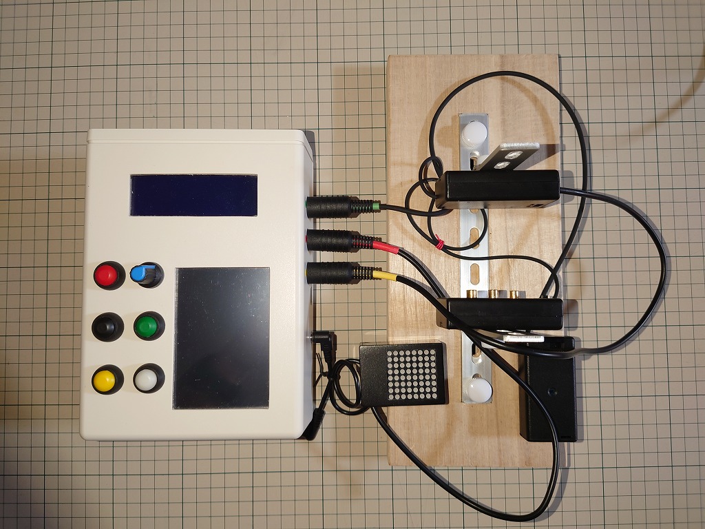

found out fixing old camera is fun and I really have a couple cameras that need shutter love :smile:
=> You are my hero !
I still need to position the lasers but so far the main assembly is done and after a bit fighting (had to boot windows to flash) , it seems to boot/work even if I am usually pretty bad at HW ...
Obligatory photos (I'll post more when done)

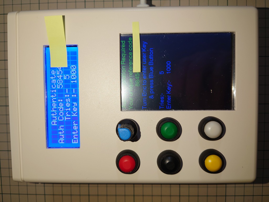

Yeah - I don't need a key... I may have poked around/reverse engineered a bit and keygen'ed my way in... but it's for my own guilty pleasure ^_^

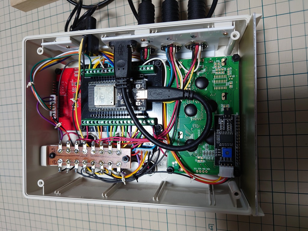

Hi,Niglyn
Thanks for posting your project!
I followed your post and build the system as per your information, only the passcode is missing, you can send it to me?

Nice build !
Nota:You should provide your reference code so @Niglyn can send you the auth code 😄

Hi, code sent.
Looks like you went for the full monty! Don't think anyone has done that yet.
I like your case & they way you have done the power bus bar.

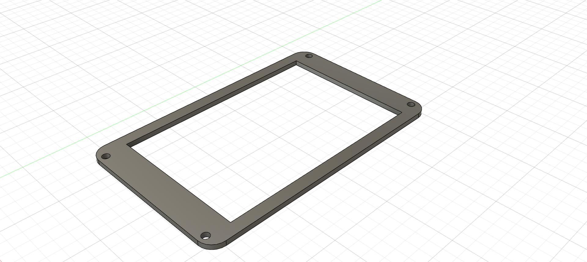

Hi, here is a piccy of the bezel. It is designed to fit over the gap between the project-box cut-out and the TFT screen, to give a neater appearance.
3d print (stl) file of this & a cutting template for hole & buttons are on the github page.
I have no idea if it will fit as I do not have a 3d printer to test it.

Hi Niglyn,
If no one gets to it faster, I'll print the part for you next week and try it on the LCD to see if it fits properly.
I might be able to add the part to an ongoing print, but I can't guarantee that, the printer is running almost non-stop right now.
Do you want to use any special material for the print, or is any material fine for testing?
BTW, please add a link to Github to the 1st post or your signature, thanks! :]

Hi, thanks would be great if you could print it & see if it fits.
I used the diagram on the seller's site which gives most of the dimensions. I had to measure a few myself.
I know nothing about 3d printing, so please change or adjust as you think fit. I did not add a bevel to the edges as was not sure if it would print ok.
Happy for any and all suggestions as to size/thickness, materials etc.
