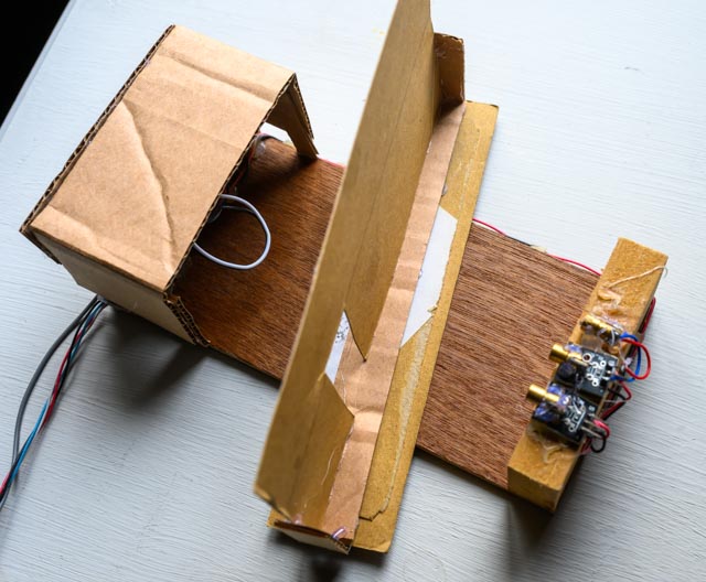

A question was asked as to why shutter speeds in my photos are so slow.
Well here is the answer.
This is my shutter-tester tester.
Rather than having to keep charging the shutter, I have a piece of card with a slot cut in it, which I push from one side to the other :surprised:)
I have a few variations, including one card with multiple slots, to simulate curtain bounce.

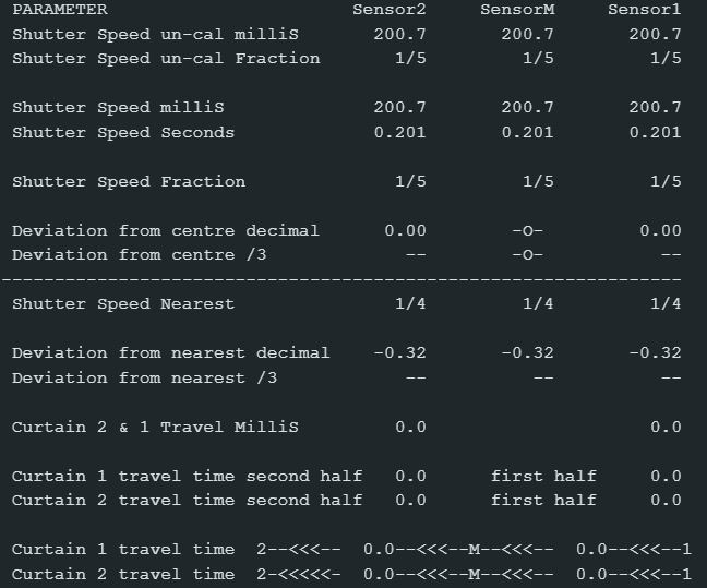

So here is an interesting screen shot from The Shutter Tester.
I have been trying to find a suitable LED light, that can be controlled by PWM, but crucially is then driven by controlled current, so there is no PWM flickering.
Turning the LED light on & then off, all sensors are seen and blocked at exactly the same time.
This proves that there is no jitter or lag in the code, as each sensor state changes.

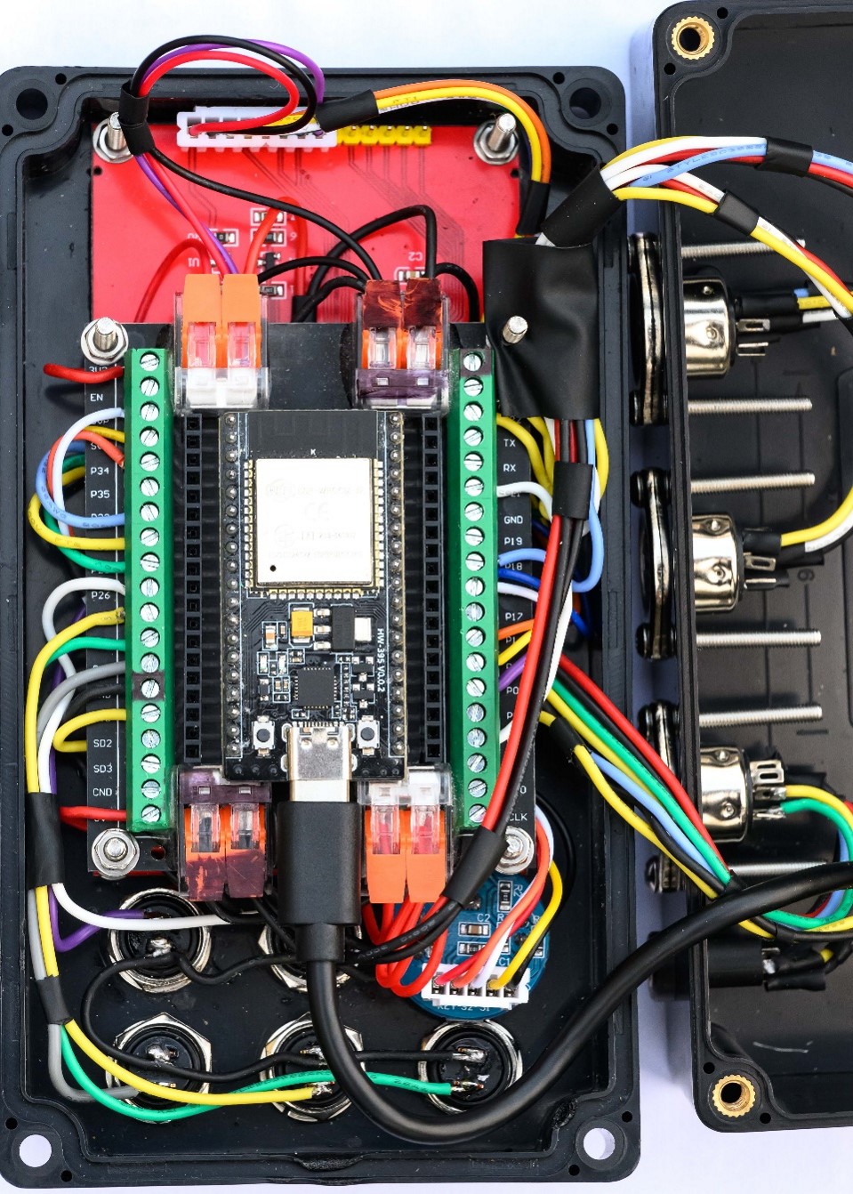

Hi, as requested, I'm embarking on building this thing and saying hi. Currently got as far as ordering all the bits in the list, now waiting for them to arrive. Very excited about it, looks like a lot of work has gone in to it, so very generous of Niglyn to share it in the first place and others to contribute. Anyway, thats it for now, hopefully I'll be back soon with a finished build, or a bunch of problems. One of the two :smile:
Hi Desmondo, welcome to the thread. Hopefully you will find the build guides will take you through the build ok. Feel free to ask any questions if anything is not clear.
I built a complete new V4 tester to enable me to update the build documents and take new photographs, so hopefully everything should be correct.
Please report back any mistakes or anything which is not clear, so I can correct and update them where required.
Thank you, I can't wait to get started and will let you know how I get on!

  • it is not necessary to install Arduino IDE just for the console (in the case of the ESP32 variant), a simple Putty program is sufficient. Set the COM port according to what the ESP will have in Device Manager and the speed is 115200bps
  • for installation, only ESP32 and encoder are needed
  • if you are looking for a blue button in the diagram like I did, it is part of the encoder, the rotary knob is also a push button :]
