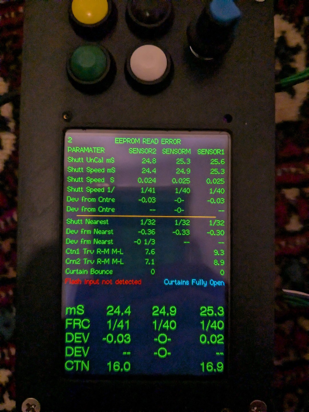

My DEV values don't seem to match your description (5.6ms S1 vs 4.1ms M is 1.5ms difference or +0.45EV). I'll check the manual when it comes out.
I think the labels S1/M/S2 would be better. L/R can be confusing if you turn the tester 180 degrees, or for vertical shutters.
I understand that because the curtains are accelerating, the slit naturally widens from start to finish. However the total travel time should be the same (like two apples falling from the same height) and exposure time should also be the same (larger slit but faster = smaller slit but slower). It seems the 1st curtain in my camera is accelerating more between M-S2, hence the shorter exposure on S2.
Maybe it's not overly significant. Here's the output for 1/30.

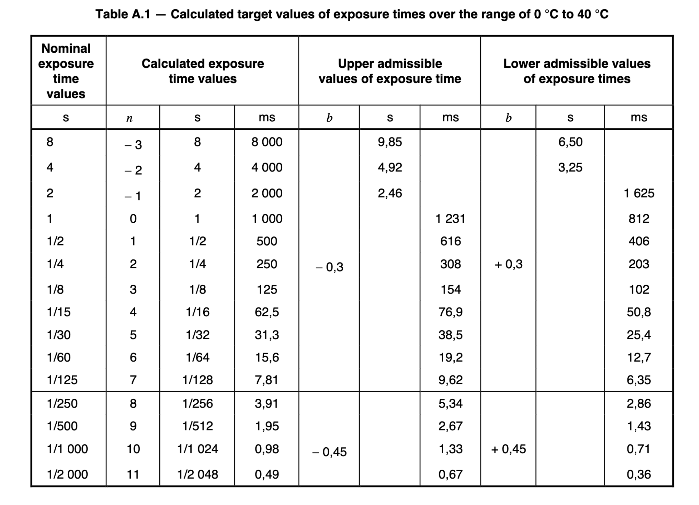

For reference, the values are calculated here in the table "Annex A," referred to in the above ISO 516:

Checked the code, Dev is indeed in decimal stops, or EV.
Then also expressed as a fraction in 1/3 stops.
There is a slight error on the TFT as it does not display the sensor 1 Dev value correctly.
It is fine on the PC screen.
It has been corrected for version V4.0,0.1 beta.
I also found another bug, that has been bugging me (no pun intended) where the light-meter looses it's calibration setting.
Also fixed.
Have also changed the display for curtain travel as per OAPOli's suggestion.

Hi. Can you tell me what the problem might be? Sometimes this error pops up, but not every time. I didn't see any pattern in it. That is, for example, I do 3 tests and everything is fine. I do not change anything and do the 4th test and for some reason an error comes out
The assembly was almost completed. It remains to finish a little and solve this error.

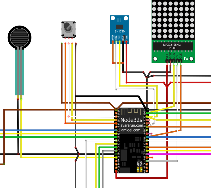

By the way, I found one error in the connection diagram V4. When I'm done, I'll tell you where to fix it
This error did not appear on V3 version, it seems, it appeared only in V4 version.
Yes please tell me of the error in the diagram.
I changed the colours & layout from V3 but have not actually followed it to build a V4 tester. I am planning on doing so this coming week, to take photos and update the build documents.
The error you are seeing is because sensor 2 was triggered for some reason and as no other sensors were triggered within 32 seconds, it shows an error.
Currently, the tester takes a reading & goes straight back to looking for the next sensor inputs without delay. This can cause some errors, if the sensor sees a reflection, for example, so thinks a new test has started.
The new version is about to go onto gitbub, should be within the hour. It now has a delay between readings and checks that all sensors are blocked before proceeding.

I checked the new firmware and the problem with the 2nd sensor seems to be gone🙂

Regarding that error in the scheme. Everything is simple. The output of the encoder and buttons are not connected to GND. The fix is very simple
And regarding the fact that the sensors read the same value in different ways - Everything is cool. Everything is fine with the new firmware version. This problem is no longer there
