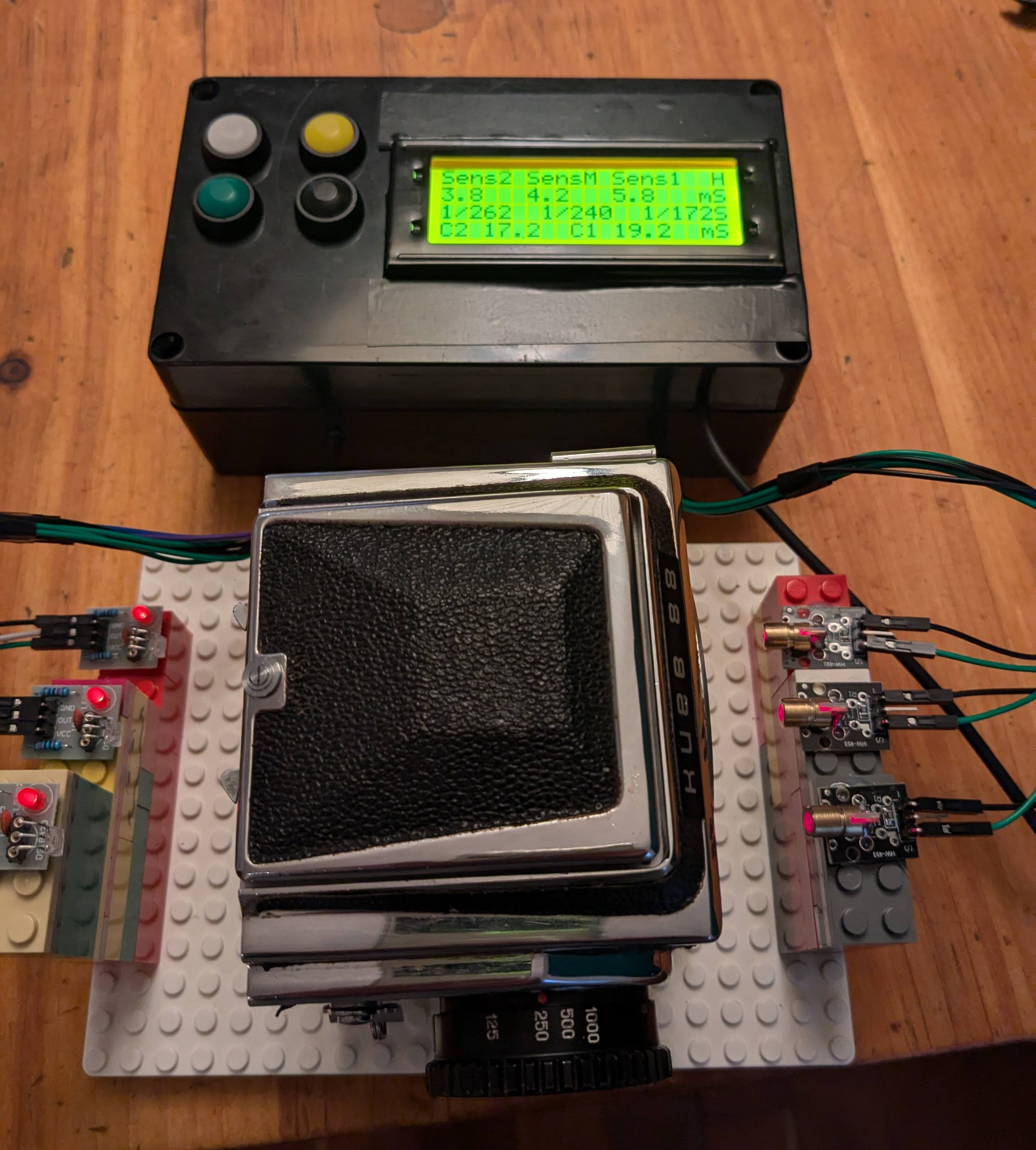

Thanks. I changed the SPI speed to 80MHz and I was able to flash the code.
I set my tester for 6x6 SLRs. I spaced the sensors at 51mm vertical and horizontal (I'm guessing the standard is frame size minus 2mm on each side?). You have to put the lasers closer than that because the lens flange opening is smaller than the frame. I still have to make the sensor aperture plate.
This Kiev 88 has a slower first curtain at the high speed settings. ~1/2 stop difference, although this is asymptomatic on the negatives.
Is there a way to test leaf shutters on this setup? Maybe have a mode where only the central sensor is used?
Hi Oapoli,
Glad you got the flashing sorted.
I like your Lego towers :surprised:)
Having the sensors in a diagonal pattern is a pain to align. If you are only doing horizontal shutters, then having all sensors horizontal makes it far easier.
Yes, the tester does leaf shutters. Just ensure sensor M and 2 are covered. Then the tester will use only senor 1. It gives a raw value for when the sensor sees and does not see the laser.
Now a slight problem, the tester is designed for 35mm cameras only. Service manuals specify a standard sensor spacing of 32mm for horizontal or 20 mm for vertical shutters.
In the setup screen, one selects either horizontal or vertical shutters. My clever code then uses an algorithm based on this setting to compute the actual shutter speed, removing the error that so many other testers suffer from, where the tester measures both slit width and sensor width. If the sensors are not set at 32 or 20mm, the speeds shown will be incorrect.
I have not looked at a medium format service manual, to see if it gives sensor width spacing. If it does, it will be a small matter to add it to the code.

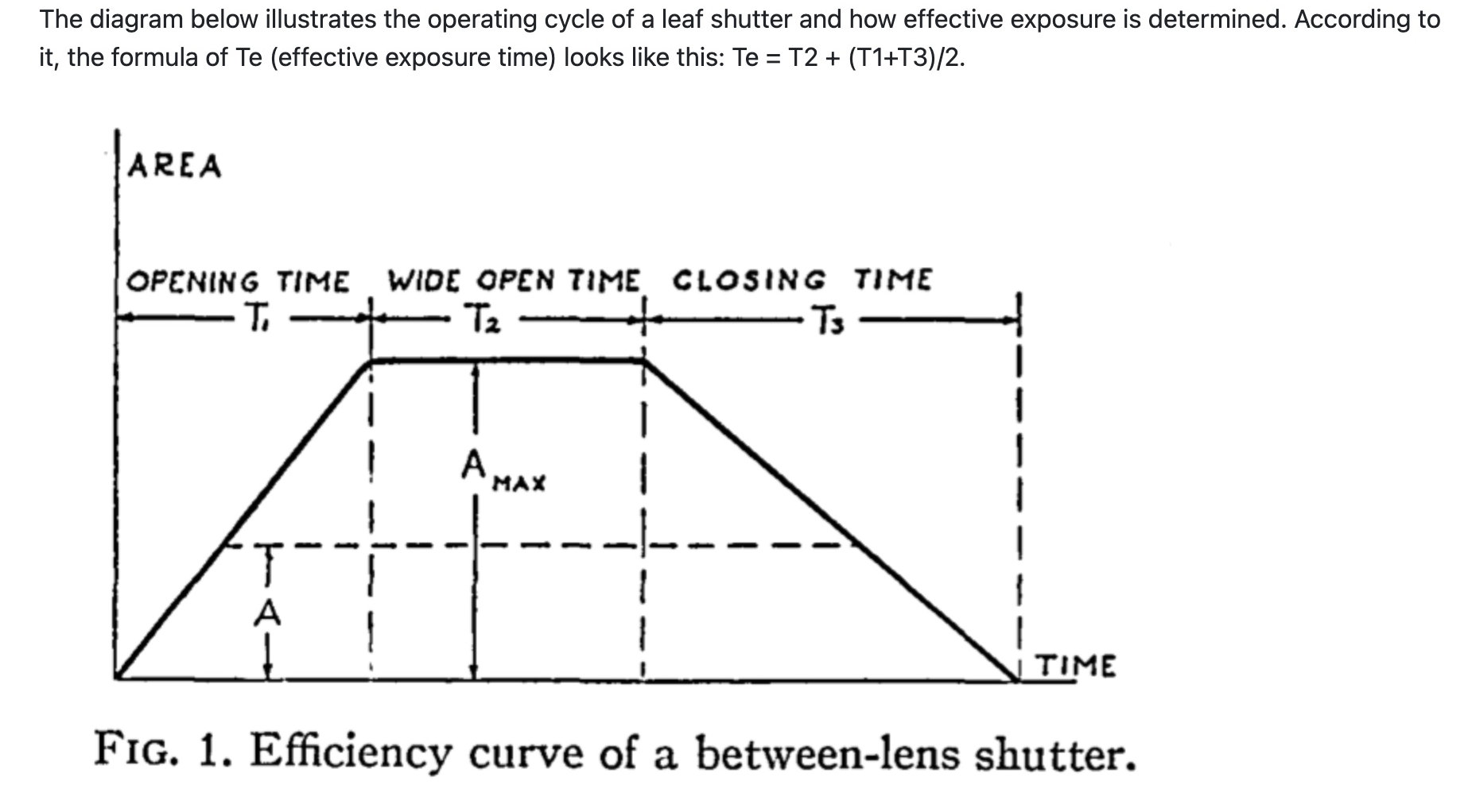

OAPoli, the tester was designed to measure focal-plane shutters. Additionally, it has a simple one senor reading. I use it for a Box Brownie.
Not sure why you are getting the<100 microseconds warning, This indicates that the shutter speed was recorded as less than 100 microseconds. This is most often caused by LED lighting which is interfering with the reading. I get this warning if my tester is too near the computer screen.
I will check my tester & see if it works ok, using one sensor and post back.
It is very easy to add additional sensor spacing. I will probably do it by adding a rotary encoder, to save having to bush a button multiple times.
Also easy to add better leaf shutter testing, as per IC's diagram using two sensors centre and edge of the lens.

Adding the leaf shutter calculation is quite straight forward, however it is a bit messy to select it, so will probably leave it until version 4, which will allow any sensor width to be selected.

Leaf shutter testing has been added, using the calculation as detailed by Icracer. Not having a leaf shutter, I have only been able to test it with a homemade leaf shutter. It seems to function correctly.

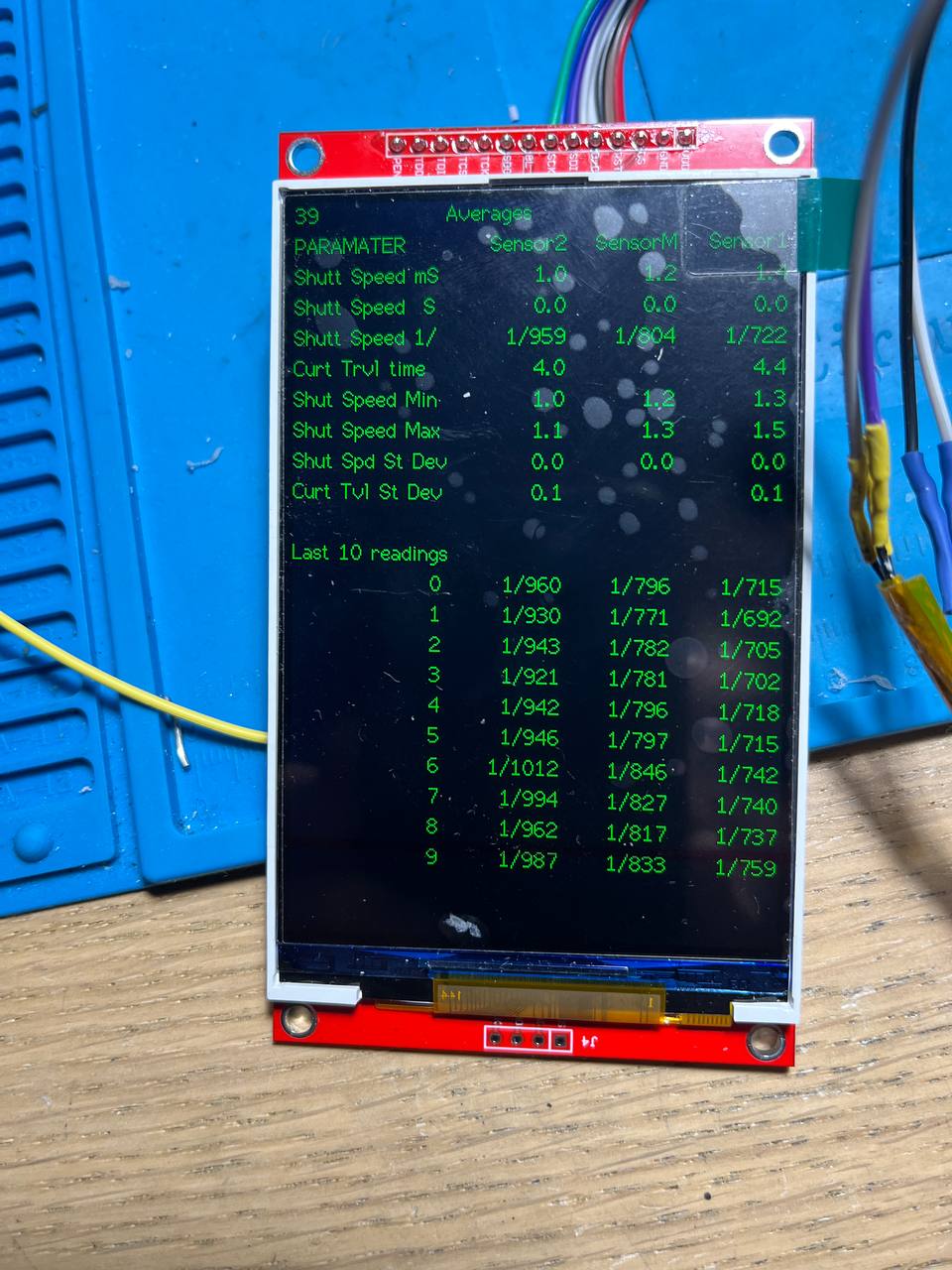

Thanks @Niglyn, I've installed the TFT screen and rotary encoder. Just wondering how to install the beta v4? I tried flashing the new partition.bin but I don't think that works.

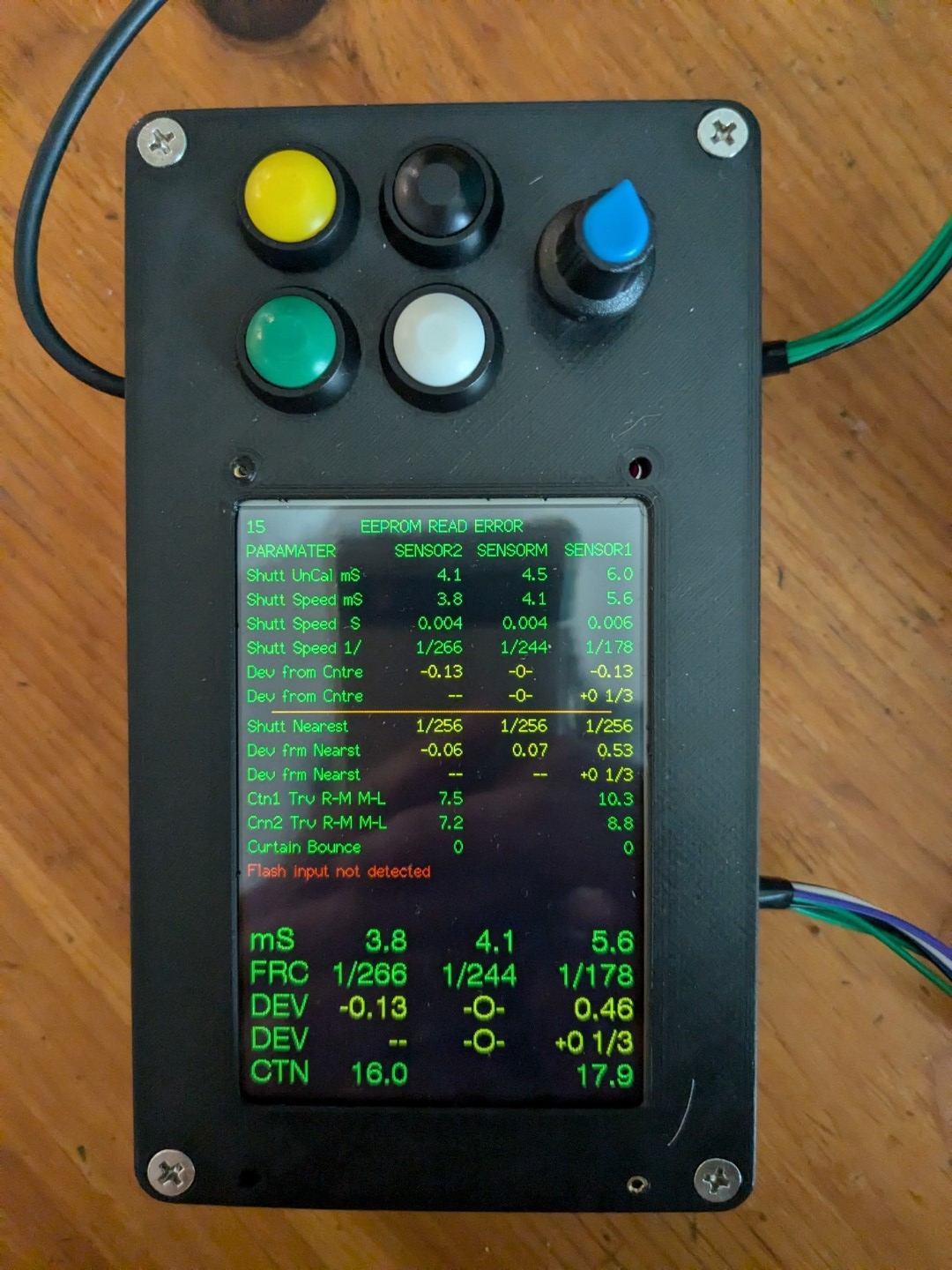

Thanks @Niglyn! The v4 is great so far.
I have some questions regarding the screen output.
1. first line has "EEPRON READ ERROR", not sure what that means;
2. the two DEV lines are decimal EV and fractional EV errors ( i.e. log2(val/ref) )? Some values don't seem to match;
3. the curtain travel labels R-M and M-L may be ambiguous, I would suggest replacing with S1-M and M-S2 or something analogous
It seems my Kiev 88 has uneven curtain movement, but on film this seems asymptomatic. I have to investigate further.
Also, does the tester expects a sensor mask with 1mm holes?
PS. it appears that the leaf shutter mode is not functional
Hi,
Thanks, you have found the first bug. The top of the screen shows horizontal or vertical shutter in V3. This is gone in V4, replaced with user set sensor spacing. As a valid sensor spacing could not be read, my error checking assumes an EEPROM fault.
I have changed it to show sensor space.
Dev is deviation from centre. in mS and deviation as a vulgar fraction to the nearest 1/3 stop.
New V4 user guide details the readings. Have been taking the photos for the user guide today. Will be on github when finished.
Not sure which is better, right-middle-left or sensor1-middle-sensor2
Maybe R<M : M<L or S1<M : M<S2
You will never get mechanical focal-plane shutters to give 100% accurate results. We are measuring old mechanical movement with modern electronic testers with nS timing.
Further up this thread is the iso tolerance figures. Work on 20% up to 1/125s and 30% 1/250s and above.
Your screenshot shows nearest shutter speed from all three sensors is 1/256s which is good.
Deviation show right side at 1/3 stop more exposure.
Both curtains continue to accelerate across the frame, so will give a shorter exposure at the final end, with curtain 2 travelling faster.
I would say that the shutter is working fine and within tolerance.
