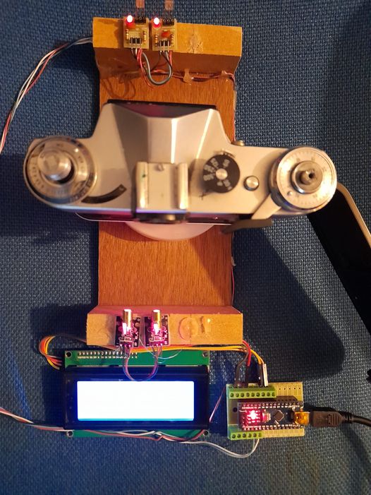

So here is a photo of the shutter tester.
It uses cheap simple parts,
Arduino Nano
Arduino Nano breakout board (optional but it makes wiring far easier)
An Arduino 2004 LCD with built in 2IIC module
Dupont male to female hook up wires.
Arduino laser tx & rx modules, two of .
I have used some scrap wood to mount the lasers. They are 20mm apart. The distance between the tx & rx can be anything (within reason) mine is spaced for a box brownie :surprised:)
The height of the lasers is such that a camera can be placed there horizontally or vertically, depending on the shutter orientation. A spacer is used under the camera to raised to the correct height.
The tx & rx units are hot-glued onto the wood. This allows for easy repositioning when required.
I just left mine like this, it could of course all be mounted into a project box

Measuring the curtain speed is easy. When first laser is seen, the time is recorded. When curtain moves across and the second laser is seen, again the time is recorded. Take these two away and that is the travel time :surprised:)
Same happens in reverse for second curtain. So now four time measurements have been taken, which can be used to calculate first & second curtain speed and exposure at two sperate points during curtain travel.
I have plans to move to a faster processor & use five sensors. An additional two at either end of travel and one at the top. This way, flash sync can be measured as well as mirror up confirmation before exposure. However, the object of this tester, is to make one that is esy to build, cheap and works correctly.

Viewed from behind the camera, the right rx sensor is sensor 1 (wired to pin 2) and the left sensor is sensor 2 (wired to pin 3)
When the Arduino is powerd (by connecting the USB cable) the red LEDs on the rx modules should light.

A jig will need constructing to hold the tx & rx in a suitable position. I just used some wood, cut to the correct height and glued to a piece of plywood. The tx & rx were hot glued.
You can of course box it all up in a project box & make it all look neat & even mount the rx into a boxthat fits in the back of the camera, against the gate, in the same way a 'professional' unit does.

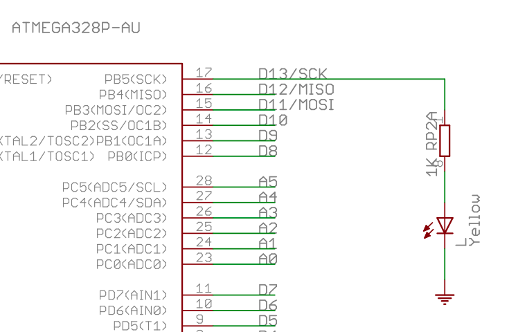

If you are typing along with Paul, when he uses 13 for 'pinMode', change this to 16. Reason being the built in LED on Nano is on pin 16.
I think on the original Nano the LED is on 13 alright (PB5):
This is from the Arduino Nano schematic V3.2 ; I don't think many changes have been made to the LED arrangement.
However, clones from China could have the onboard LED on pretty much any GPIO. Not all clones necessarily follow the schematic of the original, although the ones I've got here do. Hence, it's possible that on your particular board the LED really is on 16 (pin PC2 / A2). Btw, this would be an unfortunate choice as it will interfere with some applications where one would like to use ADC2 as an analog input. Having a fairly low impedance LED on there would pose a load on any analog signal one might want to measure. Hence, a well-designed clone should either follow the original or use another suitable GPIO for the LED.

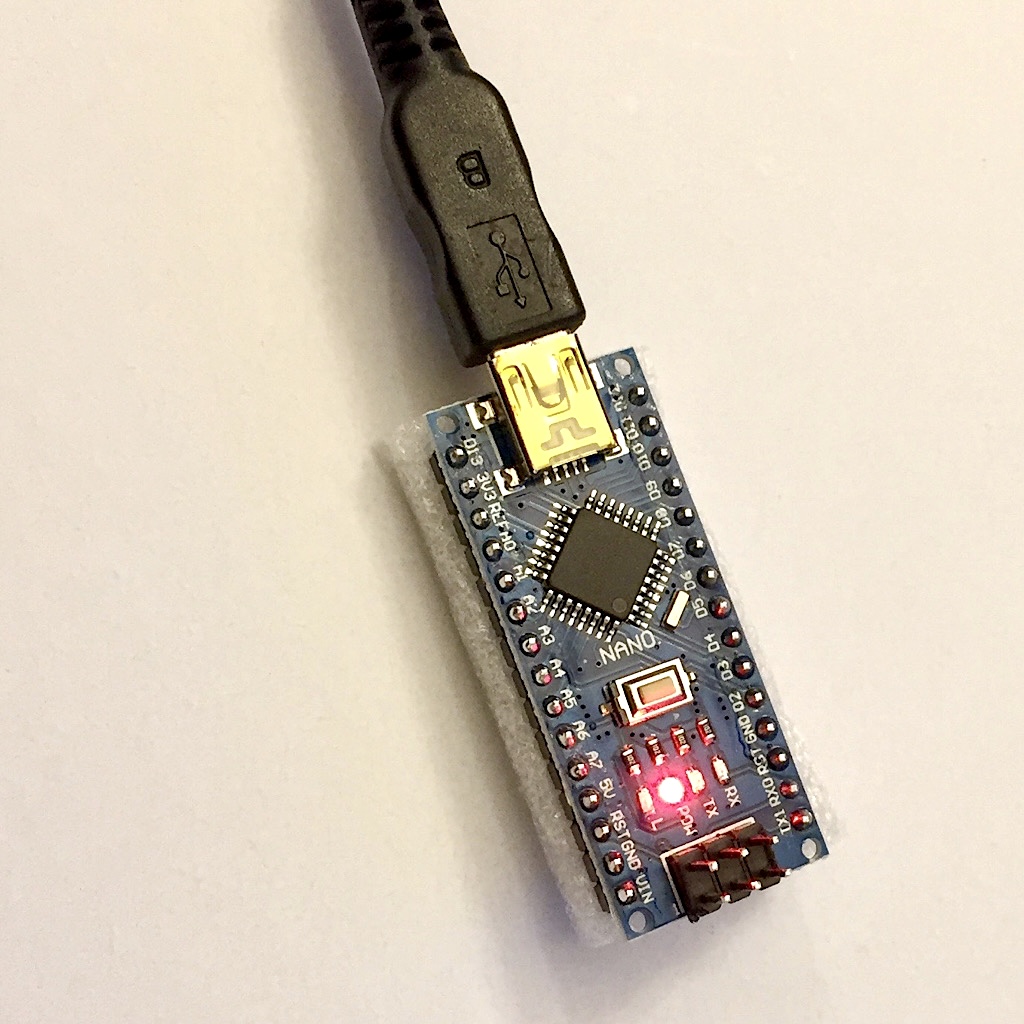

I ordered all the bits yesterday morning and the first one, the Arduino Nano board, arrived in the post this morning, impressively quick delivery. Loaded the Linux version of the Arduino IDE onto my desktop tonight and eventually managed to get my computer to talk to it, loading the 'blink' example - it took me a while to get it set-up as I only found the 'Tools/Processor' option with the 'old bootloader' displayed in the IDE once I realised it was a Nano board and not a Uno! PEBKAC!
My Nano board running the 'blink' example program - not that you can see it flashing!
Now I just need the other bits to arrive.

Yes, I think you are right. I just saw it on the interweb that nano has LED on pin 16, which did seem a little strange to me. I have limited access to tech right now, so was unable to check. Have just tried my nano and indeed LED is on pin 13.
