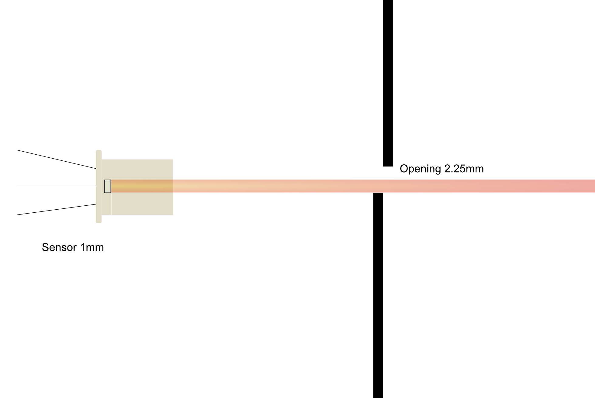

No, it turns on too soon and off too late because the sensor is not a point source. Uncorrected, one will need to adjust the shutter opening to 1.25mm to read 1/1000 which will lead to under exposure.

Sorry, I see what you mean now. You're right; you'd have to either determine the width of the beam at the sensor site or calibrate the way you proposed.
Should not make any difference to curtain speed measurement.
For exposure, then yes, as a single laser is measuring from just when the laser is seen to just when it is blocked.
If you know the width of the beam and as we know the speed of the curtain, it would be possible to calculate how long the curtain travelled over the beam and and deduct this from the exposure value. However this is complicated by the fact you do not know exactly at what percentage of rx being uncovered/blocked, will turn it on or off. The rx may only need to be uncovered by 50% or 37% of the beam width.....as said, chasing your tail.
Using a mask in front of the rx, with say a 1mm slit, will limit the beam width.

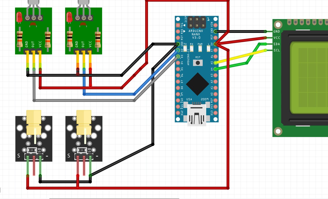

Here is a diagram of the wiring. I think it is correct, if not, I'm sure I will get jumped on quite quickly :surprised:)
Thank you for posting the diagram. Again, the power is going to come via the USB, correct?
All shutter testers need to be calibrated to some standard and calibrating this one should be easy in the software.

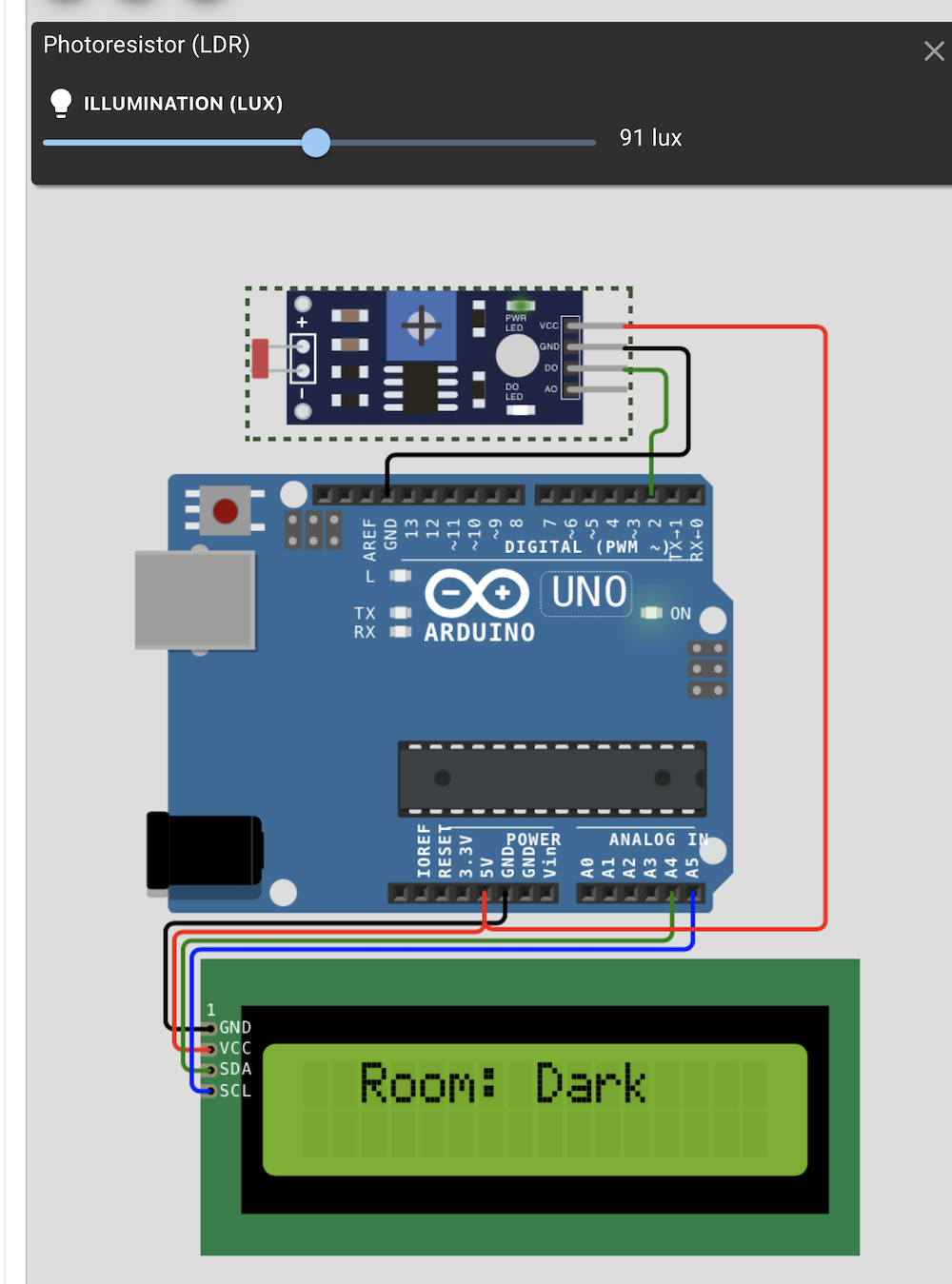

I found a basic circuit on Wokwi. Moving the slider changes the reading on the sensor from binary high to low.
If this model will work with the attachInterrupt() call, I can simulate shutter opening and closing by moving the slider and play with the code.
The model as it is uses "digitalread()" so I need to see if it works with attachinterrupt().

A photoresistor doesn't sound very appropriate in a shutter tester circuit. LDR's have response times of several (up to dozens) milliseconds.

Yeah, it will. If it's a sensible approach, and how to make it fail-safe, is another matter. See my earlier comments in the thread on debouncing. How often will that pin change interrupt fire as the light level changes? Be sure to handle the possibility that it bounces a couple of times in the process.

Hi, it was a follow on from IC, not sure what he was trying to achieve with a light sensor circuit to simulate a shutter?
This is the simulation I came up with. On Wokwi, it only allows simulation of a single attachinterrupt( ) at input #2; input #3 does not work.
So it is only able to simulate the single sensor component, though the entire code for both sensors is in the model.
Nothing really to change with the core code for focal plane shutters but I made the simulation so I could try adding some extra features specific to the cameras I repair. For example closing curtain bounce detection, calibration, leaf shutter mode, external controls, etc.

Really not sure what this is trying to do? There is no slider input to the Arduino, so I'm guessing the slider controls some light dimmer app & the arduinio is measuring light intensity?
It would be better to use the dedicated light level sensor which directly outputs in lux.

Should work in principle. Will the ~10kHz sampling rate of a typical Nano be sufficient? Keeping into account you also need to process the output. Although you could dump a lot of stuff into a buffer and work on it later.
It's part of the Wokwi simulation kit; in this setup an LDR is connected to the Arduino and in the simulation you can set the amount of light the sensor sees to verify the code does what you want. Like I said, it's quite nice how far they've already gotten with this, but this is an application where I don't think the simulation is quite going to cut it.
It is running your program.
Yes. A simulated light shining on the sensor.
That is the one in the model. It has analog and binary output pins. The trimmer on the little board sets the on/off switching point.
