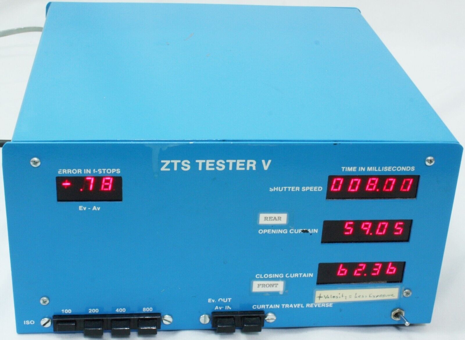

But I made it with a removable sensor like on the commercial machines and I regret doing so a bit. Thing is that the commercial ones used in repair shops have a light that is collimated. This makes the readings much more precise.
Inexpensive laser used in these projects makes collimated light as good or better than the older commercial testing units. As long as the sensor is interpreting the on/off correctly, a laser/Arduino shutter tester can be better than the commercial units in my opinion.
I bid up to $600 for this ZTS tester on e-bay a few months ago; now I'm glad I did not get it. For $600 I can make a very very nice one myself.

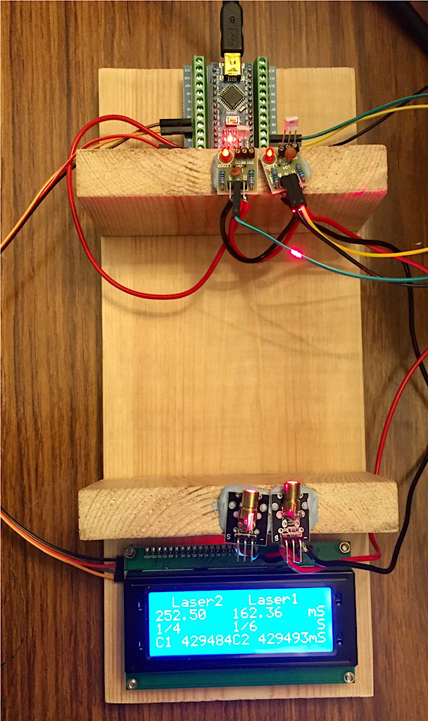

It lives…
...but I think I need to invest in a hot glue gun to stick the lasers and receivers onto the stand as my bright idea of using blu-tack isn't working as my connecting wires are quite stiff and this causes the lasers and receivers to slowly move out of alignment. Some thinner hookup wire would have been better than the thicker wire that I had lying around.
I would be tempted to cut-out two slots in the wood to set the boards in the channels.
As for the lasers, I'd use the mounting holes in the boards and put tiny screws in there..

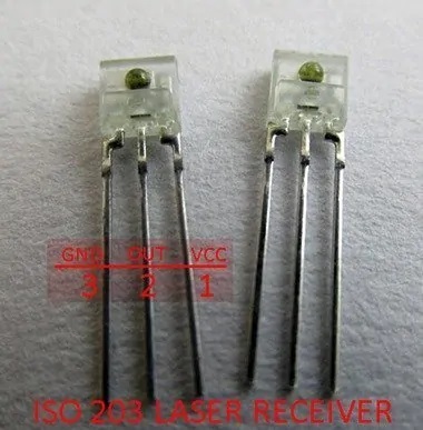

A word of warning to anyone trying this, if you detect a burning smell after wiring it up and powering on, you may have inserted the 3 legs of the laser receiver in the wrong way around :-(
It's also called "that magical blue smoke" 🤣
Yes, having waited a couple of weeks for the parts to arrive, it was also a multi-expletive moment. At least I assume that was the cause of the burning smell. I had certainly put the receiver legs in the wrong way round, and the program doesn't print anything other than "ready" on the com output, so I'm guessing it's not getting the interrupts from the receivers (even now that I've turned them around the right way).
It lives…
Yay, gives me a bit of a buzz to see my design has been built by somebody :surprised:)
A hot glue gun is a great tool, handy for jobs around the house. Aldi/Lidl often have a pack of glue sticks in their Thursday middle isle.
There is another almost identical tester and the builder drilled holes in the wooden upright to put the laser tx in, rather than gluing to the top. Some boards have the laser attached just by its wires, others have the brass body also solderd to the board. Mine was loose, so got the hot-glue treatment :surprised:)
Oh no :surprised:( sorry to hear that.
The little bubble on the front of the rx sensor has to point towards the header pins on the board.
Really sorry, yes, you would have murdered your photo-transistors.
If you touch the centre wire of the rx (which goes to Arduino pin 2) to the ground connection, this should trigger the Arduino.
The little dome lens on the photo-transistor must face forward towards the header pins.
This is the way they go in, legs numbered here are the same as in the picture above with the photo-transistor in the board.

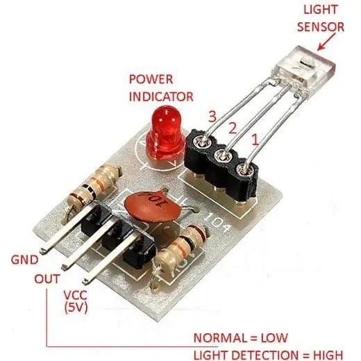

FYI on the sensor modules.
Seems the manufacturer updated the sensor parts from SIC553-04 to PIC0103SL and PIC0903SL so the sensor one buys may have OPPOSITE light response than the original Niglyn is presenting. On another forum they compared the datasheets, and, other than the reverse response, the other parameters are the same.
I actually found this out myself because the sensors in the virtual model I built was modeled from the older sensor and the response was opposite, so I had to tweak the original code.

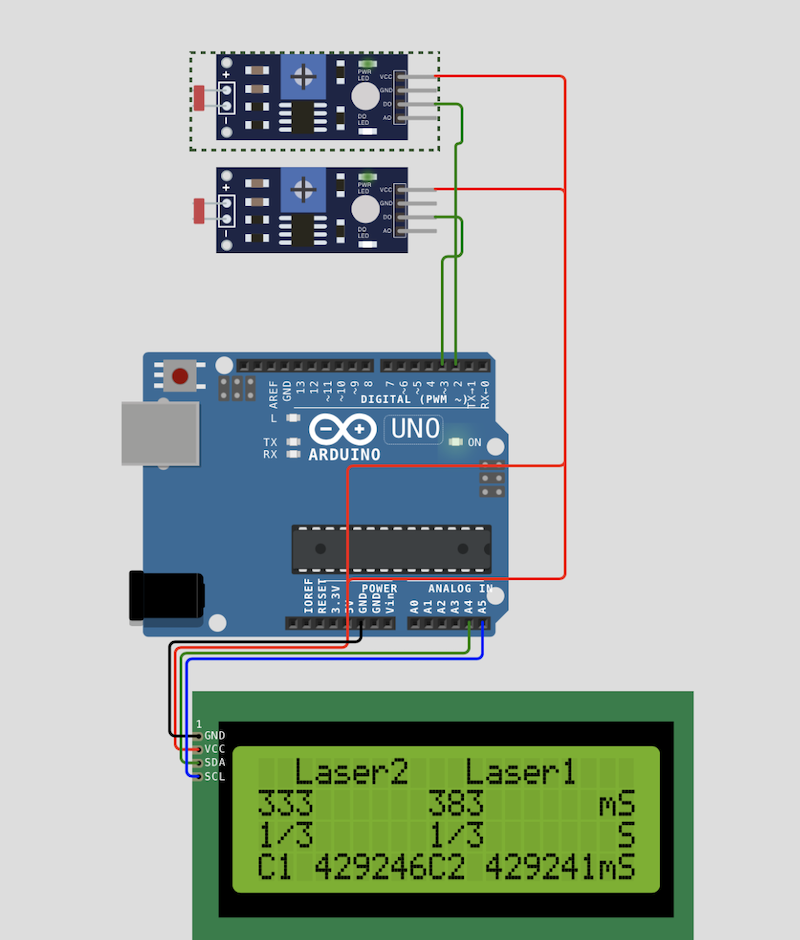

I noticed on my virtual model the C1 and C2 results are huge numbers; 6 digits. I did not mention it because Niglyn never indicated the code would work on a virtual model. However, I see Flighter's model above has the same output. Is that correct?

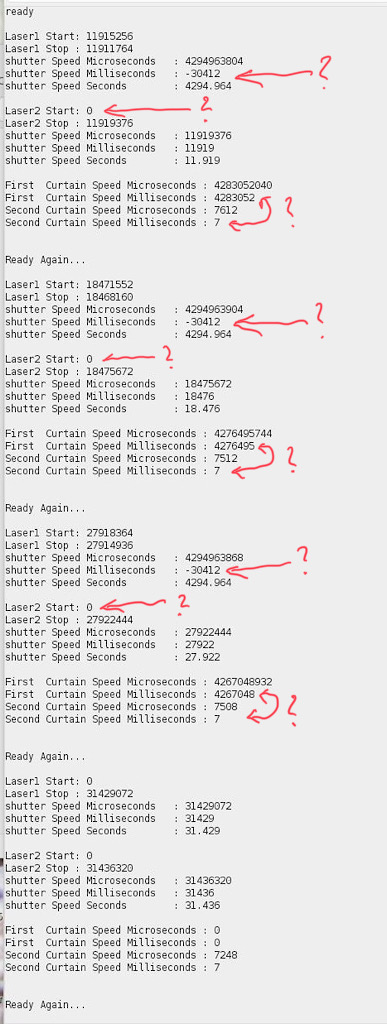

I don't think so, I've been getting results that I don't really understand but haven't had time to investigate, camera was an OM1 set at 1/500 second.
The following screenshot was taken of the serial monitor window in the Arduino IDE [Tools > Serial Monitor].
This is what the great interweb says. However, I cannot find a retail outlet to purchase them. I can get normal photo-transistors & photo-diodes, but would then have to add the trickery that is already included in these little wonders.
After fiddling with the virtual model, I believe the results Flighter are seeing in the travel time are related to the sensors being reversed #1 for #2.
This could be due to how Flighter has the camera oriented in the device. Try flipping the camera around.
I was able to duplicate Flighter's display by reversing them.
My impression is either will work fine as long as the HIGH/LOW state of each device is respected. I'm pretty sure Wokwi model simulates the old version as LIGHT = LOW state, and your software works correct with the new commonly available devices which I believe is LIGHT = HIGH state.
I haven’t had time to study the code in detail yet, but given that kind of output I’m wondering if there is a timer overflow issue? I’ll dig into it tomorrow if no-one else gets there first.
