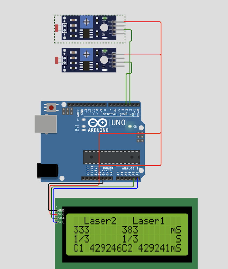

Latest wiring diagram below. Can you spot the changes?
Only change is the addition of two push button switches to pins D11 & D12.
These buttons are optional. One resets the average count to zero.
The other is for future ideas, possibly to toggle the LCD to show current or average readings.
In lieu of a push-button, you can just use a jumper wire between D11 or D12 and 0V, just be careful not to touch it to anything else!
