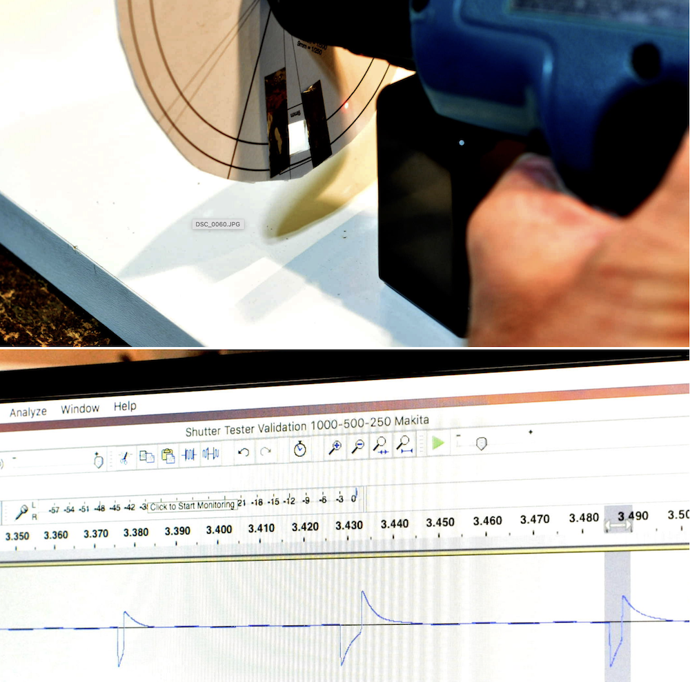

Nope, but the piccy looks like they using Audacity to measure a pulse length. Nice hack if they do not have access to an oscilloscope.

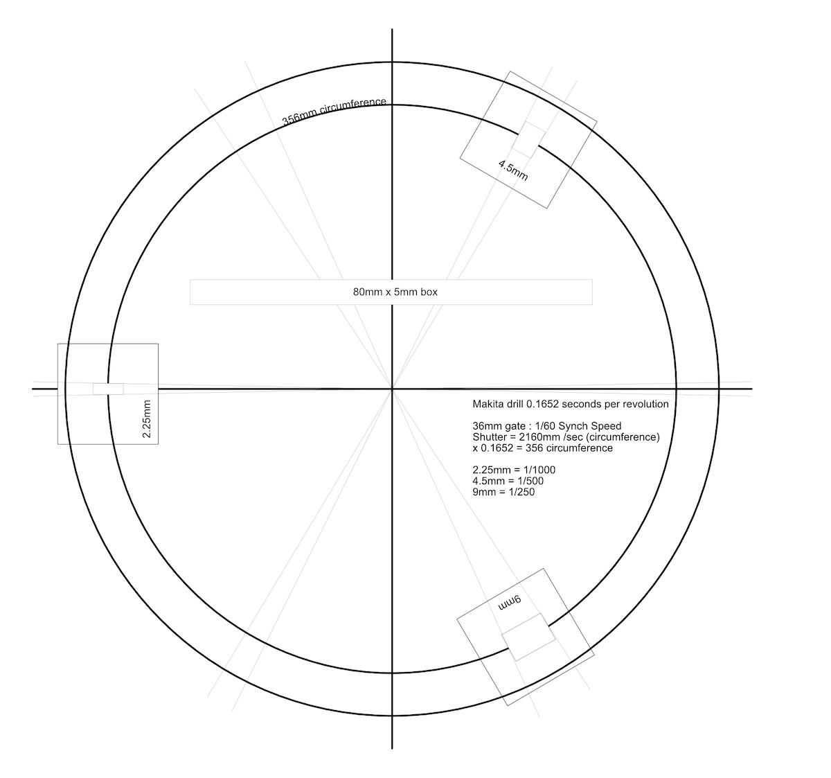

It is from a thread I had posted on calibrating my existing Audacity based shutter tester. My interest in Arduino is so I don't have to boot up my workbench computer and attach the A/D converter every time I want to test a camera.

With a disc, how do you know the sensor is triggering on a circumference of 200mm, not 201mm or 199mm?
I doubt that the rotation speed of a drill is calibrated or that it's rotational velocity is constant.
Good question. You know that the closer to the center the angular velocity is less, so, for the same shutter time, the gate has to be narrower. Likewise, the angular velocity farther out is greater, so for the same shutter time the gate needs to be larger.
This is accounted for by the shape of the openings. See how they are not rectangles but trapezoid openings. When laying the thin, slide masking tape on the edges of the openings, the tape is aligned with the spokes radiating from the center.
The same principle applies to rotating shutters in movie cameras. The opening is trapezoid and the entire frame gets even exposure.
I have many electric motors, but by good fortune the Makita drill had a speed that allowed the disk to be not too big or not too small to travel at the same velocity as a camera's curtains.
Also, as you get into the finer points of the math, my wheel actually gives speeds of 1/120, 1/240, 1/480 and 1/960 based on the progression of halving the 36mm shutter opening with each increasing speed.
The 'ticks' on an oscilloscope (Audacity screen) from the openings were measured over ten revolutions during the calibration process to get the exact speed (which btw was identical to the speed I measured before constructing the wheel as I did not run the drill at all between measuring its initial speed and sizing the wheel in software and printing it). The speed was very constant over the measuring period of ten revolutions with the interval between the 'ticks' being essentially constant. The battery would not drain in that short period, ten revolutions in 1.652 seconds ; there was no battery drain in 1.6 seconds.
The ten second measuring period gave ten samples of each of the shutter speeds to average, but they were essentially all the same +/- 1 or 2/4410.
When I tested my tester against my electronically timed Canon T70, the results were spot on, so that is close enough for me.
That is good news!! Using Audacity, the photodiode turns ON instantly and stays on until no more light hits it. Thus the errors from the sensor size. Perhaps the sensors in the Arduino world register ON after 1/2 of the sensor is exposed and register OFF when the other 1/2 is exposed, effectively making it like a point sensing source.

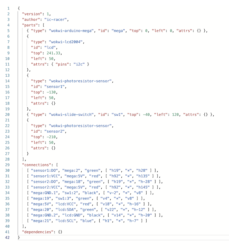

The Wokwi site is pretty amazing, I was able to build a complete version of the device with virtual components that actually runs Niglyn's code. I got both sensors to work on the simulation.
The file to create the model is attached below, it is a screen shot, so you'd have to type it in as a ".json" file to make the model.
I think there is a way to share a public link to the actual working virtual model running the code... stay tuned.

Here is a public link to Niglyn's sketch running on a virtual Arduino UNO. The sketch is modified somewhat to run under the simulation, so anything odd in the behavior is due to the simulation, not Niglyn's code.
I've saved it and I'll have to compare them when I have a bit of time.
