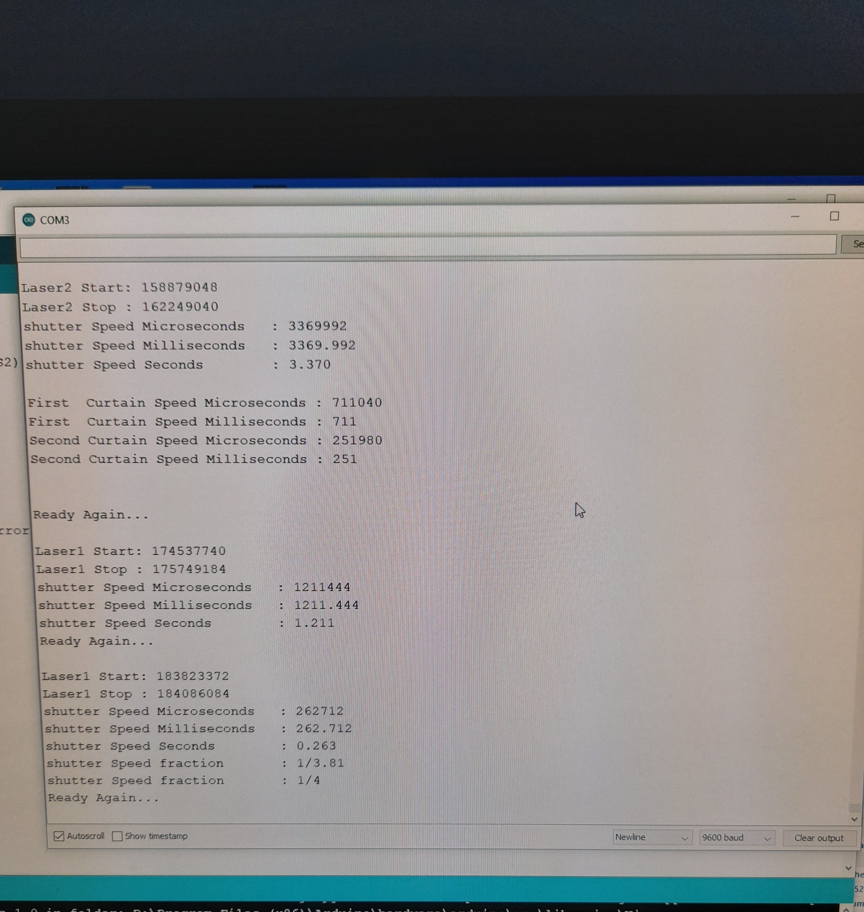

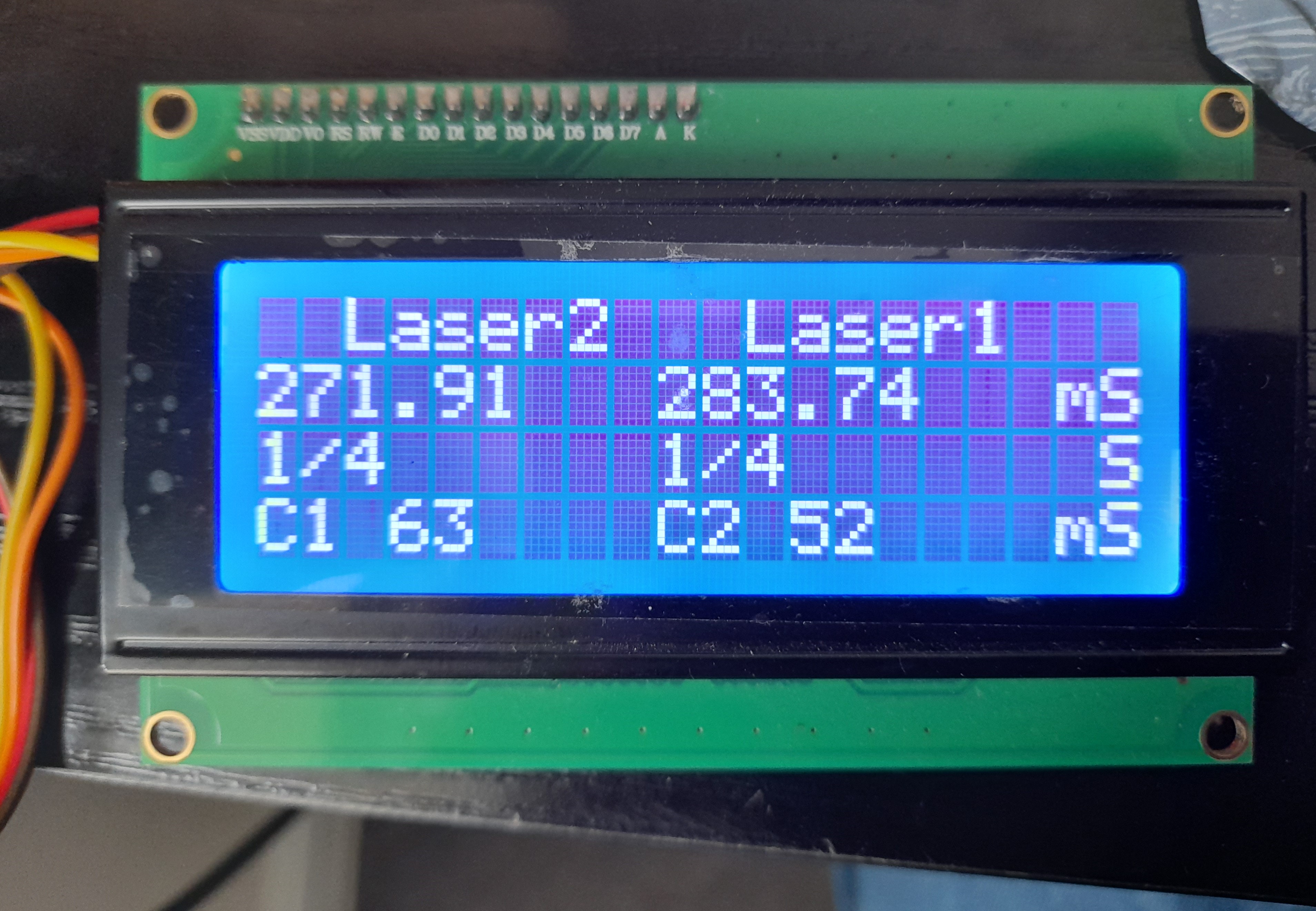

Hi Guys,
Sorry for the poor quality photos, I'm working with very little IT.
A couple of photos showing what you can expect to see on the computer screen & the LCD.
The LCD is optional, you can save money by just having the output displayed on the computer screen.

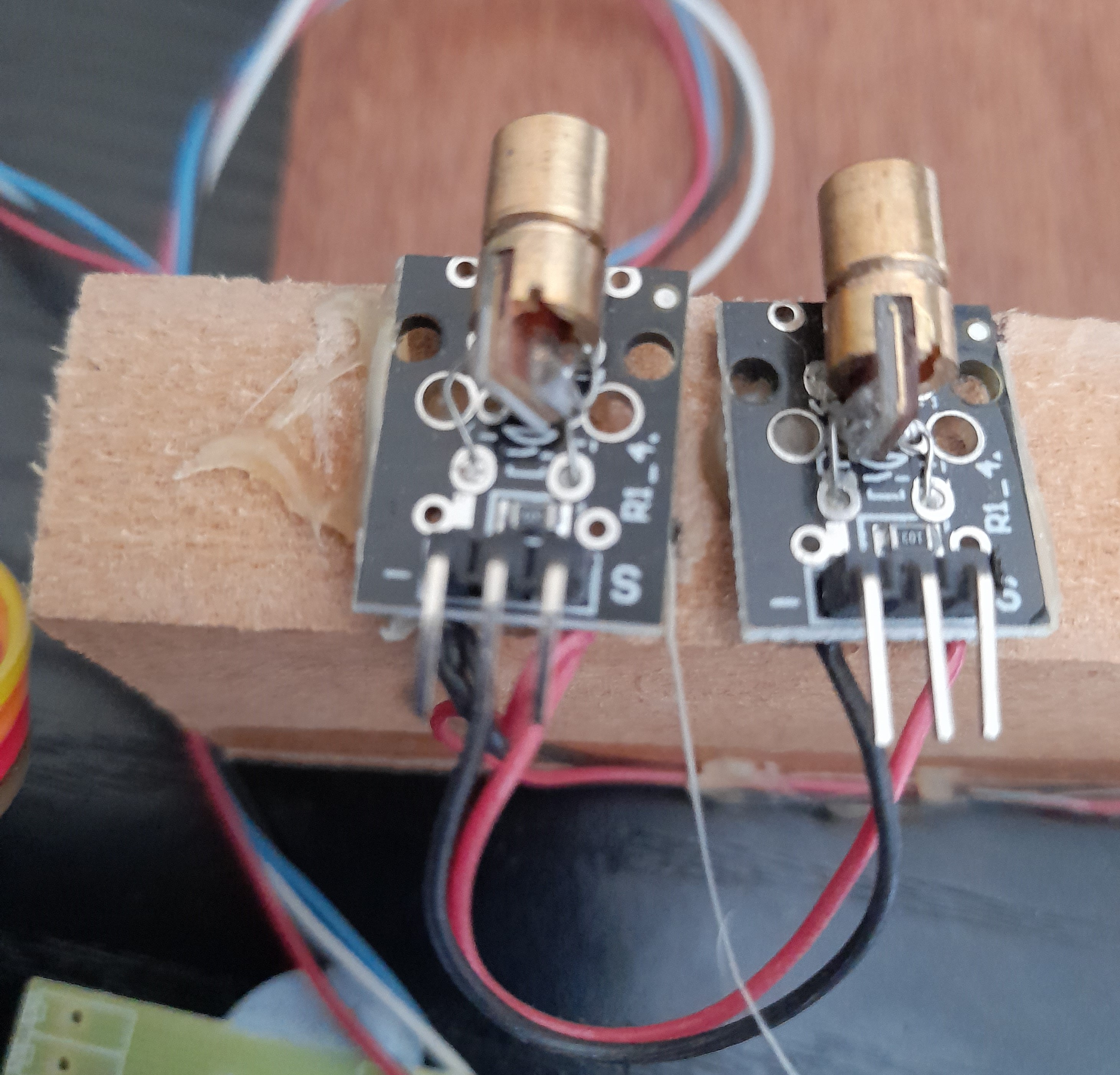

Hi Guys,
A photo of the Arduino Nano connected to the LCD. Will show you where the wires go.
A piccy of the two lasers. You can see I have soldered directly to them, rather than using Dupont wires. Red is +5V and black 0V
The sensors have three wires, again red is +5v and black 0V. Each has an additional wire, white going to the middle pin of one sensor, blue to the other. These are the trigger wires, going to pins 2 & 3 on the Arduino.

Hi,
I space the sensors 20mm apart. They are mounted at a height that a 35mm camera can be held horizontally or vertically between them (I use a spacer under the camera when mounting horizontal). You could mount the rx into a plastic project box and drill small holes for the rx to see through and then place this on the back of the camera. This is the way professional units work. They then only have one diffused light source, rather than mine having two lasers.
You could make a wooden holder similar to mine, but make it much higher and lay it on it's side. the camera could then sit flat on the workbench, with the tester to the side of it.
You do not want to space the sensors right at the edge of the frame. Everything in life take a bit of time to get going, so the shutter curtain may not be quite up to speed at the start. Service manuals often specify a curtain travel speed and also how far apart the measurements should be taken. Canon T70 for examples specifies 20mm.
The reason for soldering the wires, it was easier for me to do it that way and there are less wires to run back to the Arduino. Using Dupont wires maybe much easier for those less familiar with electronics.
