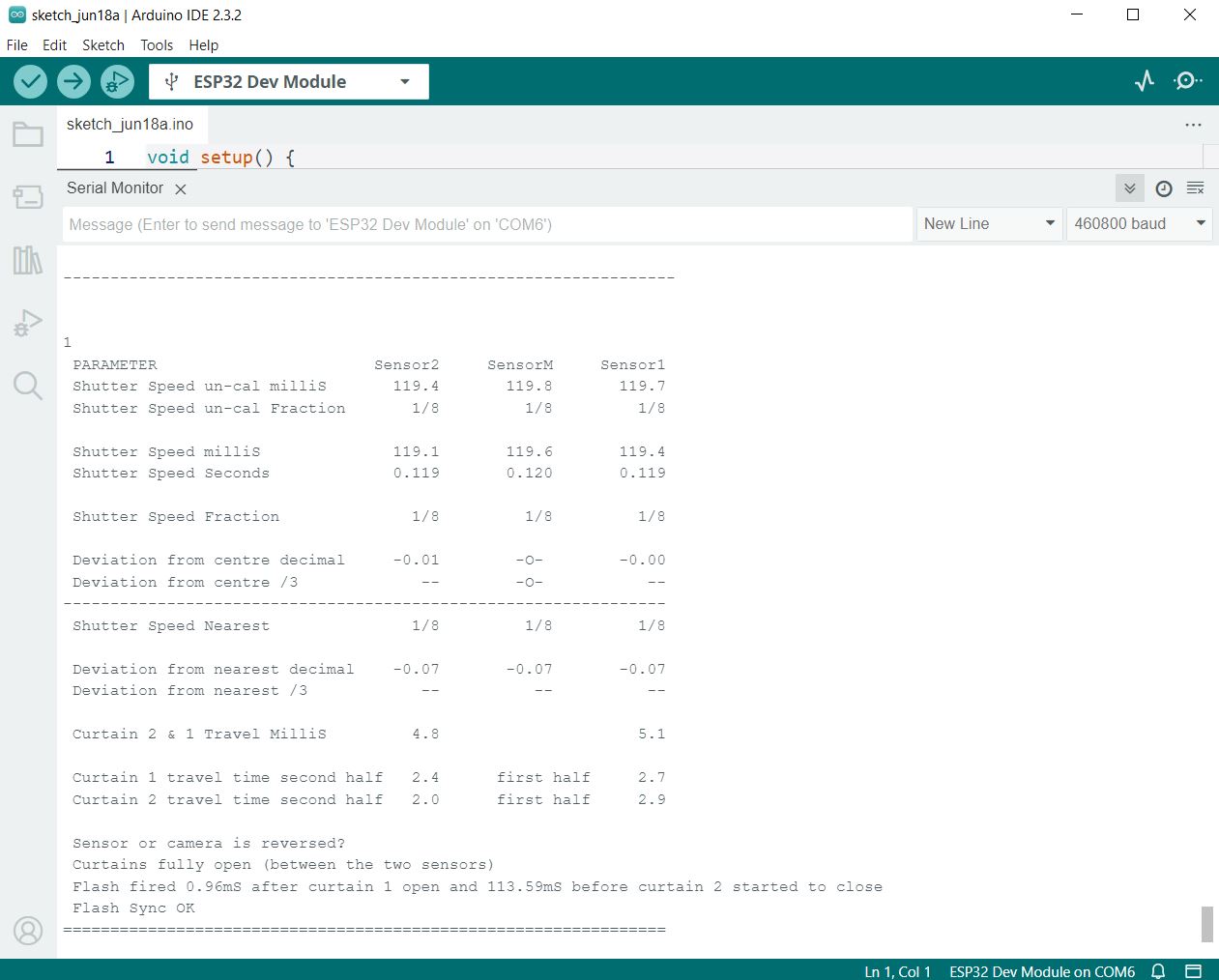

Hi, you need to select ESP32 Dev Module.
Your screenshot is showing it is not recognising the board. The latest update to Arduino IDE seems to have caused the issue.
I have changed "NodeMCU-32S" to "ESP32 Dev Module" and now everything works fine ! Thank you very much !
In the PDF file "5_ESP32 Arduino IDE software load", page 3, it is recommanded to select "NodeMCU-32S". That's why I was wrong. I don't understand...

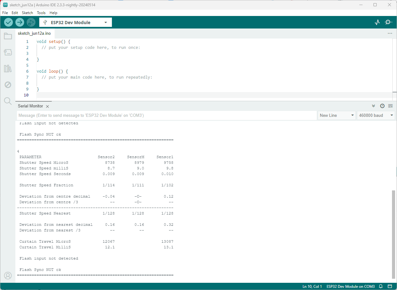

Hi, the first part of the document says to use Nano and baud rate 460800. Which works fine.
It is only for advanced users wishing to progress to programming their own boards that loading of the ESP32 definitions are required.
This worked fine until this week when the latest Arduino IDE build broke the use of NodeMcu-32s.
Sorry for the problems you encountered. Github and Instructables have been updated.

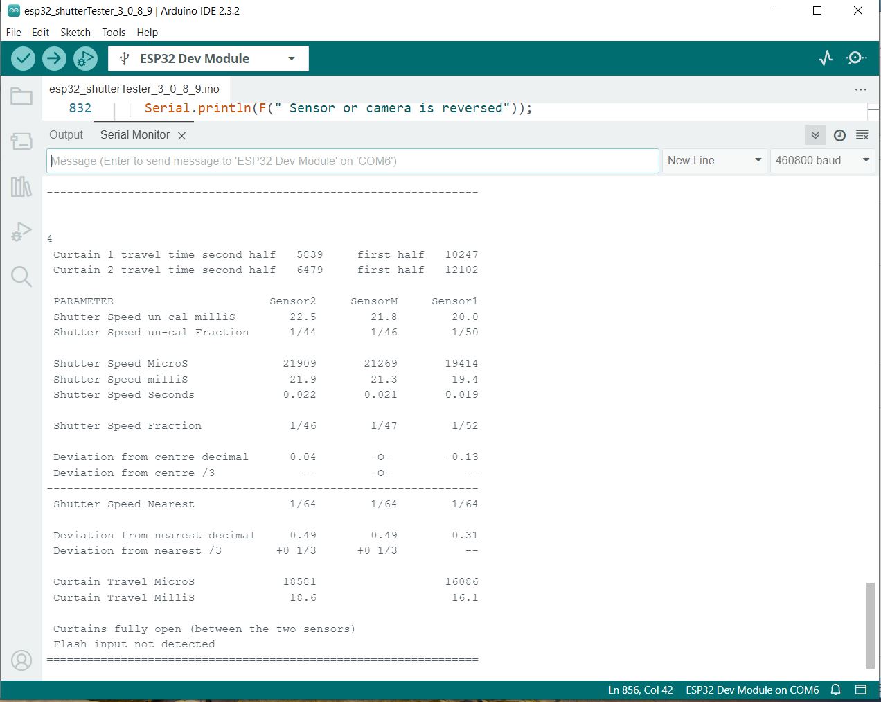

TFT and PC screen now also show raw (uncalibrated) values from the sensors, This can help if you have a really worn and sticky/juddery shutter mech. Also demonstrates the issue of sensor width & how cheap (hell this is free!) or single sensor testers will cause huge measurement errors.
TFT & PC screen now show curtain travel speeds for full and half travel. This highlights slow to get started curtains or if the springs are running out of puff towards the end of travel.

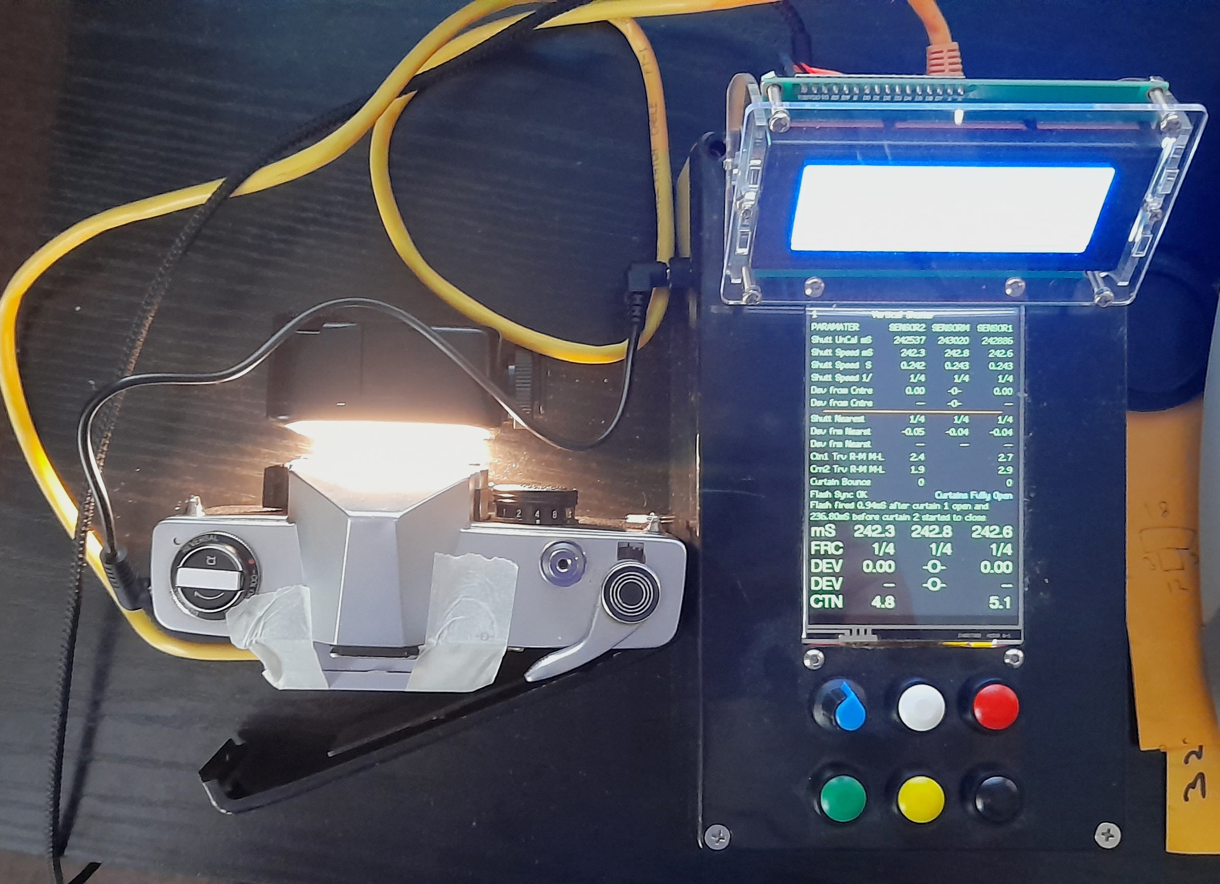

Three photos below.
First shows camera under test, using rear-mounted sensors (masking tape holding it in position :surprised:) and a cheap Aliexpress LED light source.
Note LED light must be on full. If dimmed, it uses PWM which pulses the LEDs on & off thousands of times a second, which will give LED flicker warning on tester.
Note flash sync cable connected to side of the camera.
Next picture is of the TFT screen showing changes, removal of uS values to make space for uncalibrated senor reading (first reading on the screen)
and
curtain travel speed from right to middle then middle to Left (L-M M-R) for each curtain.
I hope that makes sense?
Third photo is a screen grab, showing output on the PC screen.

Next, find an adjustable light source. A table lamp with a dimmer, for example. Adjust it so the light-meter shows the Lux equivalent of EV14. Set the camera as per a) and see what the shutter speed is.
Adjust the lamp to give a light output of 4EV and repeat the process for the b) settings.
Three photos below.
and
