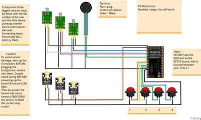

I feel dumb writing all of this, but people should laugh at my stupidity. Finally got where I was supposed to be a week ago. The problem is, I was thinking that if the circuit worked with only one sensor, it should work with two connected, i.e. without the middle one. Right? Wrong.
Turns out, the code is smarter than I, and observed that the curtain can't possibly operate correctly if it opens, then midway closes, and then opens again, hence the "Error" on the LCD.
Back to square one, connected all three lasers and sensors and hey presto, it works as intended. I had one of those 3am revelations and got to work today.
There are two morales to this story, never start working on a project after a double shift, and always follow instructions written by more knowledgeable.
All in all, I'd like to thank everyone for their help and patience!

Hi alinCiortea,
That tft display will not work. It has the wrong driver chip. It must be the exact one specified on the parts list with the ILI9488 driver.
Click on the third product picture. This shows the orange coloured board & component U1 is not populated (the 5 to 3.3v regulator)
Using just one sensor, you will only get raw data from the tester, which is affected by sensor width. The higher the shutter speed, the higher the error will be. As you have found, a very narrow beam width is required for better accuracy.
Using two or now with increased accuracy, the esp32 three laser version, the code automatically calibrates for sensor width. So a mask of 1, 2mm or no mask should function perfectly.

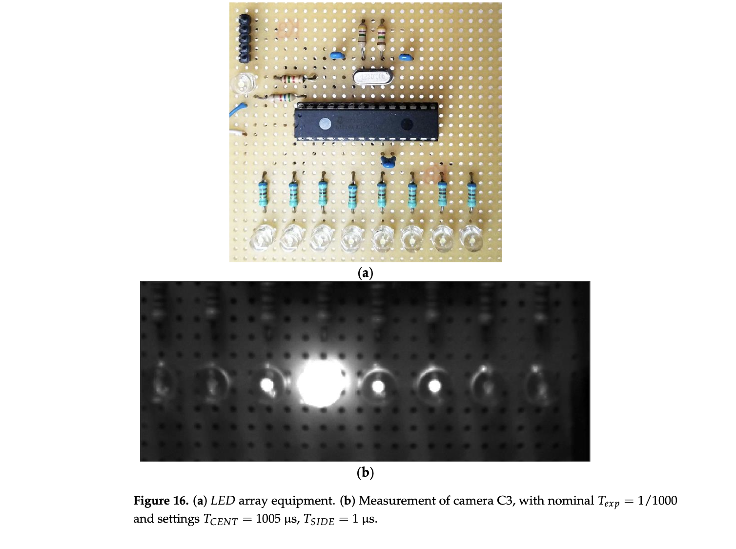

Before I had a FP shutter tester a cheap-and-dirty method to see the curtain gap would be to perfectly set the flash synch to just when the first curtain reaches the frame edge (possible on my Rolleis but may not be possible on all cameras) then you can see (via the flash) where the second curtain is for each of the faster speeds. Second curtain should cover 1/2 the frame at 1/60; 3/4 the frame at 1/125, etc.
Also, have you seen this? It is available on the internet. Maybe that is where you got your idea.
The Way to Modern Shutter Speed Measurement Methods: A Historical Overview
Gyula Simon 1,*, Gergely Vakulya 1 and Márk Rátosi 2
Interesting study, but (for academical purposes) way too complicated.

I have build a little strobing array of LEDs which when photographed (by a digital camera) or looked at though the film gate of a film camera, will show a number of LED rows.
The strobe speed can be set to standard camera shutter speeds, so when viewed, two rows of LEDs should be seen.
If three or more rows are seen, then the shutter is slow.
It is an updated version of what is seen on post 429.
Only uses a few cheap parts & is easy to build. I have started a new thread for this.
您好,我参考了您最新版本的ESP32固件。该图像表明传感器正在向引脚 34、39 和 36 应用高/低电平。但是,经过我的测试,我向引脚 25、33 和 32 应用高/低电平,并且 LCD 仅显示遮挡/可见性。设置好后,松开相机快门会显示“错误”。能帮我分析一下原因吗
I would like to add that one of the sensors was burnt out during the wiring process, and I did not connect the faulty sensor to the circuit. Will this cause LCD errors?
Oops.
If the sensor is shorting, then the tester will think it is being continuously triggered.
If the faulty sensor is removed, with a good sensor in position 1, then the tester should work ok in single senor mode.
好的谢谢。我刚看到最新的电路图,传感器的输出端接的是25、33、32,我以为是你的程序引脚写错了,哈哈
Oops, sorry. I moved the senor input pins on the latest version, to make the hardware compatible with the Developing timer.
I forgot to update the photos , to show the different wiring. I'm doing it now :surprised:)
