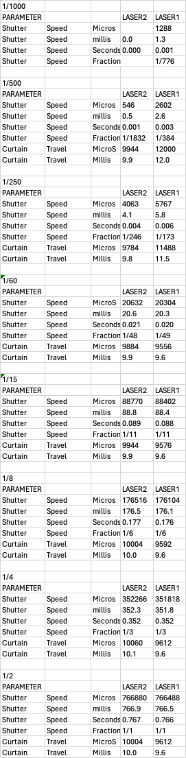

Just built the tester and I wanna say thank you for the detailed explanations.

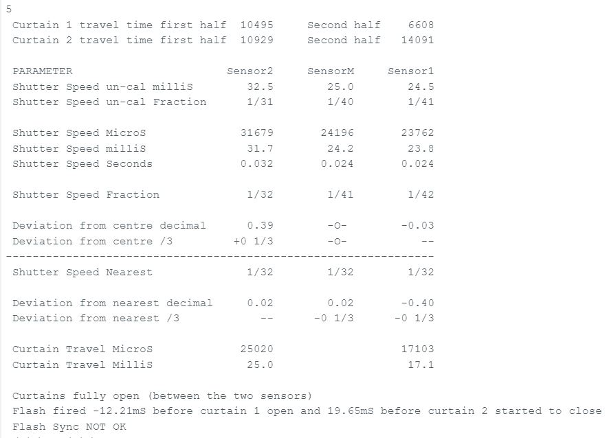

Here are my results for a Canon AV-1. As expected, there are a lot of inconsistencies at higher shutter speeds. Am I reading the results correctly by saying that the first curtain is slowing down/ second curtain is speeding up and thus resulting in laser 2 being wayyyy off and at maximum speeds, even closed at 1/1000. The AV-1 is aperture priority so I had to get these results by putting my phone flash in front of the camera and taking the picture at the shutter speed I wanted, which means the numbers are probably off since I couldn't set them.
This was my first attempt at assemblying it. Since then I've added a small wood panel with smaller holes so the laser size is smaller and added a base so everything stays aligned.
Hi,
Most interesting readings.
Curtain 2 remains a very consistent speed, but then looses it at 1/1000.
Curtain 1 seems ok until 1/250s when it starts to slow down. Bizzare why it only slows at higher speeds.
At 1/1000s I would guess first curtain is so slow that second curtain has caught up with it & is giving shutter blanking, hence no 1/1000s reading for laser 2.
Are you running the latest firmware version, 3_1_3 ?

Arduino with the 3_1_3 software. I probably have like 4-5 readings for each speed. They are all constant in how bizarre they are; I could never get a reading for laser 2 at 1/1000.

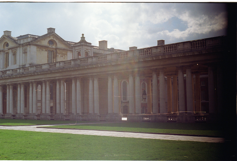

This is a photo which was probably taken at 1/500-1/1000. The dark side is on the right side of the film.

My understanding before was that the issue was happening at the beginning of the shutter opening sequence since the problem was on the right side of the film, but that seems to not align with the readings. Not sure if there is a problem with my set up or I'm misunderstanding the issues with my camera.
Right side of the film from in front, or behind the camera?
Can you post the strip of negatives (backlit) so we can see the film edge markings.
Also do you have a landscape photo showing the error?
The image is projected upside down and back to front onto a negative, so top is bottom, left is right.
Assuming you rotated the camera anti-clockwise when taking a portrait photo, then the blanking is at the bottom, so reversed, would be at the top, so indeed at the beginning of the exposure, not the end.
You could use the tester in single laser mode. Cover laser 2 sensor so it does not get triggered.
Align laser one at the left edge of the film gate and take a photo, see if you get an exposure reading.
Now align the laser with the right edge of the film gate & repeat. This will prove which side the shutter blanking is occurring.

Oh, I didn't realise the image is reversed both axis onto the film. That makes more sense now, the issue is on the right side of the imagine, so the left side of the film when shooting. Here's a landscape, from Greenwich as well.
Guess I need to find a way to CLA my camera. Thanks again for the detailed instructions, it was a lot of fun building and troubleshooting this build

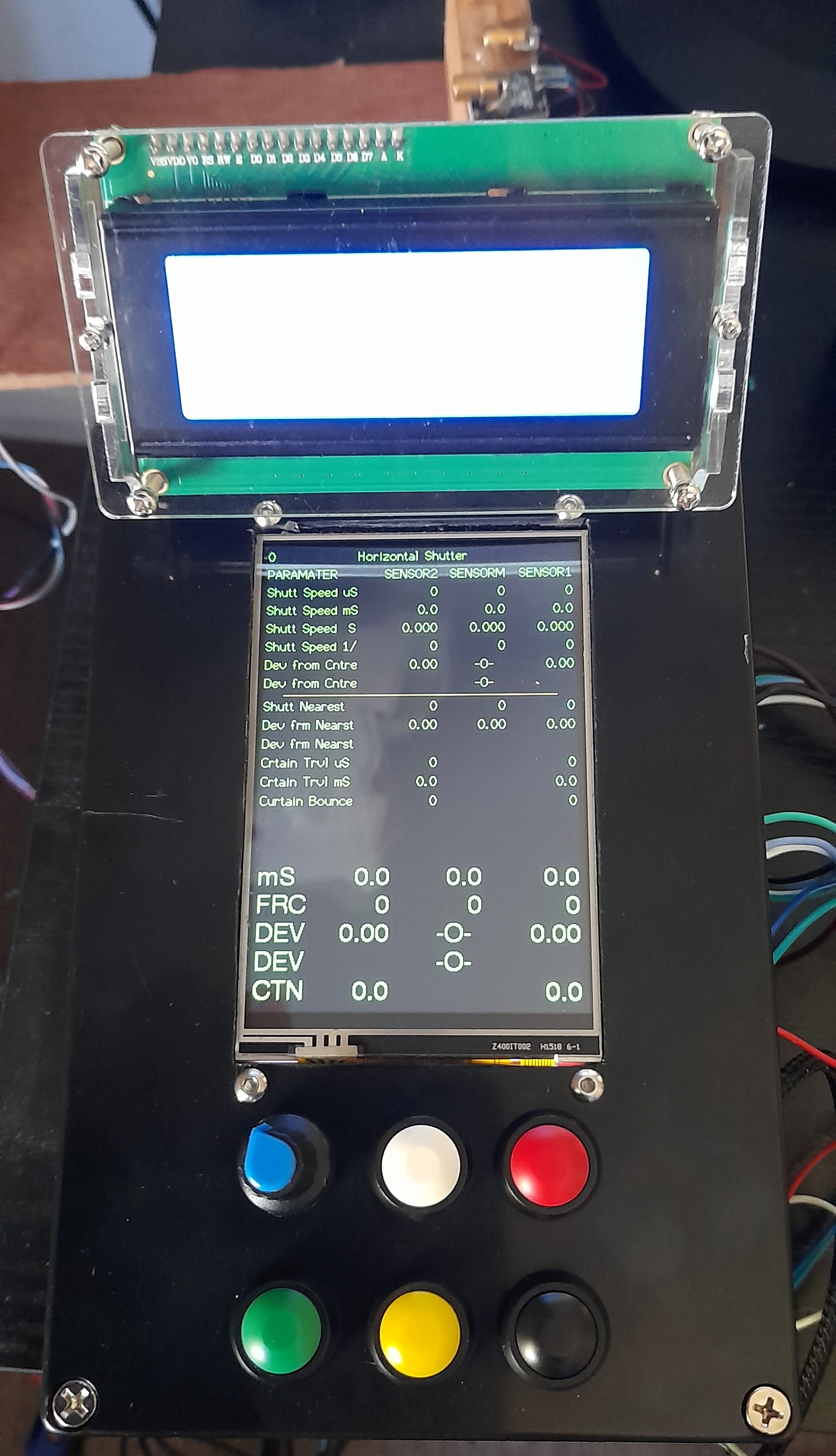

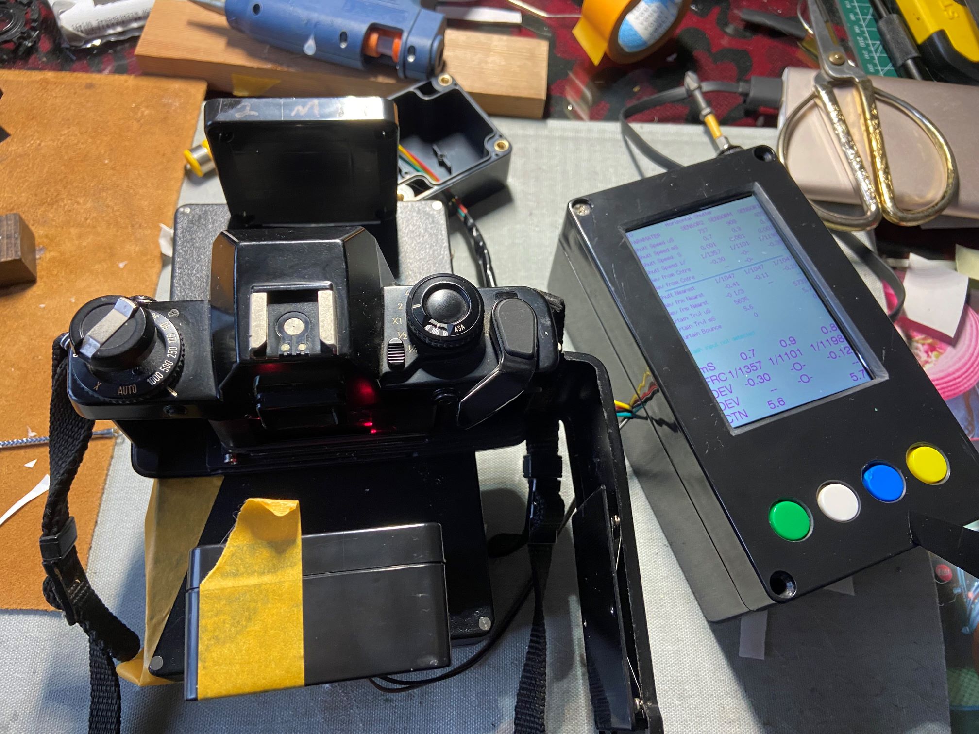

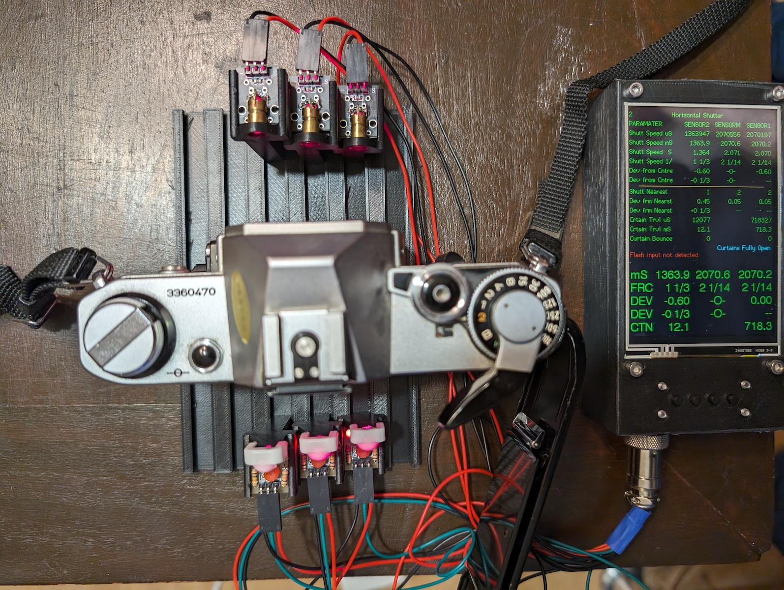

I have finally got round to putting my shutter tester in a box! Only took three years :surprised:)
I needed to use a bigger box to allow the LCD to also fit.
If using the TFT screen only, the smaller box (see my Developing Timer or Trigger / Splash Timer) would look better.
Included are extra buttons & an encoder knob. Not currently used, but I may add functionality for them later.
Second photo shows the new sensor head (below the camera & still covered in masking tape) which fits into the camera film gate and does away with the blocks of wood (or Lego) and the Lasers.
The Lasers work fine if the sensors/Lasers are aligned horizontally, but if using the diagonal pattern to use with both horizontal & vertical shutters, alignment becomes a pain.
It is simply the sensors (which need filing to remove part of housing), taken from the module and fitted into a little box. As there is no room for the module (which also contains a resister & capacitor) these have to be soldered directly to the legs of the sensor.
Light is provided from a cheap LED light box (shown below the sensor box). Due to it using PWM, it must be turned to full brightness, else the shutter Tester is so fast, it detects the PWM pulses.
The one issue I have found, is that the Shutter Tester now records one shutter bounce. I assume this is due to the PWM LEDs
Currently, the new sensor head is hard wired & all the wires for this & the light-meter can be seen spilling out from the box. I'm waiting on some connectors to arrive (and a smaller sensor box) then I will add a parts & build guide to Github.

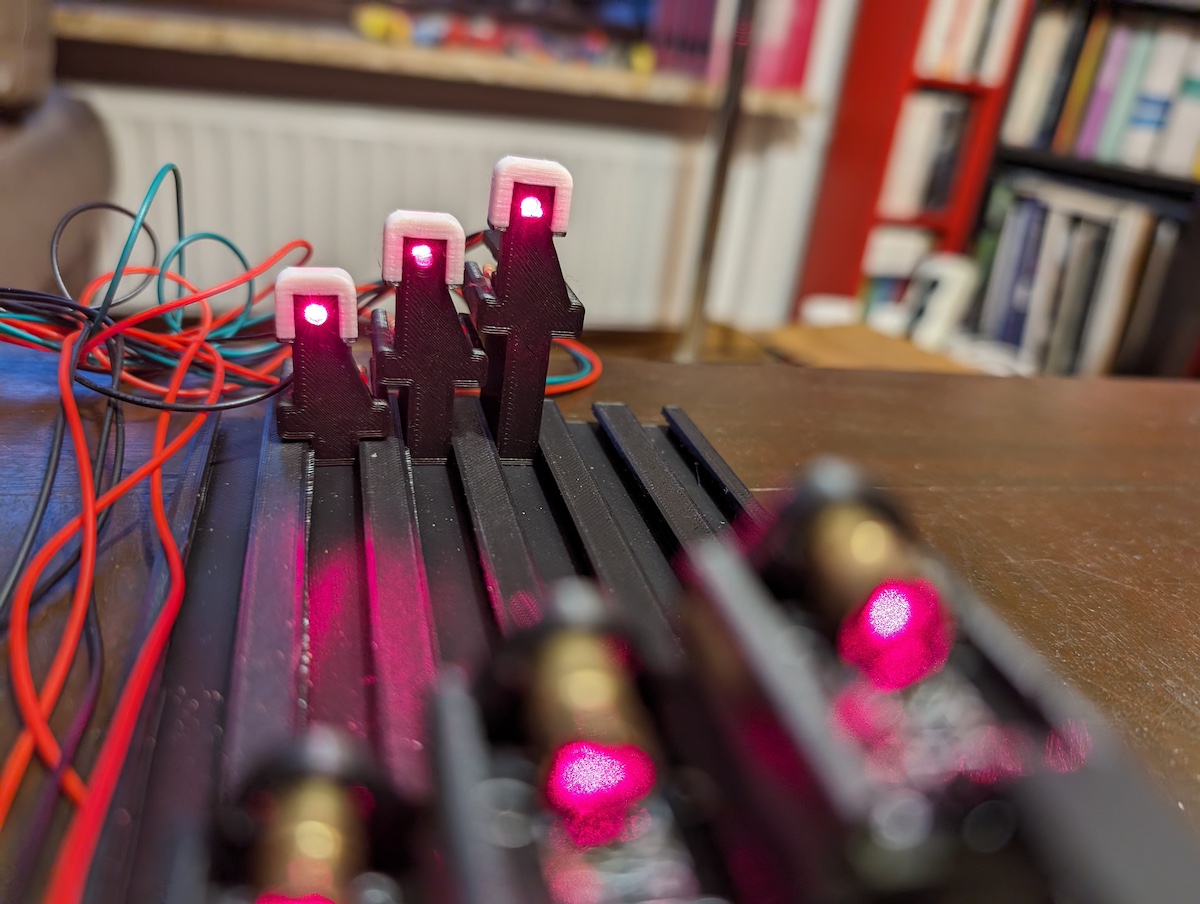

Also built my own shutter tester. Thank you for the software and the documentation @Niglyn!
I designed my own enclosure and also a mount system for the sensors and lasers which uses separate tracks so I can set them up for 35mm and 120 (6X7) cameras. If there is interest, I can upload the files to Printables.

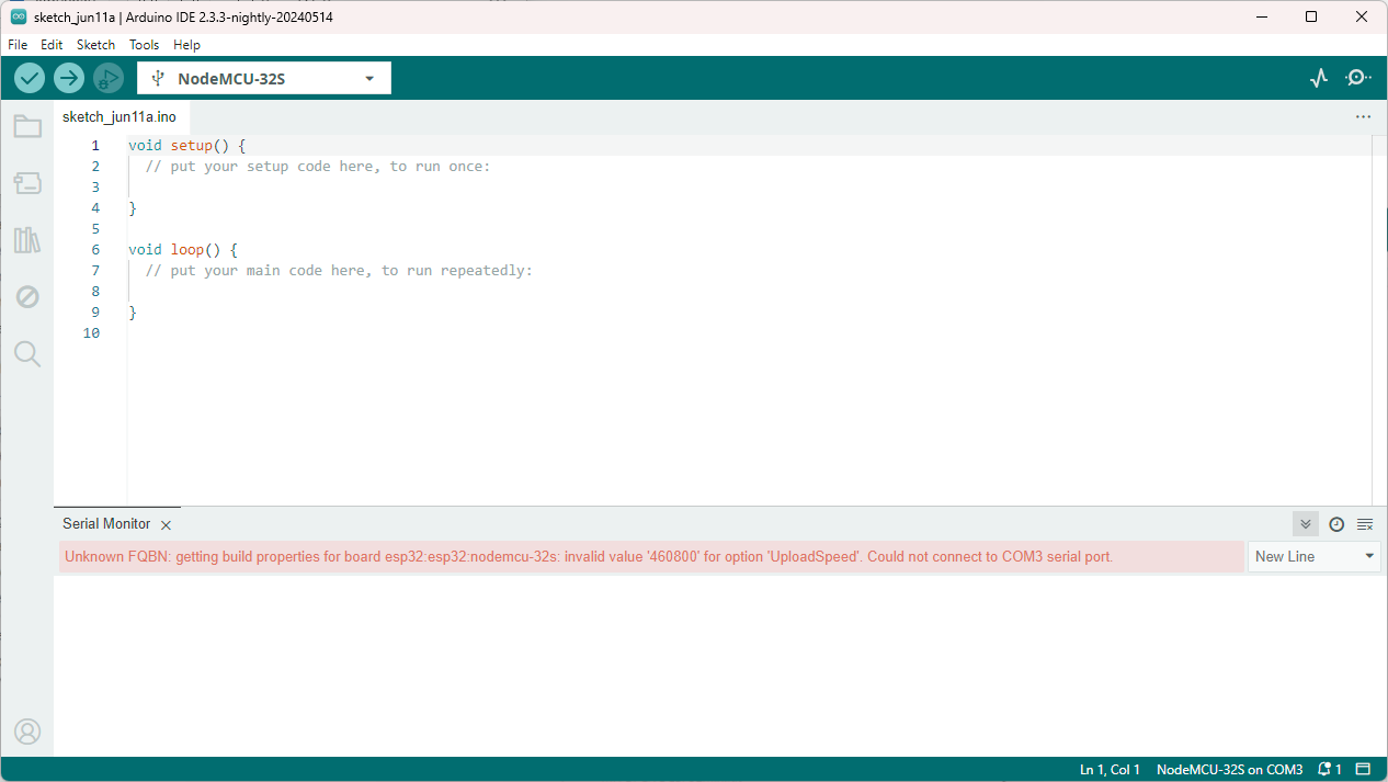

Note that in my case I had to select baud rate 460800 to use the serial console.
I noticed too late that in my design the sensors are facing the wrong way. But I liked that the cables faced outward, so I just printed a few white "caps" that reflect the light back to the sensor. Works a treat. On the side facing the camera, there is a 3 mm hole that the laser has to hit. I had to bend the laser modules a bit, but in the end it worked fine.

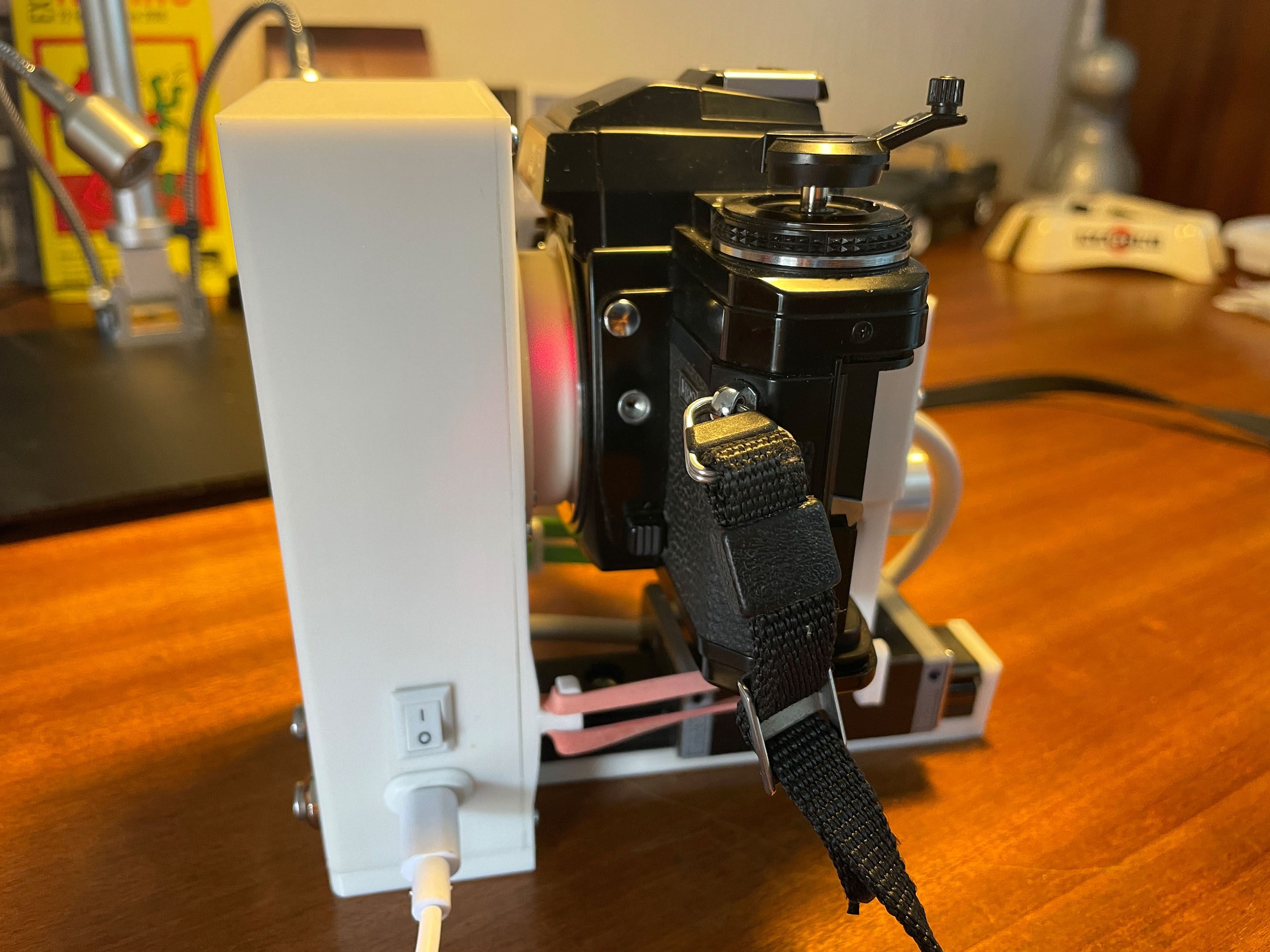

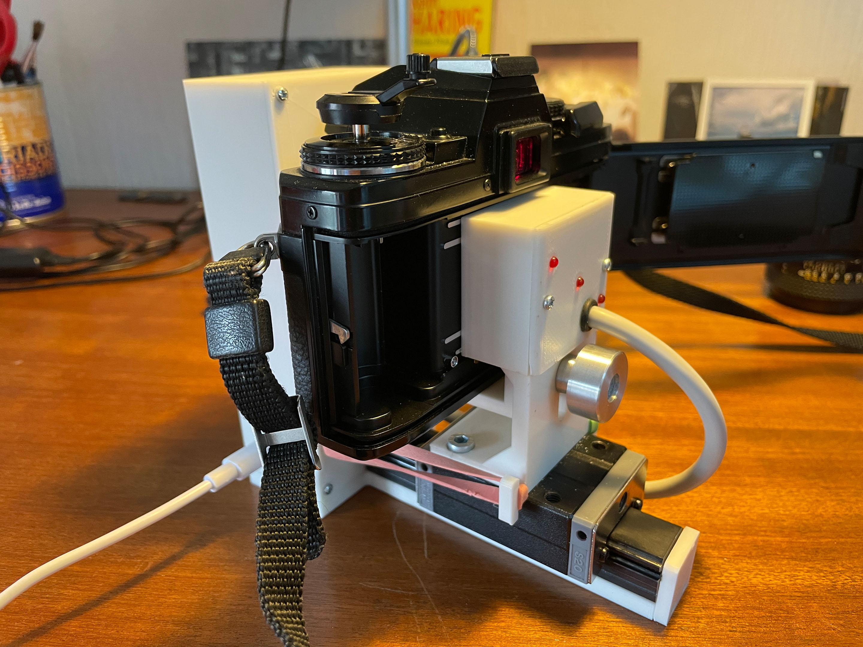

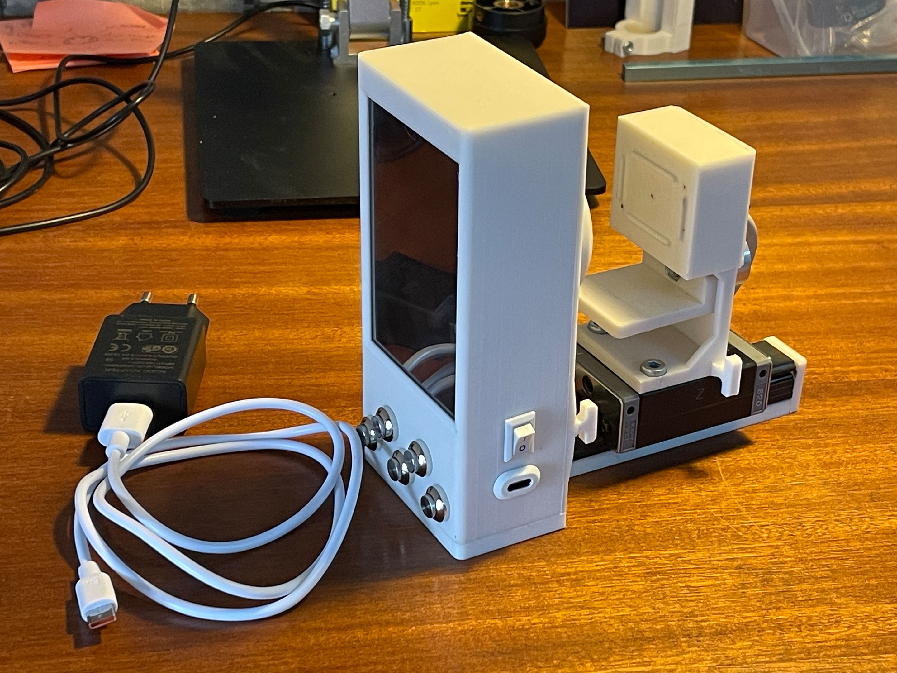

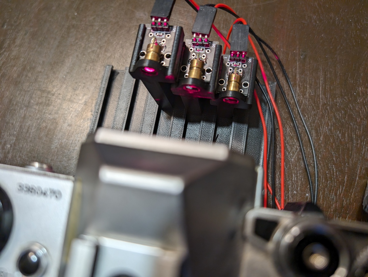

Hi all !
This is my first post in the forum.
It's my turn to present you my shutter tester.
First, thank you to Niglyn for the software and all the informations to built it.
I have tried to build it as small as possible. This have some advantages like the size but it also have some inconveniants. The wiring is very difficult.
The camera can be attached on the tester so you can do the tests really easily. I used a ball bearing linear guide (I had it in stock at work) so the lasers are constantly aligned with the sensors.
The lasers are located in the fixed part of the tester and the sensors in the mobile part.
The height of the part that support the camera can be adjusted.
I used a USB-C socket to power the tester and a switch to power it on.

The tester works fine. I have only one problem. The ESP32 can't communicate with Arduino IDE. All the drivers are up to date. I have made a research on the internet and it appear that sometimes there is a problem with Windows 11. I will keeping looking what's wrong.
Here is the project done with SolidWorks and some pictures of my build.

Hi Pierre69,
Thanks for posting your build. It is nice for me to know people are building my projects. It makes the time needed to publish them worthwhile.
Would be great if you were willing to share your 3d stl files, together with details of pla used & parts needed to 3d print & additional parts you used.
You could save some wiring by not using the laser circuit boards. They do nothing than hold the laser. You can also buy the laser units on their own, just with thin wires attached. These do seem to be alittle higher powered, so I added a resister just to lower the current a bit.
The serial monitor function in Arduino IDE should work fine with the ESP32, the IDE is just being used as a dumb terminal. Pressing the reset on the ESP32 board should output a lot of boot info to the screen. The default baud rate for this is 115200
Not sure why your computer cannot see the ESP32 board. To use the Arduino IDE with ESP32 for programming, you have to add the ESP32 boards in -
file - preferences - Additional board manager URLs
then add this line -
Then in Tools - boards select ESP32 Dev Module
But as said, this is not needed just to see the output from the Shutter Tester on the PC screen.
The Shutter tester runs at 460800.
Can you see the ESP32 in device manager when plugged in? If the driver for the USB chip on the ESP32board is not correct, device manager will show an error in the UISB tab.
Any serial (USB) terminal emulator should work. I use Arduino IDE for convenience.

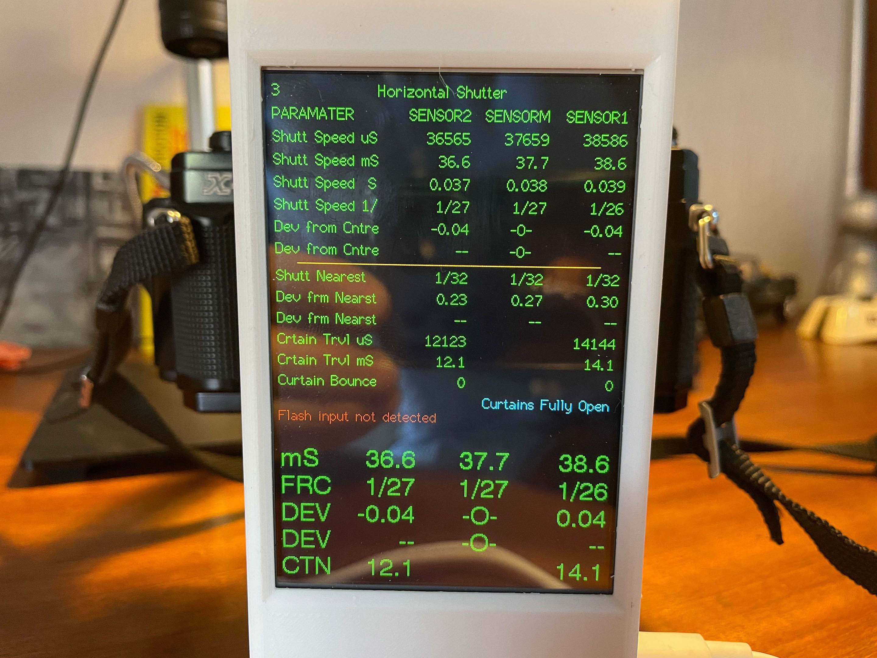

3.0.8.9 will be along soon. It adds additional camera diagnostics, some were already in the firmware as error checks, but now they print to the display.
These are things like slow or sticking curtains and shutter capping.
The flash diagnostics have also been upgraded to give better diagnostic output.
The PC screen now shows the raw sensor data, as well as the computed sensor data.
This shows & proves that errors occur when a) using a single sensor to measure shutter speed and without correction and
b) shutter testers will progressively under-read as shutter 'speed' increases - unless steps are taken to dynamically correct this error.
A constant cannot be used as slit width at a given shutter speed is not a constant. e,g a camera with flash sync speed of 1/30s will (should) have a slit width at 1/60s of 18mm. For a camera with flash sync speed of 1/60s the slit width at 125/s would be 18mm. Assuming horizontal shutter.
Shutter curtain travel speed is now also shown on the pc screen for both first half and second half of travel and overall travel speed.
This shows how much slower the curtain is over the first half, as it has to accelerate from 0.
I'm also thinking of adding the raw data and half-curtain time to the tft display. This however will mean some other data will need to be removed, to make space for it.

@Niglyn
I can share everything. All the files in every format. SolidWorks, STEP, IGES, STL. But before, I need to do some cleaning and organisation in the files because it has been design for myself. Were can I post them ?
Ok for the tip on the laser assembly !
I have understand the purpose of Arduino IDE. Just display the raw data.
My computer see the ESP32 Here is a screen shoot of the device manager. My compurter is in french.
I have add the URL for the ESP32 board in Arduino IDE. I can select the right board "NodeMCU-32S" and the right Port COM. There is not problem here.
I think that the problem is the speed. I haven't got the possibility to select 460800.
Here is a screen shot of the Arduino IDE with the error display in red in the Serial Monitor.
I have to use more my tester to make suggestions. I think that it is nearly perfect.
