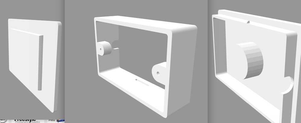

I may have got something wrong in my build, but the sensors in mine are on the distant side of their PCBs, which makes it difficult to get them close to the mask with its drilled holes. I suppose one could bend them in a loop around the end of the PCB so that they look the other way?
Hi,
I would bend the sensor legs backwards, so the sensor is now in line with the module, rather than sticking up at 90 degrees.
Add a bit of hot-glue to the legs where they plug into the module, to stop them coming out.
After attaching the wires to the module, the sensor can be hot-glued over the mask-hole and the module hot-glued to the mask, to stop it putting strain on the sensor.
There are many alternates. For example, solder a surface-mount 10k resister between Vcc and out on the sensor, and add a 0.1uf capacitor between Vcc & gnd legs. (or use a standard 1/4w resister).
This then makes a complete sensor module, but without the module. Or, use veroboard as I suggested earlier, which is also used as the mask.
These ideas do of course require a bit of electronic knowledge & soldering skills.
Using modules, especially if using five, will become a bit messy, however, the alternat is to go down the route of making bespoke pcb's which could become to difficult for many.

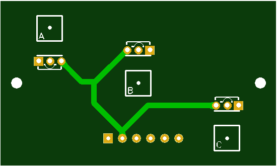

Just pointing out that a PCB with 3 sensors arranged for both vertical and horizontal from the "Film Camera Tester" project will work with this project too. The PC board comes drilled already with the holes spaced correctly as a drilling template for the front cover. The 3D printing files for its enclosure are also available:

Hi IC,
Yes, it will (with a slight mod to my code). I assume the Lasers are placed at 20mm vertical and 32mm horizontal?
It removes the need for the two additional lasers & simplifies wiring.

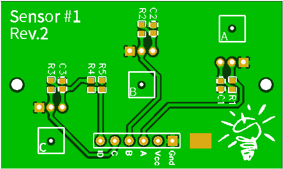

Thanks for posting the pcb details. I could not really start suggesting peeps take parts from other projects :surprised:)
'Genuine' sensors are available from Farnell, £1.24 each and a minimum order of £20. I still cannot find a source for the chinese knock-off ones, other than buying the whole sensor module.

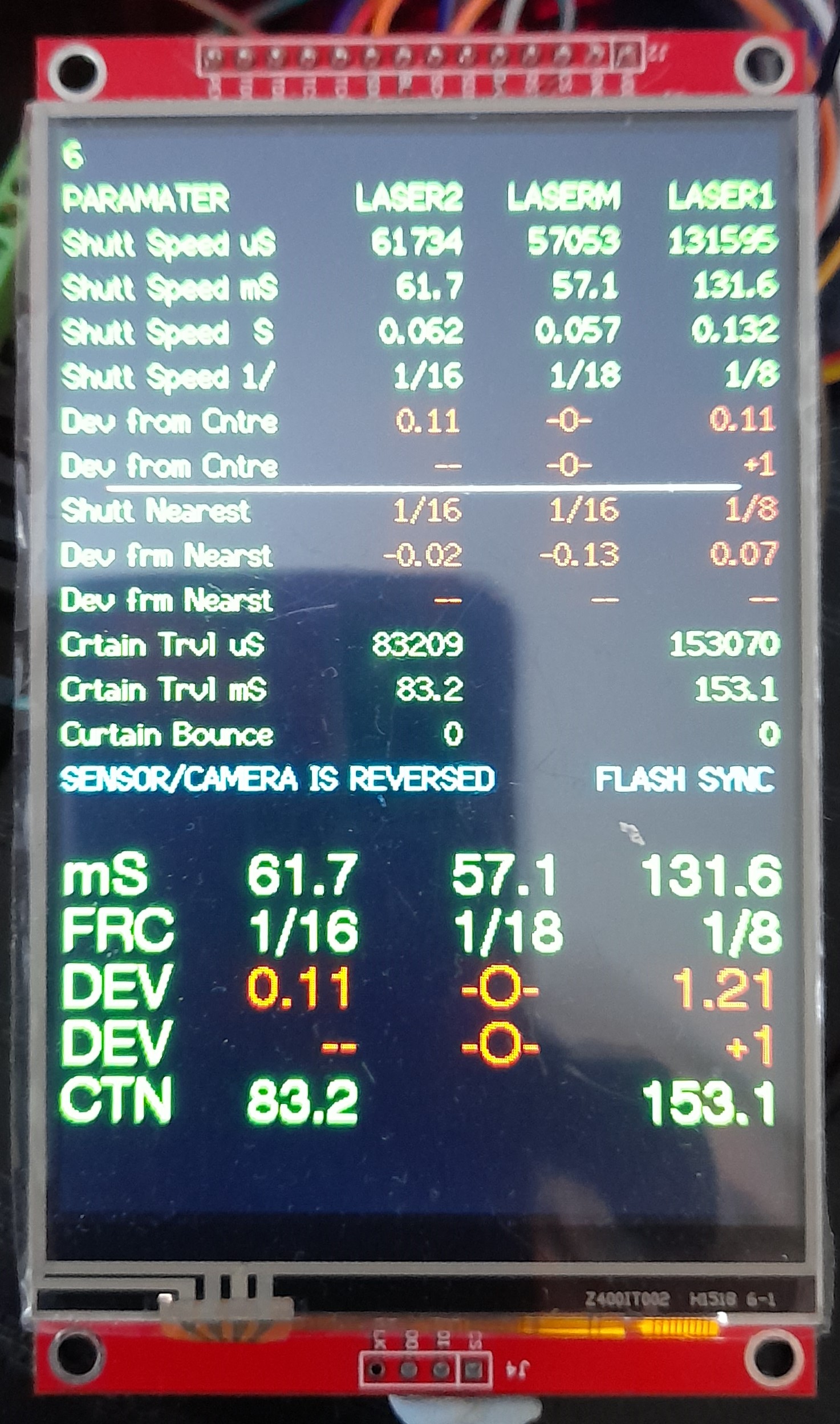

A quick photo of the tft display.
Full details are in a smaller typeface.
Larger display at the bottom shows shutter 'speeds', deviation from centre and curtain travel.
Colours change, green, yellow, red depending on how far from ideal the results are.

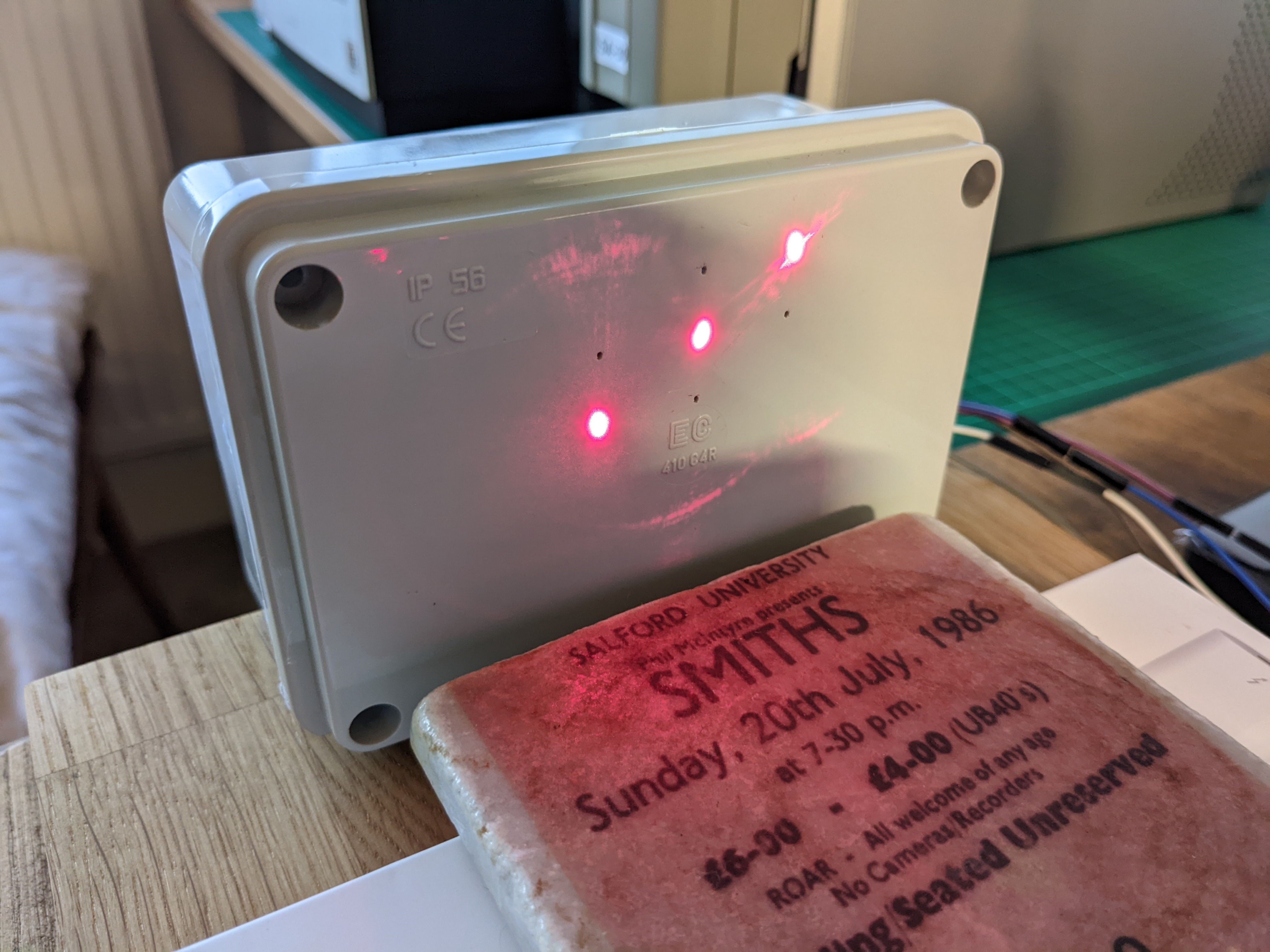

I've wrestled with how I was going to get lasers/receivers aligned in different boxes etc for a while and I did find it quite difficult.
Following some suggestions ref. Positioning of the sensors/lasers in a diagonal format, I did so, and removed the two vertical lasers/sensors from the equation.
I'm currently running the original code and 3 lasers/sensors.
Initial thoughts are that I'm impressed! I'm having an issue with alignment of the the camera to not block the laser beams, this I imagine is down to the positioning of the lasers not being perfect, something I'll look into again.
In addition, each time I'm winding the shutter on my test subject Zenit, it naturally moves the camera.
I need to brush up on my theory around curtain timing etc, but my initial thoughts are positive!

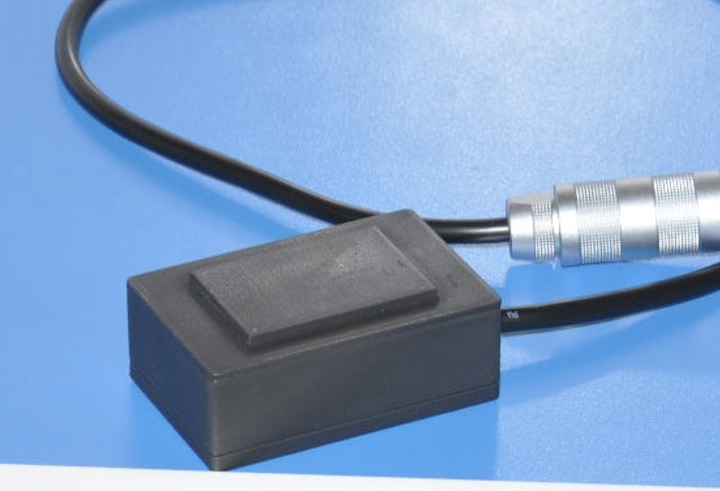

I'm going to probably take the approach of using the sensor holder from the professional build as suggested, along with a PCB, and then adjust the laser path to try and get some easier calibration.

Anyway, here are some pics! It's probably a bit more bodgy than I'd like, but that's what happen when it comes to me doing any precision drilling/measuring + a glue gun.
Definitely not a finished product.

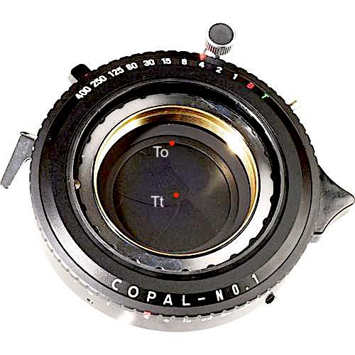

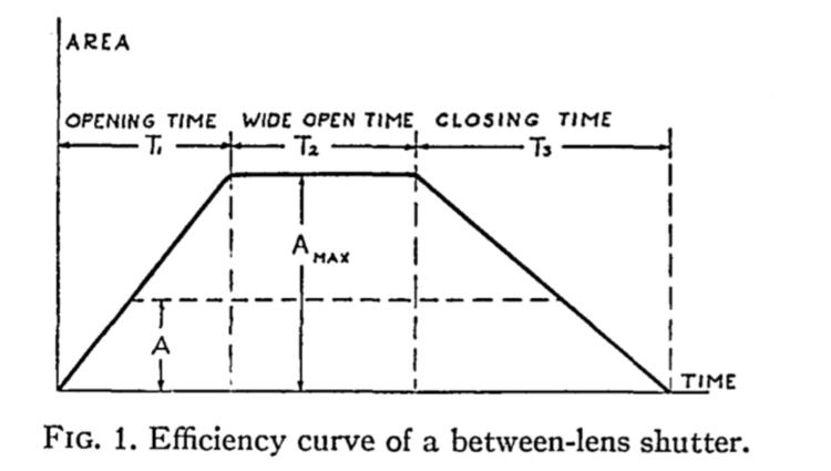

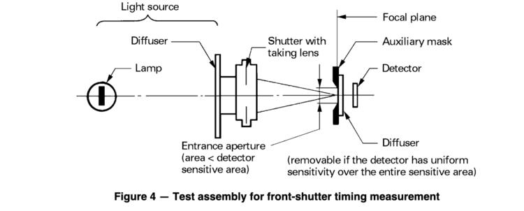

ISO 516 wants a leaf shutter to be measured with 'Normal' lens wide open, as so:
(Front Shutter = Any shutter in the vicinity of the lens -- ISO 516)
But, if measuring only the shutter (without the lens), one can get a near 'equivalent' measurement with the two measurements as shown here and using the equation:
Assume T1 = T3
Tt = T1 + T2 + T3
To = T2
Te (effective exposure time) = T2 + (T1 + T2)/2

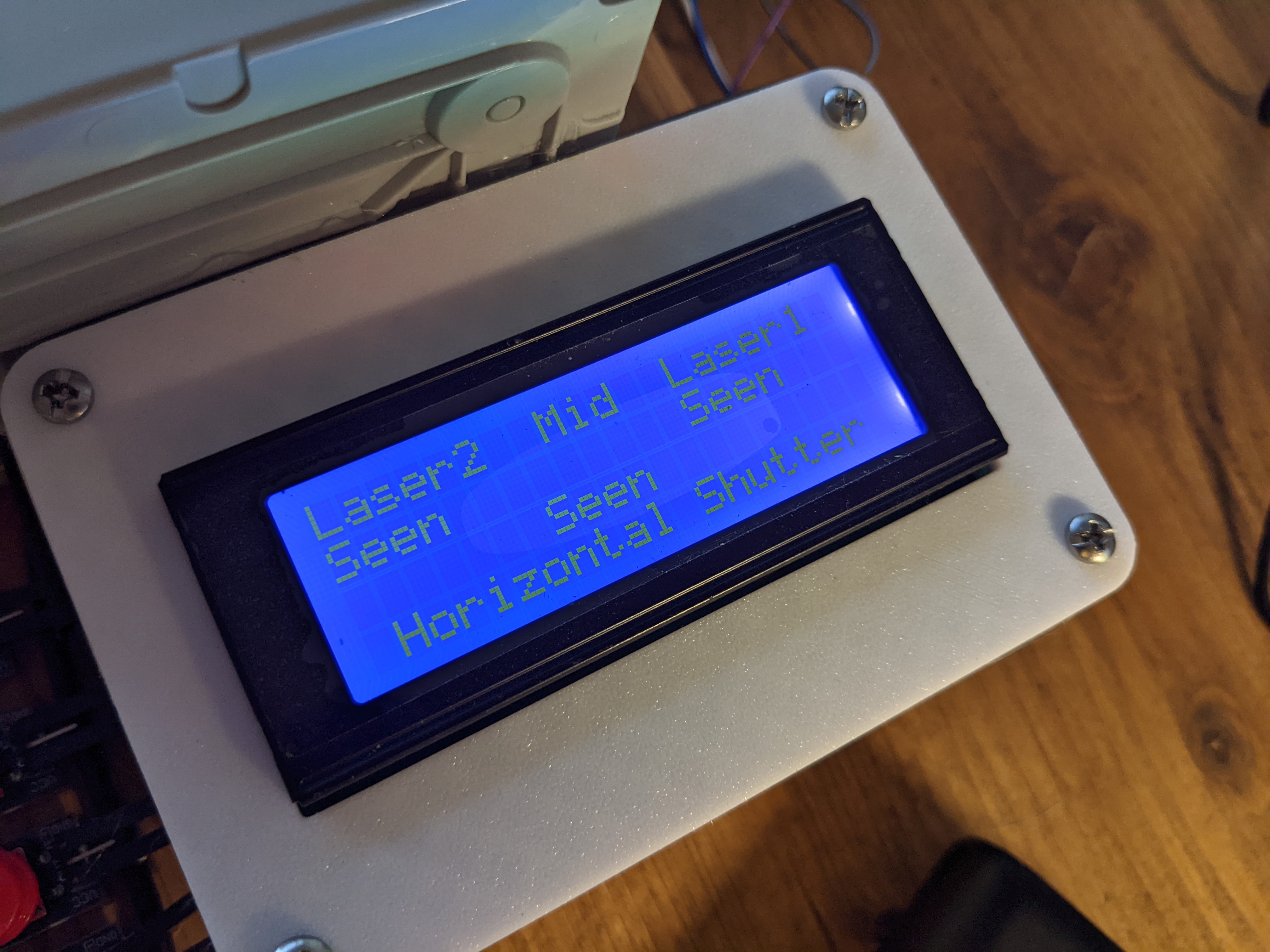

Hey everyone! I've ordered the parts needed for the ESP32 build, and while I'm waiting for them I am planning on building the enclosure, fitting everything etc.
Ihave opted for the three sensor diagonal layout design, and I was wondering if all of the three laser values are displayed on the LCD at the same time or not?
Hi, The LCD shows the outer two sensors. The LCD is a legacy left over from the older Arduino design & there is no space on it for three readouts.
The tft display and computer screen show all three sensors and more details than one should ever need.
Keep us updated with your build.

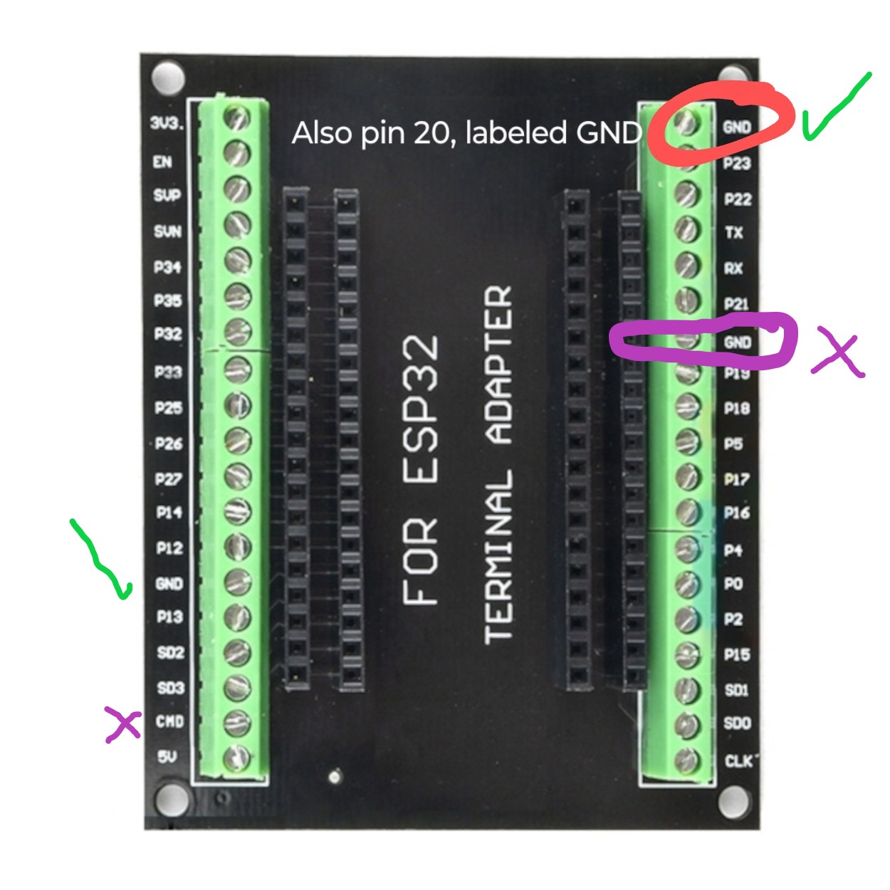

Hi nusproizvodjac,
The pin sometimes labelled as GND, between the pins 19 and 21 is not a ground connection. It is an error that is copied onto many boards.
I have looked at the PDF, pin 19 has a purple wire going to the tft,
pin 21 has a orange wire going to the LCD.
The pin between pin 19 and 21, is not connected to anything.
I cannot see anywhere on the ESP32 wiring diagram pdf, that shows pin 20 connected to anything?
If you only wish to test horizontal shutters, arranging the three sensors horizontally, rather than diagonally, will make aligning the camera far easier.
Concerning those GND pins: what you can do is take a multimeter, set it to continuity mode (many meters 'beep' when you contact both pins in this mode) and then verify if pin 20 is in contact with the other GND pins.
Alternatively, just connect the display GND to any of the other GND pins on the ESP32 module/expansion board. On the screw-type expansion board shown in your post, you can fit more than one wire into a single screw terminal if necessary. Just make sure they're all firmly connected once screwed tightly down.
Hi,
certainly not spamming.
Ask as many questions as you wish. It will help others and also help me make any changes or upgrades required.
English is not everybody's first language, so sometimes further explanation or re-wording can help.
The pin you circle, is top right on the board it is GND, not pin 20.
The pin that must not be used is six pins below. There is an error on the boards, and being chinese, the same mistake gets copied by the clone makers, rather than it being corrected.
Pin circled in purple is the pin that must not be used. It is above pin 19 and below pin 21.

EDIT: As I've suspected, neither Sensor 2 or Mid sensor detect any speeds. Tried four different recievers and modules, and it's all the same. They are detected in the alignment utility, but they don't measure. Strange really. I'll flash the code again, and see if it sorts out.
Put the camera on B and open the shutter. Do all three lasers shine though the gate and hit the receivers?
It is my guess that the camera is not aligned so all three lasers cannot shine through the gate.
Having the three lasers arranged diagonally does make it harder to align, as the camera has to be aligned both horizontally and vertically.
I have mine all in a row, s I don't have any vertical shutters.
Other thing you can do is to get a piece of card & cut a slot in it, to simulate a slot in a shutter curtain. You can now move this across the sensors to simulate a shutter passing.
