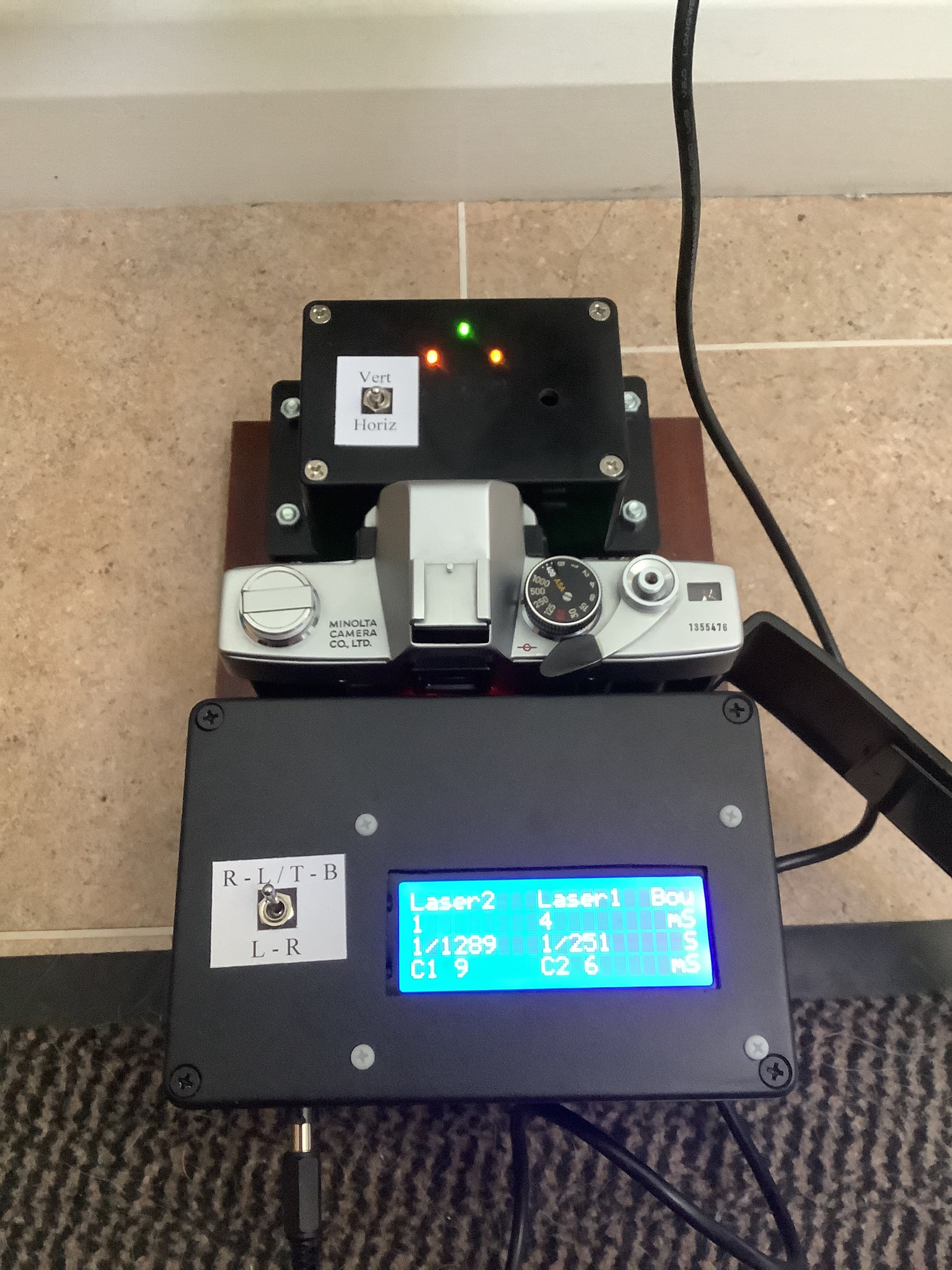

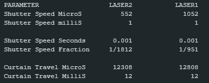

Can anybody please enlighten me? I've got the tester ready to go and tested my first camera. It's a camera I've used quite a lot, so I know the shutter speeds are within tolerance (at least within my acceptable tolerance, I only shoot B&W). So, not very suprising, all the shutterspeeds (accept 1s) are spot on, but the faster shutterspeeds (1/250, 1/500 and 1/1000) give me a weird result. The speed of the second laser is almost twice the speed of the first laser. It doesn't matter how many times I try, this is a very consistent result. I tested it with another camera (same story, used it quite a lot) and it gives me roughly the same result.
What could be the cause of this?
Niglyn
Feb 26, 2022
488
Surrey, UK
Analog
I have no idea! And it is my shutter tester :surprised:)
There should be nothing wrong with the tester (I have to say that o)
Laser 1 just measures the time between when it is first seen, then not seen.
Laser 2 does the same.
This gives the exposure time on either side of the curtain, a) to ensure even exposure and b) with two lasers, it is easy to measure curtain travel time.
Your two curtains are travelling at almost the same speed, so the slot between the curtains should be the same across the frame, so exposure should be the same.
So why laser 1 is reporting almost double exposure time, I really have no idea.
I would say that the first curtain is opening and sticking part way & then when the second curtain is released, it helps the first on it's way. But then that would not explain why the curtain speeds are consistent.
Which version shutter tester code are you using?
My next suggestion is to use single laser mode.
Cover laser 2. The tester will still work, but report only laser 1 results.
Now move the camera to the right, so laser 1 is where laser 2 would normally be & make another test.

What I eventually came up with was this:-

Time for testing: the triangle of LED’s on the cover of the sensor box, were initially
going to indicate alignment of the camera when the shutter was on ‘Bulb’. The transistors
visible at the back of the box were there to help drive the LED’s but unfortunately the laser
sensors could not drive then sufficiently, and as their circuit board was again glued down, it
was too late to modify the circuitry, so the LED’s are now just an aiming point.
and two of the three signals from the sensors transferred to the NANO via the two switches.
Testing involved:- Contax 139
Pentax Spotmatic
Pentax SF7
The Contax, having been recently serviced was spot on with the exception of the
1/1000th which was about ½ stop out.
Both the Pentax’s were good up to 1/500 with the two fastest more than a stop out.
Yes IT WORKS!

For the Arduino version, which most people have built, the changes are:-
1) Milliseconds are now displayed to one decimal place, rather than a rounded integer.
(This removes the rounding that could display 552uS and 1mS, as shown on post #355)
2) Seconds are now displayed to two or three decimal places, rather than a rounded integer.
3) Curtain travel time is now displayed to one decimal place.

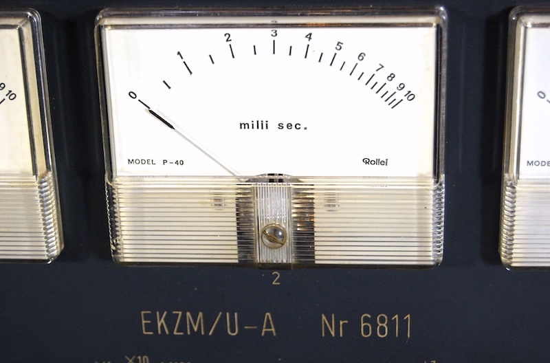

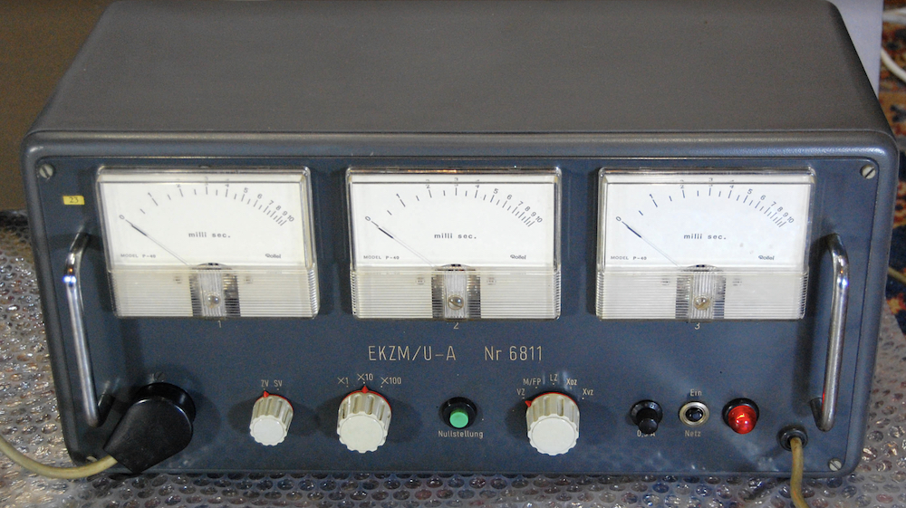

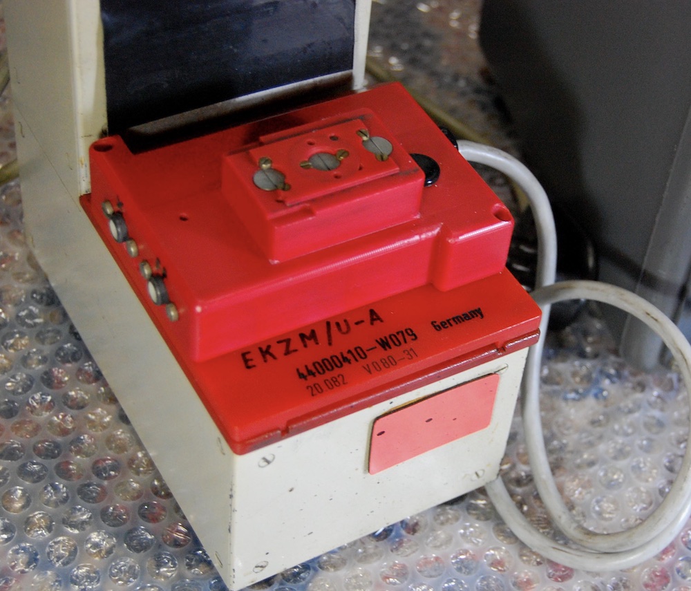

In terms of an analog professional tester, I can share some pictures of a Rollei EZKM tester. It displays the amount of charge of a capacitor. The capacitor is charged when the sensor is exposed to light, and the duration of light exposure is the shutter speed.
As you can see the slits are very thin. I don't think there is anything in the circuit to compensate for the physical width of the slit, but the device is only good up to 1/1000 of a second.

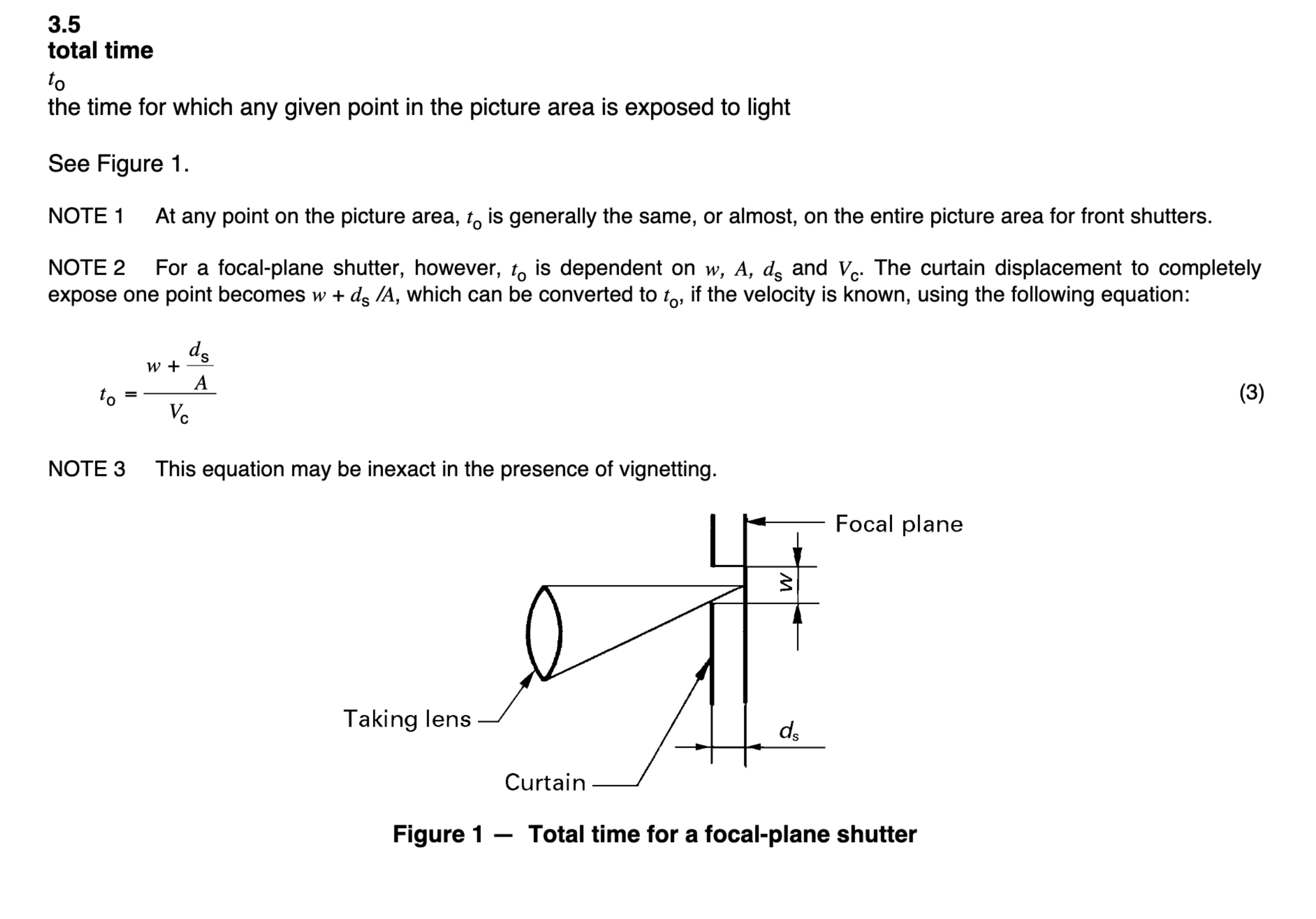

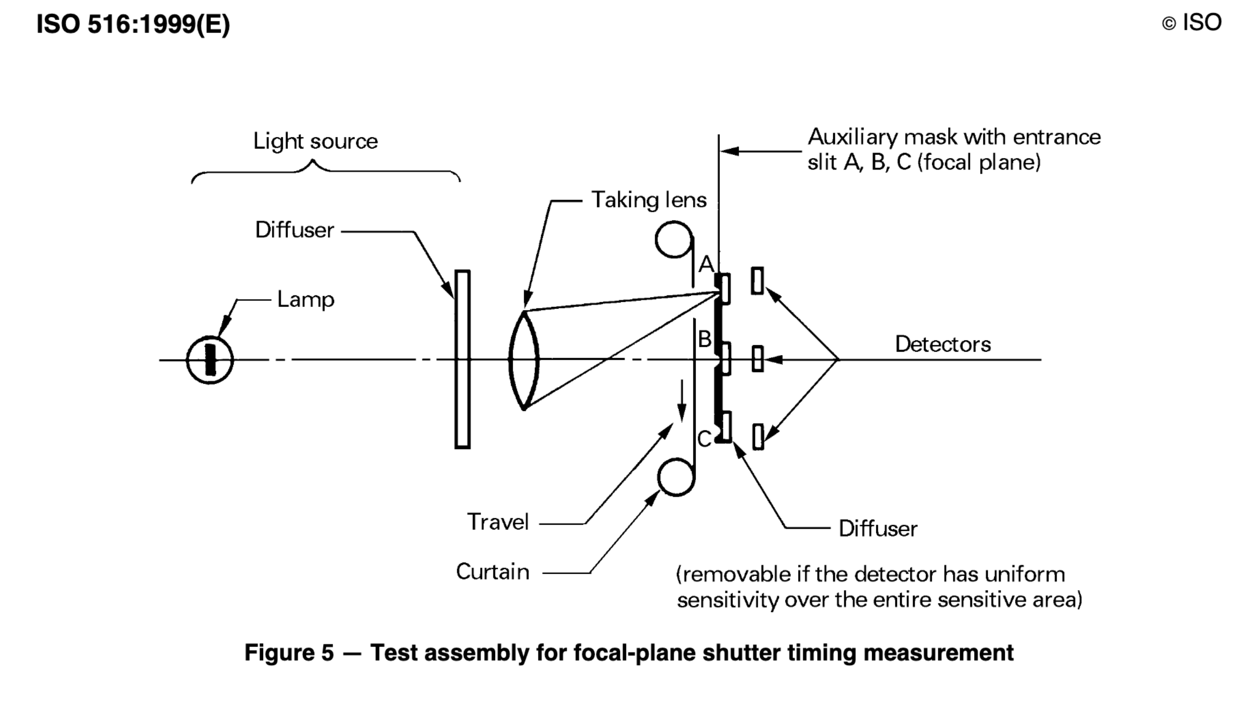

ISO 516 on shutter speed testing outlines the sources of error based on slit width as follows.

This is how the tester would be constructed according to ISO 516. There is a diffuser behind each slit. However, the next part indicates the sensors need to be adjusted in their output to only fire after 1/2 of the slit is exposed. The entrance slit needs to be less than the shutter curtain slit to be measured.
For many vintage cameras the smallest shutter curtain width would be 2.25mm.

My point with these posts is that the professional testers did not use laser light and ISO does not specify laser light. So, when using a laser, one needs to experiment to find out what one's high speed errors are and adjust accordingly.
