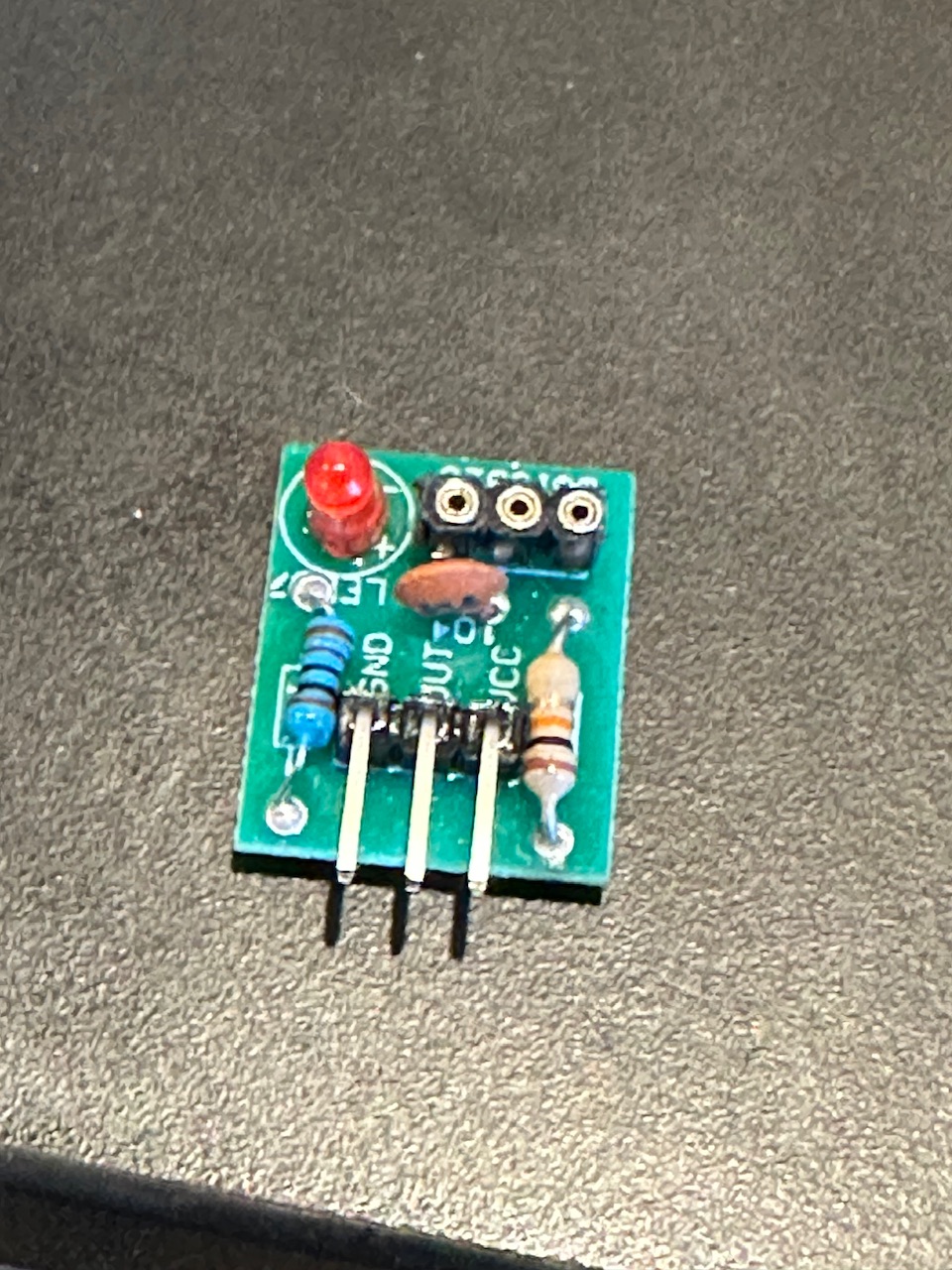

I'm having a bit of trouble getting my Arduino tester up and running. With the alignment utility the sensors are always in the 'seen' state, even with the sensor boards unplugged. I do have the red LED on the sensor boards illuminated and have checked that the sensor is oriented correctly.
Checking the voltage between the GND and the D2/D3 (sensor signal inputs), I get about +1 V with the laser not shining on the sensor and 0 V with the laser illuminating the sensor. This seems backwards to me.
I did note some references to an old/new sensor configuration with backwards wiring but I didn't see any reference to how to check for which version or how to handle if I have the wrong version. I apologize if I've missed those notes somewhere, I did try searching this thread but may have been using the wrong keywords.
Itbphoto, hi, no problem with missing anything. With 37 pages, there is a lot of chatter.
Your volage readings are not correct.
You should see 0V or 5V. Not any other voltage.
Disconnect the wires on D2 and D3.
(Leave the 5V & 0V wires connected to the sensor modules)
Measure between the 5V and 0V pin on the sensor module, you should see 5V
Measure between the 0V pin and centre pin on the sensor (or end of wire)
This should be either 0V or 5V.
Then with the Laser on the sensor (or another strong light), you should see
this voltage reverse, so if it was 0V, it should now be 5V. Or if it was 5V, it should now be 0V.
My thoughts are,
a) Not getting 5V and 0v to the sensor module (hence first step to measure the voltage on the sensor module)
b) Your sensor modules are part of the faulty batch, where the pull-up resister on them has not been connected correctly.
(Go back though the pages here, there are photos showing the difference between the good & bad boards & how to correct them).
c) The sensors have damaged the sensors, which is easily done if they are connected the wrong way round, or 5V & 0v was crossed at some point.
d) The input pins on the Arduino D2 & D3 have been damaged.
To test the Arduino module itself, you will need to connect a 10k resister to D2 or D3. The other end of which, using a piece of wire, connect to 0V. The test screen will show 'seen' or blocked' (sorry, I cannot remember which)
Moving the wire to 5V, the display should toggle and show the other value, (blocked or seen).
ENSURE the pin is connected with a 10k resister in series. Putting 5V directly into pin will damage the Arduino.
Please post back with your results & findings.

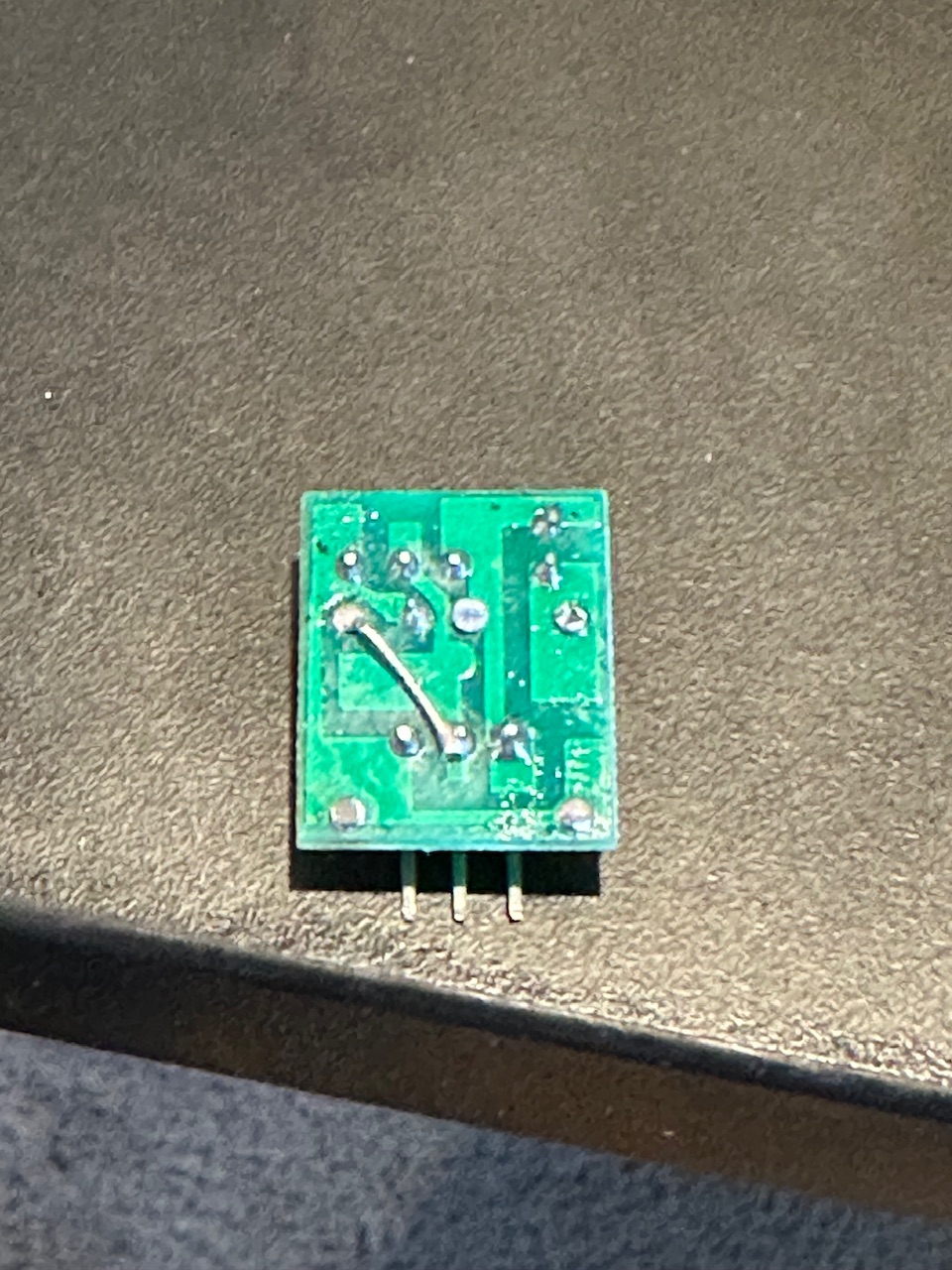

That was very informative, thank you. It was the sensor boards, which is a bit concerning as I have a mix of AliExpress and Amazon sourced sensors - they all have the same issue with the 10k resistor not being connected to anything.
I found the easiest fix was to fully replace that resistor and use the excess lead to bridge to the signal pin. Trying to wrestle a tiny wire onto the board and solder it into place was an adventure.

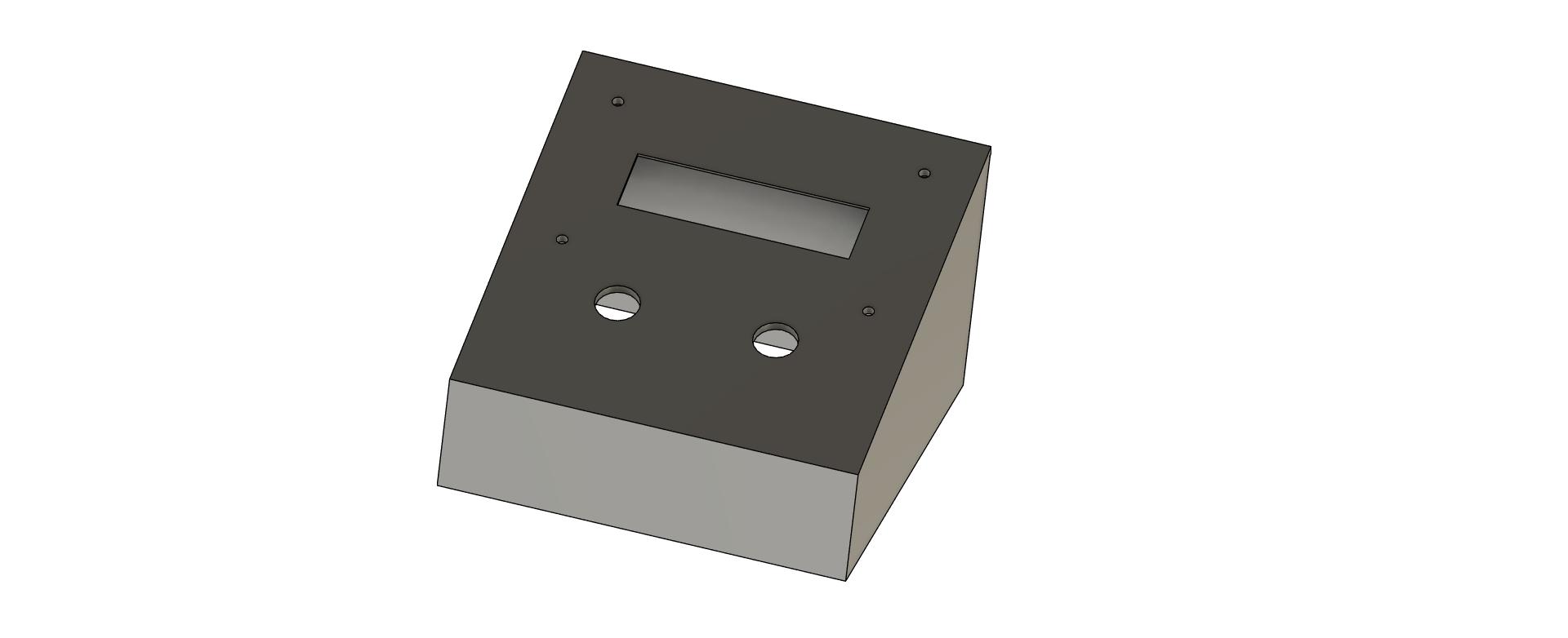

Hi all,
here is a quick sketch of an enclosure for the Arduino based tester. Any good?
Hi, by popular request, a 3d printable enclosure for the Arduino version of The Shutter Tester is now available.
Files are on Github.
Sensor & Laser enclosures use the same 3d print files as the ESP32 version & can be found in that sub-directory on Github.
Picture shows parts facing downwards, as they would be printed.
Assembly guide will follow.

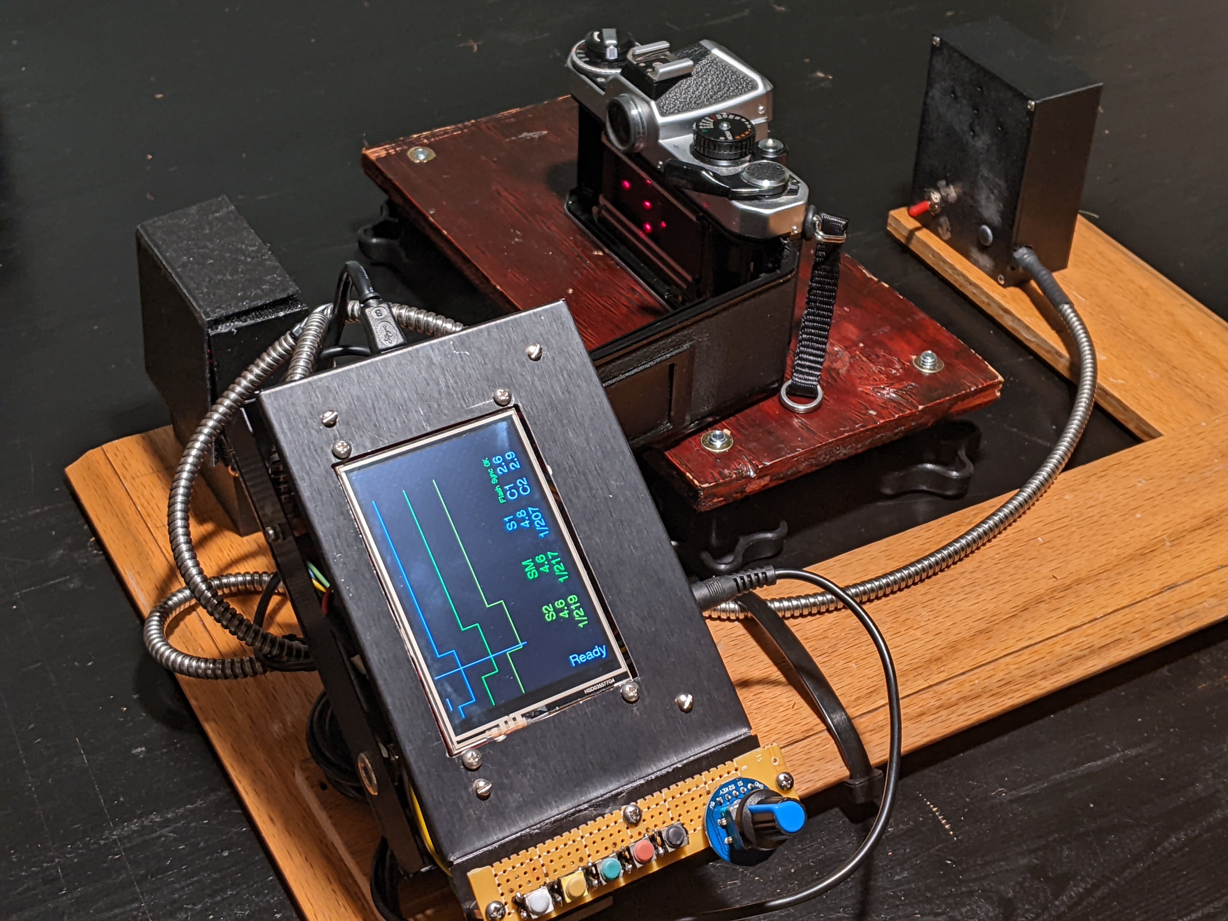

Hello Niglyn et al:
It's a few revisions behind on the 3D enclosures you provided, but here is a picture of another one of your test fixtures out in the world.
Hi, that looks, well, ingenious 😃 I like the old cupboard door used as a frame 😃
I am waiting for somebody to 3d print the case and expansion board mounting frame & take some build photos for me, as I need some photos for the build documents.
My 3d printed case uses the pcb, so does not use the frame.

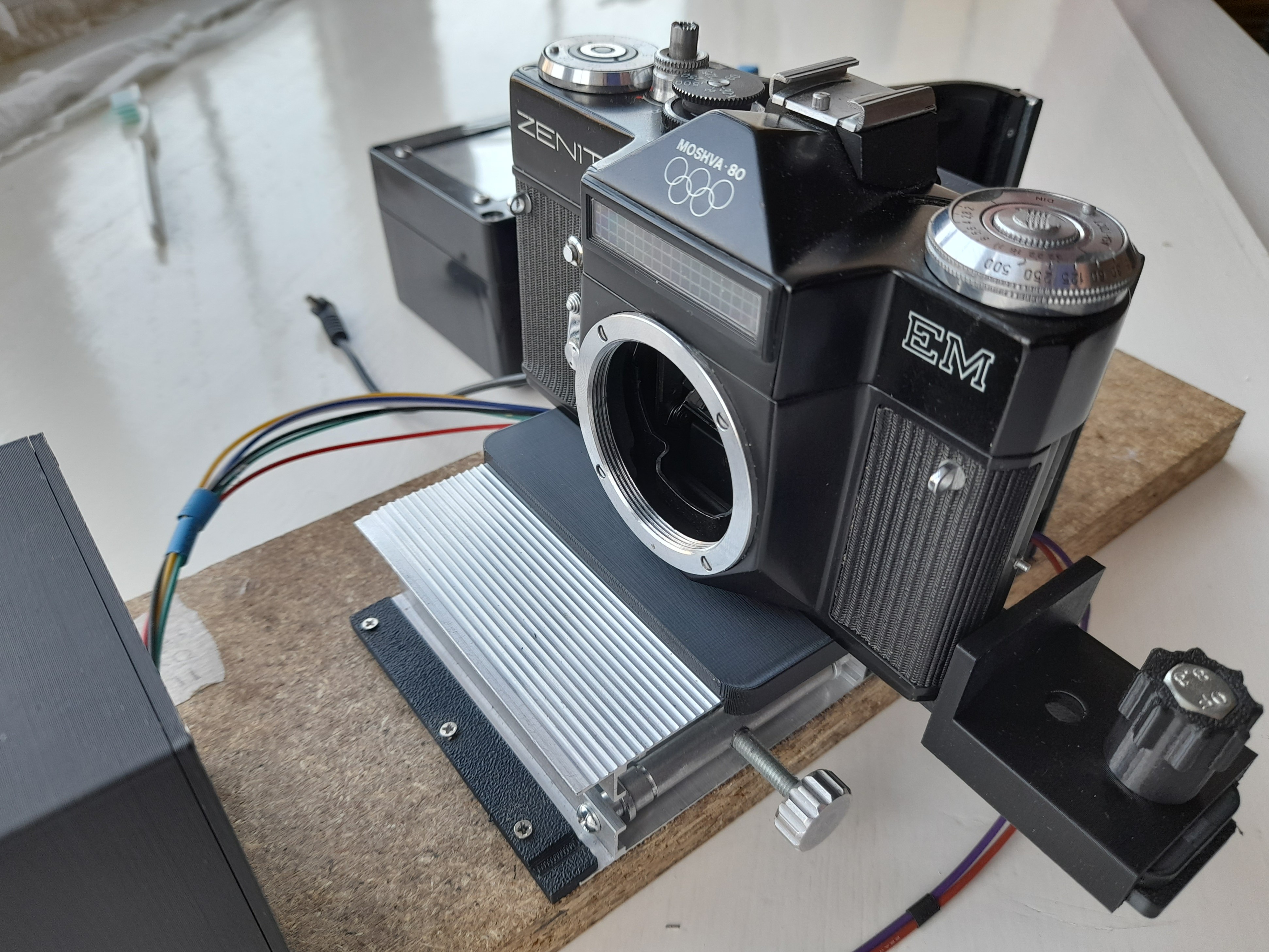

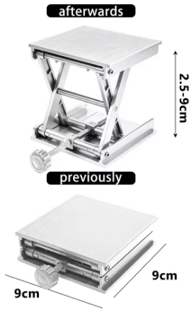

Not sure if anyone has ordered the little lifting table shown on the parts list?
I have made a platform for it, to hold the camera steady whilst testing. This should make it much easier to position the camera.
The lifting table attaches to the baseboard, either by directly screwing/glueing or using the 3d printed rails, which clip over the lip of the table & are screwed to the baseboard.
3d printed platform has to be glued/screwed to the table top (if screwed, holes must be countersunk).
End-stop is adjustable for different camera widths. M6 x 35mm nut & bolt required.

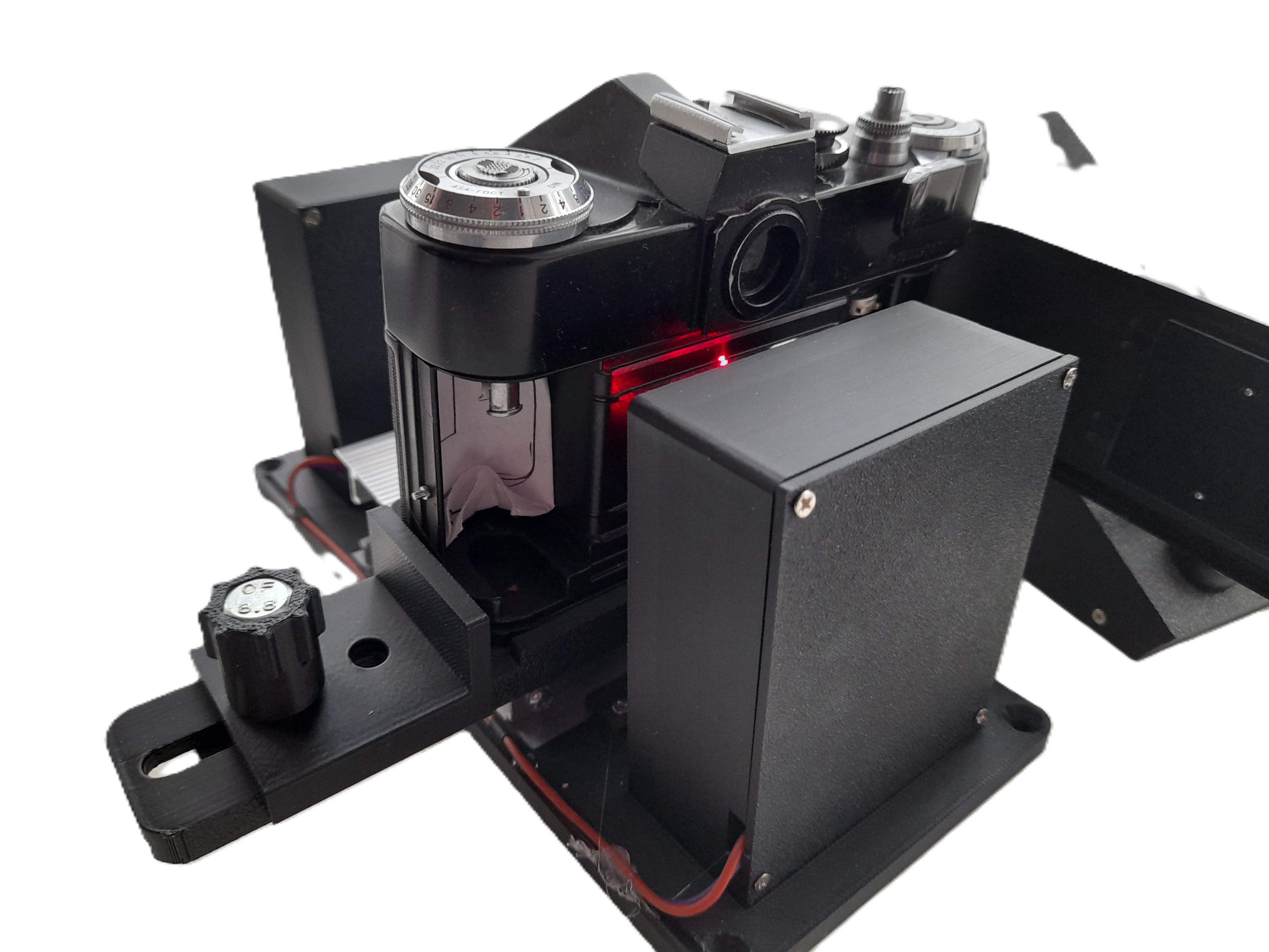

Here are a few photos of the 3d printed sensor & Laser holders, together with the mini lifting table and camera mount.
Sorry, did not have the 3d printed shutter tester, so the project-box version is shown.
I works really well. Camera is held in the correct position & makes it much easier for multiple tests or for removing & re-placing the camera after adjustment.
The baseboard is an offcut of chipboard flooring. I could make a 3d printed baseplate, with recesses for the parts to drop into, but is this overkill? Happy to make one if there is demand.

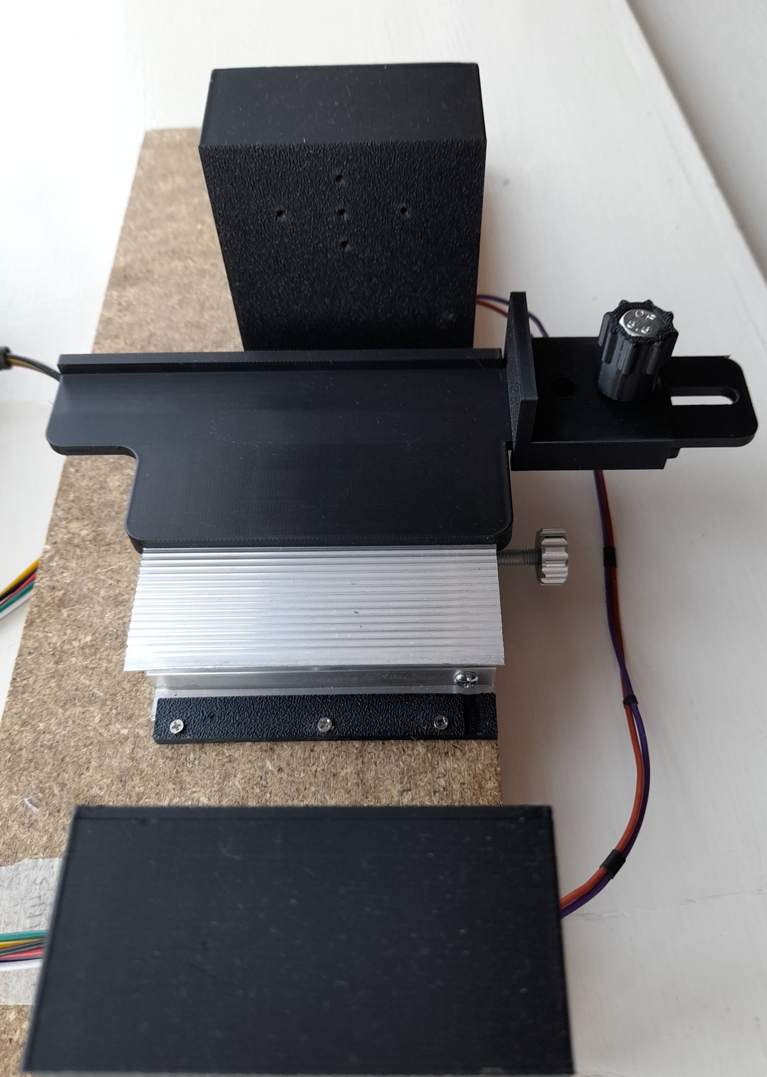

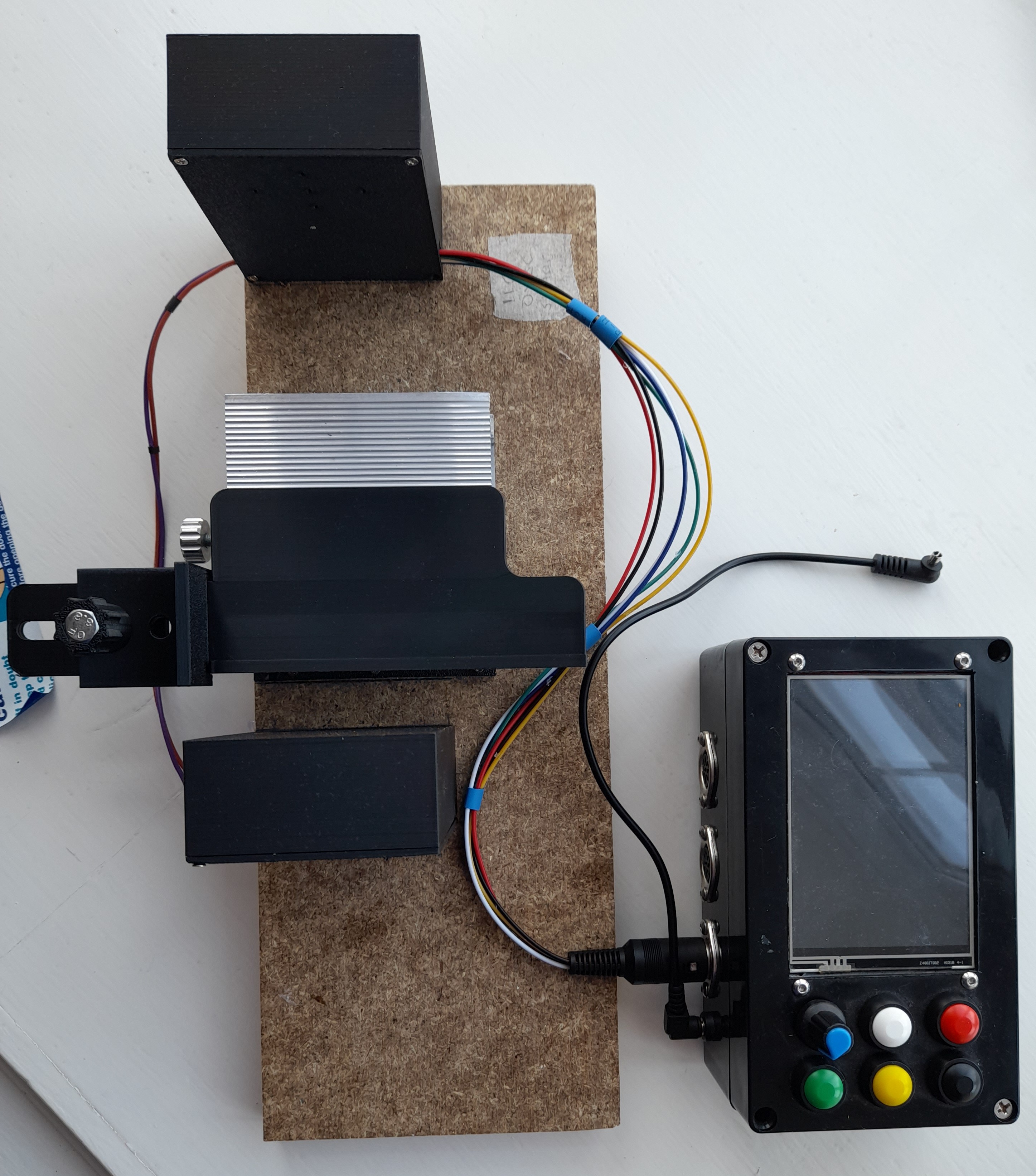

Was a horrible foggy day, so gave me time to make a Base for The shutter tester.
Photos below. 3d print files & instructions on Github.
