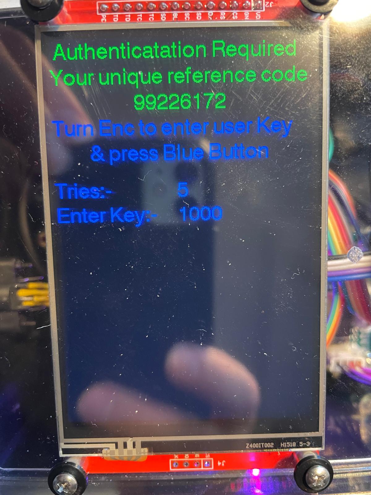

Yes, wiring up the encoder to the ESP board will allow authentication. Again for simplicity, I do not detail this in the instructions.
Yes, the Blue Button is the centre of the Encoder. I shall see if I can make this clearer in the documentation.

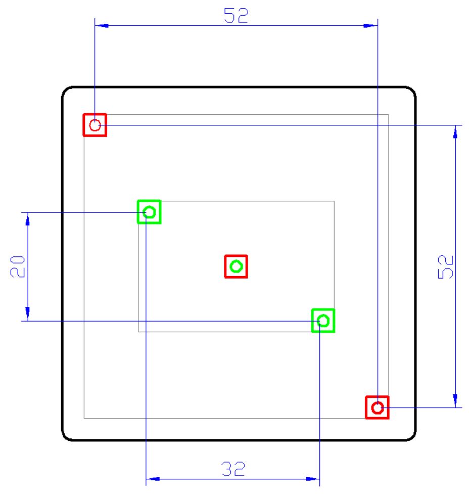

@Spachal If you want to use a diagonal configuration with a sensible spacing (51mm), the diagonal is 72mm, which is too large for the lens opening.
I don't think it's a good idea to use the 20/32mm spacing for 6x6. Generally the curtains are accelerating and you can't extrapolate the timings reliably.
@OAPOli: My idea was to have two sets of sensors that would switch, with a central sensor being shared.
I tried to draw it quickly, green sensors are for 35mm film (36x24mm), red for 6x6 medium format (56x56mm). Would a shutter meter be able to work correctly like this?

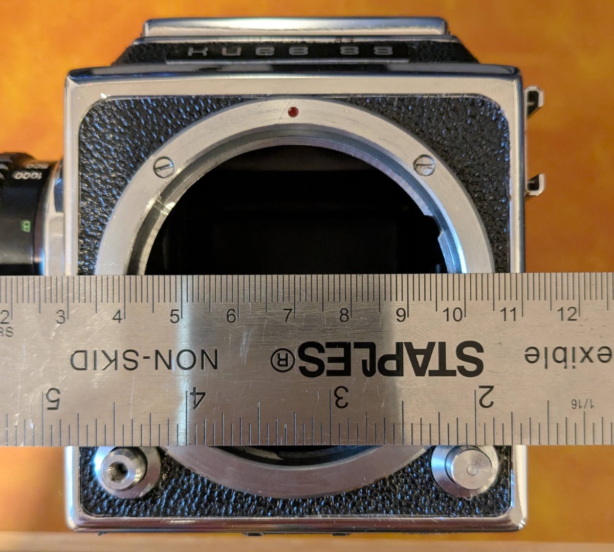

I still don't understand the problem with "lens opening", every lens mounted on a 6x6 must illuminate the entire 56x56mm film area, a diagonal of 79mm, right? Even the physical dimensions of the shutter are 56x56mm (measured on a Kiev-60)
OMG, please excuse my stupidity, I've always only looked at the shutter side only, that's really embarrassing :/
I just measured my Kiev-88, the maximum diagonal of the lens mount is 57.7mm...
Do you have any ideas for a technical solution to measure the entire medium format shutter? Besides shortening the sensor distances, which would mean I could simply use sensors for 35mm film (32x20mm).
I clustered the lasers near the centre and angled them towards the sensors. Not ideal because the measured spacing will decrease the closer you move towards the lasers.
I think one could make a "+" configuration with 5 sensors and lasers. Without modifying the code, you can swap the connections for the sensors.
I've been thinking about possible solutions and this configuration came to mind:
  • There will be 5 lasers, similar to the drawing above.
  • The center laser will always be on and can also be used for single-sensor measurements.
  • An on-off-on switch will toggle between the two outer lasers for 35mm film or the middle format.
  • The lasers for the medium format will be angled to illuminate 32/20mm sensors.
  • There will be only three sensors, shared for both 35mm film and medium format.
  • The distance between the lasers and sensors must be constant for the angled lasers for the medium format to work (beam position on sensors)
It will be more complex to create fine adjustments for the laser positions and angle (especially for those with angled beams), but I already have an idea in my head. And I wanted the laser and sensor positions to be fixed before this modification anyway. Yes, the measurements will be slightly affected by the angled direction of the medium format lasers, but this distortion will be minimal for our purposes.
The only thing that will be necessary is manual adjustment of the sensor spacing (in this case, the lasers) in the ESP when changing between 35mm film and medium format.

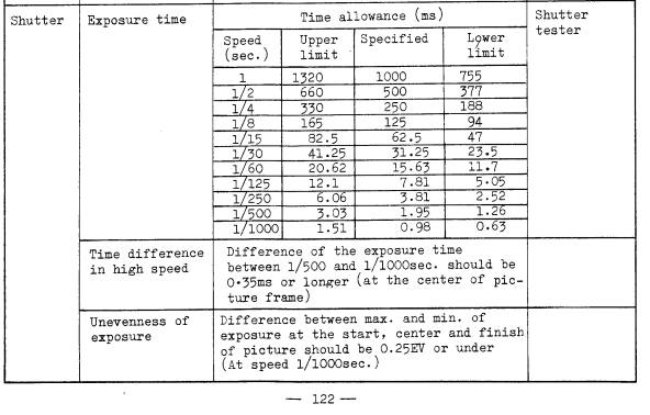

I often get questions on why a camera shutter is not showing the correct speeds.
Sometimes people even grumble that The Shutter Tester is not working properly!! The audacity :surprised:)
Here is a page from a Nikon service manual, showing the tolerances.

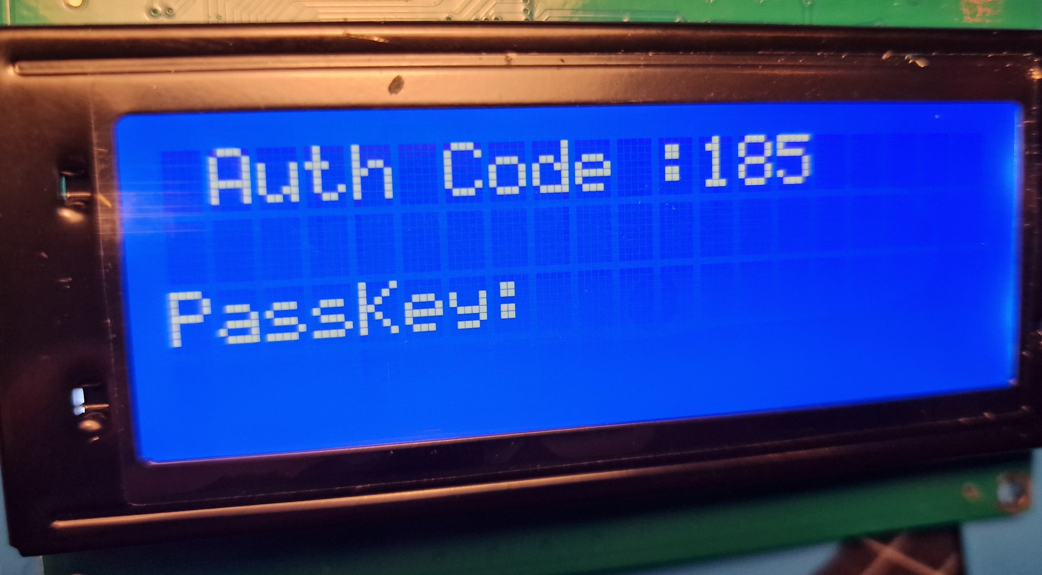

Hello to all and thanks to Niglyn for this project. I think -- think! -- I'm ready to load the shutter speed program onto the ESP32. Is this the point at which I need a code for the software? Thanks!
Hello to all and thanks to Niglyn for this project. I think -- think! -- I'm ready to load the shutter speed program onto the ESP32. Is this the point at which I need a code for the software? Thanks!View attachment 388396
And here it is waiting for the code:
Excellent! Realize 1.51ms is 1/662!
