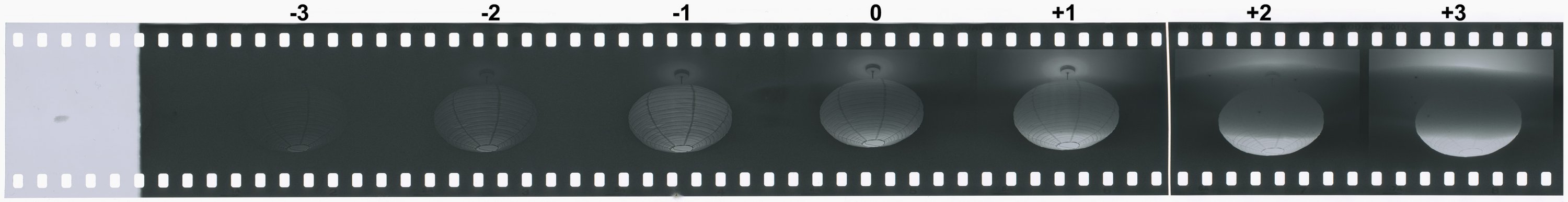

I've seen lots of edge markings that aren't fully exposed, so having some density left in them isn't necessarily definitive. I'd go by the exposed leader, assuming you're using 35mm.

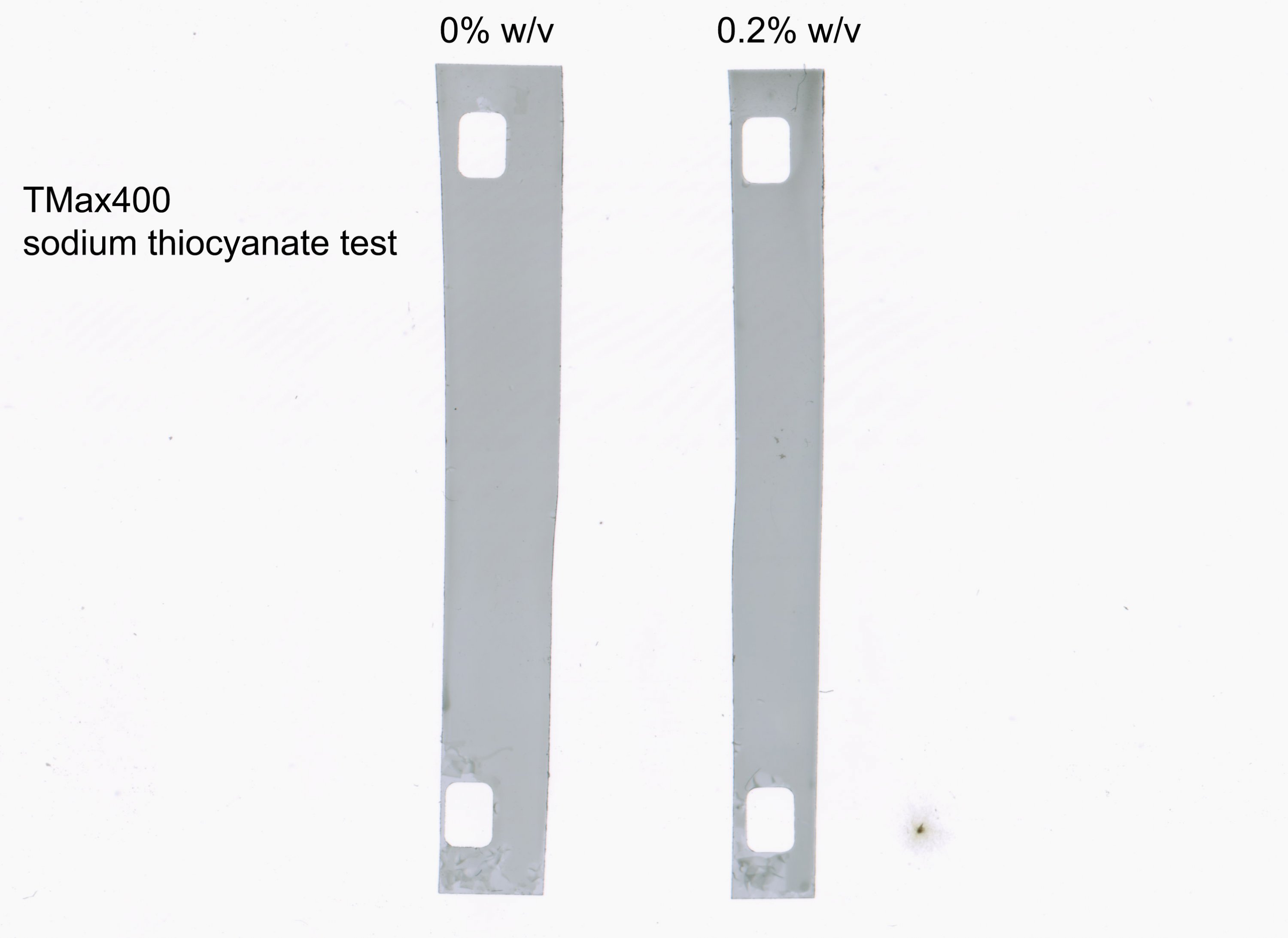

I tried with the film leader of TMAax 400 again. The first developer 1:6 rodinal has either 0% or 0.2% w/v sodium thiocyanate and everything else was the same except for the second developer, which was replaced with 1:6 HC-110.
After all the steps (1st dev, bleach, clear, reexposure, 2nd dev) the emulsion appeared to be fine for both 0% and 0.2% thiocyanate film leaders. However, they appeared to be a bit dark but became lighter after fixing. After placing them in the fixer (Ilford Rapid Fix 1+4), the emulsion started to peel off from the edges. I suspect that the pH of the second developer was the culprit of emulsion peeling and this somewhat confirms that, since the emulsion appeared to be fine after the second developer and only started to peel when it's in an acidic environment of the fixer. Also, I would like to mention that Jens Osbahr's protocol uses a hardener in the fixer and I highly recommend doing that (previous whole film tests used the hardener but this film leader test did not).
Here are what they look like.

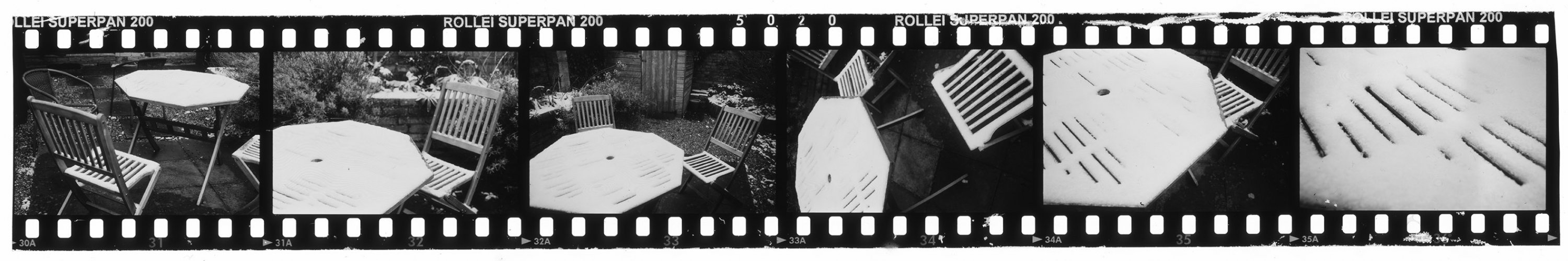

I then tried this process again but with Rollei Superpan 200 since I had gotten decent result last time. Everything again was the same but I used the fixer/hardener mixture.

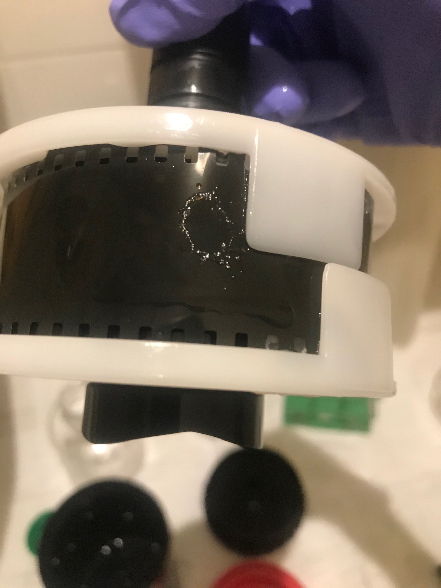

One thing I noticed after the whole process was that there appeared to be a gelatin layer on the film base side that was peeling off. I thought this was due to the ethylene glycol from HC-110
I thought this was from inadequate mixing of the 1:6 HC-110 and the ethylene glycol had deposited on the film. However, after further rinsing, this gelatin layer would not come off. I had to manually remove this by hand under the sink. When the film dried it curled up a lot and even after days of attempting to flatten it under lots of photobooks, it's still very curly.

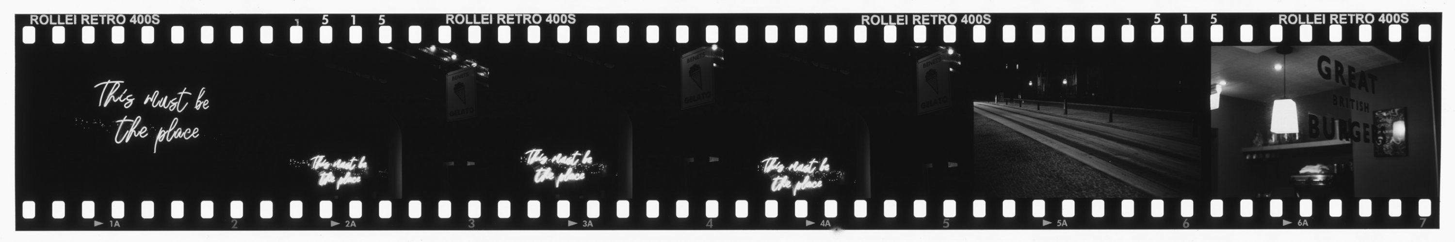

Next, I tried it again but with Rollei Retro 400S (which is supposedly the same thing as Superpan 200) kept everything the same but reduced bleaching from 10 min to 8 min.
This definitely made the emulsion happy; however, at the end of the roll there was one frame where the "gelatin" layer on the film base side was present. I tried to remove it by hand but this just exacerbated the issue further. It seems like this is either the anti-halation layer or something else. I suspect the peeling of this gelatin layer is from over bleaching so future trials will use a shorter bleaching time (6-7 min, as I find that 5 min is generally not enough).
The good news is this system of rodinal and HC-110 works by solving the pH issue. Care must be taken when using permanganate bleach as this is pretty abrasive to the film emulsion and the "gelatin" film base layer.

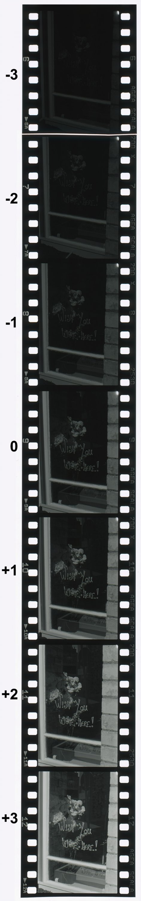

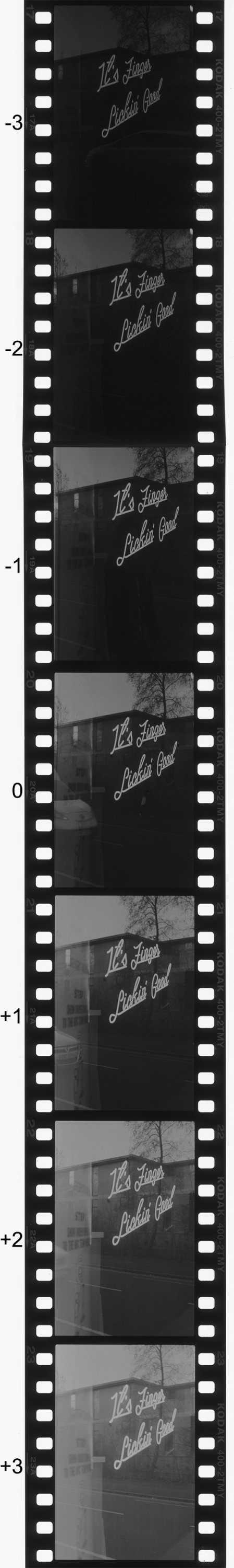

I tried a roll of TMax400 with my process. Everything was kept the same but the bleaching time was done in parallel with a strip of the film leader. Bleaching actually took a bit longer for TMax400 (11 min) than Superpan 200/Retro 400S (8 min). After the whole procedures I did not notice any emulsion damages, so it seems like the rodinal and HC-110 combo works with this film as well.
Here's the result of a reversed TMax400 shot at 400:
This was scanned on a Epson Perfection 4490 with a level range of 0-255 in the SilverFast 9 software. The scanner was calibrated with IT8 color slides from SilverFast. This was done with the above Rollei films as well.
One thing I noticed is that this film when reversed is way less contrasty than the Rollei film; the grey film base also doesn't help either. I was afraid that the longer bleaching time might have damaged the emulsion but this doesn't seem like an issue. Moreover, I have opted out the sodium thiocyanate from my reversal attempts and won't use it in future experiments.

Hey, you got some decent results from the TMax 400! That's very good news. Looks like you managed to get a very good DMax from just eyeballing the scan. Which exposure seems to look right to you? 0 or +1 maybe from the scans, but can't quite tell.
Thanks man! Honestly I think exposure at 0 is fine since this was shot through the KFC window with the neon sign inside. I feel like for reversal slides, just like E6 slides, you need to shoot +1 for night scenes.

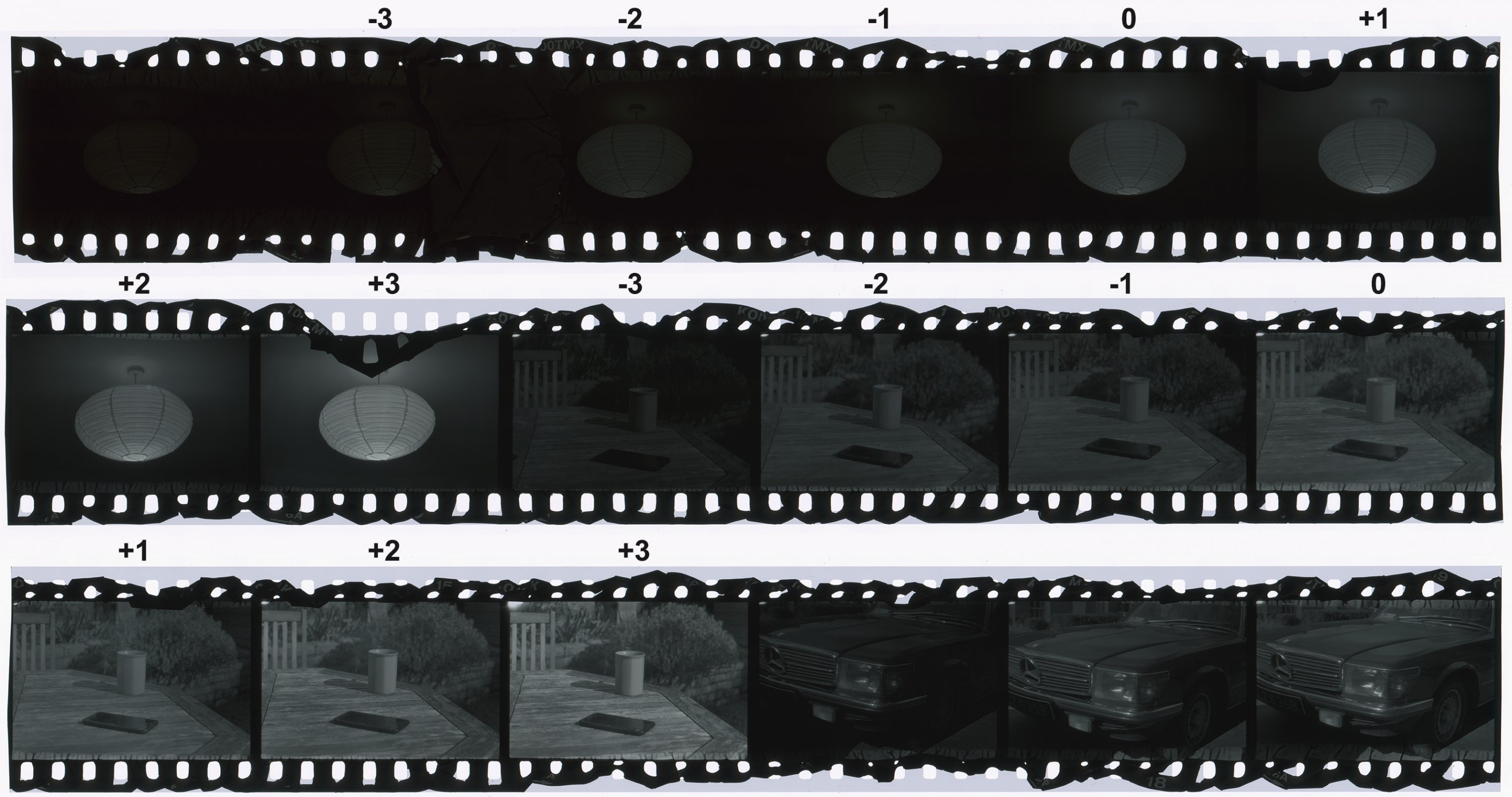

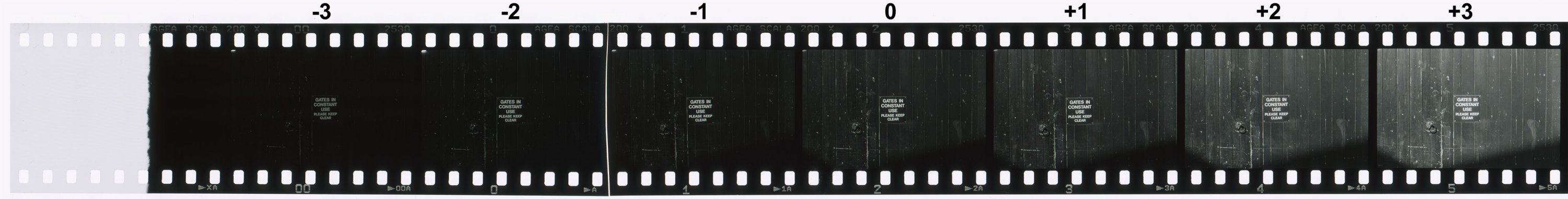

Some updates on my film tests.
TMax100 @ 100: bleach cleared film leader for 5 min but I extended to 8 min for the whole roll. Emulsion damage around the sprocket holes is pretty bad, which is mostly likely from over bleaching. Next trial with this film will reduce it down to 5 min. I also suspect that the fixer/hardener mix had gone bad.
Tri-X @ 400: bleach cleared film leader in 10 min; however this wasn't sufficient enough as solarization occurred and the blacks are not deep black. This is visible from from -1 to +3. Next trial with this film will need to extend bleaching time to around 15 min or longer. I used a fresh fixer/hardener here which probably helped to minimize emulsion damage.
Scala 200X @ 200: bleach cleared film leader in 8 min but wasn't long enough to clear the film border edges. Next trial will need to extend bleaching to 10 min.
Most important take away here is that TMax100 is pretty fragile to the permanganate bleach and fresh fixer/harderner must be mixed before each reversal process. I used Ilford Rapid Fixer and Tetenal hardener, even though they aren't suppose to be used together I found that the mixture is stable enough for 2 days. During the 2nd day you must aggressively agitate to make sure the precipitated aluminum on the bottom of your bottle is well mixed together in the solution.
