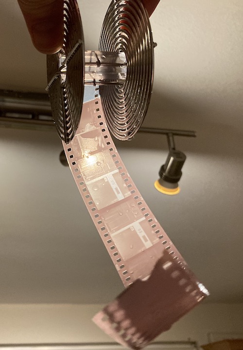

@Eddypolak I agree with what @YoIaMoNwater said. Here's a photo of that roll of Scala 160/Silvermax 100 that I discussed above. This is after bleach, just before re-exposure. Was yours this clear? Note the leader at the very top and wrapped around the spool: totally clear. You can see the white highlights here as well, for comparison.

Thank you all for being very helpful and informative! The back story here is I bought a bunch of Scala 160 and then found I couldn't get the kit! So coronawhile I thought I might as well pick up where I left off with the Ilford process and Pan FPlus during the first lockdown :smile: I will surely buy the kit once I can and indeed get a true benchmark set of results but I like experimenting and using my brain (and those of others!) so I will carry on with this a little bit longer. It is very true that I have struggled with the language of describing the results with this benchmark. Who will/would be stocking the Scala kit in the UK?
I've only looked at my film once it's been through the clear. It looks a creamy white but I haven't examined it in any detail. The final film has a perfectly transparent leader with a slight yellow tint I naturally see in highlights. If 'film border' is the same as where the sprocket holes are that is perfectly black which is I would have expected since it's not been exposed so I am confused that it should be clear.
My bleach and clear are as per the Ilford method. So that is Bleach A potassium permanganate 4gm/l Bleach B 10% sulphuric acid diluted 1+4.which I mix at the time of processing. The only doubt is percentage concentrations are no long used but I have calculated that 1M acid is equivalent to 10%. The clear is 25gm/ l sodium metabisulphate.

It could be residual silver from the first development due to insufficient bleaching. Or it could be silver formed by second development due to rehalogenation in the bleach. There's also a third possibility where some of the silver removed by the bleach doesn't diffuse out fully and gets trapped in the gelatin mesh. This happens when the bleach is not properly formulated or has been reused several times.
Extend the time in bleach by a minute and see if the tint goes away.
Rehalogenation can happen when bleaching if there are halide impurities in the bleach. Some silver in the negative image gets converted to silver halide which is redeveloped by the second developer. Use distilled/RO water for mixing the bleach.
To avoid the third possibility, mix the permanganate bleach afresh every time and don't reuse it.
BTW if you still have the leader with you, try bleaching it again with lights on, clear and redevelop to see if the stain goes away.
