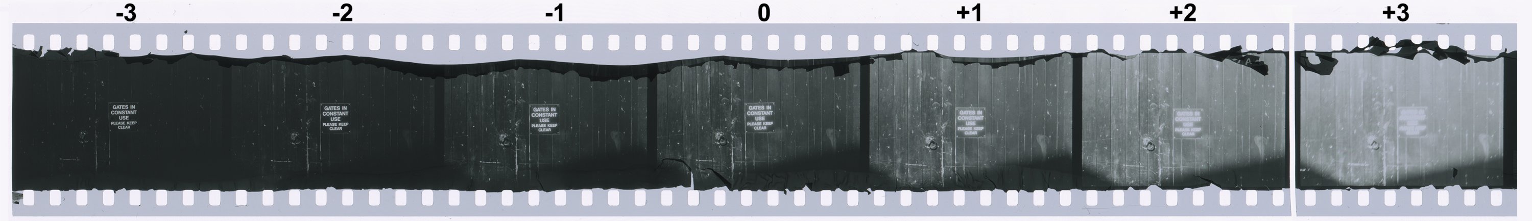

HP5+ @400 with 12 min bleach:
I have a little update here. @YoIaMoNwater mailed me a bunch of his films and I did some measurements with my densitometer (X-Rite 331). No H&D curves, but these numbers are looking very good:
Agfa Scala @ 200 — Dmax 2.71, Dmin 0.06
Rollei Retro 400S @ 200 — Dmax 2.92, Dmin 0.03
TMax 100 @ 100 — Dmax 3.63, Dmin 0.16
HP5+ @ 400 — Dmax 2.27, Dmin 0.23
TMax 400 @ 400 — Dmax 2.95, Dmin 0.17
These go along with the previous details he has already posted in this thread for each of those films.

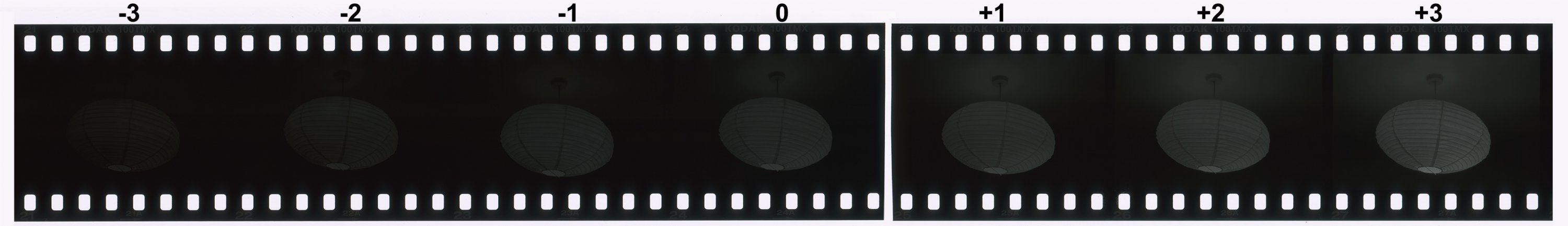

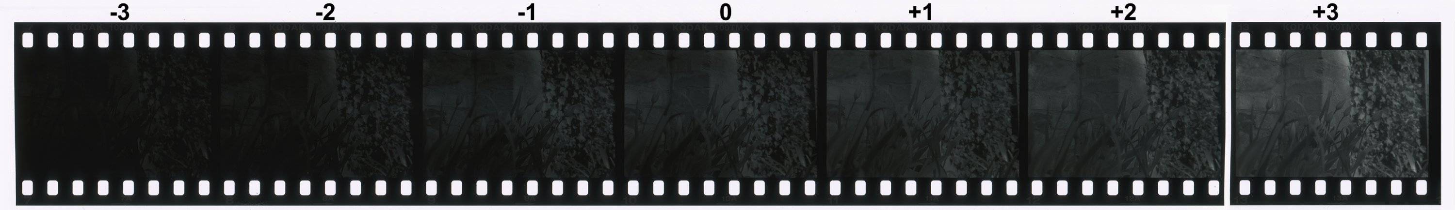

Fomapan 400 @ 400: I tried reversing this film with both the leader strip and the whole roll. Bleach cleared the leader strip at 11 min but I extended to 15 min for the whole roll. This was a terrible mistake because after putting in the 2nd developer for a few min, I could see black pieces of emulsion floating around the developing tank. Next trial with this film probably need to limit bleaching to 11 min or less. Contrast seems fine; however, there's a noticeable reduction to Dmax as the blacks are not black.

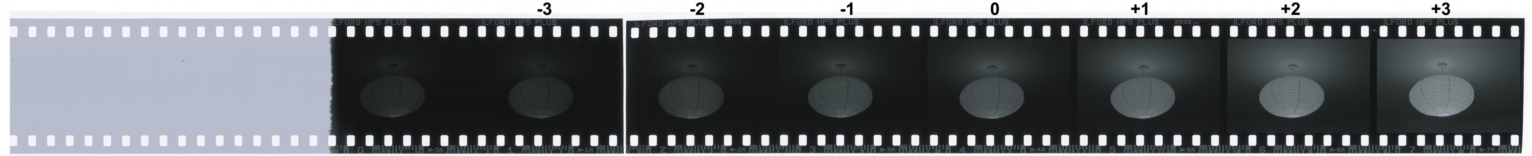

TMax 100 @ 100: I also attempted this film again but this time bleached for only 5 min. Previous attempt for TMax 100 also resulted in emulsion damage when it was bleached for 8 min. I have to say that although the densitometer readings for Dmax and Dmin look good, this film does not reverse well in my process. Unless you're shooting contrasty scenes, the reversed film will look quite flat. One thing to note is that for the bleach step, I normally agitate continuously for 1 min then 10 s for every 30; however, I think if I had continuously agitated for the entire 5 min then the result wouldn't be as dark. If anyone else want to try to optimize this, feel free to go ahead.
Where exactly in the film strip did you take a reading for DMax and DMin? Can you mark those points on the film strip?
