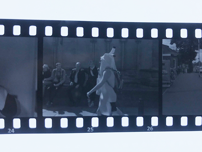

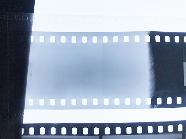

Here's what the film base
and image look like on a light box.
And when the curve is adjusted on SilverFast8 with Plustek 8200i
Fomapan 400 @ 800 reversal processed with Microphen.
