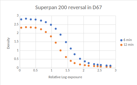

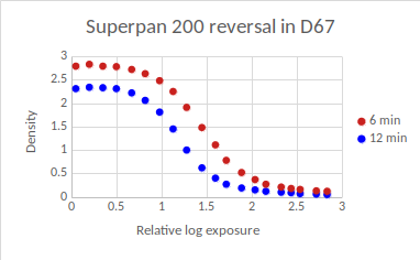

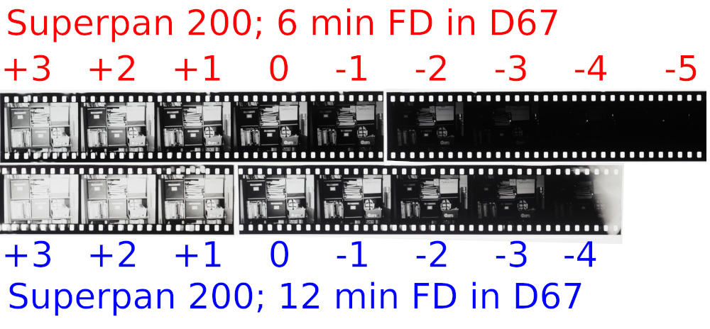

I don't have too much to add here, but I have sunk quite a number of hours into B&W reversal and I do have some suggestions for testing. It takes a lot of testing to get excellent results, and it's very easy to deceive yourself unless you expose some step wedges and measure them with a densitometer. Next best is to take identical exposures of the same scene under controlled lighting and directly compare the slides.
The experimentation can be simplified considerably by only changing the critical step: the first developer. All other steps can be considered to be "to completion", so as long as you have a working process and you maintain fresh solutions and good washes between steps, you just need to focus on the first development. If you can mix your own chemicals, I would suggest going for a tried and true formula, such as Ian Grant has posted here. Choose one developer, choose one film, shoot a test strip with several frames of the same scene at different exposures and develop it.
If the slides come out too dark, increase the FD time. If the Dmax is reduced, you've increased the time too much.
If the slides come out too bright, decrease the FD time. If the Dmin is increased, you've decreased the time too much.
If you cannot find a combination of exposure time and development time that gives an acceptable brightness without compromising Dmax or Dmin, you'll need to try a different developer composition or give up on that film and try a different one.
First developers are complex beasts and it is challenging to come up with your own formulation that will give excellent results that are backed up by densitometric data.
Since you mentioned it, if you are interested in Superpan 200, I can share the best results that I have obtained with this film.
Film: Superpan 200
FD: D67; 6 min at 20 °C
gamma = 2.6; Dmax = 2.8, Dmin = 0.1
