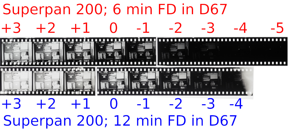

Since you mentioned it, if you are interested in Superpan 200, I can share the best results that I have obtained with this film.
Film: Superpan 200
FD: D67; 6 min at 20 °C
gamma = 2.6; Dmax = 2.8, Dmin = 0.1

Film: Superpan 200

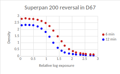

@iandvaag: Nice informative and educative work! Just curious to know how you computed gamma. 2.6 seems high as typically slide films aim at gamma of 1.7-1.8 IIRC.

I don't have a properly calibrated sensitometer, so I don't get film speed information out of this. I labelled the x-axis "relative log-E", but really it's just the density readings from the Stouffer step wedge. I develop the test strip taken at different exposures alongside the printed step wedge to get a rough idea of film speed.
The gamma was a linear regression on the straight line portion from 1.28 to 1.72 log-E. I would agree, the contrast is definitely a bit high by the numbers. The straight line gamma is not the whole story when it comes to contrast though. I've found that Delta 100 works well in D67 using a time of 15 minutes. Although it develops to essentially the same gamma using this time, the overall contrast to the eye appears lesser compared to the Superpan 200. I believe this reflects differences in the toe and the shoulder, and I need to make additional calculations such as contrast index or average gradient to quantify those differences. I would be happy if anyone has suggestions as to which types of calculations capture the differences of contrast seen by the eye. The Kodak sensitometry workbook is great, but if anyone has recommendations as to a book or paper with information on more advanced sensitometry, that would be awesome.
In the end, I was happy to get good Dmax and Dmin and I got tired of testing. So to date I haven't done any tweaking to the developer formulation which I believe is probably required to change the contrast while maintaining good Dmax and Dmin.

Regarding the gamma, the concern I've is it is computed from a straight-line part of the curve that corresponds to a relatively small exposure region, 1.28 to 1.72 log-E, which is about 1 stop. Had you considered the more useful exposure region 0.5 to 1.5 log-E (mid tones?), you would have got a gamma of ~1.75.
I agree with your assessment @Raghu Kuvempunagar. It would probably be more meaningful to report the average gradient over a longer portion of the curve since there is most certainly image data contained in the shoulder and toe of the curve. Even so, it is my understanding that the conventional number of 1.6 to 1.9 (as suggested by PE in his photo system engineering primer here) refers to the straight line portion of the curve. But straight line gamma is certainly not the whole story.
I haven't received any formal training in photographic theory, so I've tried to stick to the definitions that are given in the Kodak sensitometry workbook found here. I don't know if the definitions presented in that document are standard or not, but the following definitions are given:
Gamma (γ) - slope of the straight line portion of the curve
Average Gradient (Gbar) - average slope between any two points on the curve. The points chosen for the calculation should be specified when reporting the value.
Contrast Index (CI) - determined graphically, but essentially it measures the contrast of a negative in the exposure range that is normally used to make high-quality negatives.
Here is the raw data if you'd like to try calculate anything yourself:
Density of Stouffer step wedgeDensity of Superpan 200 developed 6 min in D67
2.840.12
2.720.13
2.540.16
2.440.18
2.330.21
2.160.27
2.040.37
1.890.52
1.720.78
1.601.11
1.451.48
1.281.91
1.132.25
0.982.48
0.822.63
0.672.72
0.502.78
0.352.79
0.202.83
0.052.79

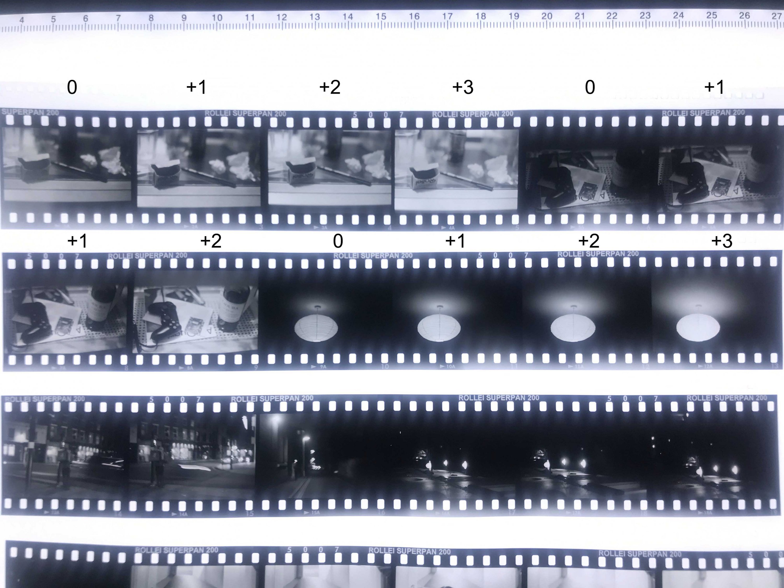

Thanks a lot for the info Ian. It seems like the quantitative part of film density is way beyond my scope and definitely something I'm going to learn more about.
Just to update everyone on my progress. Turns out my developer has gone bad. I tested some film leaders from Rollei Superpan 200, Fomapan 400, and Film Washi F with the same method I did as before with a longer bleach time (15 min 1st dev, 10 min bleach, 2.5 min clear, 2nd exposure, 15 min 2nd dev, 5 min fix). All of the film leaders came out white after bleaching but turned dark after the 2nd developer and even after fixing. I think this definitely means my developer has hit the hay. I'm waiting for another pack of Microphen to arrive this week. In the mean time I might just give 1:6.5 Rodinal a try from Jens Osbahr's protocol.
Yep. After first dev, a fogged leader should be black, and the bleach should render it clear.
The fresh Microphen arrived the other day. I tried to make a 2x stock in 500 mL but couldn't get everything dissolved so I ended up making a 1.3x stock in 750 mL. Next, I tested film leaders from Rollei Superpan 200 and Fomapa 400 with this more concentrated developer. The protocol was as usual but with different bleaching times (15 min 1st dev, 5 min and 10 min bleach, 2.5 min clear, re-exposure, 15 min 2nd dev, 5 min fix, 1 min stab). I mixed the KMnO4 bleach solutions (KMnO4 in part I and H2SO4 final in part II to get 1.5% final H2SO4) right before using it.
The 5 min bleach wasn't enough but 10 min seems to be better. I actually saw some silver "flakes" floating on top of the bleach solution and was afraid the emulsion might have fallen off. Since I already had parts of the Fomapan 400 from before (I accidentally cut the film off too early from the reel), I used the 10 min bleach step to see whether or not the emulsion is fine.
I like to mention that the top strip is from the fresh 1.3x Microphen whereas the bottom strip was from the first reversal attempt using a depleted Microphen from 2018.
Then I took a beer break for about 9 hours. I tested the bleaching again with a Rollei Superpan 200 film leader just to make sure it's still functioning. Unsurprisingly, 10 min did not completely clear the leader but 12 min did. I then developed a roll of Superpan with a 15 min bleach just to make sure.
@Raghu Kuvempunagar @Donald Qualls @Alessandro Serrao @destroya @Lachlan Young @iandvaag What do you guys think?
@Raghu Kuvempunagar Yes, I had a good result with Delta 100 and some poor results with HP5 and PanF. I've been pretty busy lately, but I'll try to post the details this weekend.
@iandvaag: sure, no urgency, please post when you make yourself free. As far as I'm concerned, the data you've posted is among the stuff I've found most useful in threads like this and I look forward to seeing more such data.
@YoIaMoNwater It looks like you're getting some nice results, congrats. I'm not sure exactly what you wanted a comment on, but here are a few thoughts:
Good idea about mixing the permanganate bleach fresh. In aqueous solution, MnO4- spontaneously reduces to MnO2 which further catalyzes the reaction. MnO2 is a brown sludge which can stain your film. You didn't mention what your clearing bath is, but IIRC Haist recommends a metabisulfite solution since its lower pH will help solubilize the MnO2. Some of the excess density you see may be owing to stain rather than incomplete bleaching, hard to say for sure. Wash well before and after the bleach. I recommend distilled water for the bleach. Permanganate will soften gelatin, so you'll want to use a film that is well hardened and minimize the time in contact with the bleach. I can attest that the hardeners used by Ilford and by Foma are not the same.
10 minutes in dichromate bleach seems long, and it doesn't look like it went to completion.
As for using old developer, I wouldn't chance it. Your time is worth more and it will be difficult to replicate if you do achieve successful results.
I use Dektol/D72 for the 2nd developer which only needs 4 minutes max. Reducing the total time of the process frees up time to do further experiments.

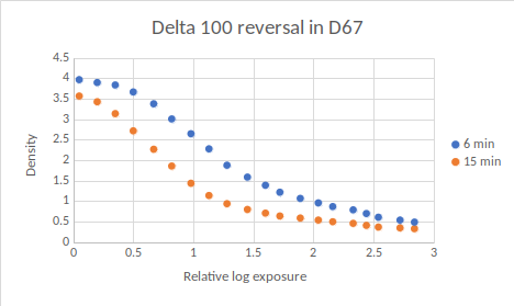

@Raghu Kuvempunagar Thanks for your interest. I'm glad someone else might be able to make use of my results. I posted these results on APUG once before, but there wasn't much interest. I've been meaning to do a proper write-up and put it on my website or maybe the "Resources" section here, but I haven't gotten around to it.

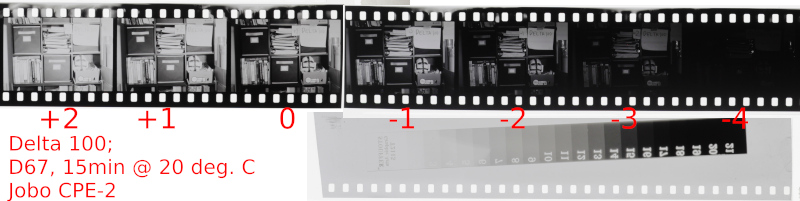

The only Ilford film that I managed to get good results with was Delta 100. I have "failed" results for other films, but I won't clutter up this thread with those results. I do think it's important to report failures, so I'll plan to write this up and post it somewhere. I didn't manage to find a great result for the following films using D67 and varying the developing time: Delta 400; PanF+; Tmax 100; Tmax400.
Film: Delta 100
FD: D67; 15 min at 20 °C; continuous rotary agitation in Jobo CPE-2
gamma = 2.7; Dmax = 3.57, Dmin = 0.33
Density of Stouffer step wedgeDensity of Delta 100 developed 15 min in D67
2.840.33
2.720.35
2.540.37
2.440.41
2.330.46
2.160.50
2.040.54
1.890.59
1.720.64
1.600.71
1.450.80
1.280.94
1.131.14
0.981.44
0.821.86
0.672.27
0.502.72
0.353.14
0.203.43
0.053.57
@iandvaag: thanks so much for sharing the data on Delta 100.
I was wondering why longer development resulted in lower DMax but it had skipped my mind that D-67 has thiocyanate in it! Do you use D-67 as single use first developer or do you use it several times till you notice a significant difference in the results?
Let me take some time to digest the data and come back to you with questions or comments. I'm sure I'll have a few. :smile:

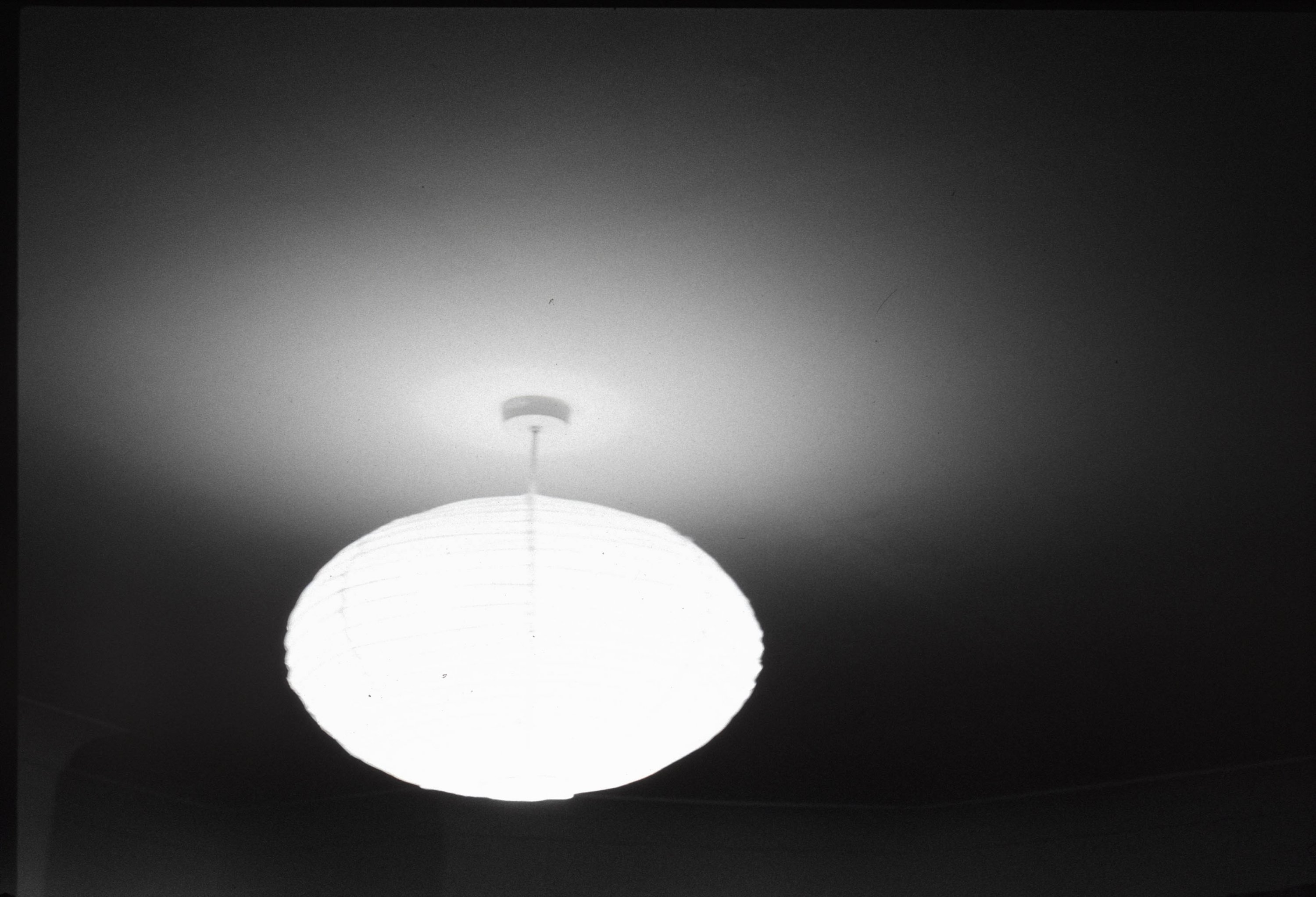

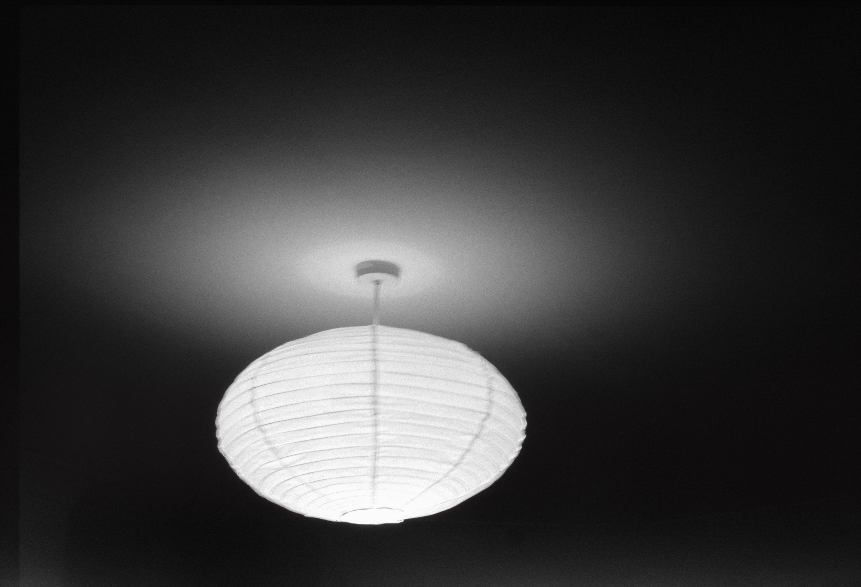

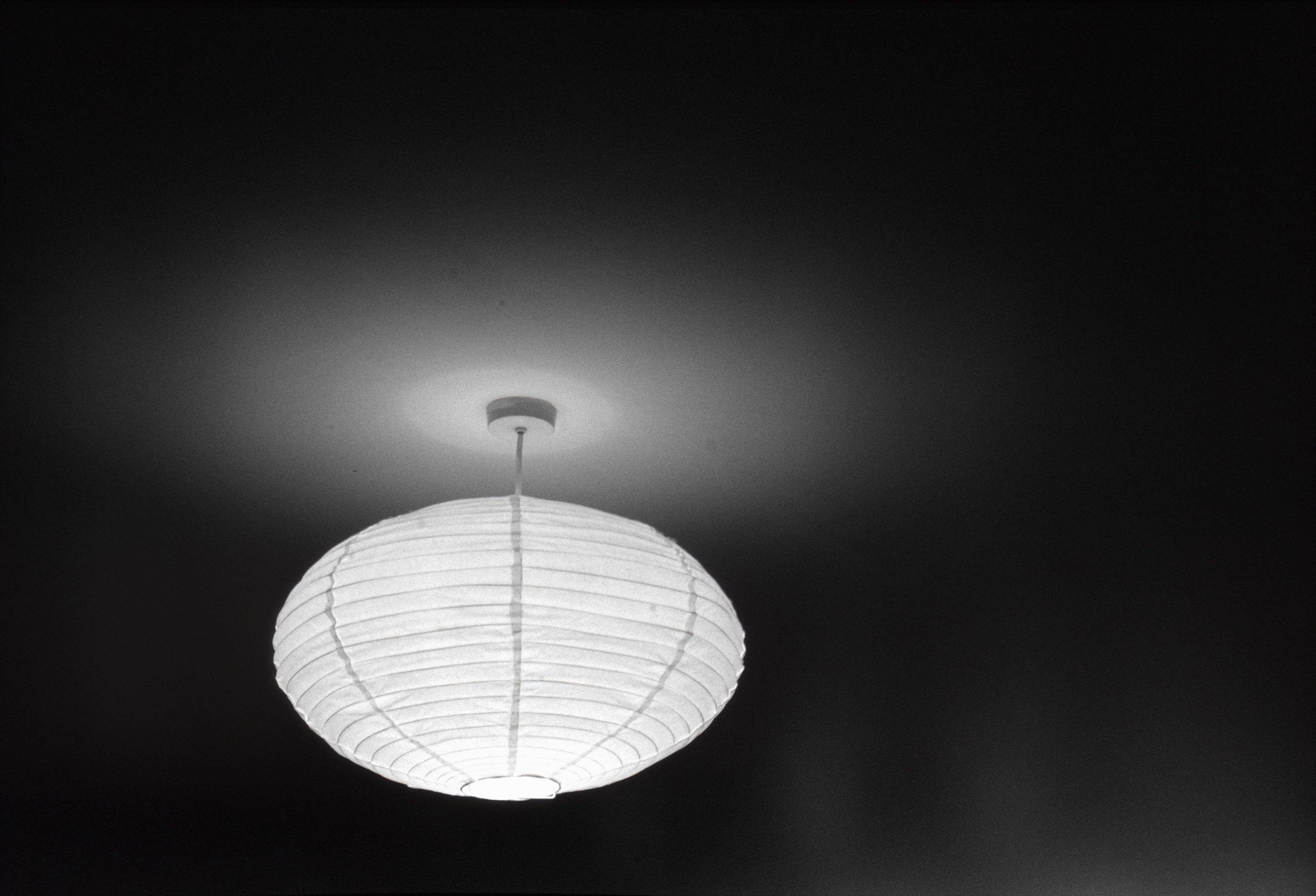

Thanks for the advice Ian. Yea I think the main issue was the developer. I have couple rolls of HP5+ pushed to 3200 and 6400 that I'm gonna try with the current protocol with a increased time for the first dev step.
These look really nice! Second from the top looks like the right exposure to me.
Thanks a lot man! It definitely seems like +1 for this film is the ideal exposure for reversal.
