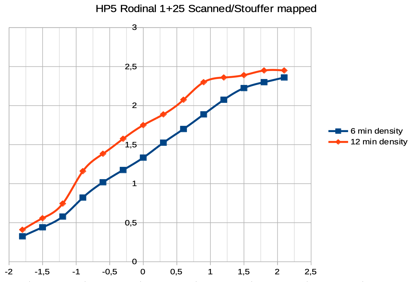

Bill, could this be a good graph?
The densities are translated from Stouffer (Scanned together with strips and then grayscale mapped to T2115 density).
X-axis is translated by multiplying stops 0.3.
I think it starts to look maybe.. correct? The mapping to actual densities was probably the key.
The toe is now clearly steeper on 12 min, as it should be. The 6 minute one is very linear actually. Highlights compression is enough far away. If exposing EI 1600 and developing 12 minutes the compression is actually two stops more up, so no problemos with that either.
And yes you can see why people push HP5, it gives that nice CI boost. 12 minutes is a bit heavy of course but it doesn't ruin anything.

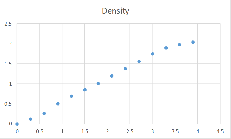

I did this quick and in Excel. I used a relative log-H and the density is the supplied density minus film base + fog. This is looking to me like a film curve.

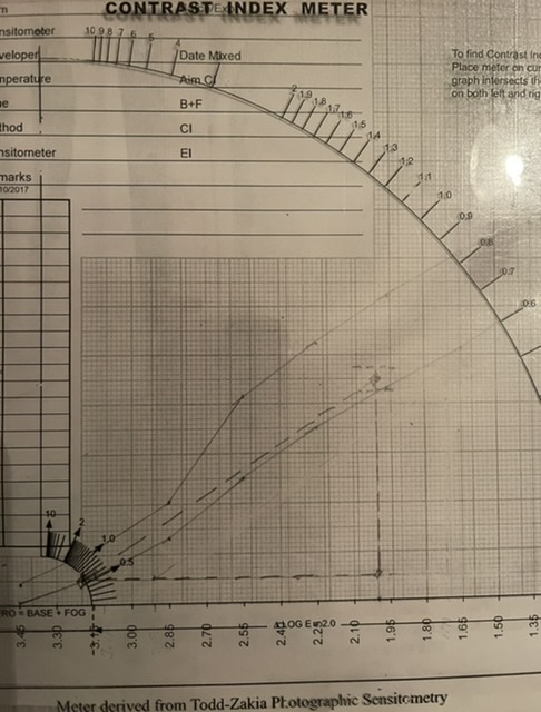

I drew up a graph from your numbers, I had to leave off a couple readings because of the scale of my paper.
You had a CI of 0.60 for 6 minutes and 0.77 for 12 minutes Rodinal 1+25
You are "just under" the tolerance of the ASA triangle with 6 minutes. So I cannot properly judge film speed but for now I dropped the scale at 400 right at where the curve crosses 0.10 above base plus fog.
Try 15 or 30 seconds more next time to try to hit the triangle.
The Time-CI curve is just an example, the parts of the Time-CI curve outside the two data points is completely made up.
You can get a more complete family by developing several tests at different developing times, some people like a series that tends to give a broad set of contrasts such as 4, 6, 9, 13, 17 minutes.
https://www.beefalobill.com/images/RadiantTime-CI.pdf
Here’s how the Contrast Index Meter looks adjusted to fit your 6 minute curve. Right at 0.60

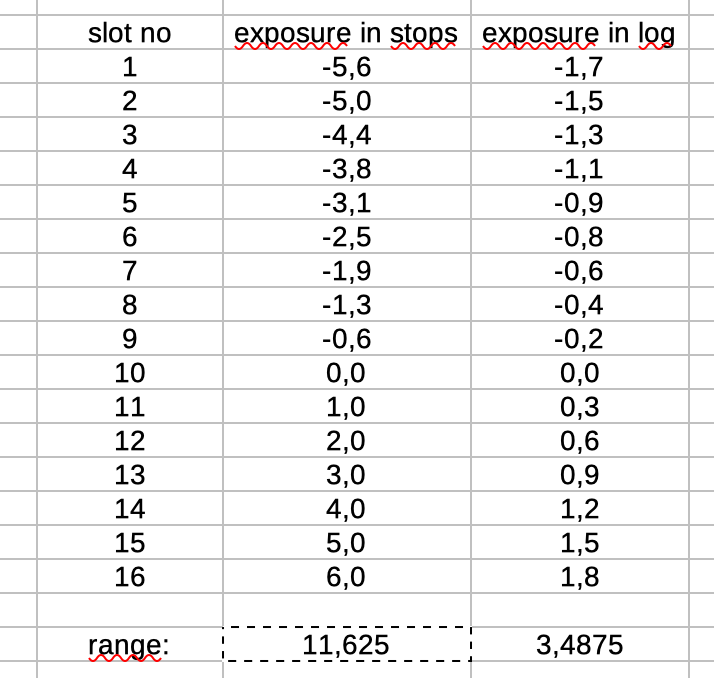

Numbers tell more, so this would be my next exposure plan (where 0 = 18% exposure of course):

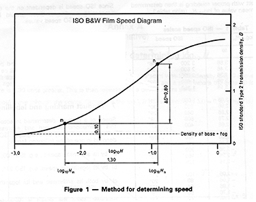

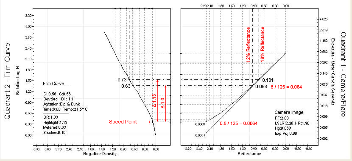

The ASA triangle (ISO :smile: ) Bill talks about refers to the contrast parameters in determining the ISO film speed for black and white negative films.
What he didn't mention is that you can determine your EI without it by using the Delta-X equation. The CIs are a form of average gradient to determine the slope of the film curve.

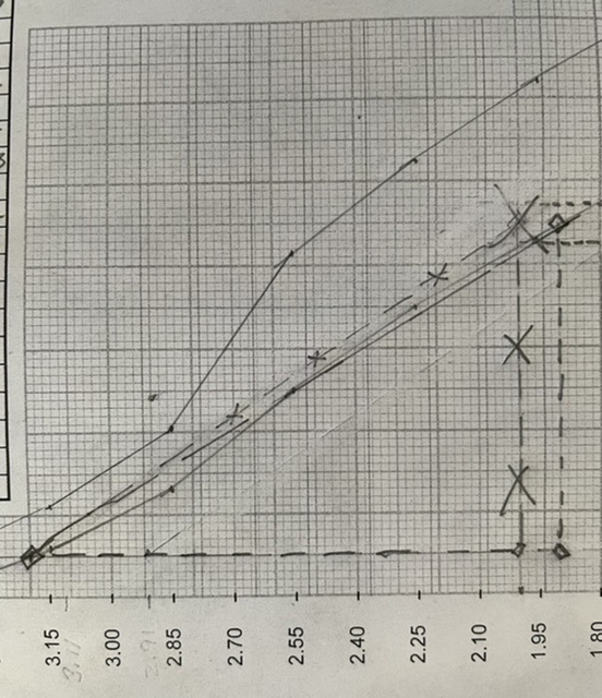

I screwed up the drawing but guess what… you hit the ASA triangle exactly with six minutes. Don’t change the developing time, forget what I said about 30 seconds more! This is how the triangle should look…

Your scanner seems to be serving very adequately as densitometer!
I calibrate my sensitometer by the ASA triangle and on the assumption that Kodak works very hard to assure that TMY2 is exactly 400. (As Ilford does with HP5+). Using that triangle as a guide, the closer your curve gets to hitting the points of (1,3 run 0,8 rise, from 0,1).
Since you hit the triangle exactly, you can take my paste-up top scale as your calibration (until another test suggests a different calibration, or maybe a discovery that something is “out of control”)
If you can reduce all the exposures by 0.03 log meter candle seconds, then your calibration will coincide with 1 MCS at your “#3 from the top” tube (1,5).
To sum: You hit ASA exactly so now my top scale is your calibration.
I mean your #4 tube is 0.03 log MCS and if you reduce all the exposures 0.03, your #4 tube will ‘conveniently’ be 0 log MCS
And you have readings down to the #14 tube.
You could make a few tubes (e.g., #16, #15, #14 and #13) be 0,15 log units apart. It’s good to “waste” one tube such that it makes “so little exposure it can’t be detected”. But you have a few that you’re “not using” so you can shift everything down (or experiment with varying intervals). Guaranteed if you vary the intervals I will make a mistake or two graphing…
If you can make the total run be -3,1 log MCS to 0,45 log MCS, your whole curves will sit pretty on my graph paper
