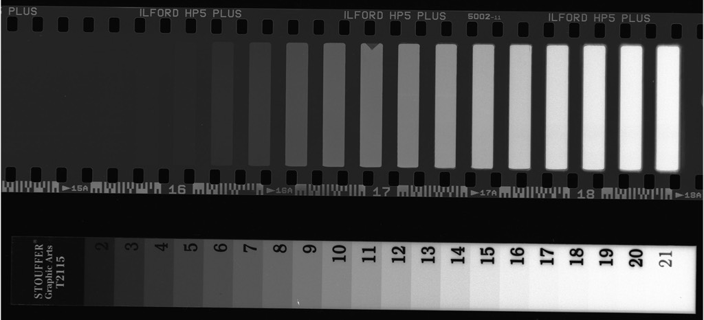

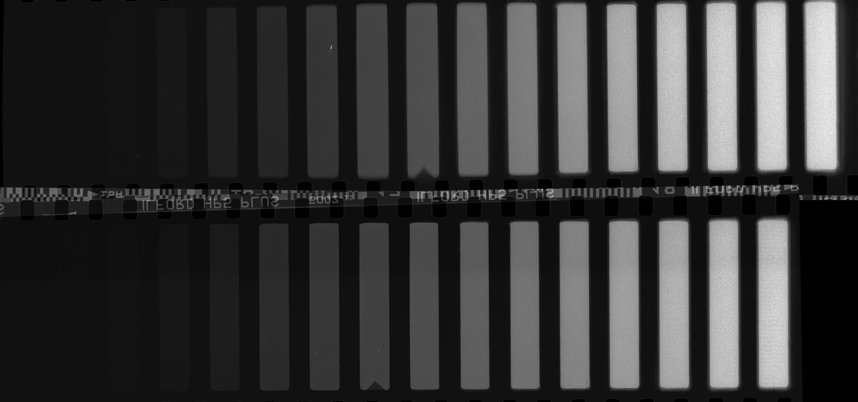

Ok, new scans from "correctly exposed" tests. I wanted to share these with you.
So what you are seeing here are two strips, exposed separately but developed + scanned together. I've shifted the lower one for one slot so you can compare the densities. Yes, you guessed right. The upper one has been exposed for one stop more than the lower. When using RGB picker and comparing the tones, they are really same. Well, you can probably see it by your eyes. Remember that these are scanned at once, so their tones are relative.
I can see 4 stops under 18%, the fift stop is a bit faint. That should be in par what HP5 can do. The upper strip has 5 stops under because of the overexposure.
For highlights or stops over 18% I can count 8 stops with different tones when using RGB picker. My scanner clearly had difficult times to scan the last slots as those are very very dense.

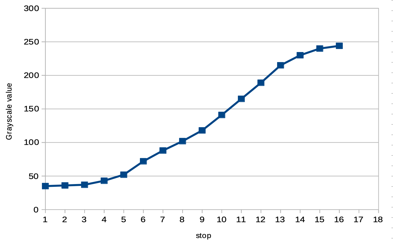

Here is the almost correctly exposed strip (lower one from previous). It has small flaw for base exposure (instead of 125ms, the 18% gray is exposed 100ms). But close enough for having fun analysis.
And here is graph drawn from the data:

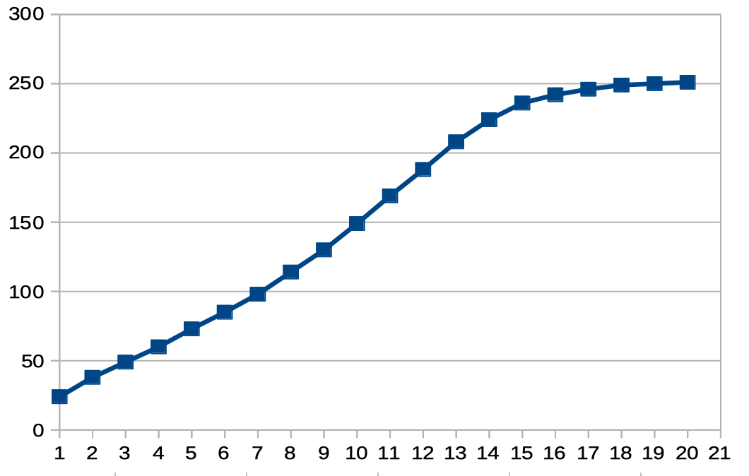

BTW: as I know the densities of stouffer wedge, I could map the grayscale values to densities via stouffer grayscale values, I think.

Of course the scanning is imporant to do right. In previous example I adjusted the film highlight end point as maximum and that caused the stouffer scale scan to be compressed. Also it isn't completely straight, here is a plot of data from previous stouffer scan:
YES! much better! addresses my previous criticism.
Plus, you get numbers out of your scanner. They are expressed in some color space, and their relation to the luminous flux passing through the film is (a) not logarithmic; (b) non-linear and complex, with many different forms floating around. See e.g. : http://www.brucelindbloom.com/index.html?Math.html; I give below a sample at random:
Make sure, however, you scan the Stouffer steps with every film you intend to measure. DO NOT trust the scanners's translation of film densities to 0-255 values to be fixed and unique.
Of course I will do that. The scanner + software can mess up my analysis big time without a stouffer. It is very valuable tool in many places, glad I bought one (well, two..).
